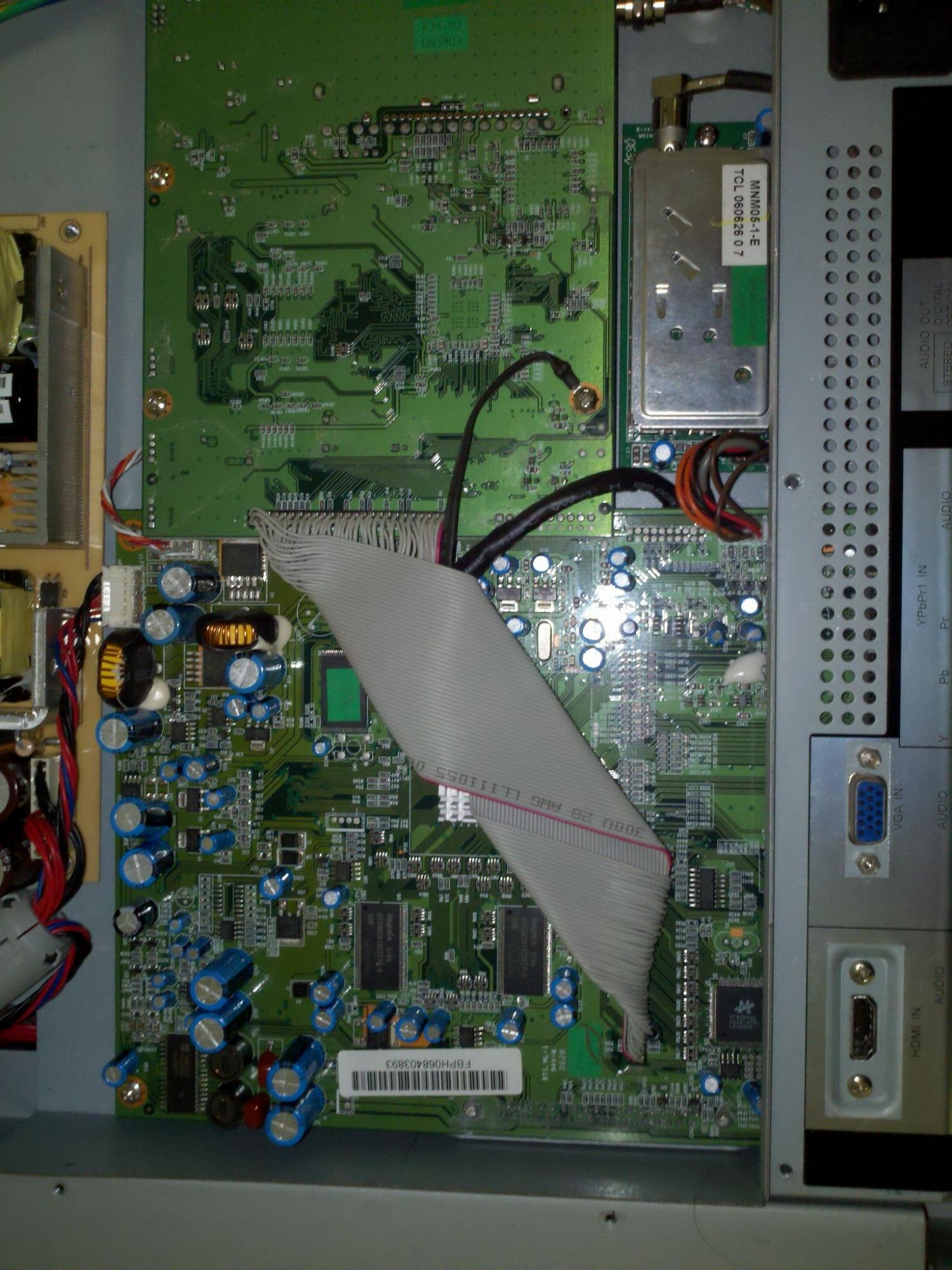

    FLX-3202 Element made by poloroid

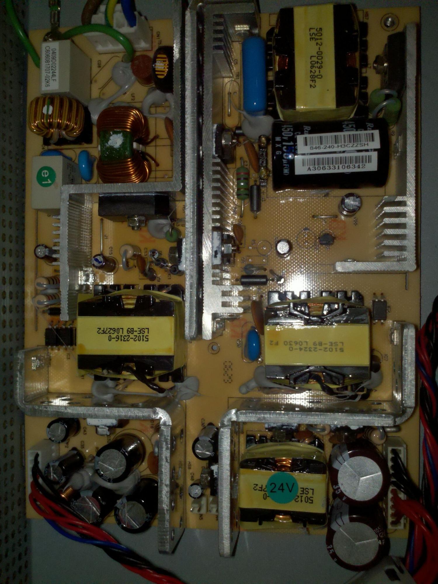

    boards segmented into PSU, inverter, and video board.
    Backlight flickers and goes off.
    Power supply has a number of Rubycons installed from the mfg! No swollen caps, all test good. It has 2 25V rails, the one powering the inverter board goes out after the screen turns off.
    Tested all the diodes, all test ok.

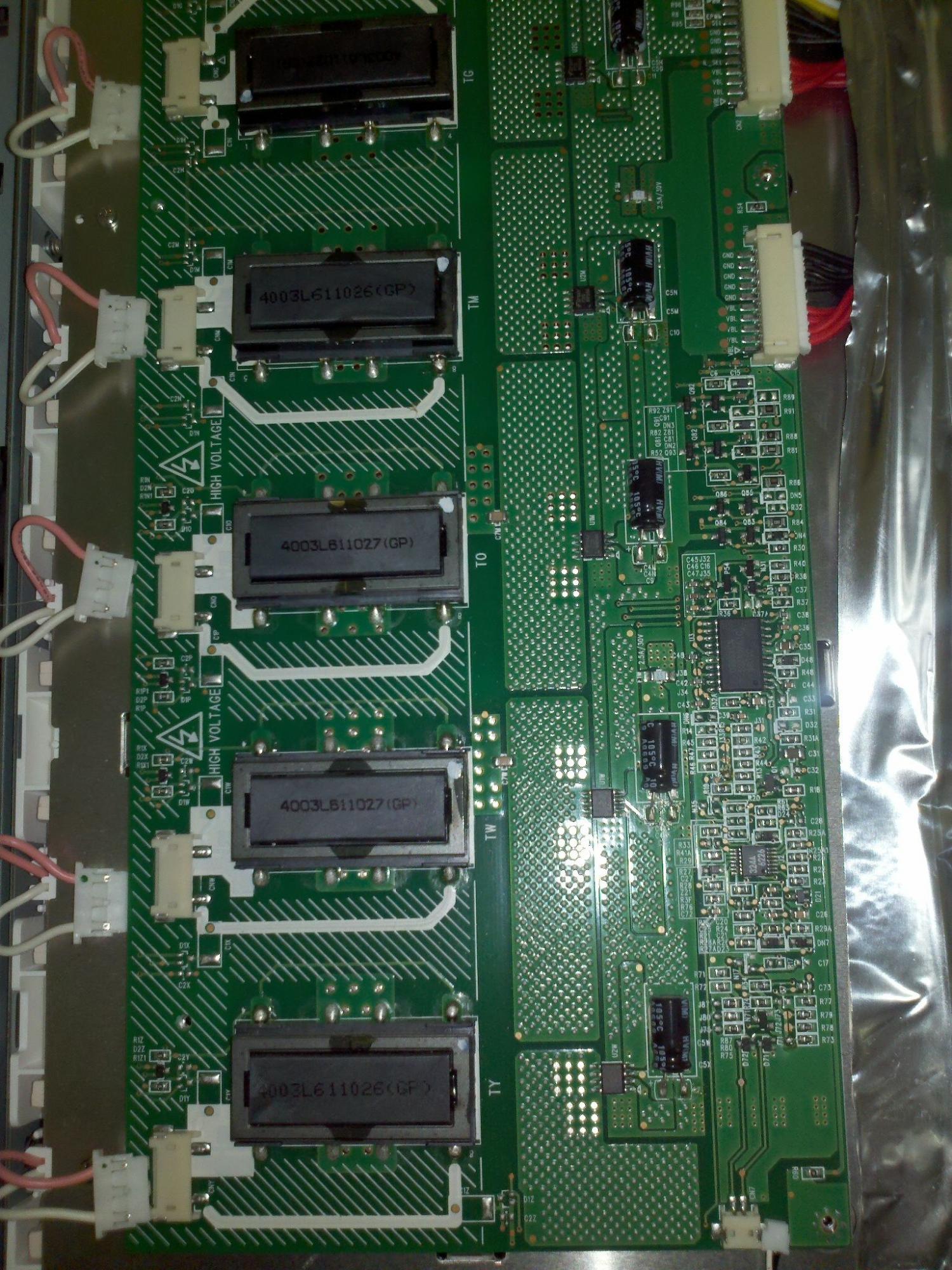

    Check the inverter transformer secondaries as identified by
    http://lcdparts.net/TransformerDetai...ProductID=2731

      That looks like a Darfon inverter. Definitely check the transformers.

        Secondaries range from 2.20k to 2.260k... The 2 secondaries on each trans is wired in series, so I just measured the total on each trans instead of each individual secondary.
        Nothing odd with the primaries either.

          Check the individual sections of the secondaries. I made the same mistake and missed a secondary that was significantly lower than the rest. It turned out to be shorted.

                All secondaries are 1.08k to 1.10k. Can't check primaries individually without desoldering, they are run in parallel.
                Found 4 fuses on inverter board, none of them are bad.
                Checked the transistors driving the transformers, none are shorted.
                This morning when I turned it on, the backlight flickered rapidly for about 10 sec before I unplugged it. Usually it would only flash three or four times and go out.

                  I tried hooking up each backlight individually. All turn on, but two of them, the top two, cause a tick tick ticking noise that occurs when the backlight flickers on. I've heard this noise before on another poloriod screen where I had to replace the PSU (noise from inverter circuit on psu). It sort of sounds like a high-voltage zap, like static. Is that likely from an arcing transformer?

                    Well, I removed one of those transformers, and no visible burns on the wiring...

                      Using just 1 backlight, the same one on three different coils, generates different sounds. Using it on one the 3rd coil from the top causes faint ticking static noises, the 2nd coil from the top and the top coils have loud ticking static noises.
                      So is it safe to assume the transformers are bad?

                        Sounds more like a bad CCFL. Is there any combination of lamp and transformers that *doesn't* make any noise?

                          I agree, this sounds like bad wiring to the CCFL or possibly a bad CCFL.

                            Listened more carefully this time. the quieter noise is actually coming from the power supply, and I hear some high-pitch whine in it too when I move close to the power supply.
                            The louder noise only comes from the top two transformers. Any CCFL that I can get to reach, when hooked to those two transformers, makes that noise... Hook CCFLs to different transformers, no noise. I'll see if I can record the noises.

                                I took the screen apart and looked at the CCFLs. No burn marks anywhere I saw.
                                As for bad wiring; are you talking about a short through the wiring to the CCFL?
                                I'm leaning toward bad inverter...

                                    No discoloration on any of the ccfls or the white rubber ends or any wiring.

                                      I'm gonna order an inverter board. This guy on ebay has some new ones for cheap. Far cheaper than ordering a few of those transformers.
                                      • el3ctroded
                                        • Nov 2008
                                        • 198
                                        Re: FLX-3202 Element made by poloroid
                                        All cables attached, but the backlight never turns on except once it flashed. The power supply keeps turning off the power to the inverter board. The power supply has two output rails, one rail for the video logic board, one rail for the inverter. Both measure 22V. I noticed the video board rail drops to 18V when turned on... That seems like a lot...
                                        I've tested all regulators on the video logic boards, they are all ok except one 3.3V one is outputting 3.33, but that's pretty close. I've tested several large caps on the video boards, none bad.
                                        I've tested the new inverter board, all transformers are 1.1k, and all fuses good.
