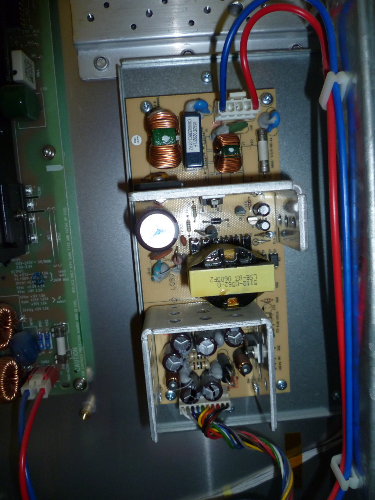

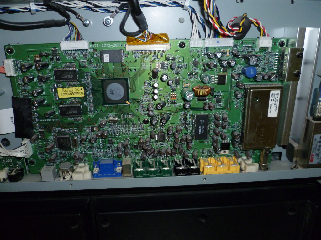

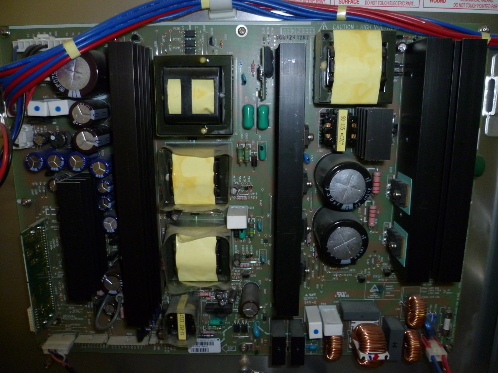

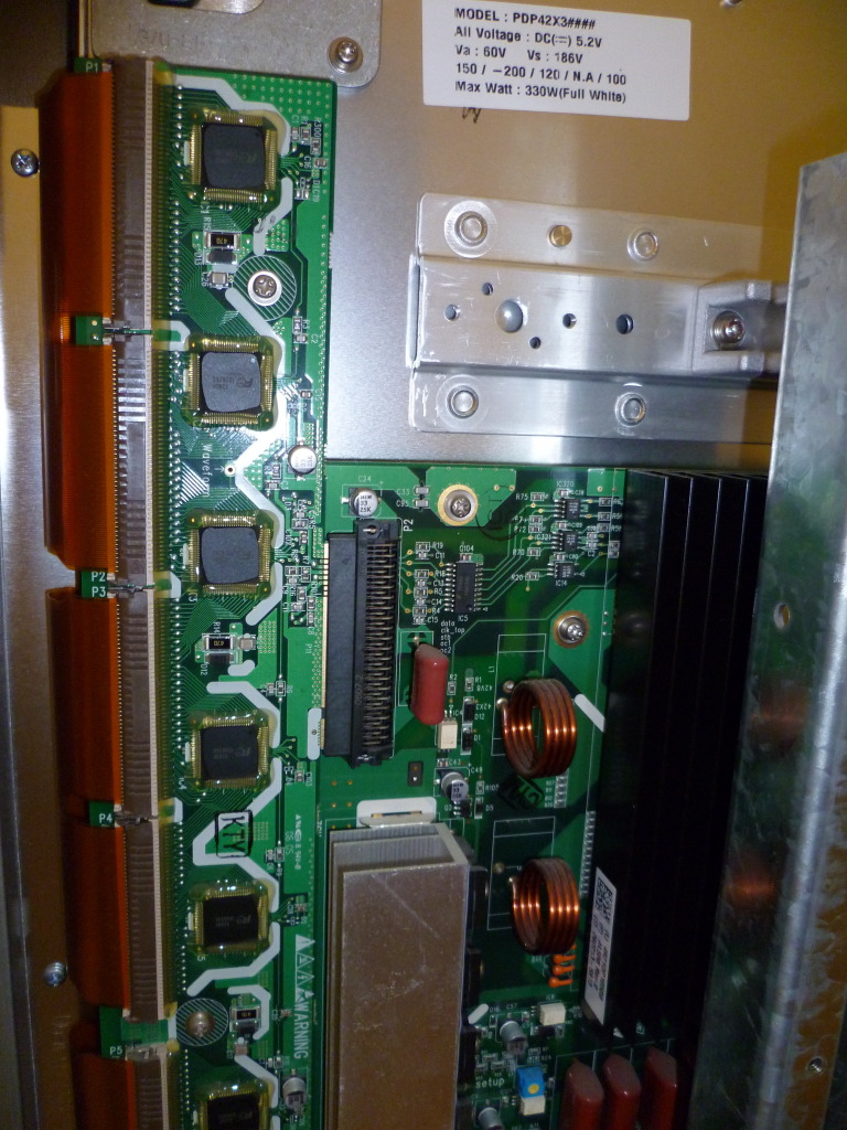

    Hi everyone. I have a P42HDTV10A Vizio. Previous owner heard a pop and video went out, sound still worked. I checked the capacitors but do not see any damaged ones, other the two 330uf 450v fatties on the power board that have a small bulge on their heads [pic #3]. All the TV techs I spoke with say it is a Y Sus Z Sus board issue. Of course, I would like to do it myself if I can but I am only familiar with mac/pc disassembly. On eBay though, someone advertises a mail in service for my 6870QYH005B board... $140 to attempt to fix both the y and z boards. Please take a look at the photos... I could not tell where the damage may be.
    What do you guys think, is the mail in option worth it? Anyone know a place with Y and Z board removal instructions?
    The storage room is dark so pics are not perfect. You can see the original shots at http://s278.photobucket.com/albums/kk100/pcptwist/
    Let me know if better shots are needed Thanks in advance, I appreciate any help and hopefully can return the favor one day.

    Pretty clean set you got there.

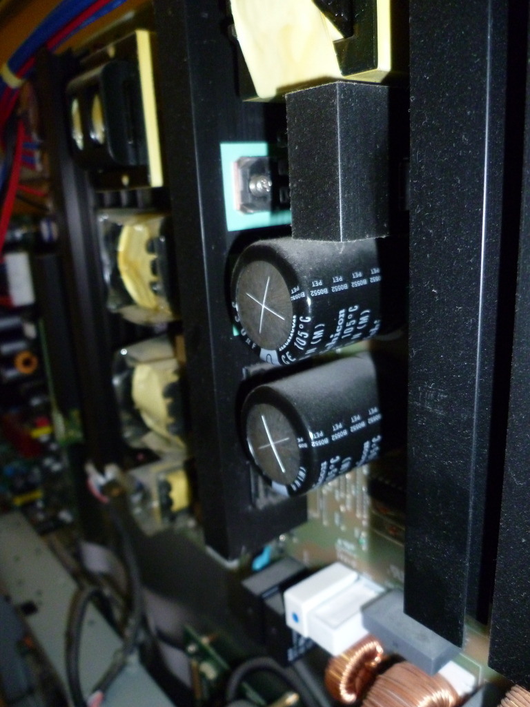

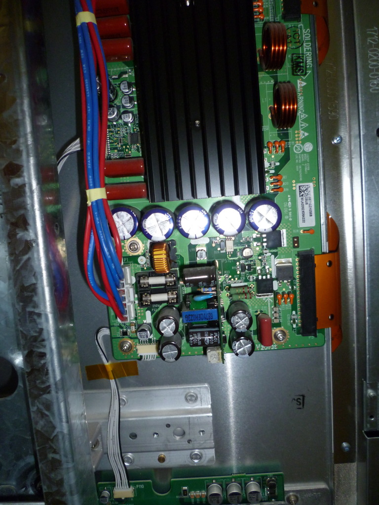

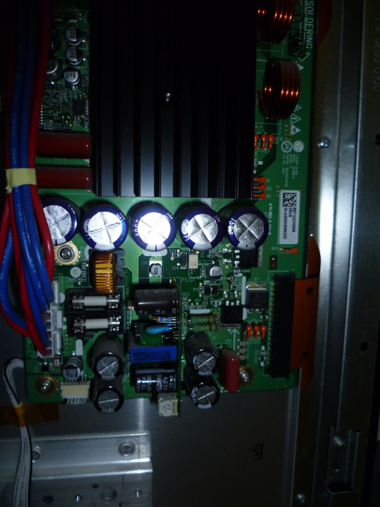

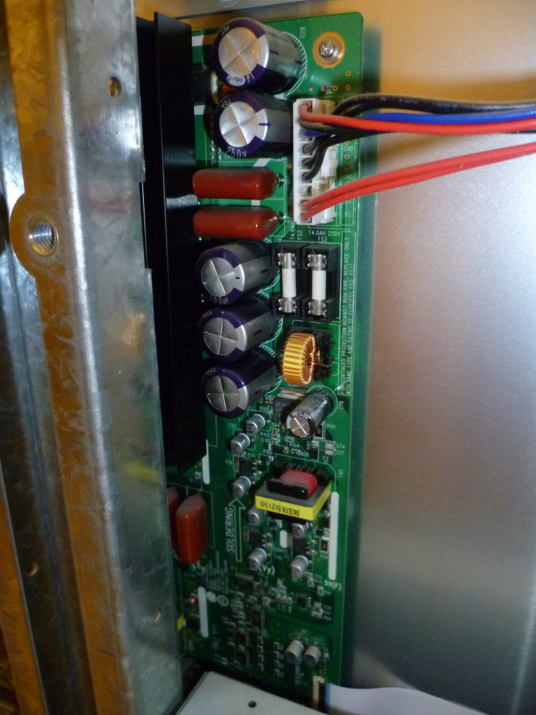

    Don't assume that both the Y and Z sus boards are shot. Check the fuses on both the boards first. If you find any open fuses then it's safe to say that the IPM/s on the board are shorted.
    If the fuses check out ok then power up the TV and leave it for half an hour to warm up. Switch off then touch the heatsinks, carefully(!), on the Y and Z sus boards. If you touch a stone cold heatsink then that is the board you need to change; open IPM/s.
    Oh, and you may as well replace those cap's in pic #3.
      ...and all those samwha crapacitors if you found & fixed the problem..
      the excessive use of samwha's in there smells like samsung OEM..

          Wrong twice. Anyone SHOULD be able to recognize an LG electronics design. After all, they supply most of the components for the overadvertized Vizio line.
          And while Samwah has had bad production runs of a few caps in specific values / voltages, it's far from the universal problem that you seem to believe.

            Use a DMM to test the fuses. If you don't have one, buy one. If all fuses are intact, observe the screen preferably in a darkened room. If a faint image is visible in the lower right corner of the screen, you have a defective Z-sus. This can be enhanced by hooking up a source (DVD player) and stepping through the inputs until you hear the sound. You will need the DMM when adjusting the replacement Z-Sus
            I would not advise using a repair service; you can buy a replacement board for essentially the same as the repair services, and you won't have to pay shipping to get the defective board to them.
            A common failure is the hybrid under the heat sink on the Y-sus and Z-sus. I don't recommend going the 'replace the hybrid yourself' route unless you have superior soldering skills.

              I'll try multimeter readings on the fuses (when I get one . Here are shots of the fuses I have might as well post 'em
              http://i278.photobucket.com/albums/k...t/P1010013.jpg
              http://i278.photobucket.com/albums/k...t/P1010010.jpg

                    Education time. Most modern electronics represent a collaboration between multiple companies. An LCD TV may consist of an LCD panel from one company, a power supply from a second, inverters from a third, and a mainboard from a fourth. Add in the companies that produced the firmware and the plastic case, and you have a hodgepodge.
                    Plasma TVs are a little different animal. Usually the plasma panel, the various buffers,main logic card, sustain cards, and power supply are all supplied by the manufacturer of the plasma panel. The speakers, audio amplifier, remote, control panel, etc are added by the manufacturer. The main control card may be supplied by the panel manufacturer or the panel manufacturer, with firmware customized for that manufacturer.
                    The particular plasma panel in that TV is supplied by LG Electronics, LG used it in a number of TVs, including the 42PC3D-UD. That panel was also used in tvs built by a number of other companies, including Vizio. That panel had a consistent problem with the sustain boards, specifically the hybrids. There have been various culprits suggested - the silicon heat sink compound on the hybrid, a 15V supply that would drift, etc.
                    There are three likely failure modes
                    1. The hybrid on either sustain shorts and blows a fuse. In that case, you get the 'No picture, has sound' failure.
                    2. The hybrid shorts, does not blow a fuse, but overloads the power supply. That results in the 'Trys to turn on, turns back off' failure.
                    3. The hybrid on the Z-sustain fails in such a manner that the fuse does not blow, and the power supply is not overloaded. Again, you get the 'No picture, has sound' failure - with a little twist. There will be a dimly lit area in the lower right corner of the screen.
                    Everything points to your having either a mode 1 or a mode 3 failure. Once you get your DMM and test the fuses, you can hopefully identify which board is bad.

                          Most techs say it is the Y sustain on the Vizios, so go ahead and get a new 6870QYH005B board. One guy said that the Z sustain will 90% fail within a month, so get both Z and Y.

                            Set your DMM to the 200 ohm range, do the testing with the power off.

                                Is that a typo? I thought you were measuring fuses?
                                Assuming a typo, here's my best suggestion: With signal applied (or if you hit the menu? button on the remote), do you see any sign of light in the lower right corner of the screen? If you do, the Z-Sus is the problem. If you don't I'd suspect the Y-Sustain first. Oh, to pull the Y-Sustain card you will have to remove the right hand vertical brace.

                                      My apologies that was a typo and I meant to say fuses not cap's.
                                      I did not see signs of light while toggling the input and menu buttons (I don't have an extral DVD player to test with).
                                      I guess I'll go with the Y sustain replacement. Do you suggest a "seller refurbished" board on eBay?

                                        I would question any seller of refurbished Y-Sus boards carefully about just what was done. I've heard that just dropping in a new hybrid is not enough. Make sure that they offer some sort of warranty, and have an excellent feedback rating.
                                        I believe Coppel TV repair both sells repair kits and also refurbishes the boards. They can be found on eBay.
