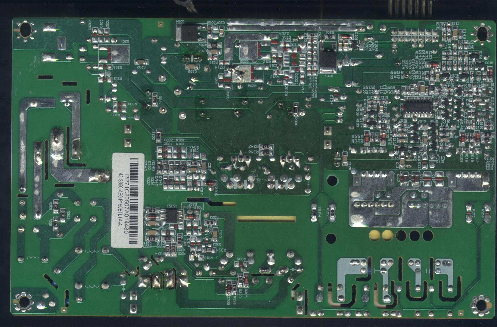

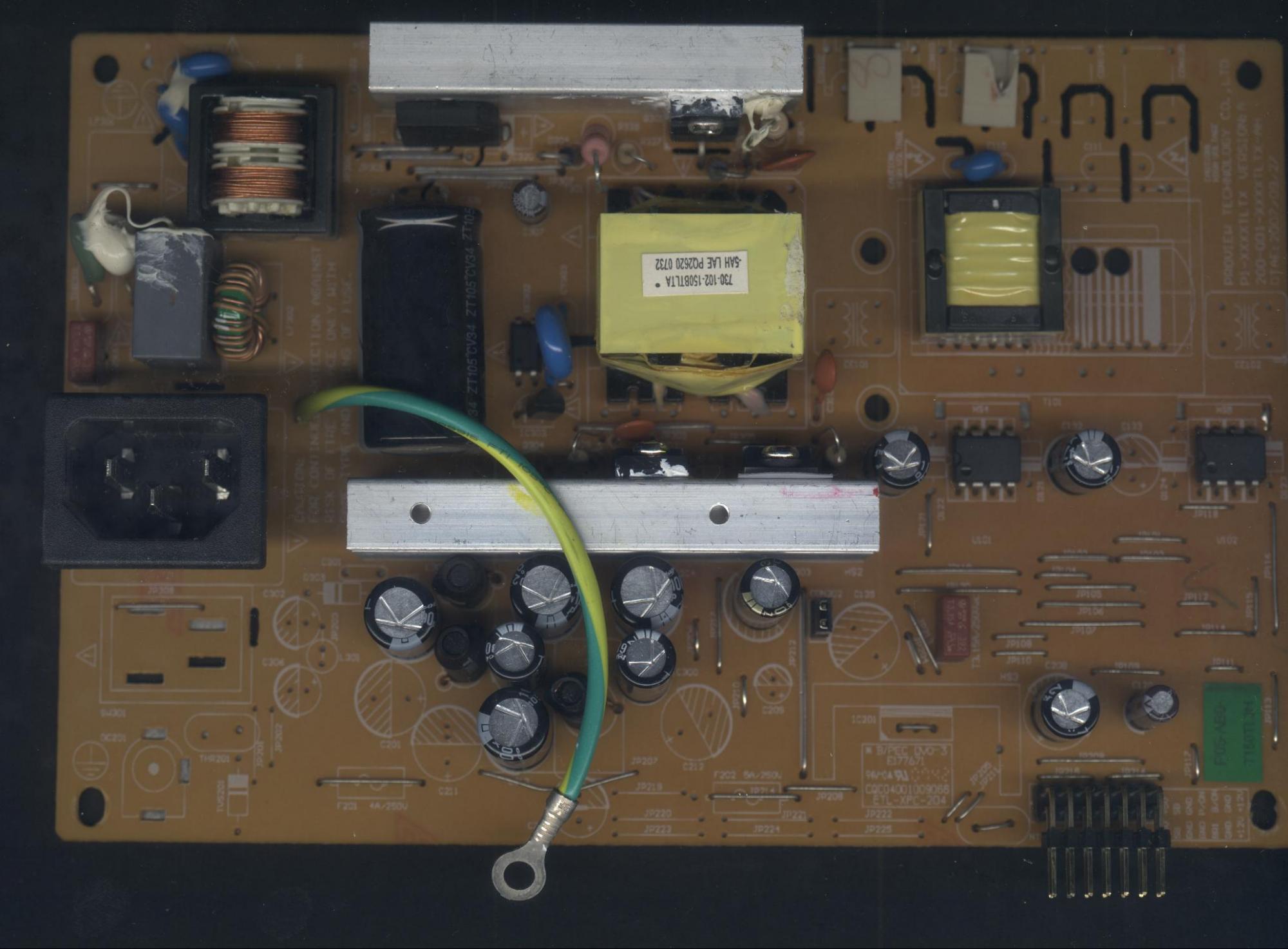

        PS. Post a picture of the boards so we have a reference for future. Please post using the manage attachments button and do not post inline.

          OK here's after the recap. Received new CCFLs yesterday, soldered everything up and still getting 2 sec and off sometimes, then sometimes the backlights restart, eventually though I started hearing buzzing or arcing coming from somewhere and an ozone like smell so I pulled the plug. Time to recheck my soldering work and take the panel back apart.
