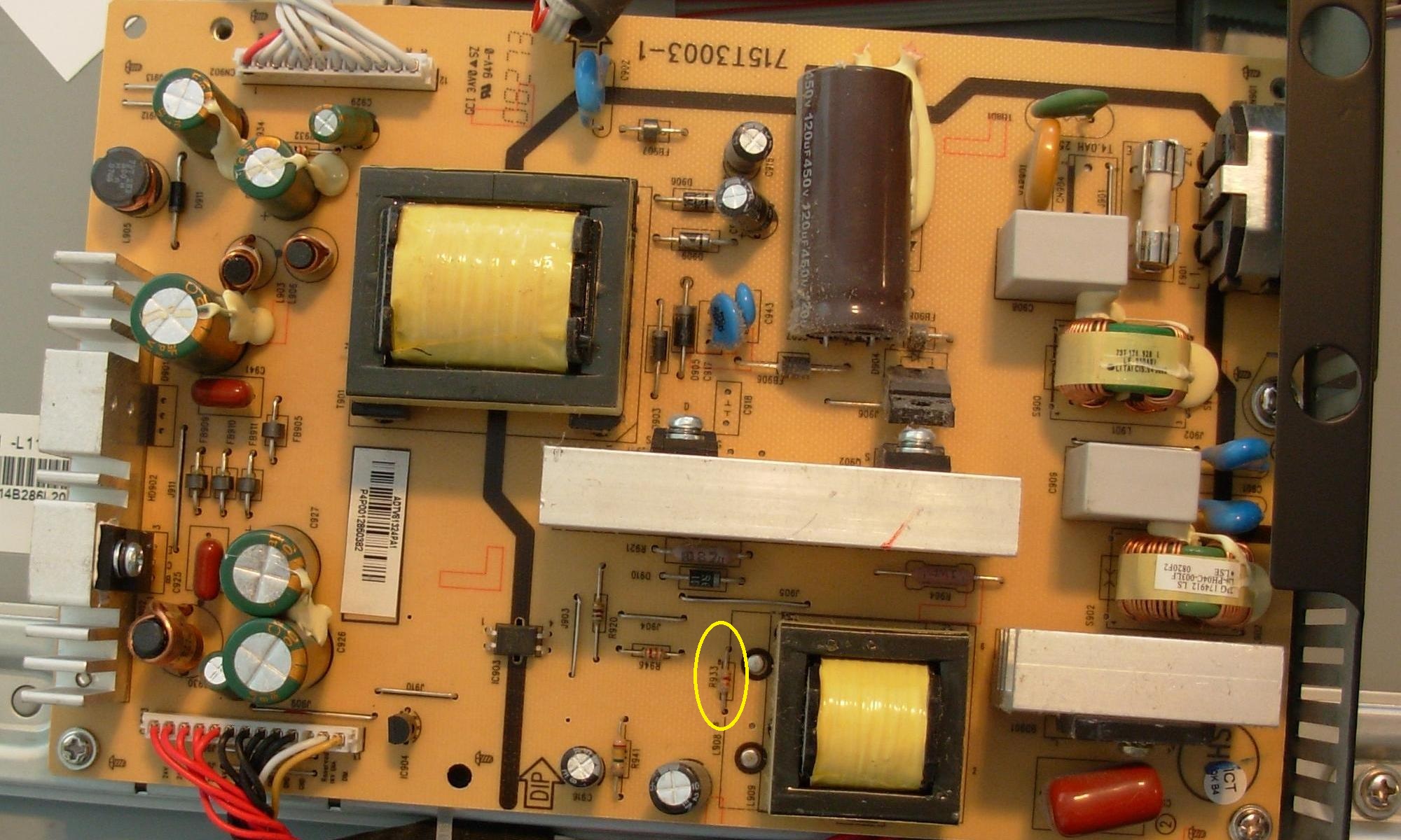

                          Re: Vizio VA26LHDTV10T Sound but no picture
                          Ok sorry about that jetadm123
                          Brand:Vizio
                          Model:#VA26LHDTV10T
                          Part:#ADTV81324SA1 Power supply/Inverter Board
                          Here is a picture with the component circled in yellow the part number of the power supply/inverter board is ADTV81324SA1
                          need some help Identifying the resistor color bands on R933 of the power supply board on this model ADTV81324SA1 it is burnt beyond recognition.
                          Also if anyone has a service manual for this model it would be greatly appreceated
                          i am looking to try and repair this powersupply i know just replacing this part wont be the fix but it is were i am starting all the caps look ok but i am asumming anything could be the culprit allso the unit would not even light the on button no power watsoever
                          I repair lcd monitors all the time replacing the caps and differant things so just so you know my exspereance level now trying a lcd tv for a change
                            #33
                            1) A rare chance some member may have one of these boards and can tell you the value, or better yet a schematic.
                            2) You can try asking someone selling one of these supplies on eBay what the value is. Many sellers won't mind aswering a simple question if you're nice about it.
                            3) This resistor might be part of the PWM circuit. See if it's connected to a pin on the PWM chip. Look up the datasheet for the PWM chip and the manufacturer may have a application circuit or a formula for calculating the resistor value.
                              Well jetadm123 from what i can tell you are correct the resistor is connected to a chip
                              I think your correct in assuming it is a PWM chip the part number is P1337 with the letters PANR under them.
                              I believe the NCP1337 with the CASE 751U surface mount is a cross with it as far as the manufacturer Having a application circuit or a formula for calculating the resistor value i dont know
                              you are beyond my Knowledge talking about what a chip like this does or why the restor would of failed but i am trying to understand
                              I think from the layout of the NCP1337 chip the resitor is on leg #8 of the chip
