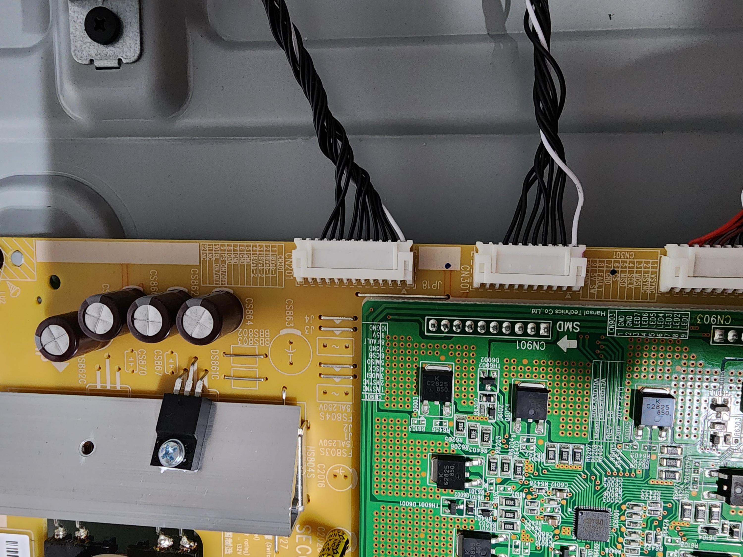

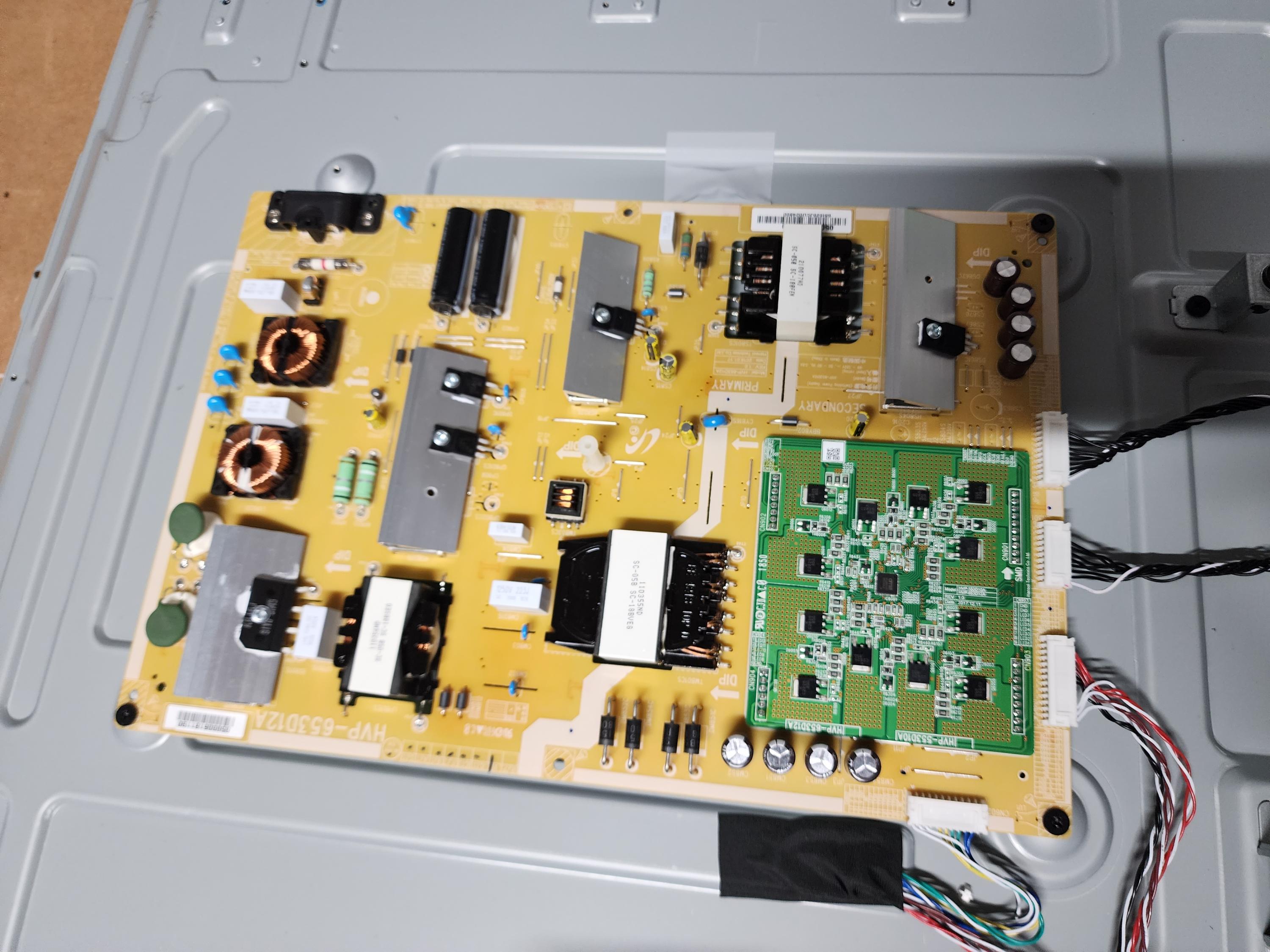

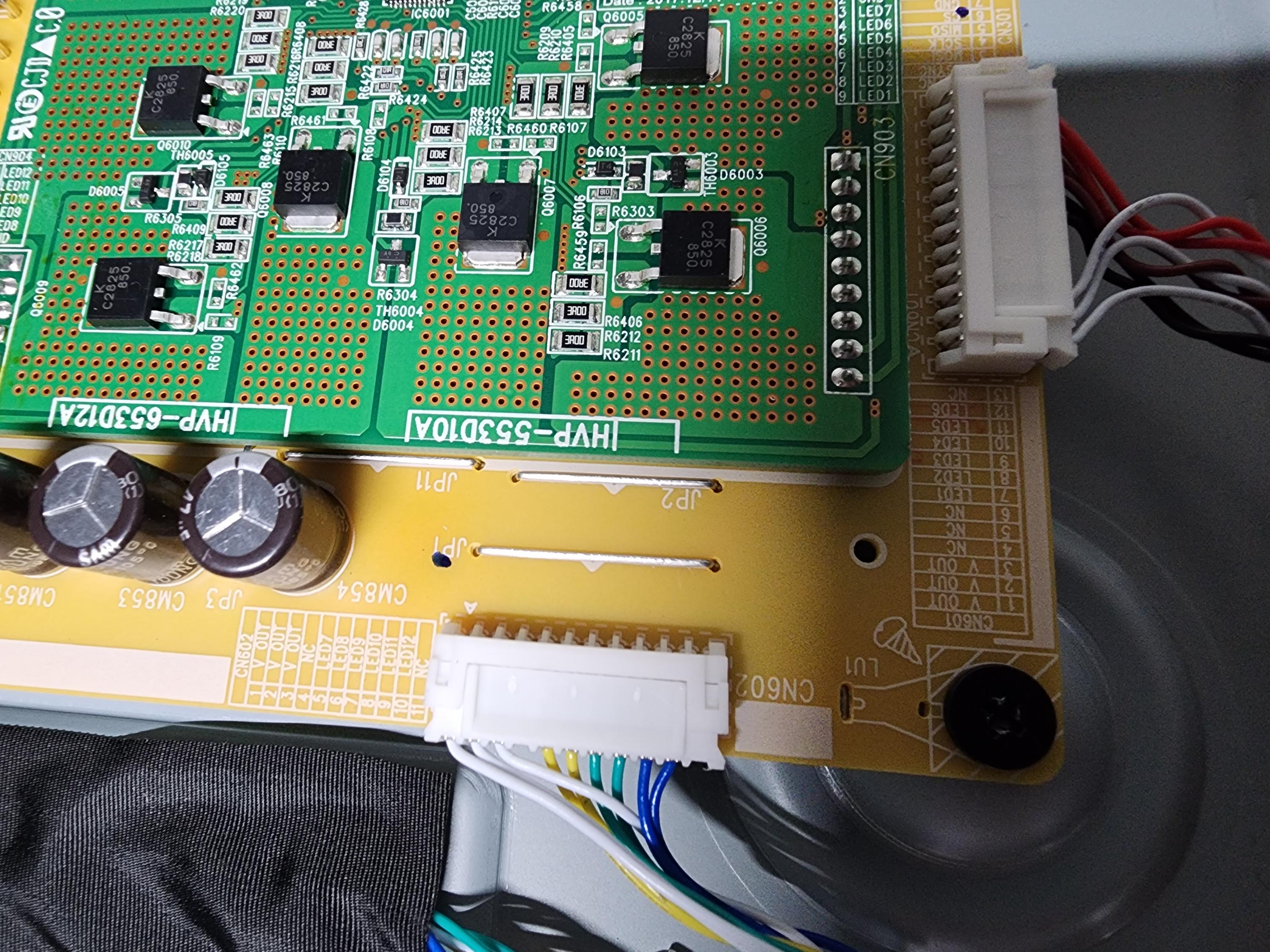

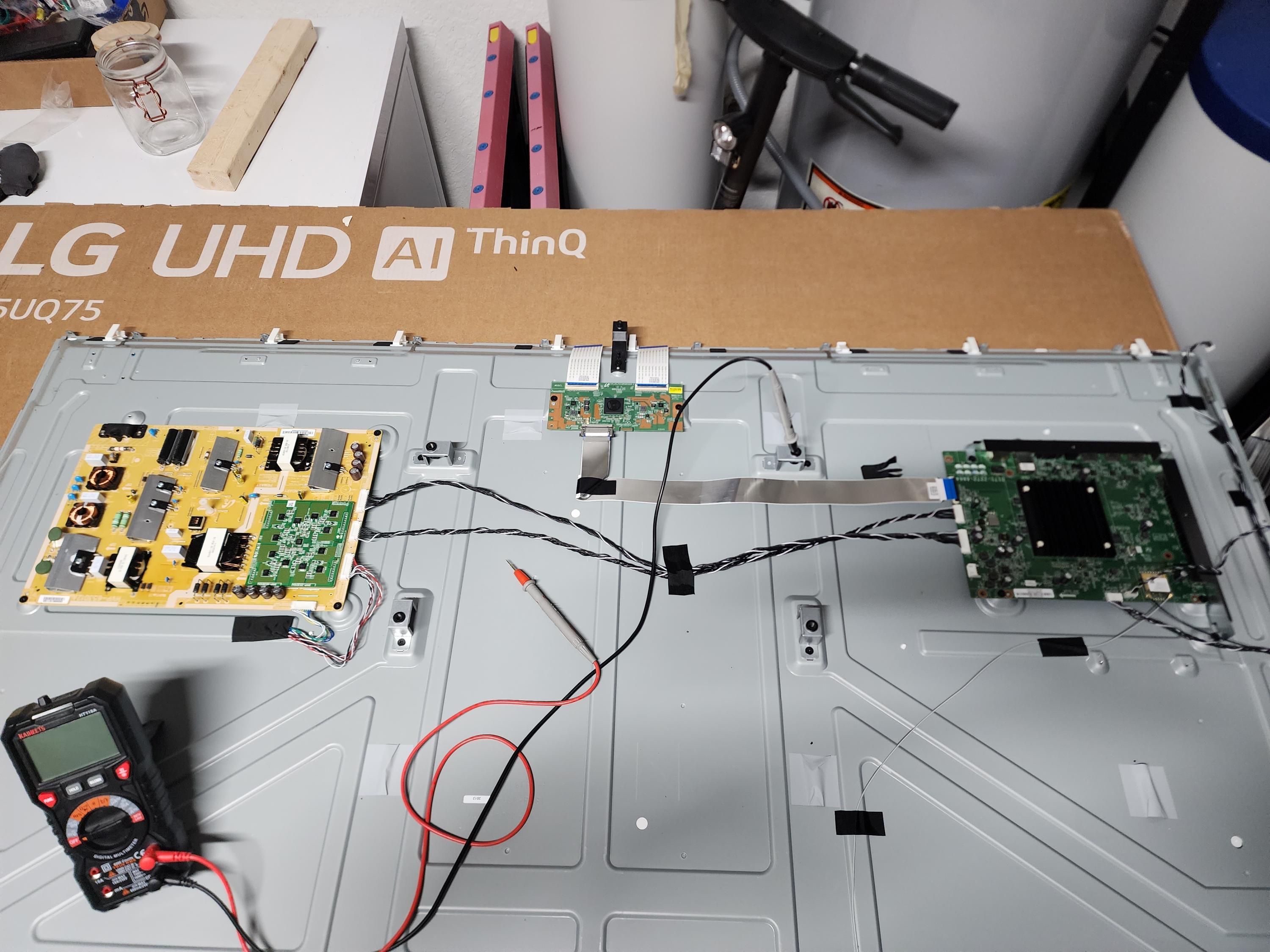

    So I turn TV on. TV has no backlight but has picture. I considered LEDs, either way some oddity and I pulled it down to the LEDs and all LEDs light up and aren't dead. So I have it down to LEDs and plugged in and can hit power button (no panel connected) and I get these voltages
    connector CN201
    pin 1 (18vsb1) = 18v
    2 (18vsb1) = 18v
    3 (18vsb2) = 18v
    4 (18vsb2) = 18v
    5 (GND)
    6 (GND)
    7 (GND)
    8 (GND)
    9 (ps on/off) = 3.3
    10 (bl on/off) = 3.3
    11 (NC)
    12 (NC)
    CN301
    1 (vsync) = .017
    2 (hsync) = 3.3
    3 (mosi) 0
    4 (sclk) .057
    5 (miso).036
    6 (cs) 3.3
    7 (GND)
    8 (fault) = .044 and fluctuating to .8and drops immediately. Every 1 sec
    9 (5v sw) = 4.975
    10 (GND)
    CN601
    1 (v out) = 36v
    2 (vout) = 36v
    3 (vout) = 36v
    4 (nc)
    5 (nc)
    6 (nc)
    7 (led 1) = 5v
    8 (led 2) = 5v
    9 (led 3) = 5v
    10 (led 4) = 5v
    11 (led 5) = 5v
    12 (led 6) = 5v
    13 (nc)
    CN602
    1 (v out) = 36v
    2 (vout) = 36v
    3 (vout) = 36v
    4 (nc)
    5 (led 7) = 5v
    6 (led 8) = 5v
    9 (led 9) = 5v
    7 (led 10) = 5v
    8 (led 11) = 5v
    9 (led 12) = 5v
    Is the fault fluctuating telling us something? I'm using ground as negative for LED voltages, maybe that's wrong. But backlights will NOT turn on.
    I need help backlights need to turn on. Any experience with this?

    Carefully measure the capacitors sitting sideways, a probe on each leg, what do you get it in standby and when powered on.
    • EazyBone
      • Jun 2023
      • 1351
      • United states
      Re: Vizio e65-f0 oddity
      I did, they read 389v both ways, for some reason I can't get the BL voltage to stay at 36 steady anymore
      So I noticed when I disconnect the main board, the one with fault from PB, fault goes to 3.3 and stays steady. When I plug it back in, that's when it goes from nothing, tries to jump up to 3.3 (I assume) and just drops back down. It keeps repeating this cycle continuously.
      Anyone know what this fault thing is? Maybe connected to this all?

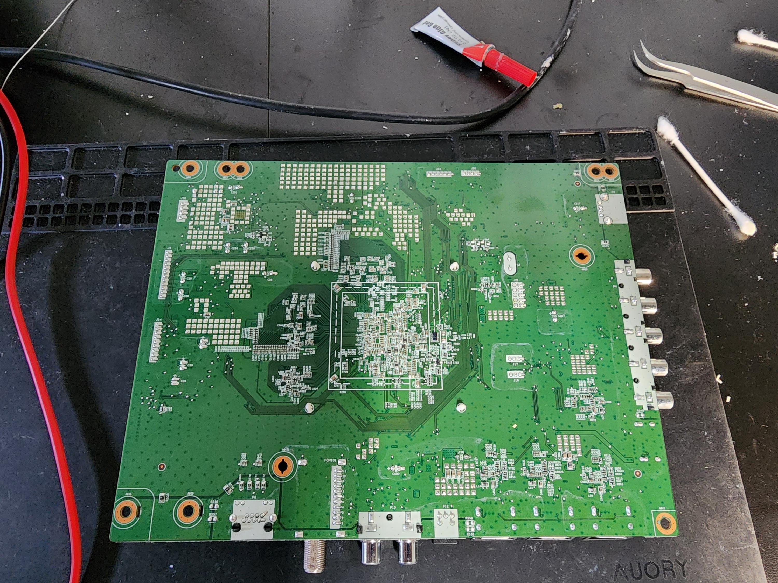

        I can only assume something odd is coming from the main board telling it not to turn on or something. Thoughts?
        • EazyBone
          • Jun 2023
          • 1351
          • United states

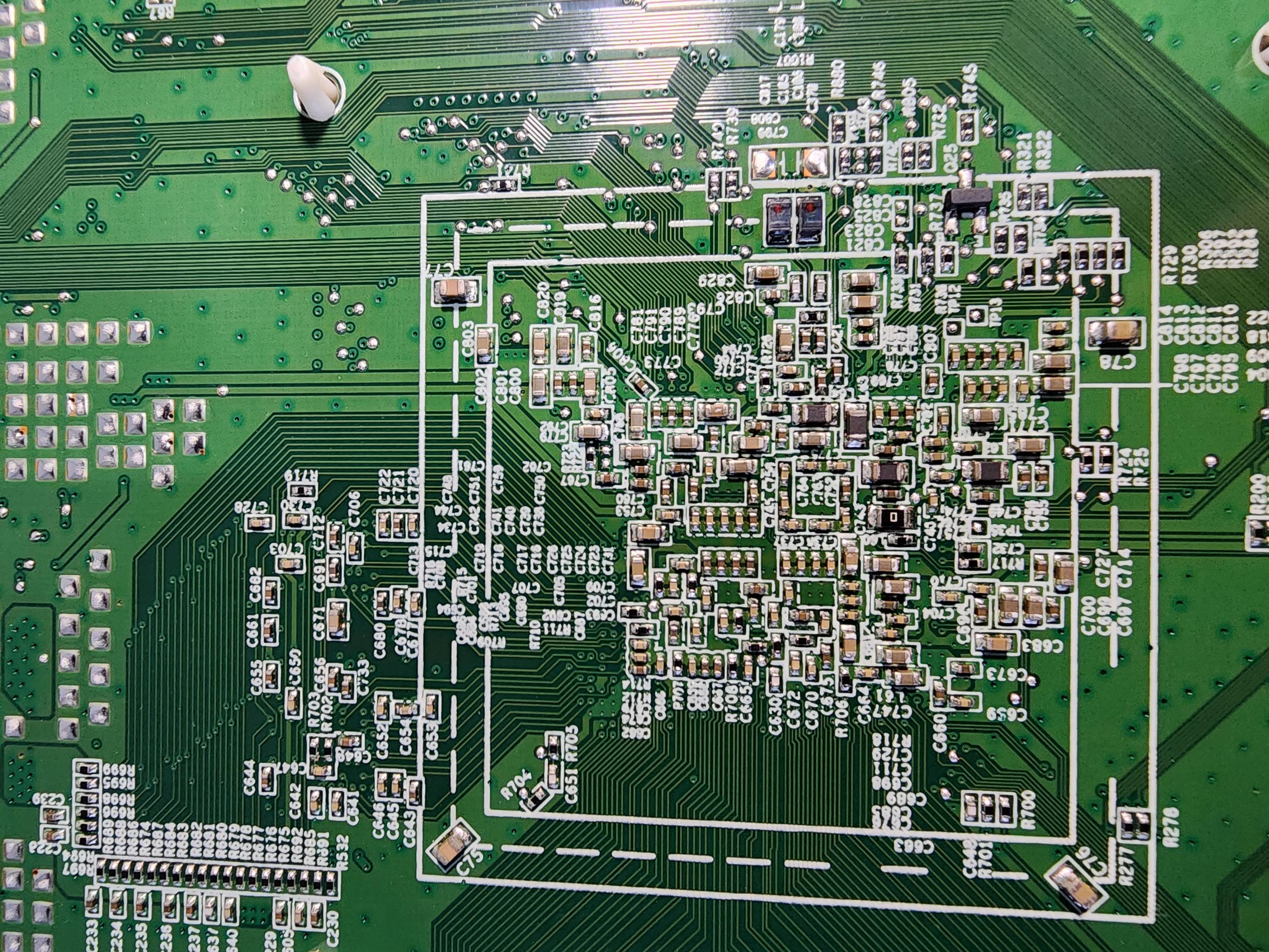

          All c76,75,78,77 caps read short.
          Would reflow or whatever on main chip handle this you think?
              000.1 or 000.2 all sides of each of them are short to ground also. I'm not expert here maybe that's how it's supposed to be

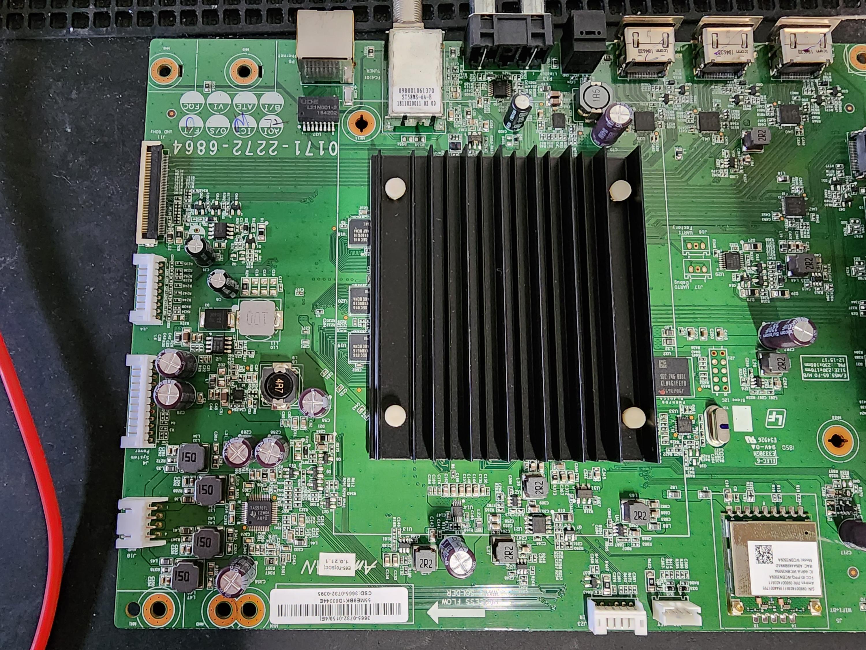

                Does anyone know what this fault thing is? Seems to be potential to the issue? Since it keeps fluctuating
                I've tried disconnecting the main board with this pin, and the power board keeps it at 3.3v along with cs
                I then pulled just that wire out the harness on pb side and plugged harness back in and it's fluctuating again. Something is sending a signal to it from MB I assume

                    Well where does that one faulty wire lead to on the mainboard, can you trace it and see what component/s it leads to/thru.
                    • EazyBone
                      • Jun 2023
                      • 1351
                      • United states
                      You ask the tough questions lol. I don't know yet lol I'll look and try take pictures. Do those short caps indicate something maybe?

                            On those caps reading short, how are you measuring, if you have your neg. probe on ground prolly only one side should show continuity/test as short.
                            • nomoresonys
                              • Jan 2013
                              • 12212
                              • U.S.
                              Lots of times when several read short it can be the ic closest to it that's the problem.
                                I measured one side neg one side red. Then I stuck new on a ground screw hole and measure each side. All 4 caps read grounded on both sides

                                  Sure seems like a short.

                                    I'll have to bust out my short killer, never got it to help yet. We will see soon!
                                    The thing is though, I turn TV on and I get a picture. So I'm skeptical lol, but no BL won't turn on

                                      Ok, no backlights then, take the cable CN201 off from powerboard to mainboard on powerboard side and measure those connector
                                      pins again on the powerboard.

                                        Tried that, they all become 3.3v lower. So 14.7, 14.7, none for bl on or PSON. I did check that, all voltages look normal. I'll still look through this motherboard here tonight.
