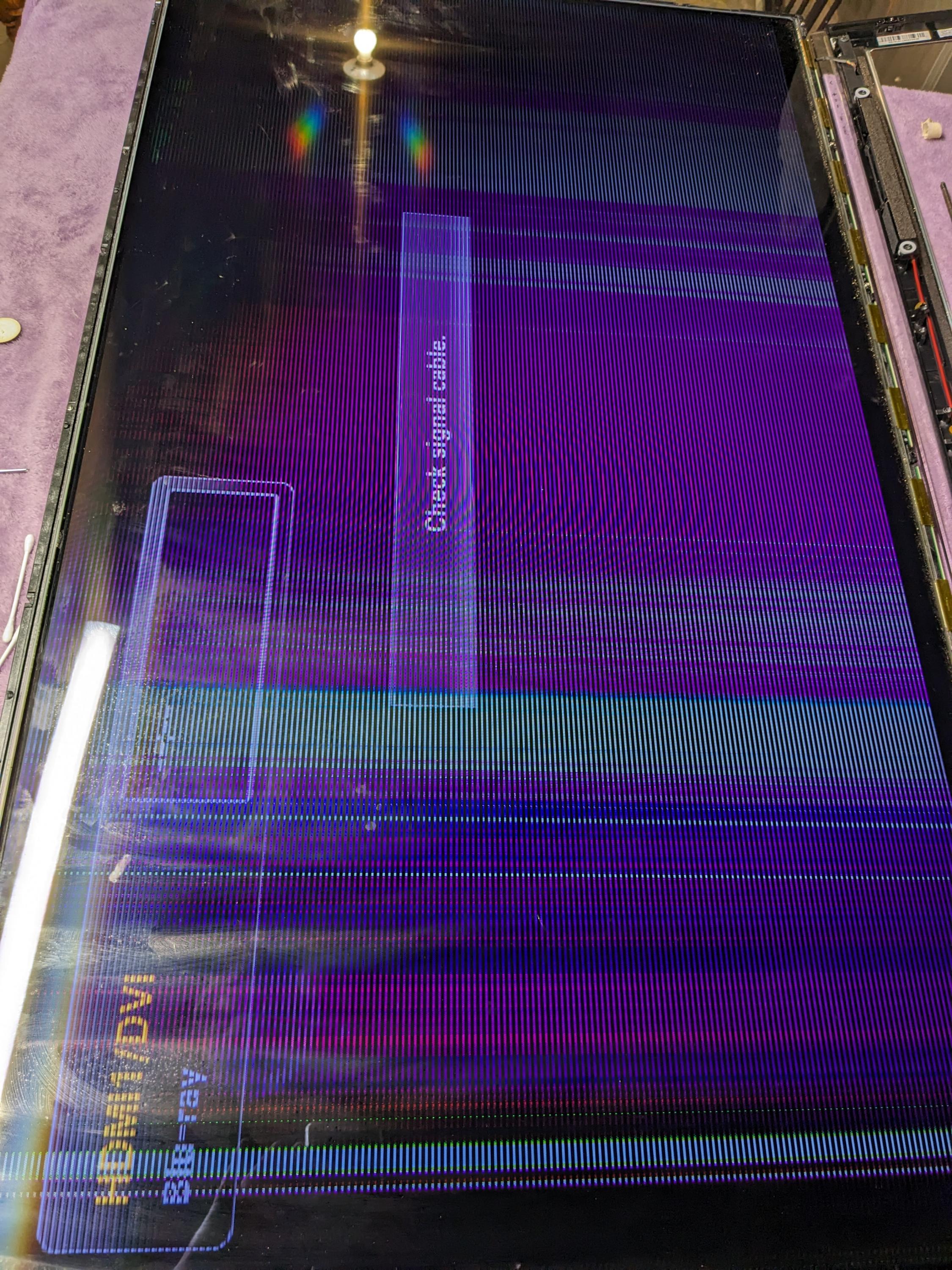

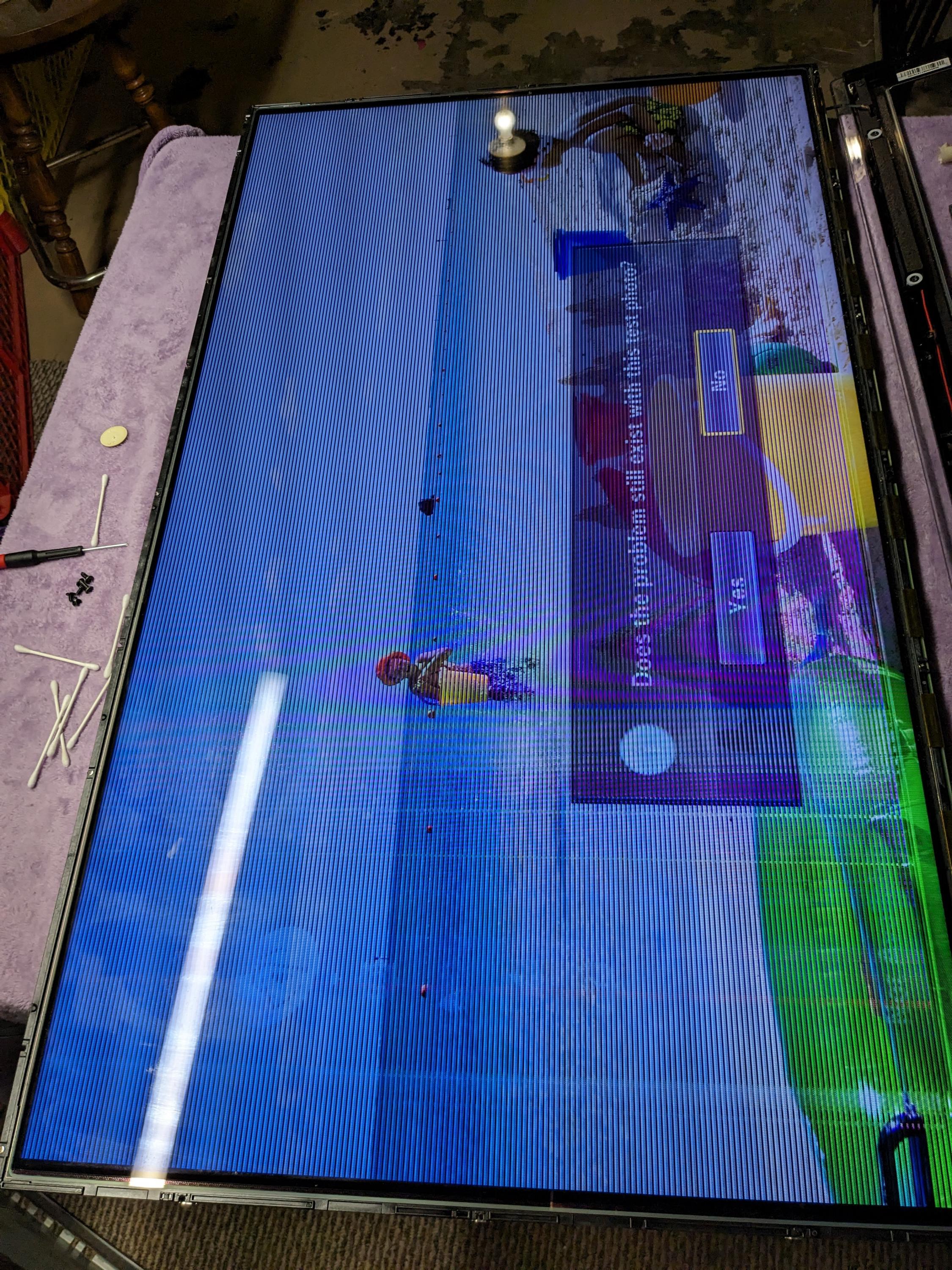

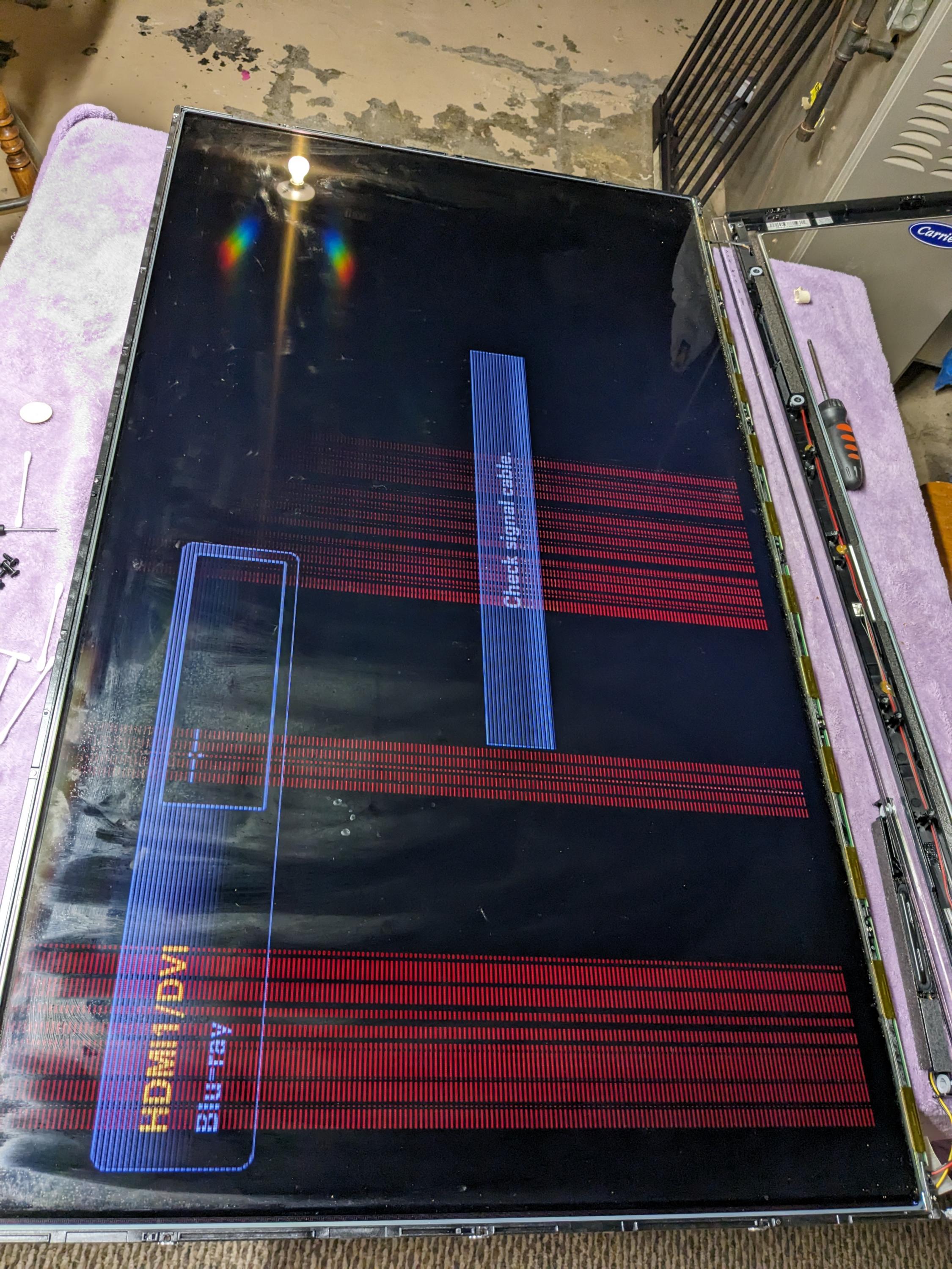

    I posted about this previously but didn't get any response, and I have some troubleshooted a bit so I have more info.
    The screen is full of horizontal "gaps" or lines that distort the picture badly, and after about 10 seconds of powering it on the screen starts to fill with red vertical bars that take on the horizontal pattern. After the screen filled with the red bars, they instantly vanished and then slowly started to reappear. I initially thought it was tab bonding failure, but after getting down to them and pressing each one I find zero change in the picture. I went into settings and turn on the diagnostic image you can see attached.

          It looks like the panel is at fault some how to me. There is a black band at the bottom of the screen in pics 1 and 2 and in the test image pic 3 that part is a good picture with a bright line above it.

            i did not notice it, that tells is almost 90% panel fault..

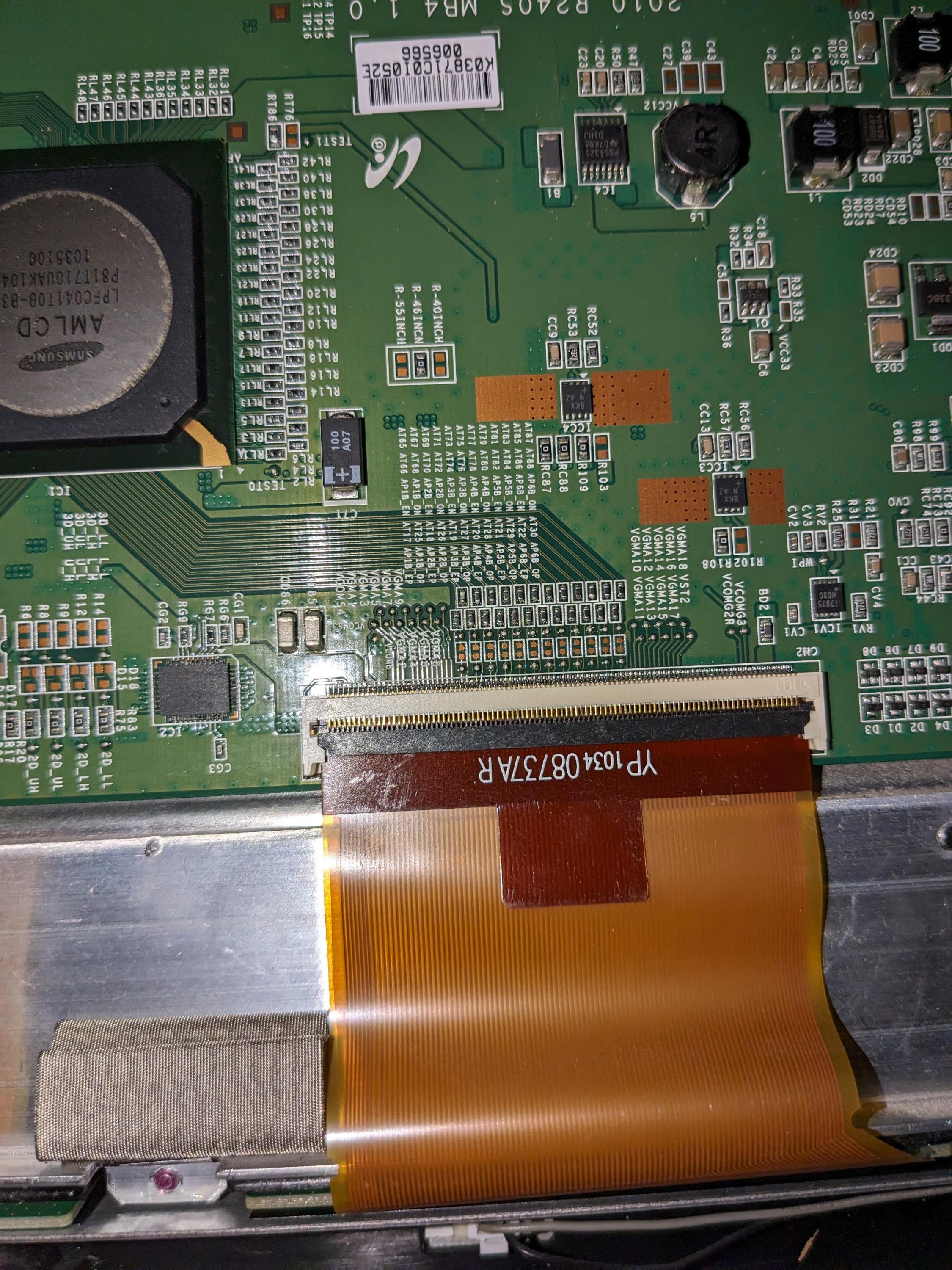

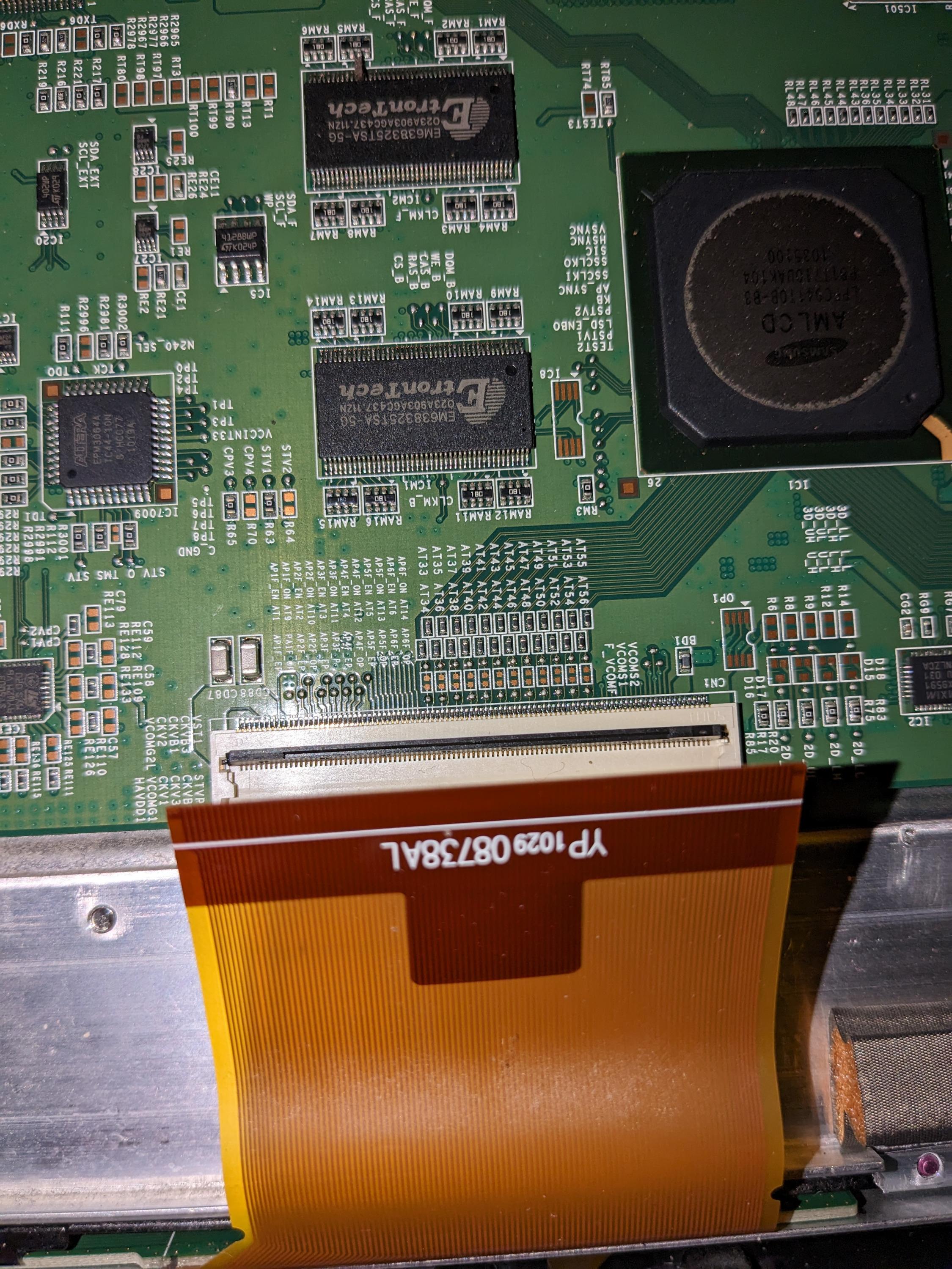

                    I'd like to attempt to do this if anyone can help me understand which pins i should and should not cover:
                    https://m.youtube.com/watch?v=kUWapOBtm0Y
                    (Skip to 1:15)
                    I have attached up close photos of my connectors. I don't see any traces going BETWEEN the two connectors, but maybe I'm misunderstanding him.

                      Re: Samsung UN46C8000XFXZA vertical bars/horizontal lines
                      You are out of the road, the defect is not the same..
                      i can guide you to search for the abnormality i was talkin about, i need close up photo of the ic i mentioned, if you have scope or frequency meter

                                  Can you post good clear pictures of your panel driver boards, might help to see what all is on those.
