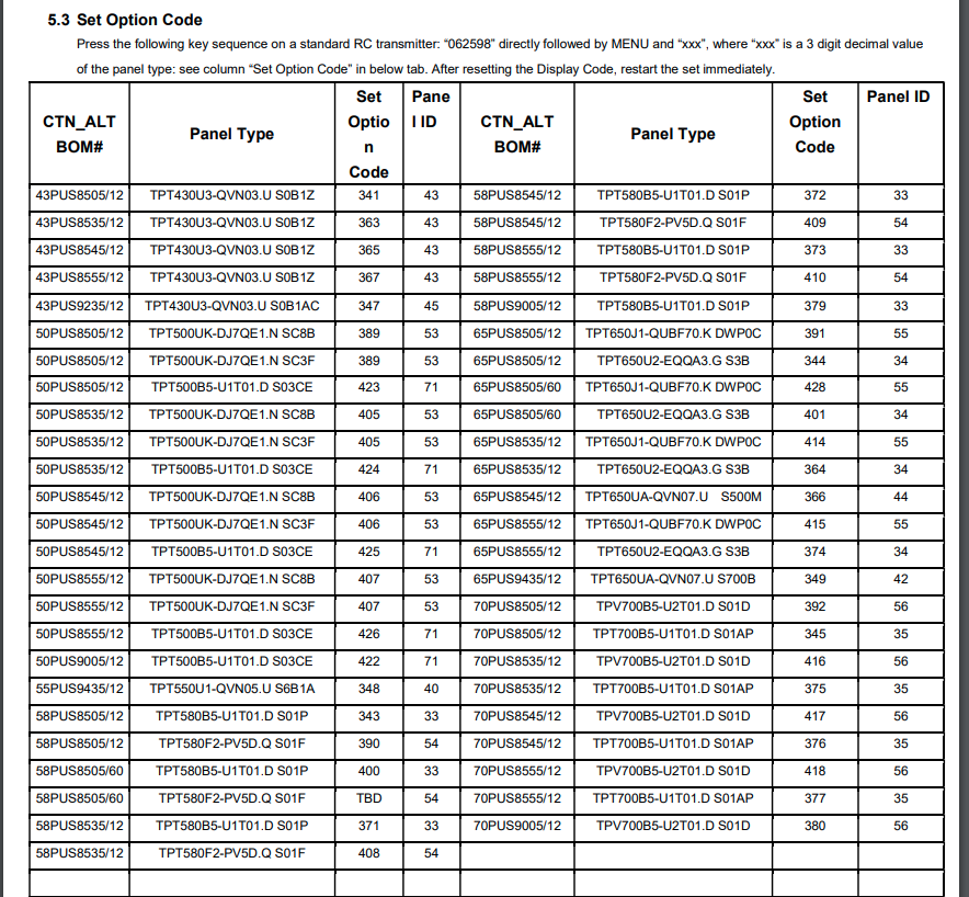

    as title says, I'm trying to hunt down a working t-con for philips 58pus8555/12, seems like new or used working t-cons for this model are non existent. If anyone has any idea where I could buy one I would appreciate it.

      Do you happen to know if 7505 or 8505 boards compatible with the 8555? They looks the same visually but I'm not too sure.
      the serial no. on the boards seems the same (CCPD-TC575-009 V1.0) but maybe firmware is different?

        Under your panel (matrix), enter your three-digit code, if anything.

          Good info, thank you
