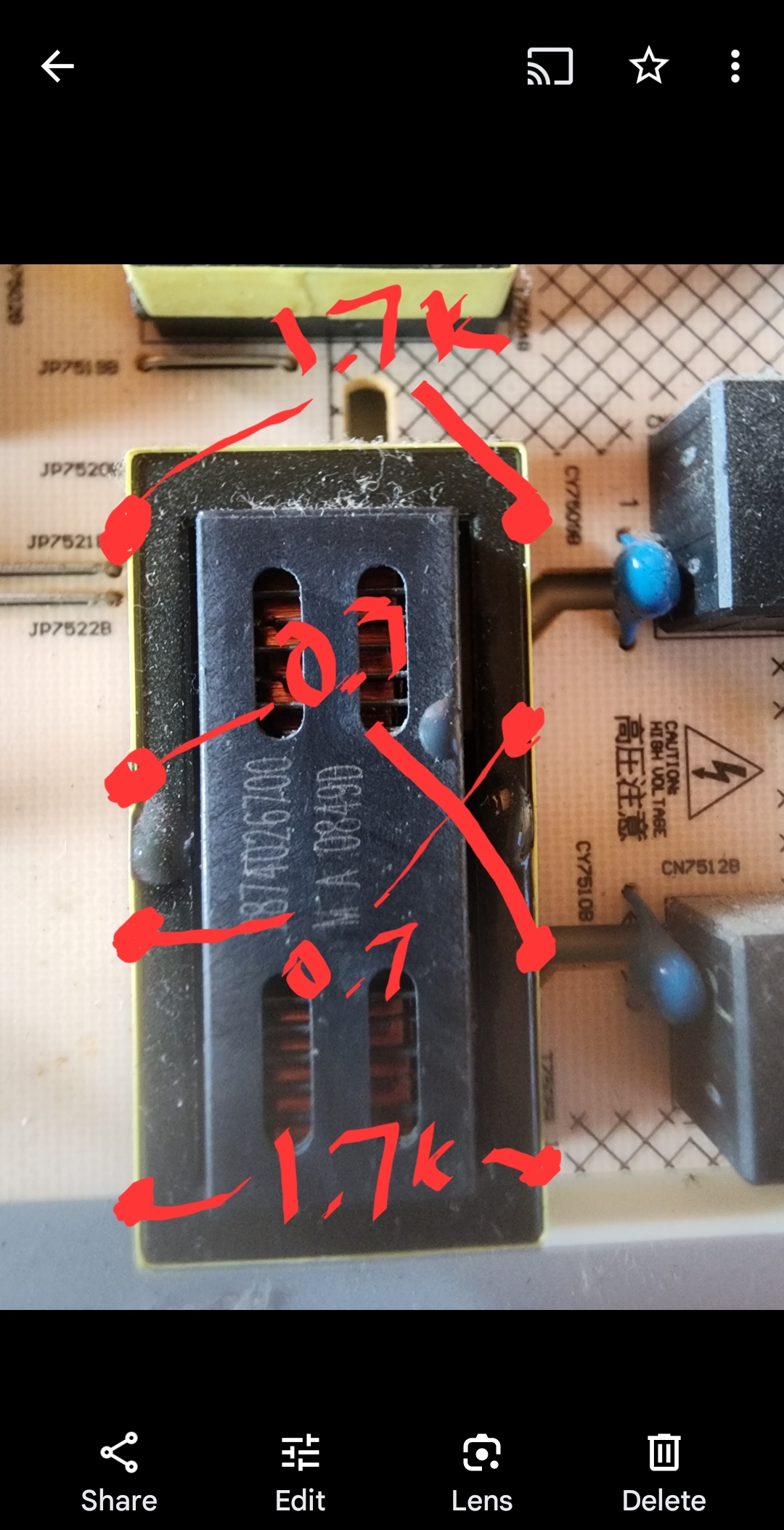

                      The first thing I would check are the transformers, The transformer has two secondary's so check the resistance of each winding, they are usually around 1000Ω so check each transformer and see if one of the readings is not like the others.
                        #51
                        Re: Sharp LC-C4655U Flashing OPC and Power lights.
                        I think I'm checking these right? didn't find a diagram in service manual. Look at picture to see if I'm doing right. If so I'm getting consistent readings on all of them.

                          If I remember this should be the secondaries
                            #53
                            No that doesn't work. Here is the only thing I could find on the transformers.

                              The original way you checked the transformers is the correct way so I suspect they are ok. On these inverters, transformer failure is common, but so is having a bad ccfl in the panel, or even bad connections between the ccfl tubes and there sockets can cause a problem.

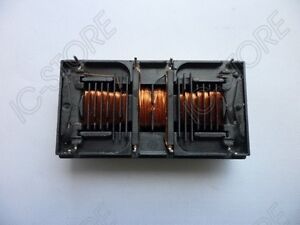

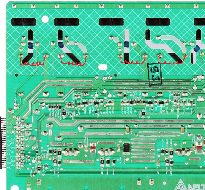

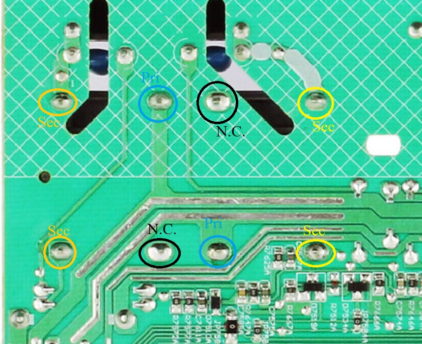

                                  Remove one of the transformers so you can see and check the windings, with it removed there will be nothing else effecting the readings, sometimes transformer pins are just used for mounting and are not connected to a winding.
                                  If all the transformers checked the same I suspect they are all ok, 1.7k seems fine, if one was 1.5k or something like that I would suspect it was bad.
                                  I suspect it is like this picture
