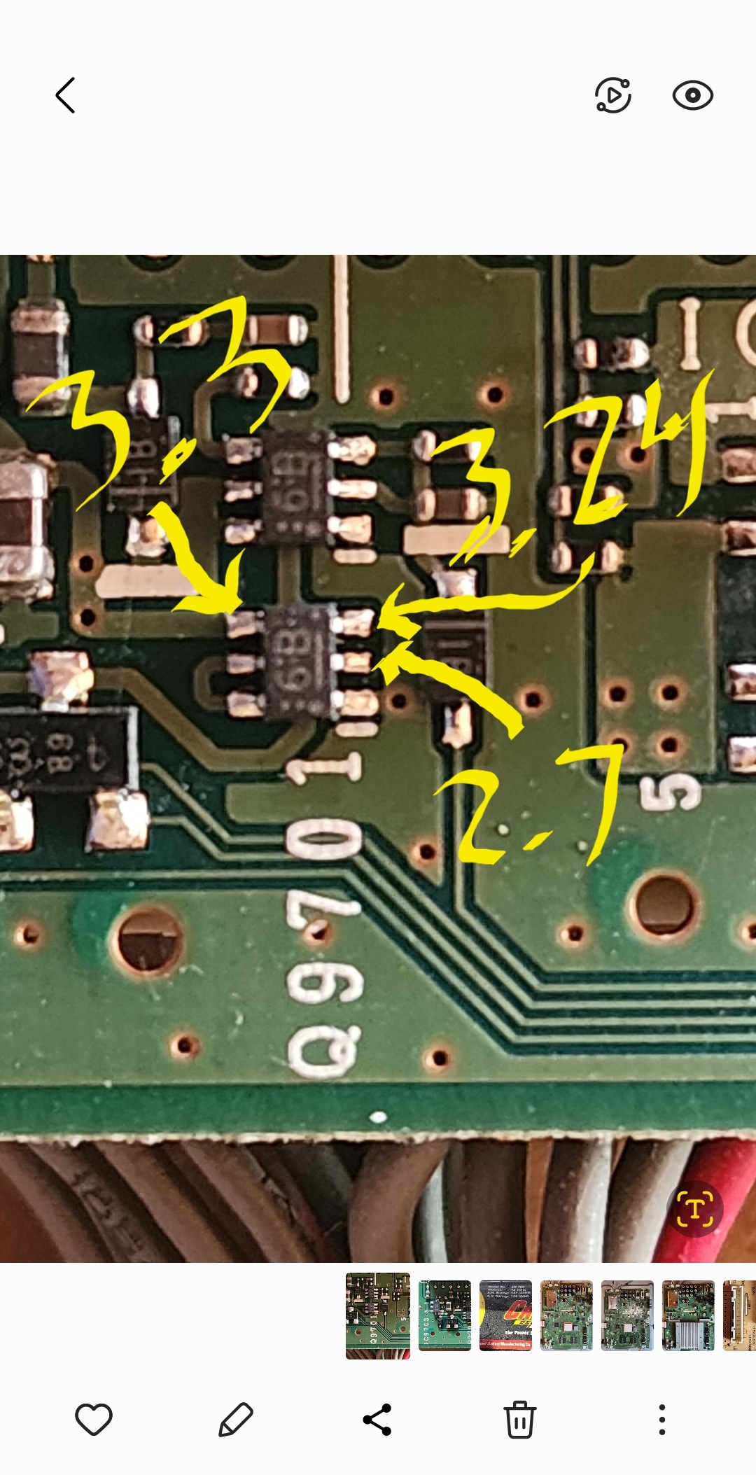

    Q9701 has 3.3 on pin 4
    Pin 3 has 3.3. only if I start the tV with channeldown/volup
    Pin 2 acts the same but 2.7V
    Looks like I need to flip the board to check those fuses? Of note, I only get power to the inverter board if I have that jumper to PS_ON. Need to go to bed.
    Let me know what to check next. Thank you so much for your help! Learning a lot.
    -Mike

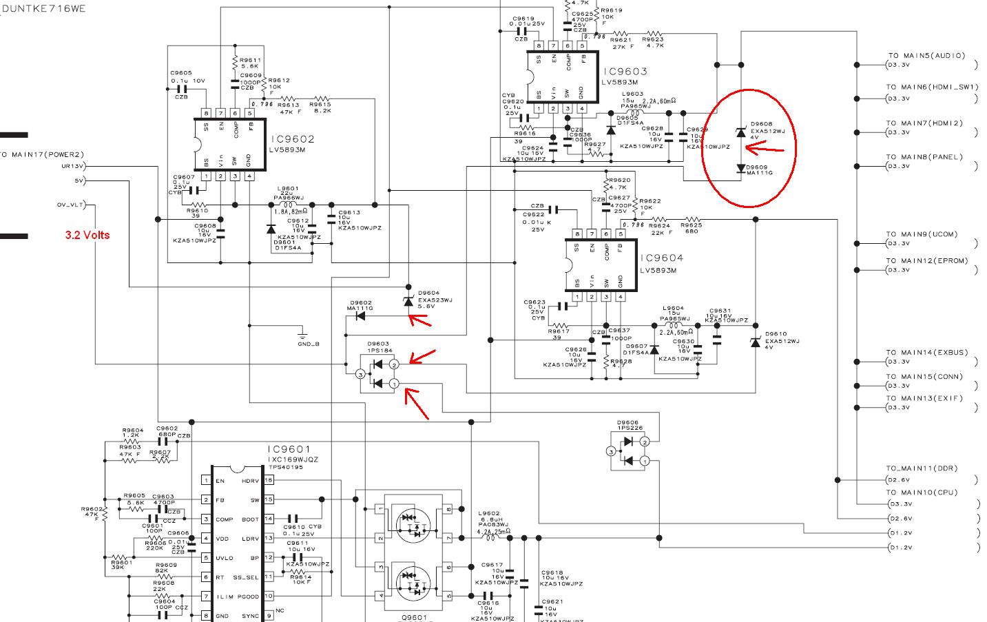

                          Re: Sharp LC-C4655U Flashing OPC and Power lights.

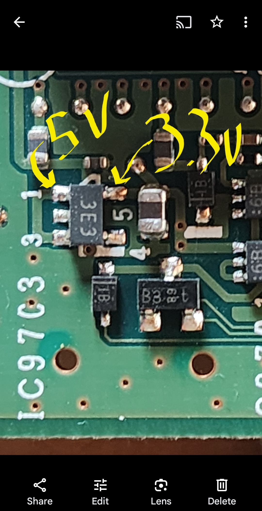

                          If D9702 has 3.2v then there is a problem with one of the regulater voltages on the main board
                          Of note the .7 is before and after the resistor.
                          This must be when you are not using the CH-/vol+ to turn the tv on because in post #21 you had 3,3v on Q9701 pin3 which is directly connected to R9705
                          To find out why there is 3.3v on OV_VLT I would check the points I placed arrows, I do suspect (circled) If D9608 shorted it would provide the D3.3v to the OV_VLT line OR one of those voltages is too high and causing its zener to conduct.
                          • berrmich
                            • Aug 2023
                            • 30
                            #33
                            Just checked again with CH/Vol. Yes your absolutely right. 3.3 on one side and 0.7 on the other. Sorry about that.
                            What's next?

                                    Now do the testing to see where that 3.3v is coming from.
                                    • berrmich
                                      • Aug 2023
                                      • 30
                                      #38
                                      Gotcha. I completely missed that you posted a picture in #32.

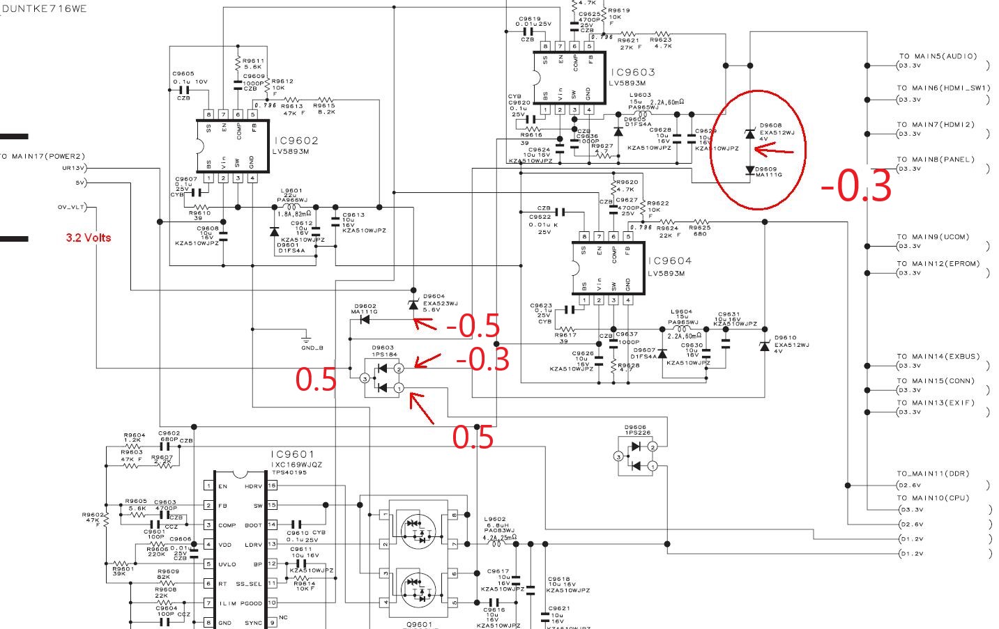

                                        #39
                                        Here is what I got. Pin 3 on D9603 is 0.5v ?
                                        I checked pin 2 on Q9702 and D9702 and it still shows 3.2V.
                                        • R_J
                                          • Jun 2012
                                          • 9535
                                          #40
                                          So the anode of D9702 must be .5v and the cathode is 3.3v? I wonder if D9701 is leaky, Can you remove D9701 and see if you get PS_ON 3.3v?
