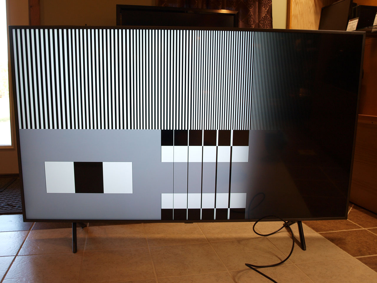

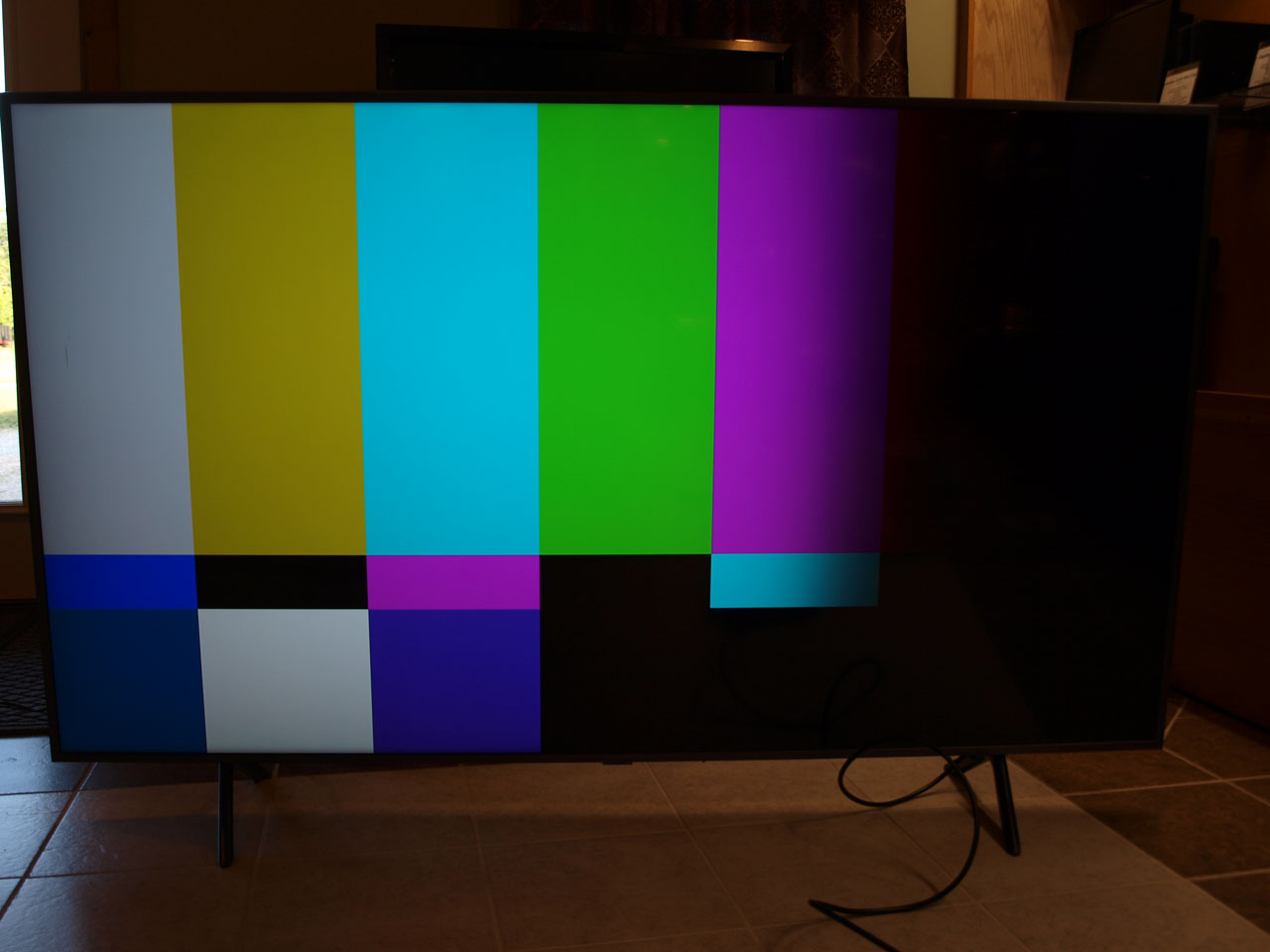

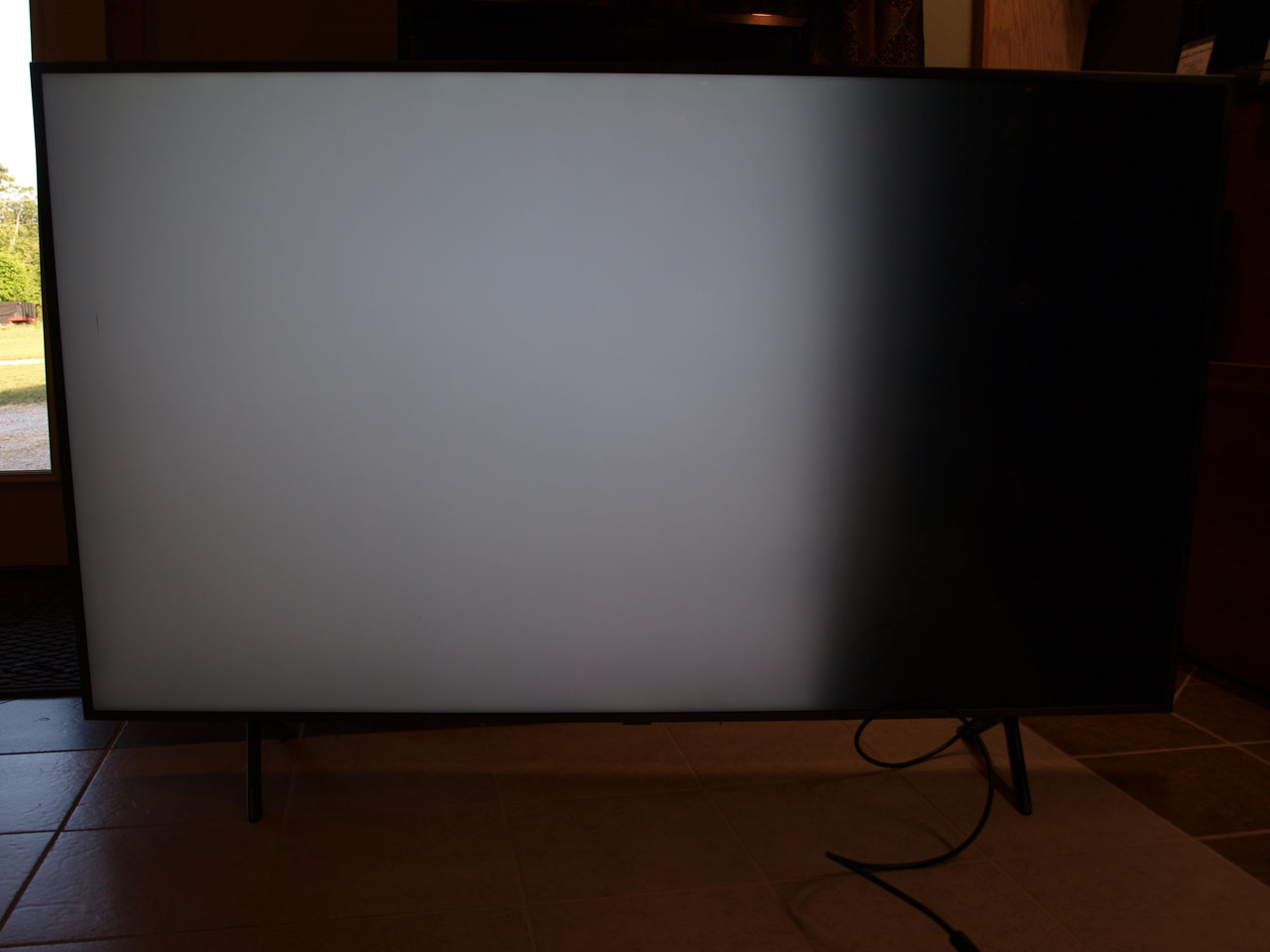

Samsung UN75RU7200FXZA - Right 1/3 Portion of Screen Dark
  • Topcat
    The Boss Stooge
    • Oct 2003
    • 16959
    Set from 2019.....sad this is all they last anymore. Ok, obviously a backlight problem. From what I understand there are 3 strips in these, mounted vertically....one seems to be bad. The image is present behind the darkness, not a LVDS or TCON issue.
    This TV is a beast. I can't even manhandle it by myself, let alone try and lift the screen out to restrip it.....but I haven't even gotten this far yet....I can't seem to find strips for it.
    I found a set for the UN75RU7100FXZA but not the 7200.
    https://www.shopjimmy.com/samsung-bn...strips-bars-3/
    Knowing samsung, they're not interchangeable.... I never thought I'd see the day I'd scrap a 75" TV over something so trivial....but without parts, it's scrap.... Any insight as to whether the above strips would be compatible? If not, anyone know of someplace that may have them?

    Re: Samsung UN75RU7200FXZA - Right 1/3 Portion of Screen Dark
    It is possible that there is a bad connection on the led section, bad connection on one led on the strip or maybe one led only is defective, just a guess.
        • ducky29
          • Dec 2015
          • 369
          • Europe
          Yes those strips are compatible but there are cheaper alternatives if you search on Ali.
          Also check the light sheet guide if its damaged or not.
          You should replace them both in case its damaged.
            Just did one of these. There’s 3 strips total so need to replace all 3. As Ducky29 mentioned, I would open it up before ordering to confirm the diffuser isn’t cracked. A lot of times they melt/ crack on these models when the backlights go out. If you do replace the lights make sure to turn the backlight down as much as possible to prevent this from happening again

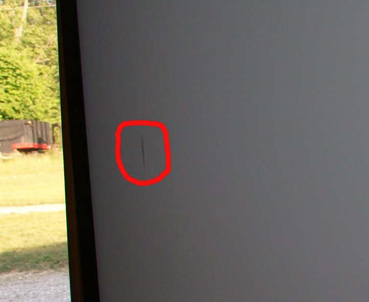

                Thanks for the info. I have not taken this apart, I'll have to get an extra set of hands for this one, its just too girthy for one guy unless you have a 7ft arm span...
                FWIW, it did have a mild abrasion on the screen that would not rub out with simple cleaners.
                I used some nifty stuff called Novus. This took it out to the point I can't even tell where it was. Perfect restoration; can't be seen with the screen on or off. I'll post an after pic when I have a little time. ON a matte screen, it will leave a shiny spot....but on a shiny screen, it disappears completely. No marks at all.
                  you don't have faulty LED.. its issue with strips socket..
                  RU strips are 4 in total each build from 3 pieces clipped together via easy metals pin plug in if the panel / chassis get wrong mounted or forced to be curve shape as it its thin design the clips will get losses.
                  you have the left side all dark.. mean one line of this contact got lost
