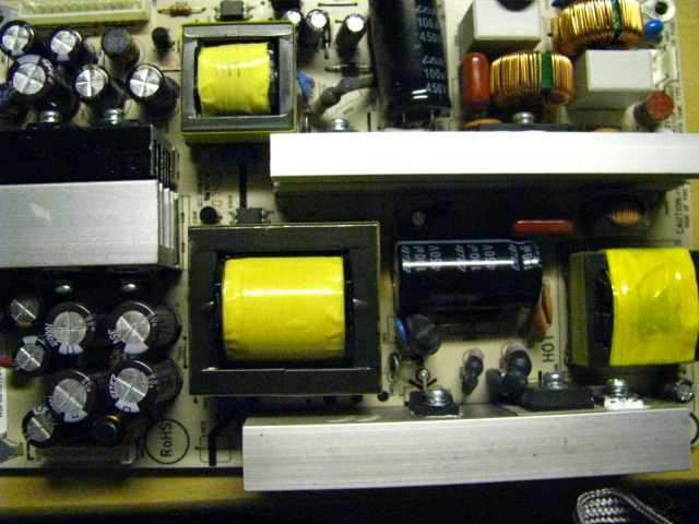

    I'm working on an RCA L32WD22.
    The front panel LED is yellow in standby, when you press the power button the LED flashes. No codes as far as I can tell just a constant flash.
    Power supply outputs:
    5v is only 3.4v
    12v 15v and 24v are all ok.
    If I hold down the power button for abut 10 seconds, the 5v comes up to about 4.5 the led gets brighter, then turns green, and 5v goes back down to 3.4v. No other signs of life (no backlight flicker, no noise from speakers)
    If I disconnect the main board from the power supply, and leave the inverter plugged in, the 5v is 4.9ish. So either the supply is weak, or something on the mainboard is bad and loading it down. Will load test the 5v line later.
    Visually nothing too amiss, though someone has done some poor soldering on the power supply, particularly the caps on the 5v output.
    Caps are crap Elite brand so automatically suspect, just not sure if I want to throw caps at it if it winds up being an unrepairable mainboard like the last LCD TV I worked on.
    More later.

    Re: RCA L32WD22 TV dead
    Patch in a good 5v supply.
    • Wizard
      • Mar 2008
      • 2296
      This power supply tend to have elite caps that does not bloat for at least some of them.
      Also change all small capacitors in hot side section. Inspect the 5V regulator feedback circuit and the components for 5V standby supply. You may will find none or find one or two that is leaky or off value. Need multimeter. This is advanced job to trouble shoot.
      Cheers, Wizard
      • kc8adu
        • Nov 2003
        • 8832
        • U.S.A!
        that 5v section runs hot.the caps are baked.see the darkened board under those caps?
        had 12 of those sets given to me.caps and solder joints fixed all.

            Finally got to it tonight.
            2 Lelon 1000uf/16v caps that looked fine on the top, had pushed out bungs on the bottom, and measured quite bad.
            Replaced those, and a few others, some solder touch-ups, and it's good to go.

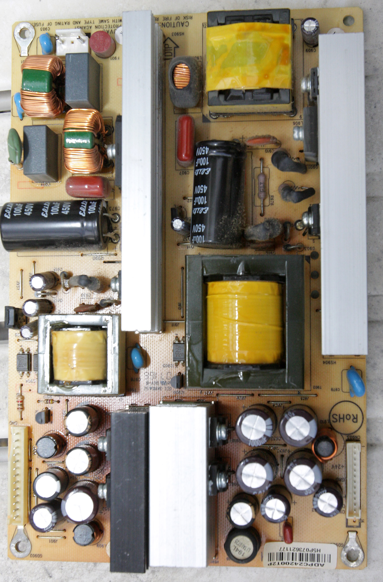

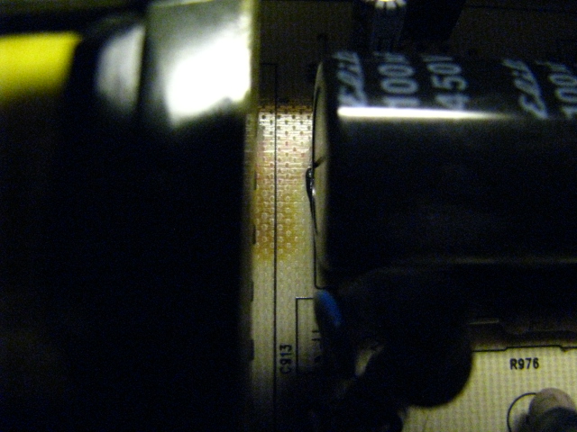

                    Sorry to resurrect a dead thread, but I figure it's better than starting a new one on the same tv. Mine has an issue where the video just cuts out, but I still get sound.
                    I pulled the power board so far and see that there is a very bad scorch mark "above" the 450v elite cap on the left, and some of the little chips on the other side also have scorch marks around them. Finally, there is a plastic guard that the board sits on that seems to be a little bit melted directly under that cap.
                    Knowing that, would it be possible to still work with this board? I can replace the capacitors, but It's a lot of work if the board is trashed. I attached pictures, sorry their kind of blurry, but it's the best I can do so far.
                      Sidney You need better pictures or higher resolution, I'd suggest to start a new thread so as to lesson confusion with the people trying to help you out. I still have yet to finish mine as well, I put it aside for other projects I'm working on. I think my problem is I didn't get low ESR caps to replace with.
