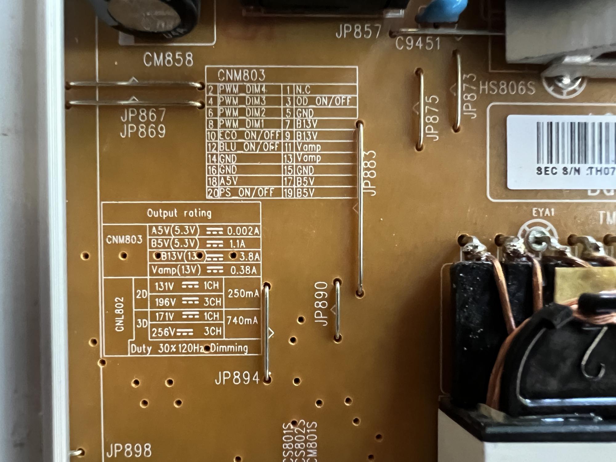

    Update: Replaced ICM801CS with FSFR2100XSL. Board flashes backlight now while standby light turns on and off.
    Voltages: while main board plugged in
    Pins 7 and 9 (B13v)goes upto 11v then goes down with the backlight flashing
    Pin 17 and 19 (B5v)goes upto 5.3v then goes down with the backlight flashing
    Pin 20 (PS on/off)goes upto 3.3v then goes down with the backlight flashing
    Pin 18 (A5v)has constant 5.38v
    I am wondering what else may be wrong. Any help please.
    ICM801CS heat sink getting to 55c

      Re: L65X1Q_DHS / BN44-00627A Samsung UN65F6400AF Standby blinks twice five times
      Ok, now try it with the cable from powerboard to mainboard unhooked, see if backlights come on steady and stay on.

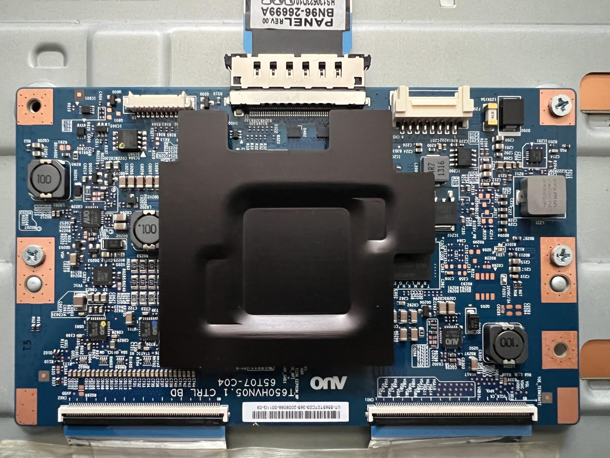

        Yes. With main board disconnected backlight stays on
          Ok, now do the test with one cable at a time unhooked from tcon to panel, then try turning on tv, see if you get a display or what happens, best policy is have tv unplugged from power whenever unhooking or hooking cables, so you don't get any errant surges or such.
            my POST #10
            try to slide out the 2 wires of B13V from the socket of pins 7&9 at PSU side, then plug the tv in wall and see if it boot complete and BL stay on. they are for sound and t-CON. if the issue same bootloop... pput them back and remove B5V wire and try
              When I take out both(B13v)s (with B5v on)and try it still cycles but the BL does not flash. When I take out the (B5v)s leads(with B13 on)it goes back to doing the original standby flashing twice 5 times over and over but the BL flashes. I didn’t get to disconnecting the tcon cables one by one as that would mean that I have to take this giant tv and lay it flat. Probably do it tomorrow morning. Thank you Diah and nomoresonys.
                Ok. Tested with either cable and both cables disconnected from the t on board to the panel and symptoms are the same cycling and flashing the BL. Does this mean fault in PSI or main board or tcon board?
                  Originally posted by Diah
                  in this case.. u need to check pin A5V if its stable
                  if stable mean pin 20 power on caused by Main boards didn't boot ( boot loop)
                  if its not stable then the issue at PSU
                  So measure A5v shows constant 5.3v does this mean main board fault?

                      #30
                      A5V are the STBY. so there are 2 scenario of fault
                      1- one Opto coupling which switch PS on are fault/ not stable so the circuit power on off you need to follow PS ON/ OFF pin to know which Opto and test..
                      2- boot loop on MB
                      to be more sure you need to test the power supply complete as stand alone ... when all pins output on the socket correct value and stable include the pins Vamp 13V. at this stage if every things fine then the MB are in boot loop.
                      BTW use 1K ohm R with testing when you bridge A5V to any other ON/OFF pins.

                        #31
                        2- boot loop on MB
                        Ok did the above with 1k Resistor jumped from A5v to each on/off pin results in B13v at 8.04v and B5v at 4.49v will check opto couple next

                          #32
                          yours PSU had not enough juice ../ weak . BTW you didn't write any things about pns Vamp 13V... so you need to work on the PSU include to measure all CAPs MSR

                                #35
                                The Vamp pins 11 and 13 are at 8.04v
                                Caps cs801 at 387v cp803/cp804/cp805 at 387v
                                On the cold side caps c9454/c9354 at 191v but c9154 fluctuating between 126v-115v and c9254 fluctuating 190v-160v happens between screen BL flashes bright then goes back to regular brightness
