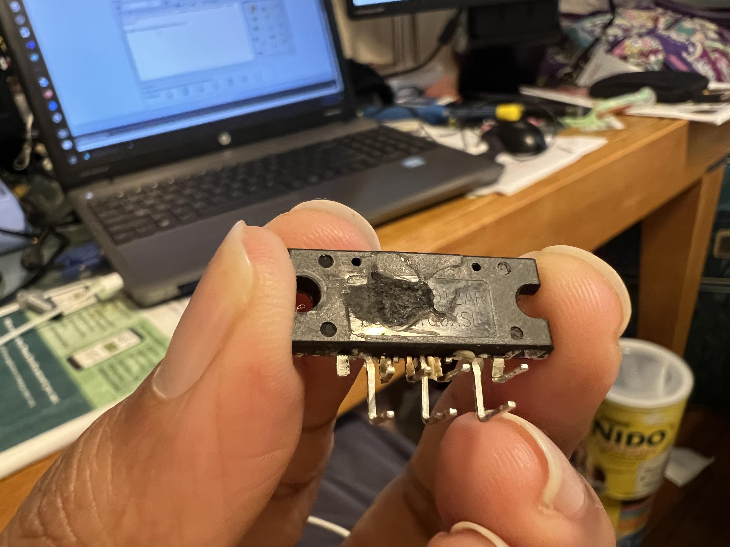

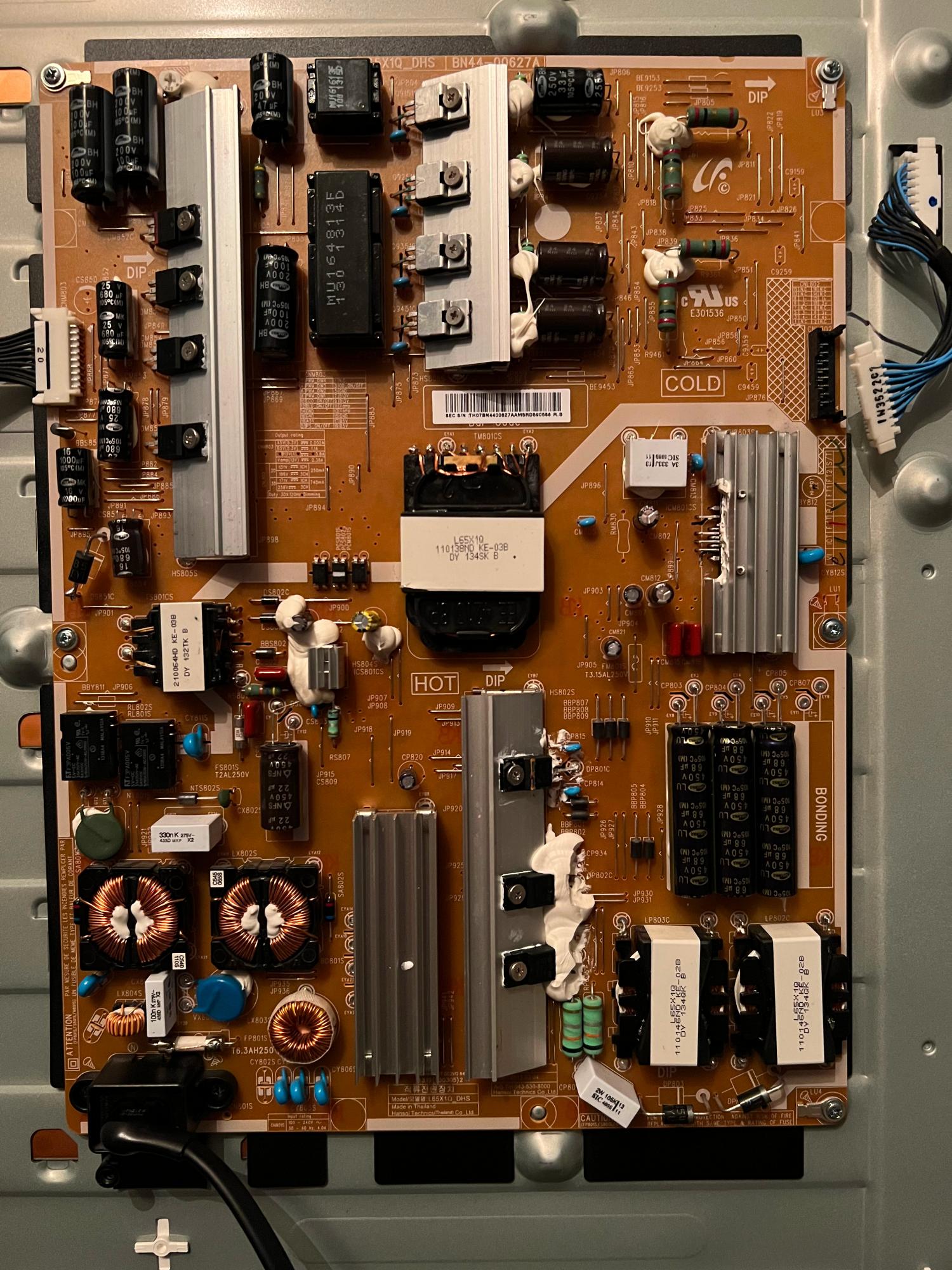

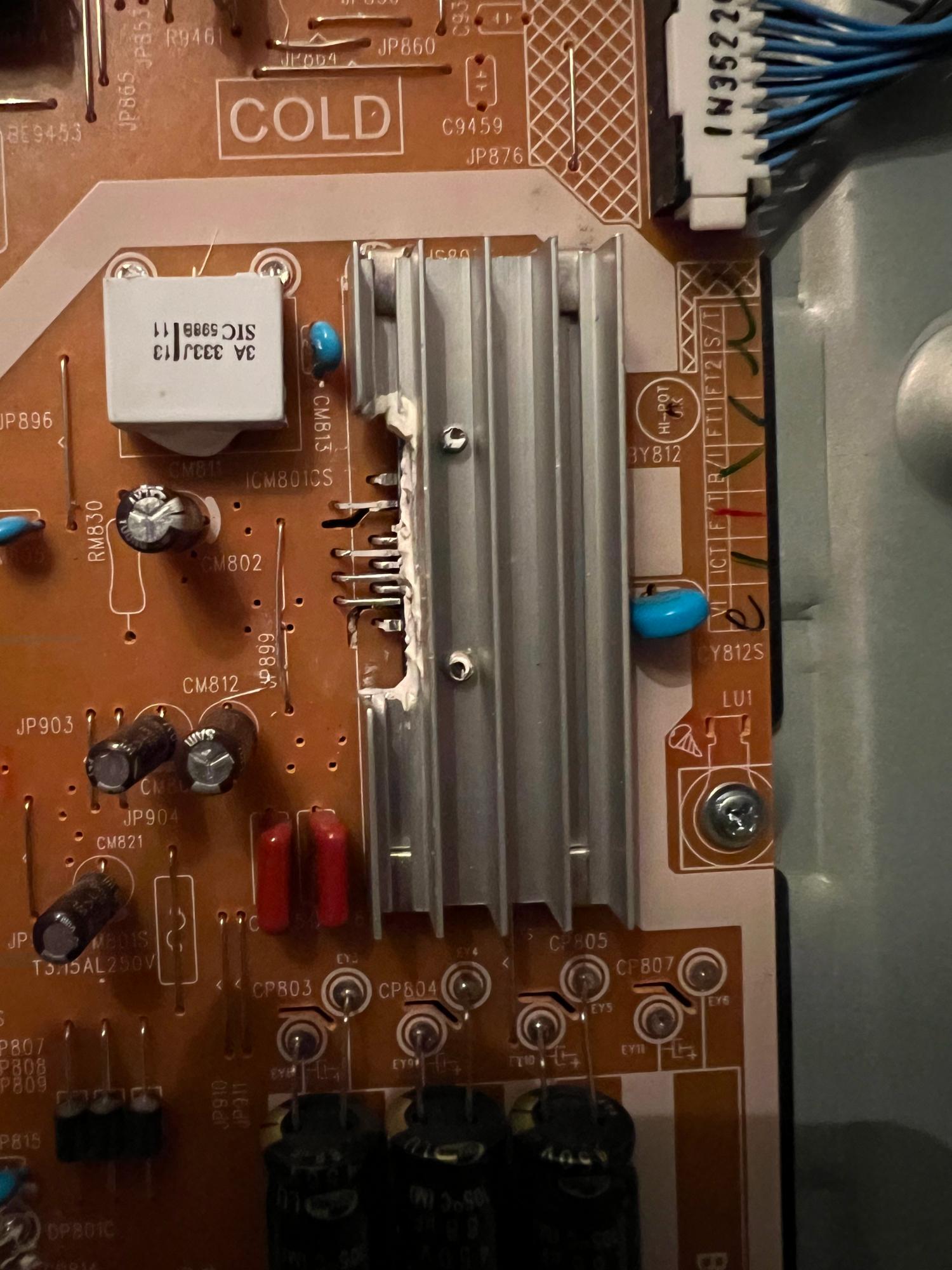

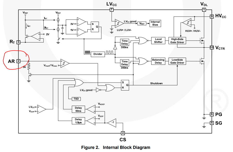

    I am a noob with some elementary knowledge trying to fix this TV that I have no history on. Any help or guidance will be much appreciated.
    When I first examined it was completely dead. saw that the fuse was blown and the ICM801CS blown. I searched and found that the FSFR1800HSL might be the replacement and got one from ebay and replaced it. But when I pulled the ICM801CS I could see the last 3 letters on the blown up part was XSL. So may be I replaced it with the incorrect part. I fixed the fuse and turned it on and it now gives me a standby light blinking twice five times, then clicks and repeats. Checked the entire board and cant find any other visually defective parts. Pulled /20UA60DN and checked it as it's heat sink screw was stripped. It showed 0.469v when negative multimeter lead on middle pin and positive on either side pins and showed no connectivity in reverse therefore I think this one cheched out. Put board back on TV and disconnected the main board lead and turned it on and the backlight came on but when it is connected the blinking standby light happens.
    Since I the ICM801CS part number is not legible if anyone can help me find the correct part and any other advice on this endeavor is much appreciated.

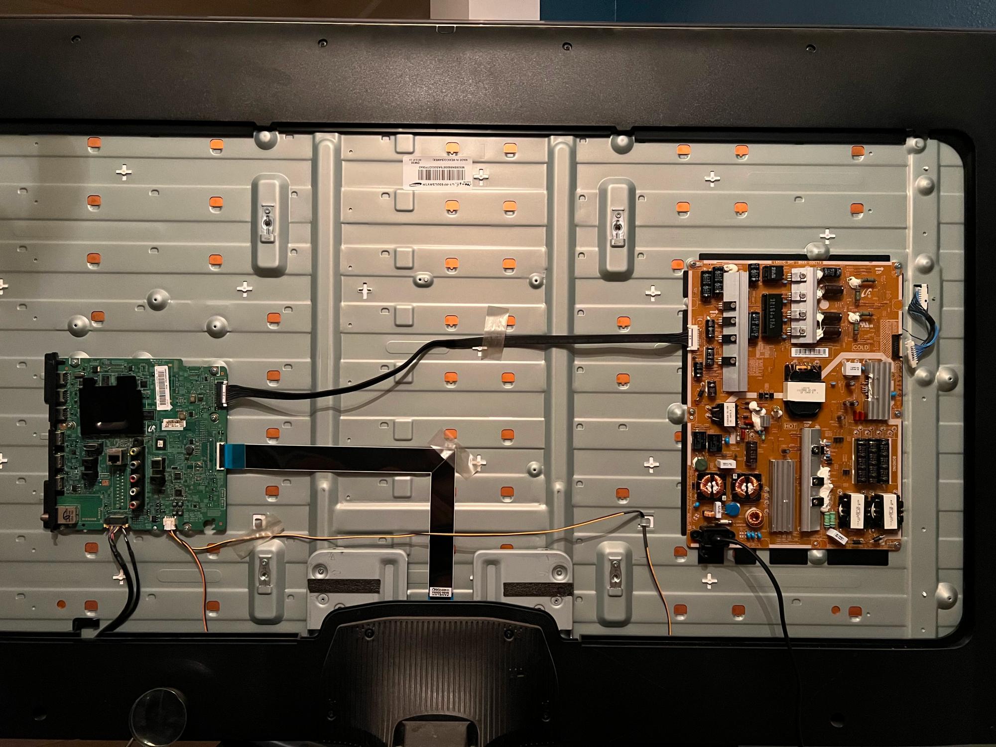

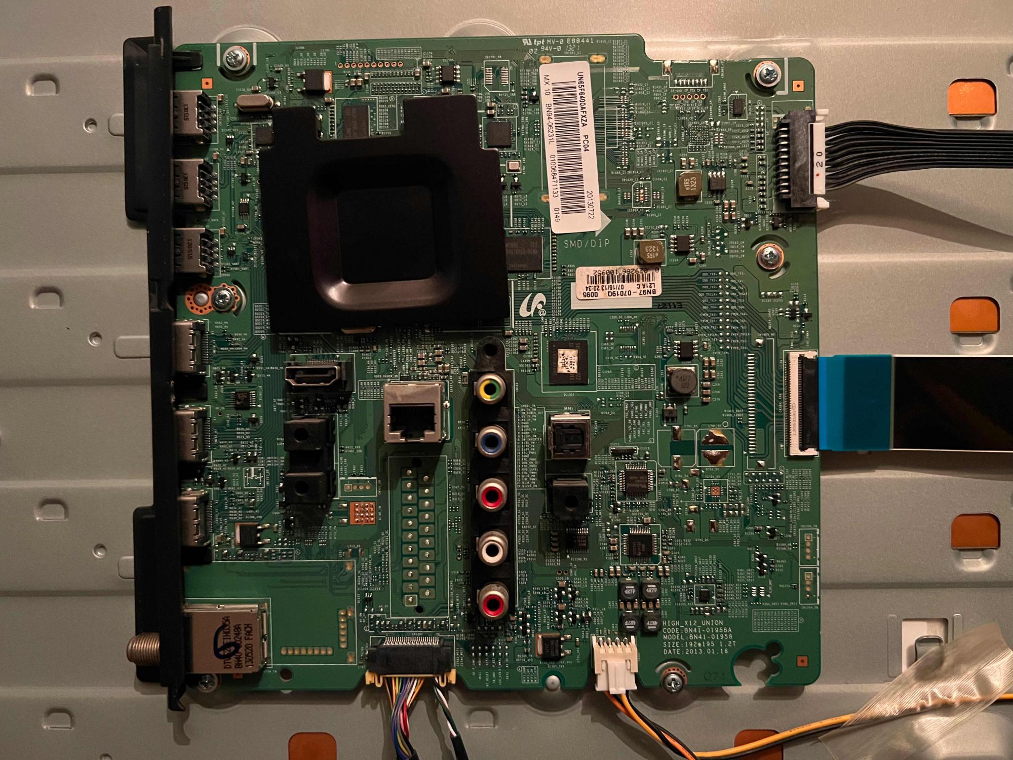

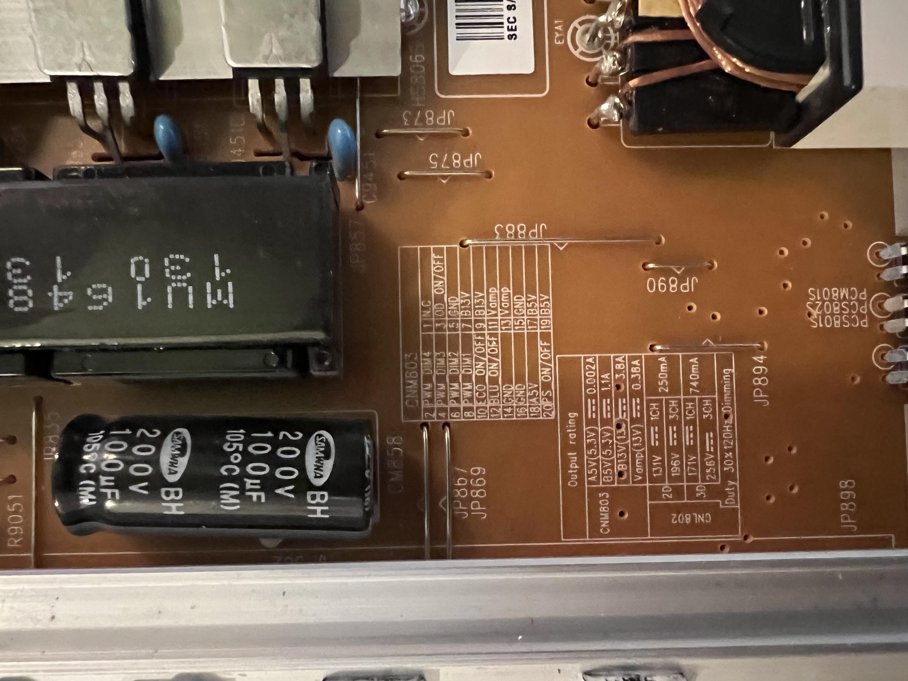

    Re: L65X1Q_DHS / BN44-00627A Samsung UN65F6400AF Standby blinks twice five times
    how about you post photos on the PSU and of the socket print chart which it go to main boards.... also measure and listed all voltage you have on the socket with pin name while the 5 blinking time.

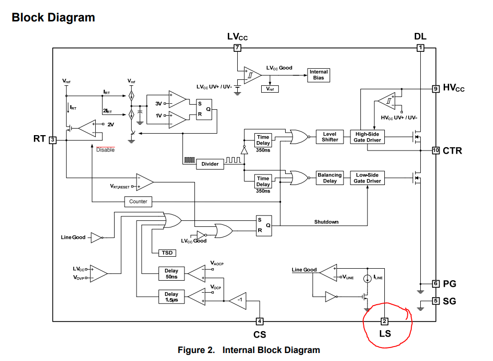

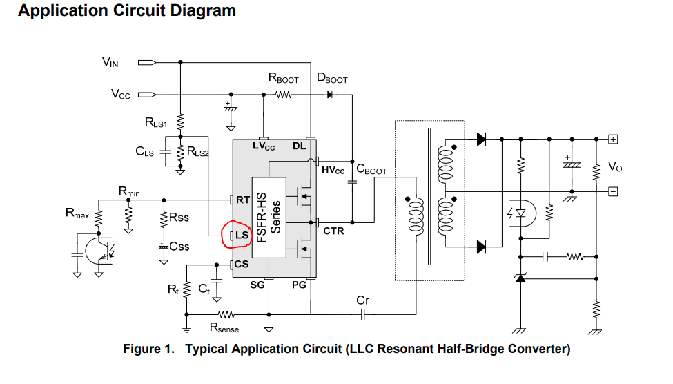

      HS and XS are completely different series, they differ in 2 pins.
        PFC goes high when MB disconnected so BL turn on.. LED indicator lit on mean STBY V present.... but how about Power on signal !!! yours photo of the socket print chart not clear at all.
          I mounted the PSU board back on the TV to measure the voltages and now it is flashing the back light continuously.
          Here are the voltages I measured when the main board was disconnected. Pins 2, 4, 6, 8 around 2.5V and 10 at 11mv 12 at 2.43V 18 at 5.38V 20 at 3.37V. Pin 1 at 0V 3 at 1.11V pins 7, 9, 11, 13 at 7.62V pin 17and 19 at 4.22V
          I measured the voltages of the outer pins as they are exposed and could not get good readings of the inner the pins. Pins 7, 9, 11, 13 were jumping to 10V temporarily and pins 17 and 19 were jumping to 5.37V. Jumping meaning they were not constant and held at that voltage for enough time to read them and then showing some milli volts.
          I am afraid now that something else has gone bad on the board.

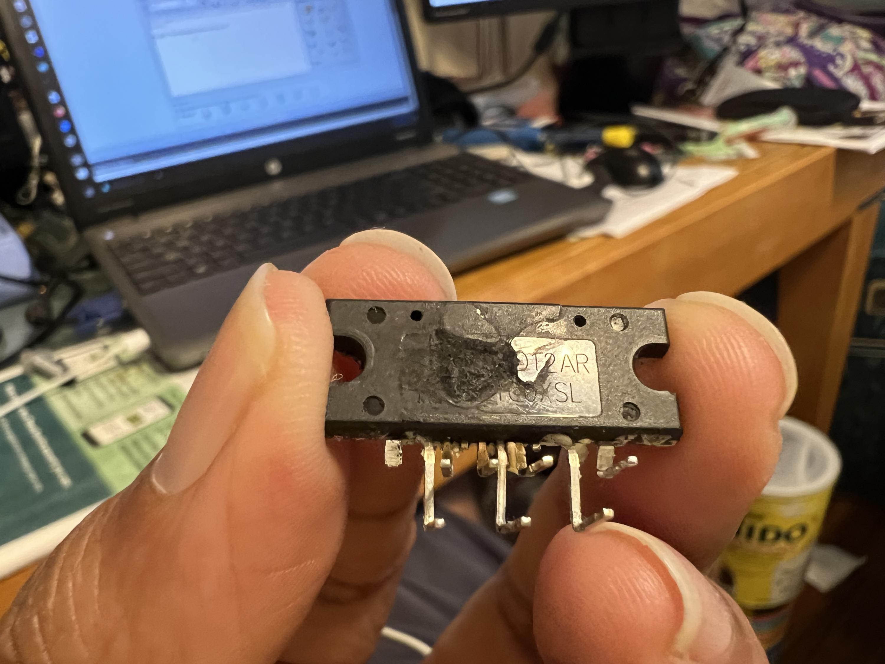

            OK got it. The only legible letters on the IC are XSL. Pictures attached. What could be the actual part I need to fix the board? I looked all over the internet for a schematic for it and could not find it.Aafter looking at the board and the schematic for the HSL I thought it would be the correct part and thats why I got this replacement.
              you need to measure voltage while MB connected and give attention on pin 20 reading
                When main board plugged in pin 20 shows 3.3V while back light is lit and goes down to 255mv when back light is off. This keeps cycling continuously. What can this mean.

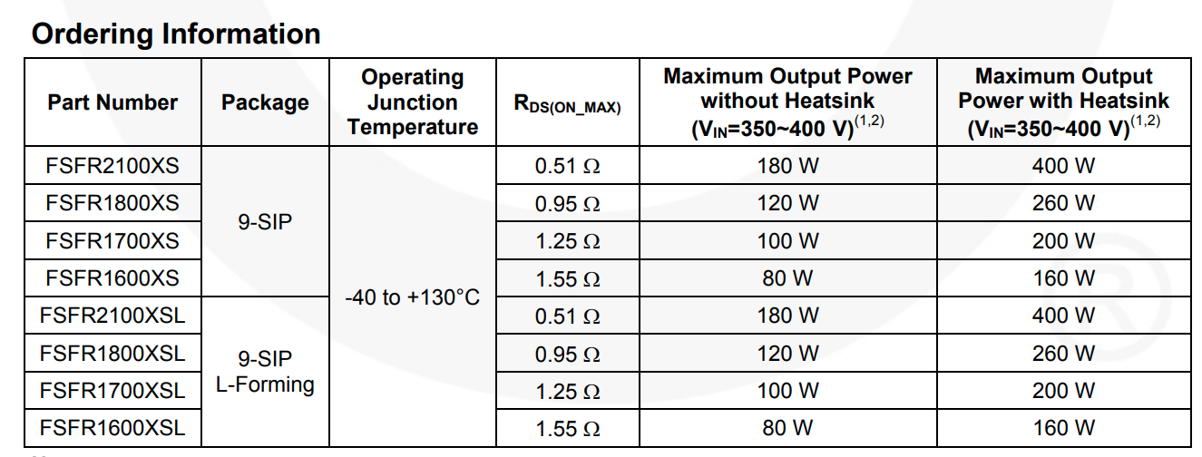

                  Yes, you need to install exactly this one (FSFR1800XSL), it will not work with another one.
                    in this case.. u need to check pin A5V if its stable
                    if stable mean pin 20 power on caused by Main boards didn't boot ( boot loop)
                    if its not stable then the issue at PSU

                      Yes, you don’t need to measure anything, you first need to replace it with the original microcircuit.

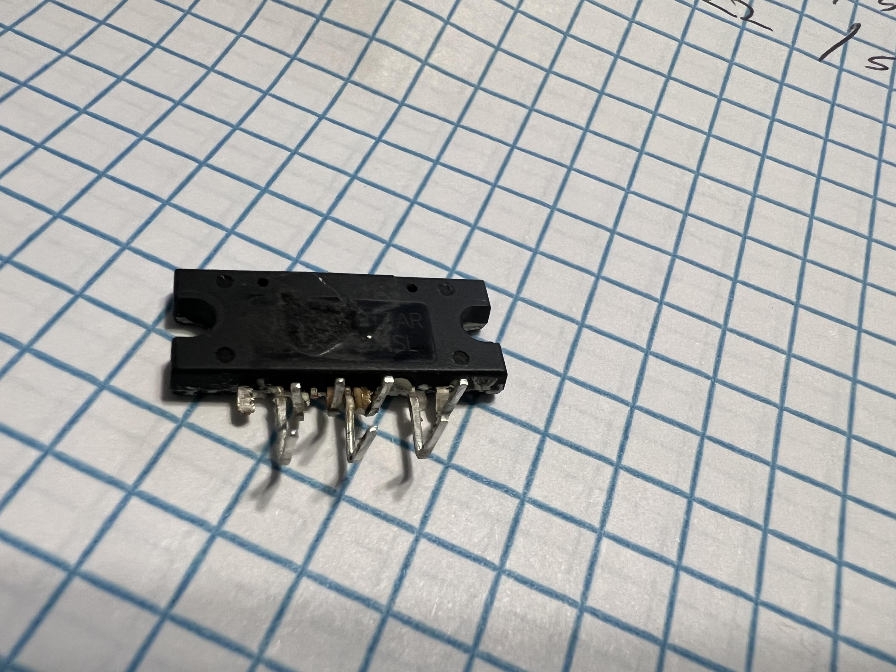

                          Yes, you don't need to measure anything, you first need to replace it with the original microcircuit.
                          Upon closer examination of the burnt IC the last few numbers on the part number may be 100XSL. So could this be an FSFR2100XSL? If so I will replace it with this part and update here. Thank you everyone for the quick responses to my issue.
                            Well, then you need to know exactly what should be.

                              If you can find a quality service manual it might have a parts list in it.

                                Saw a parts list but wouldn't you know it they didn't list the suffix, just FSFR1800, so if you can read the last part then it looks like it is indeed a FSFR1800XSL.

                                • cekanayake
                                  • May 2019
                                  • 16
                                  Looking at the remnants of the IC-pictures posted, I think it might be FSFR2100XSL. Please take a look at it let me know what you think
                                  • lotas
                                    • Jan 2016
                                    • 4909
                                    • Russia
                                    Yes, it is very similar to 1, put it, that is, FSFR2100XSL.
                                    Just for your "65" diagonal, it is the most powerful of this series.
                                    In "46" the diagonal is 1800.
                                      Thank you. I will order it. I will update after I make the change.

                                        Yep, that makes sense, the parts list I saw was for a 55 inch.
