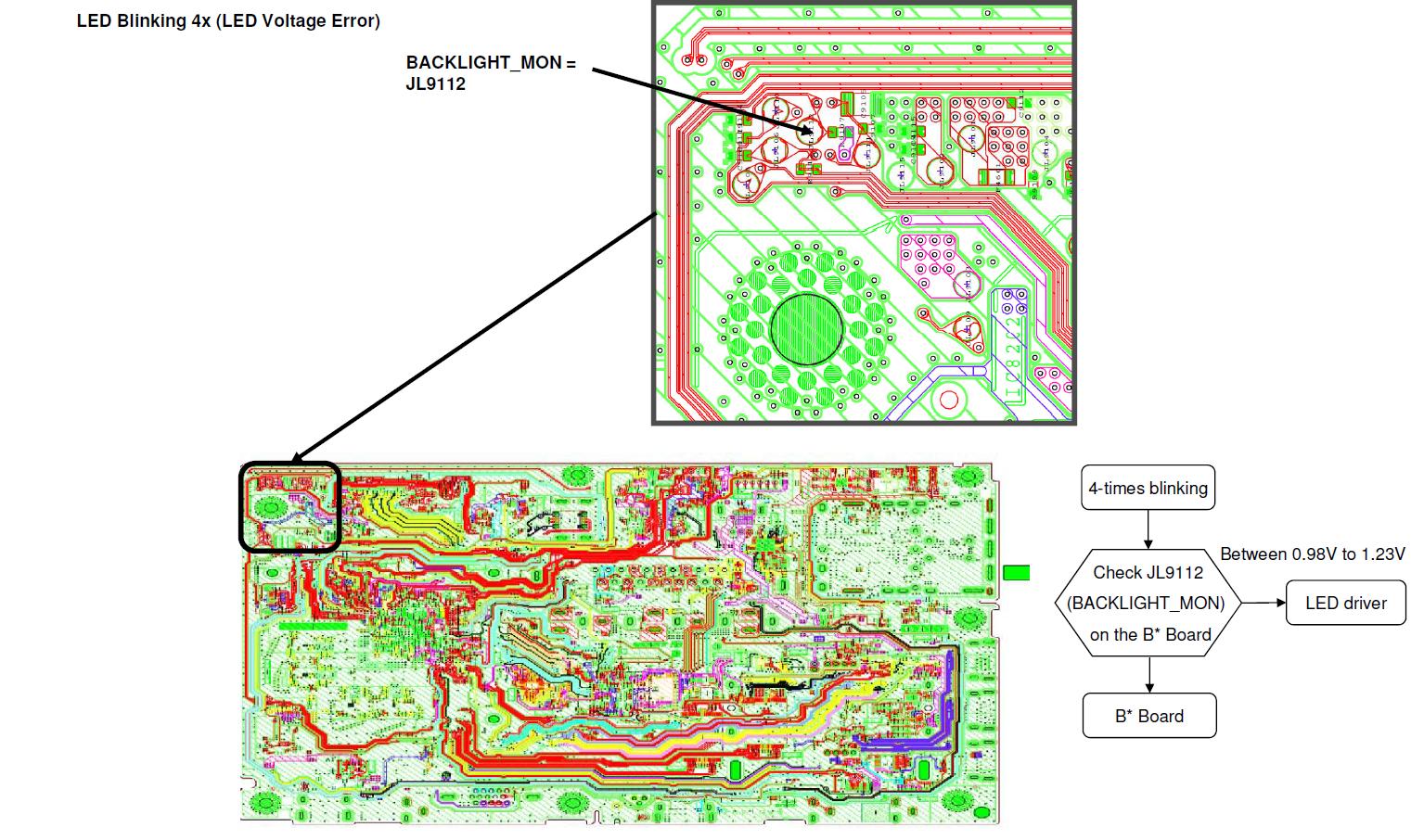

      With everything connected, locate and check the voltage on JL9112 on the rear of the BA2 board

              @R_J: The measured voltage on JL9112 was 1.11v.
                This would suggest, going by the manual? that the fault is not with the B* board and is likely with the led's them self. You should be able to operate the tv without the lcd installed so you can see what the led strips are doing, ie one led flickering etc.

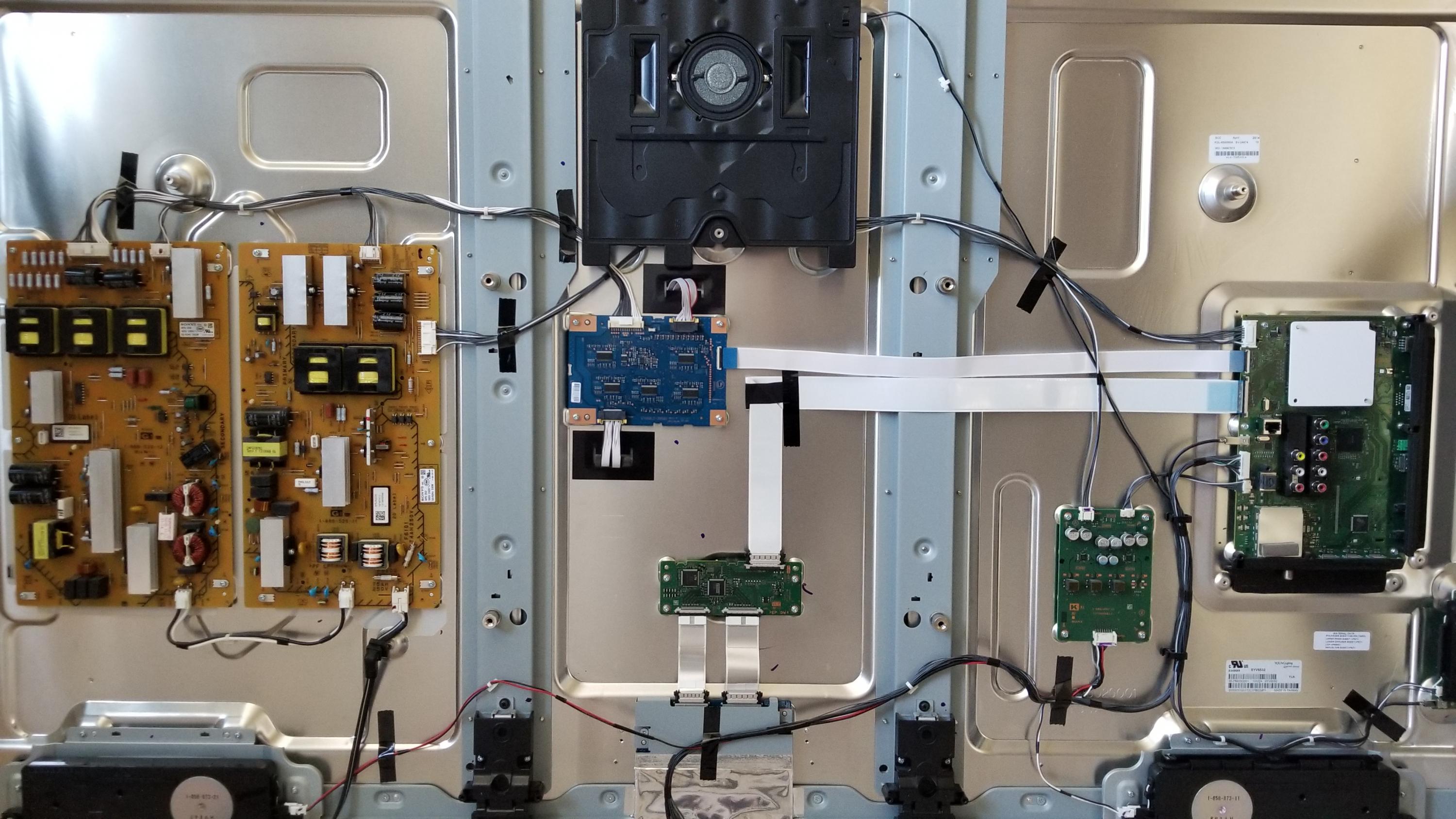

                            Okay, so I was able to check the newly installed backlights, and one of the strips was bad. Only half the lights on that strip worked. So I replaced the bad strip, and I'm still getting the same error. I checked all the backlights several times and they all are working. I replaced the LD board: no change.
                            I'm stumped. Could it be a bad power board? Or a bad t-con board? At this point I'm just throwing money at it guessing which board to replace next.
                            @Storyteller12: I'm not sure which board is the backlight inverter. Can you tell me which board that is or what I should be looking for?

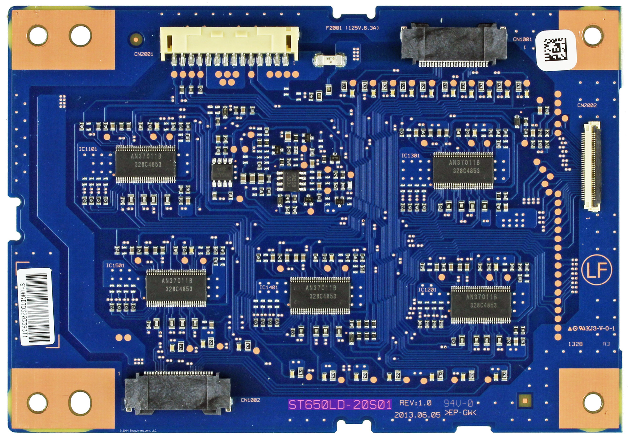

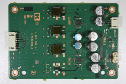

                                It is necessary to change not one led strip that burned out, but all (for a new complete set).
                                LED Driver is 1-888-652-11.

                                    I did replace all the old strips. One of the new strips immediately burned out (a portion of lights on the strip). I then replaced it with another strip and the same thing happened. Oddly, when I plug in an old strip, it seems to work (see my post above).
                                    I thought the LED Driver is 1-895-465-11 (ST650LD-20S01). The part you mentioned is the K board, which I'm not sure of its function.

                                      Apparently my mistake, I didn’t look at the photo in the first post, when I entered the led driver in the search engine, I gave out this board, yes, the blue board 1-895-465-11 (ST650LD-20S01) is right, this is the led driver, then the strip immediately burns out LEDs, rather, one chip has broken through and the maximum voltage is supplied to this LED channel or not high-quality new LEDs (not original).
