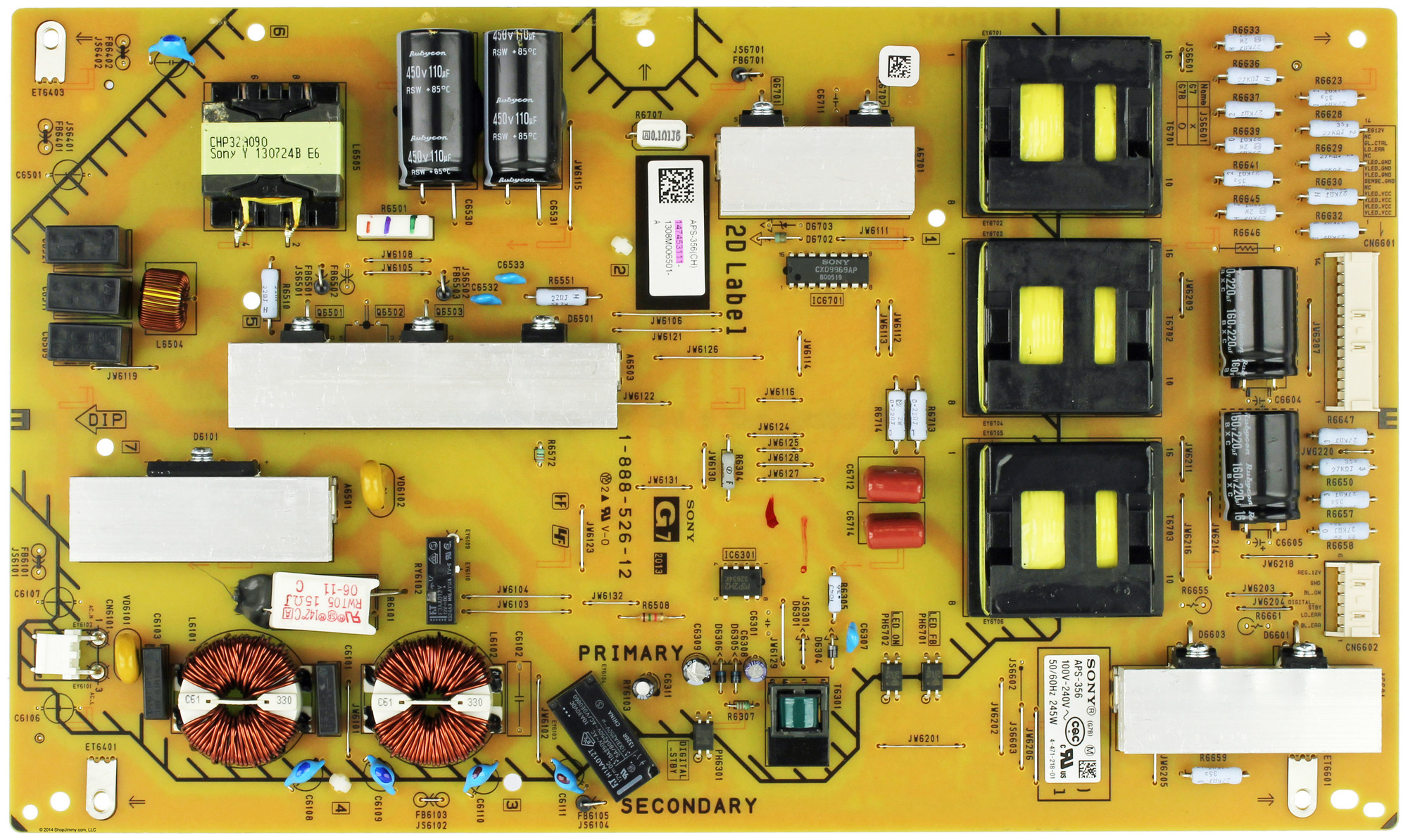

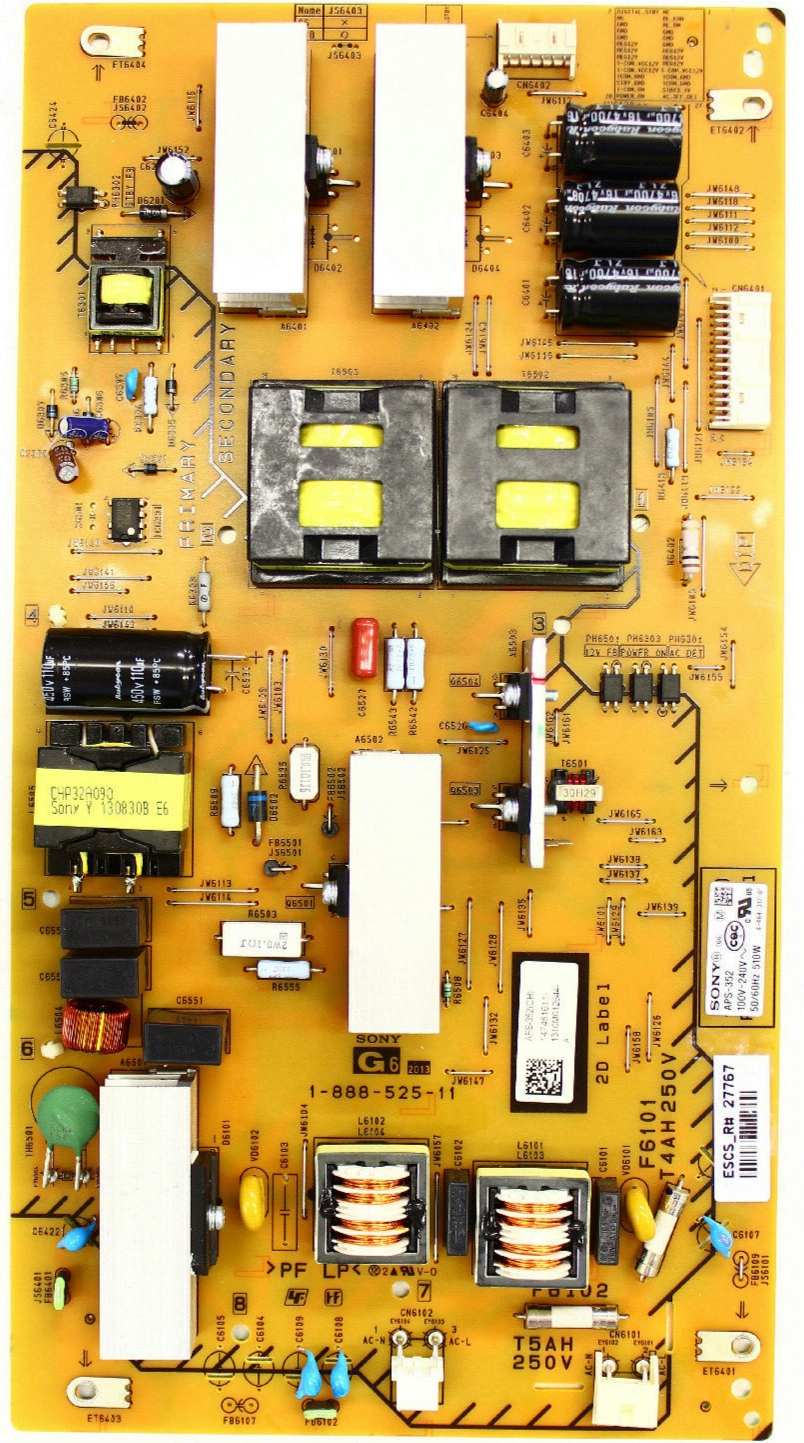

      Any idea which powerboard? There are 2: the G6 board (1-474-516-11) and the G7b board (1-474-531-11). My guess is the one that connects directly to the LD board (the G7b).

          Thanks, will do! I'll order a power board in the meantime.

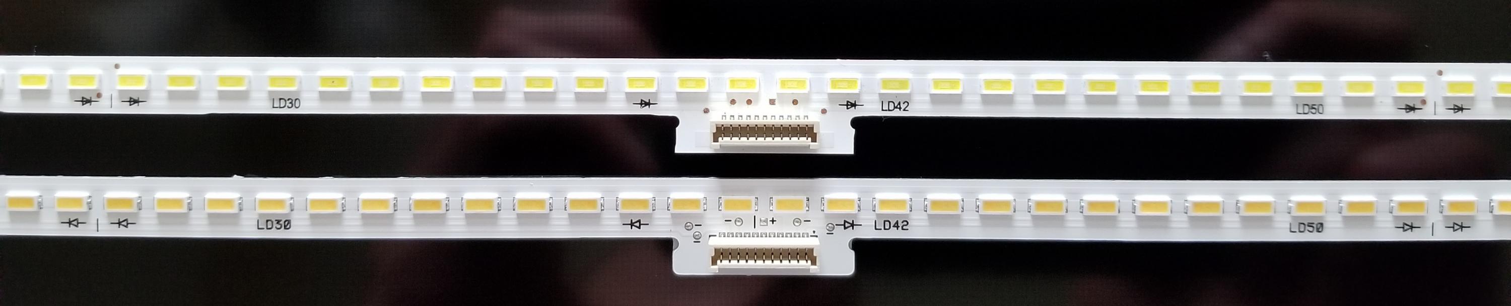

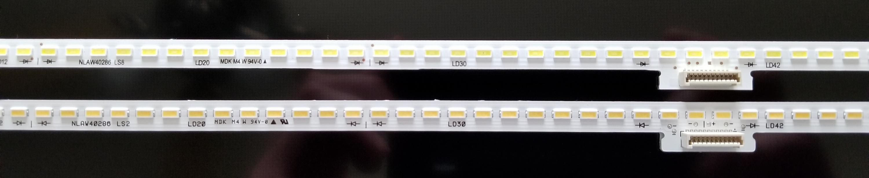

                I tried testing the old and new LED strips in diode mode, but I'm not really sure how to correctly test these strips (see photos - top is new, bottom is old). I should also mention that I plugged the old strips back in and they all appear to work fine.

                  Not sure, I wonder if that diode icon pointing in the other direction has anything to do with the problem??

                      Re: 4 Blink Error Help: Sony Bravia KDL-65W850A
                      Because in this one bar there are 5 separate channels of LEDs, why are there so many pins on the connector.
