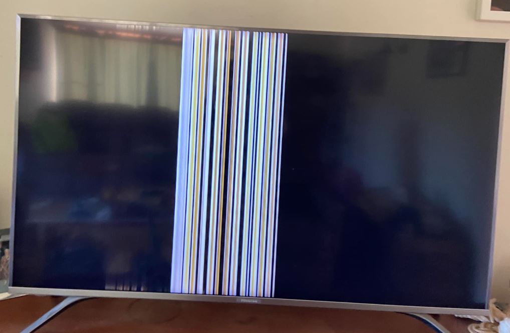

    Hisense 50P6

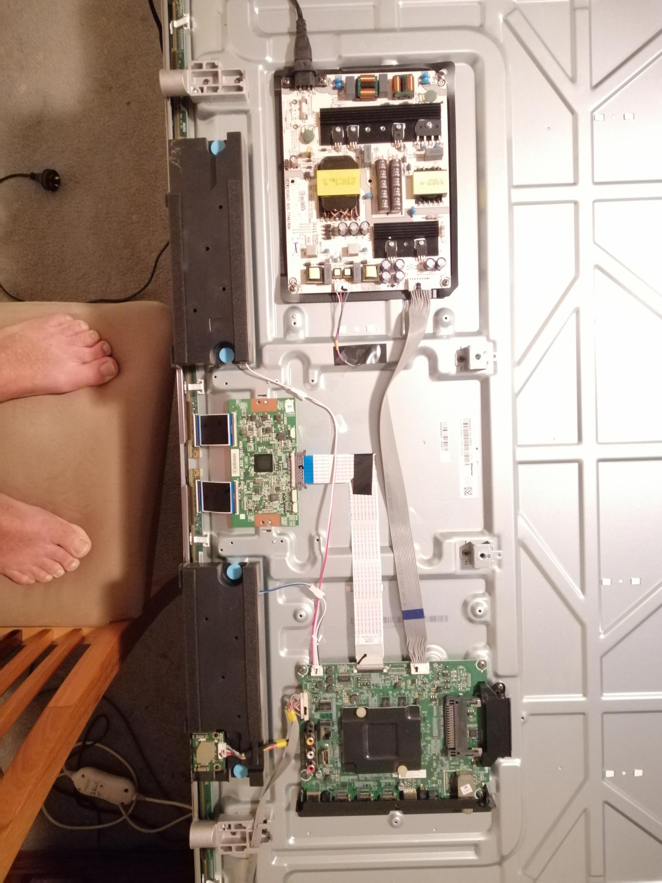

    What would you look for first, to diagnose this fault please?
    Many thanks.

    Inspect for damage and clean and re-seat same cables from t-con board to panel driver boards.

      Can also try powering up with just one of those cables hooked up, check display, then do the other side, do all connect and disconnects with tv unplugged to insure against any errant surges or such.

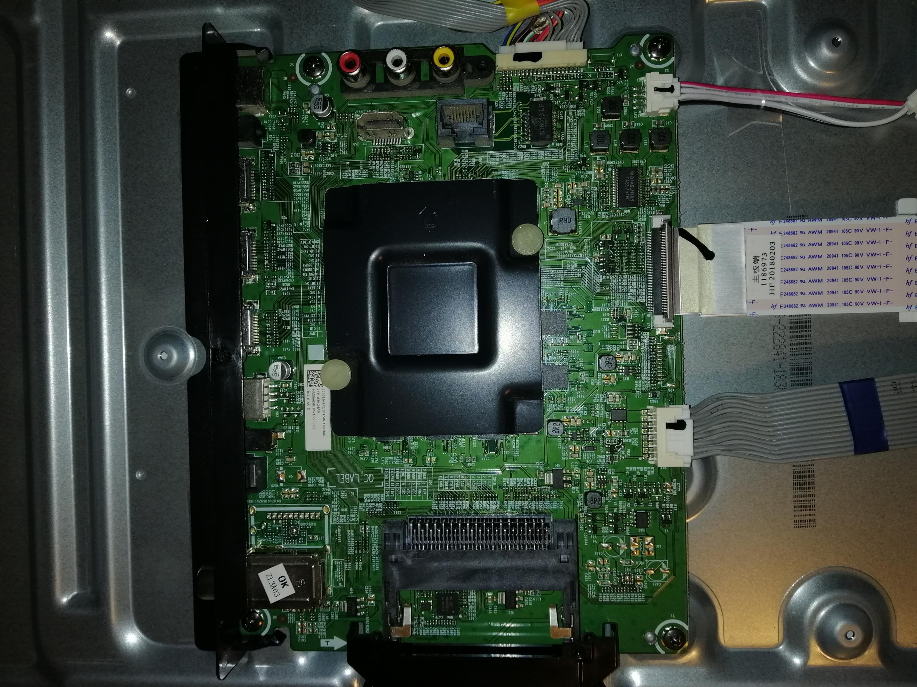

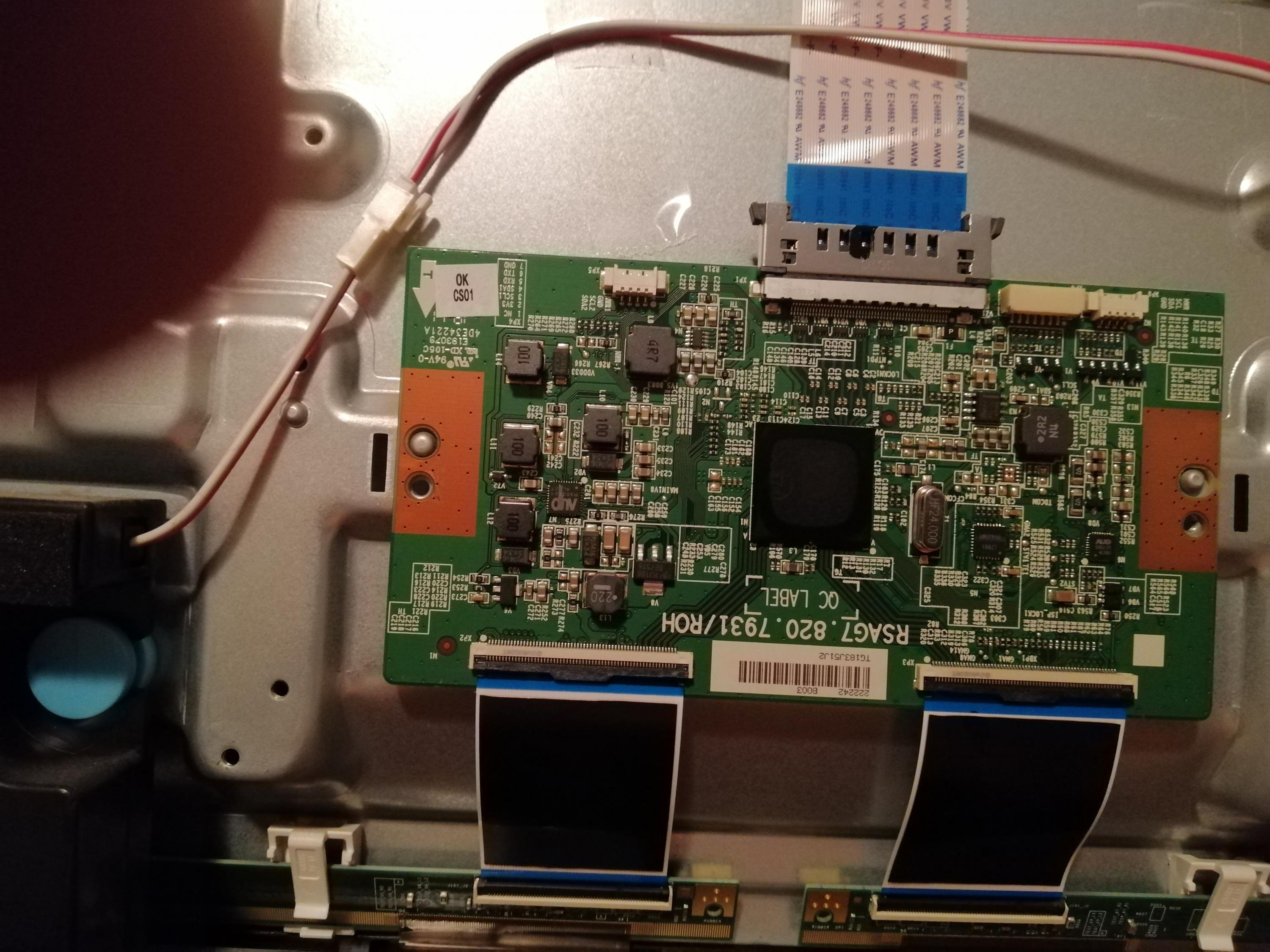

          TV brought to me today.
          I undid and reconnected all the ribbon cables, no success.
          In wiggling each cable from the mainboard, to the tcon, the two ribbons leading from the tcon, and as well as the edge boards, I noted nothing happening to the picture.

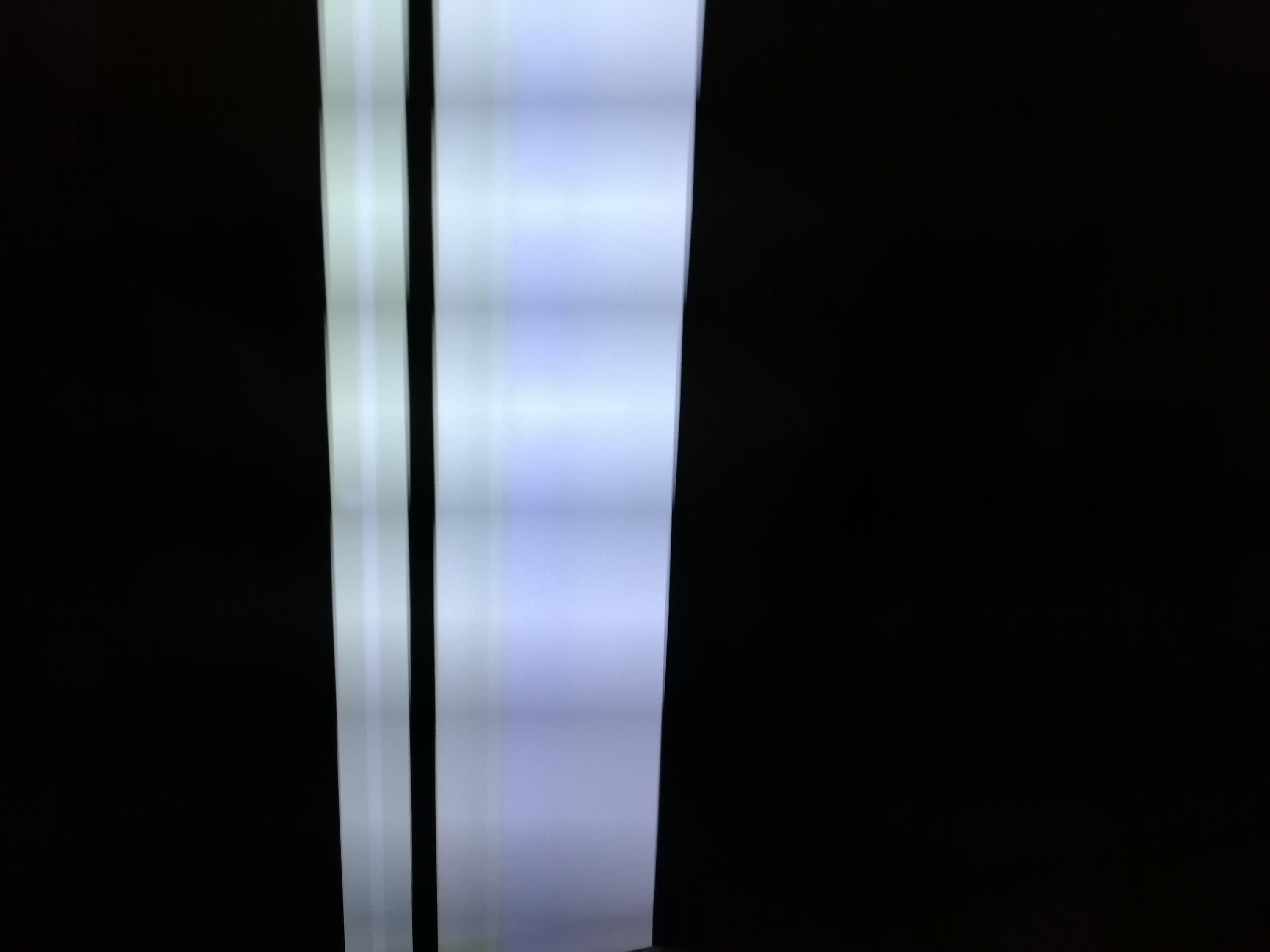

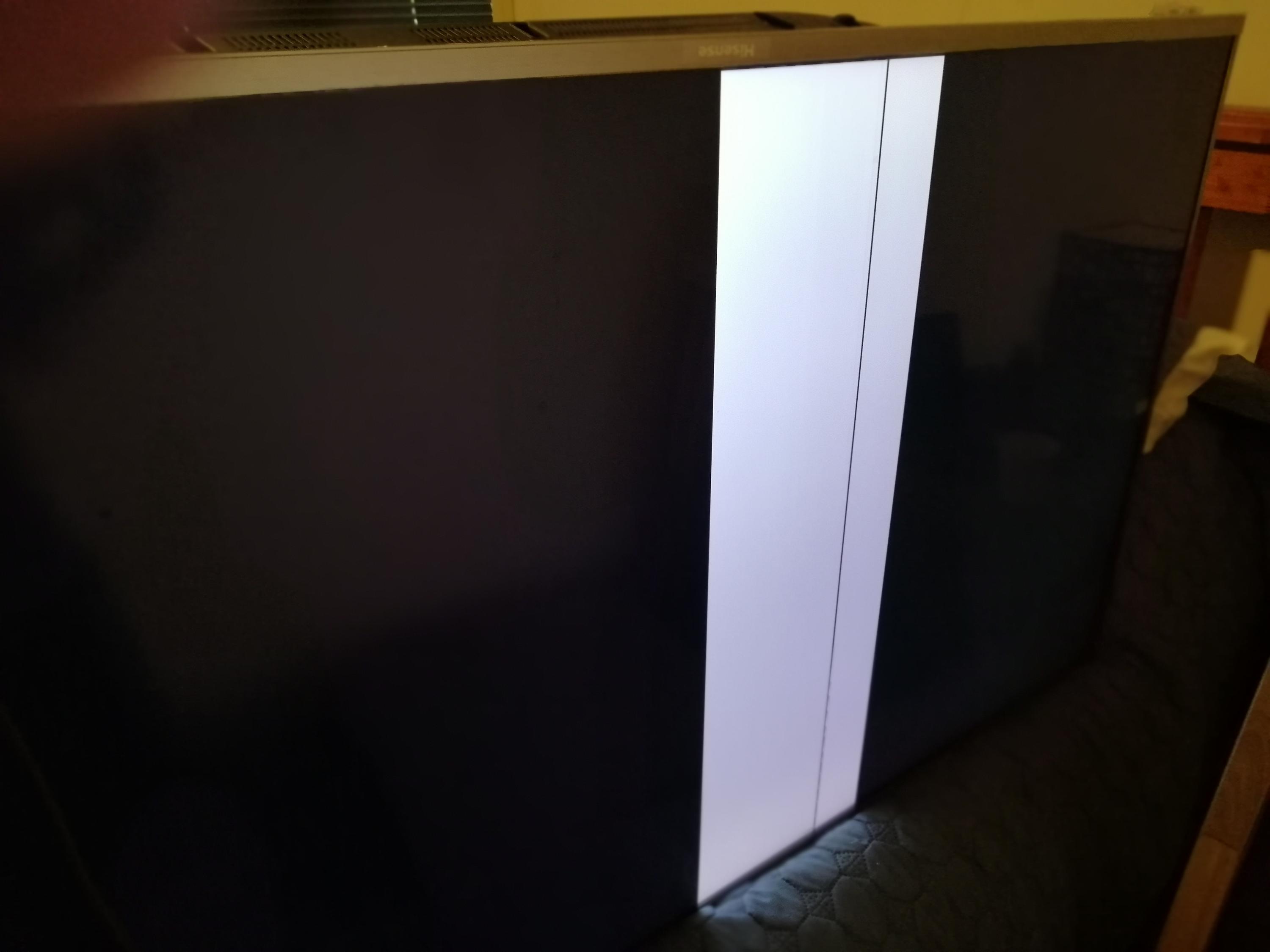

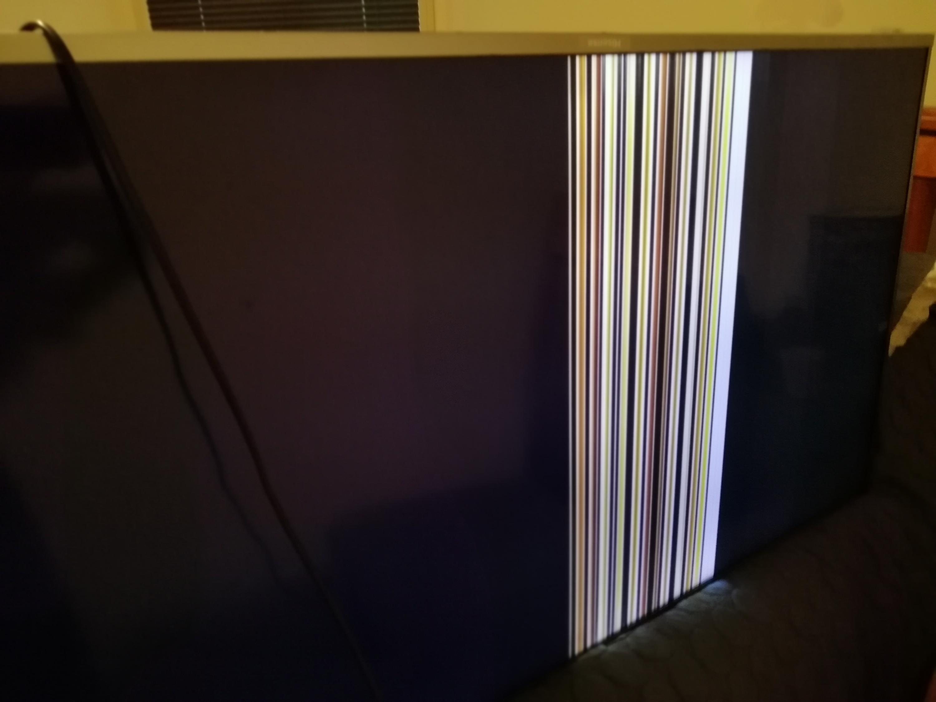

          I turned it all off again, took a photo at start up again, as pictured (normal lines)
          I then did as suggested,disconnected the power, removed one ribbon one side of the tcon, restarted, picture attached.
          Powered down, reattached first ribbon and disconnected second ribbon, picture attached.
          Put it all back to how it was, and lines still present in picture.

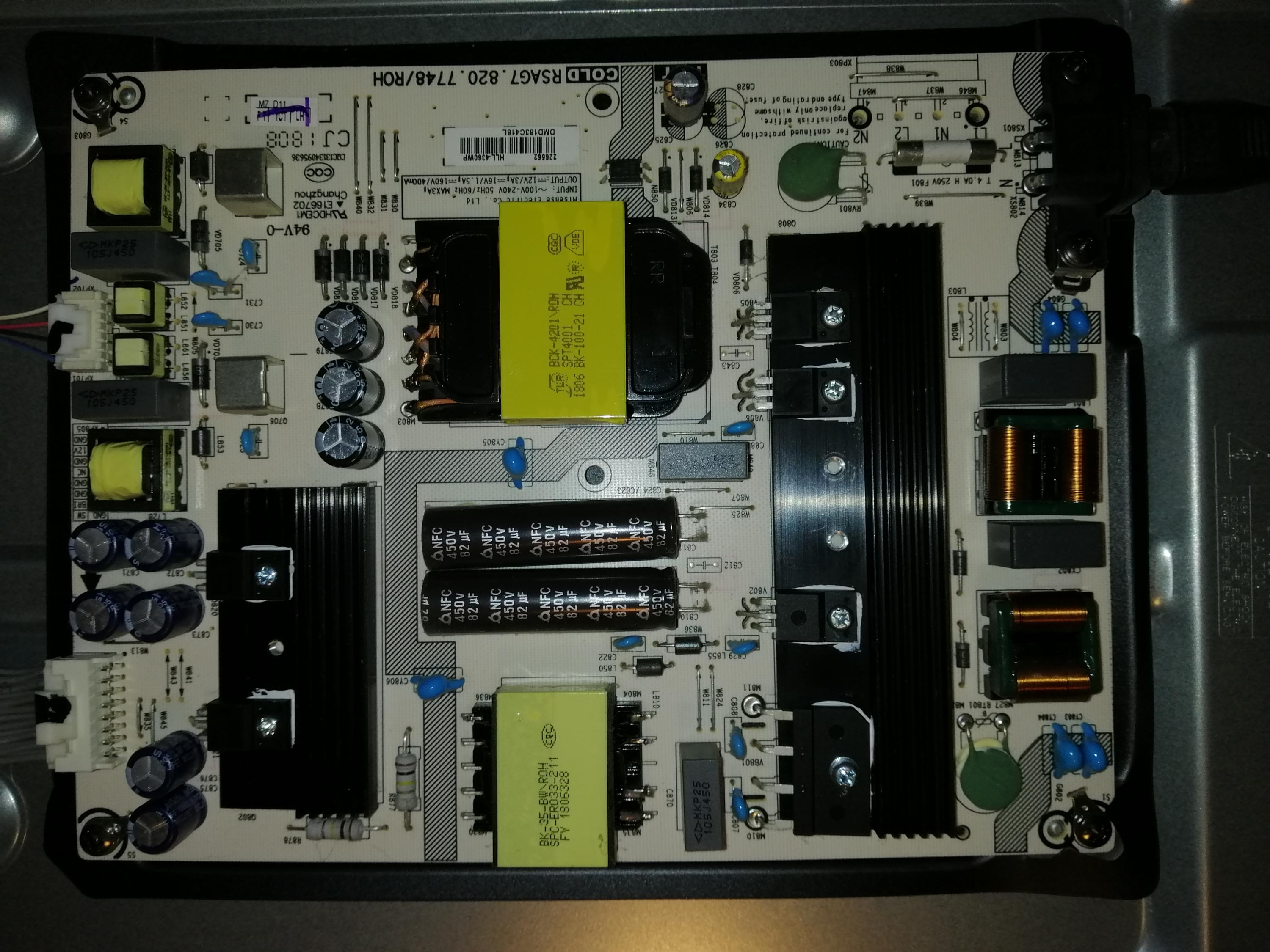

          POWER BOARD ...RSAG7.820.7748/ROH
          T-CON BOARD.....RSAG7.820.7931/ROH
          MAIN BOARD......RSAG7.820.7970/ROH
          Owner says tv has been good for 5 years, turned it on the other day, and all there was is the lines.
          Your valued directions please, novice status.
          Many thanks

            disconnect the LVDS from T-CON side and turn on... if the BL come on then follow the test
            - keep the LVDS disconnected from T-CON side.. make jumper wire between the power boards 12V line and feed it direct on F1 ( black fuse ) on the T-CON and turn on see how the screen look.
            if the first point the BL didn't come on... but u still have the 12V on PWB ... do the point 2 but use torch light to discover what the screen displaying.

              Such a defect can be caused if liquid gets on the screen and gets on the decoder cables in this area where the strip was formed.

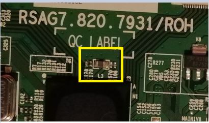

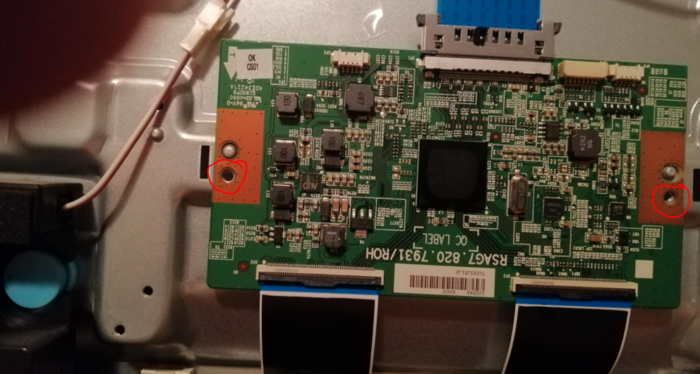

                    I have only completed part 1 of the test, as I am unable to know where to connect things for this part of your test "make jumper wire between the power boards 12V line and feed it direct on F1 ( black fuse ) on the T-CON and turn on see how the screen look."
                    I am just a newbie, with poor abilities.
                    I had the set off, and disconnected the lvds from the tcon. The backlights all came on as they do normally.
                    About 3 seconds after the backlights all turn on (light seen trough holes) I noticed that the red on/off switch blinked 17 times.....it did not blink previous to disconnection.
                    In regards to the tcon, is this the actual fuse area to check to see if it is also getting 12v or similar?
                    Thanks, the help appreciated.

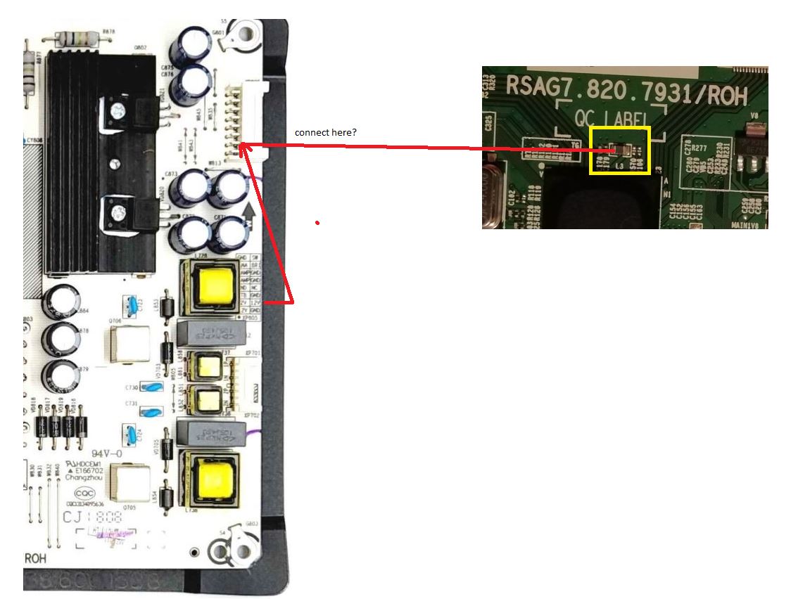

                    • viewerau
                      • May 2020
                      • 315
                      Re: Hisense 50P6

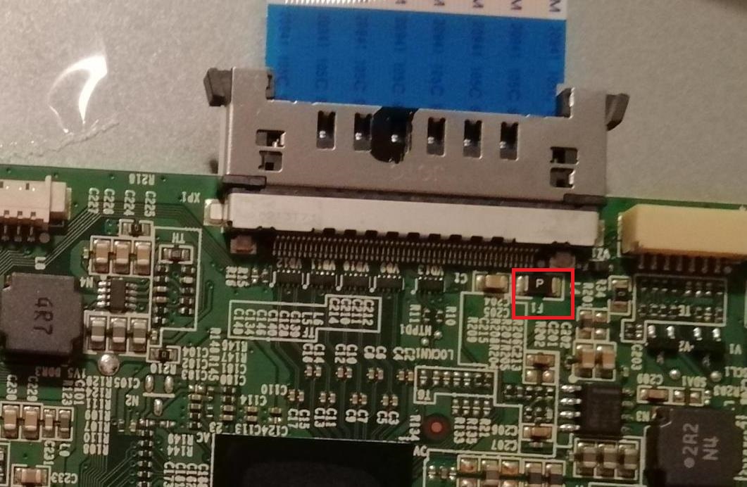

                      I may be on the wrong track here, but is this what you mean me to do?
                      Connect a wire between 12v pin on power board, and ouch it to fuse and see what happens?
                      Sorry for my novice level.
                      Signature:Seemingly hopeless tv fixer
                      • vinceroger69
                        • Mar 2012
                        • 6714
                        • uk
                        Re: Hisense 50P6
                        Fuse F1 has a p marked on it its by the connector
                        • Diah
                          • Feb 2013
                          • 6552
                          Re: Hisense 50P6
                          +1 exactly
                          be sure LVDS disconnected from T-CON side... & the pin on PWB are 12V (measure it ) before u make the jumper..

                              • viewerau
                                • May 2020
                                • 315
                                Re: Hisense 50P6
                                Thanks...
                                Do I need to buy some of these to do the test ( I don't have any), or do I just find some old wire, strip both ends, and then just hold them in place to do the test?
                                My apology, but as I say, I am a novice, that unfortunately requires me to ask things before I commit to tasks that I have not done before.....SORRY.
                                EDIT.....When I do the test, do I still need the lead (with an 8 pin connector) in place on the power board, that runs between the power board and the main board? (AGAIN SORRY)
                                • Diah
                                  • Feb 2013
                                  • 6552
                                  Re: Hisense 50P6
                                  1- just use one wire to put it in place
                                  2- all sockets should be in place as original... only the LVDS cable disconnected it from T-CON side.
                                  • lotas
                                    • Jan 2016
                                    • 4841
                                    • Russia
                                    Re: Hisense 50P6
                                    In this case, do not forget to screw in the bolts so that there is a ground (GND) with the TV case.
                                    • Diah
                                      • Feb 2013
                                      • 6552
                                      Re: Hisense 50P6
                                      correct.. good point
                                      • viewerau
                                        • May 2020
                                        • 315
                                        Re: Hisense 50P6
                                        My apology for being a bit slow with this reply.
                                        Before I did anything I checked to see if the pin on the PS had 12v when turned on...it did.
                                        I then turned it all off and then put the lead on the 12v PS and onto F1 on the t-con and the screen went bright white with no lines.
