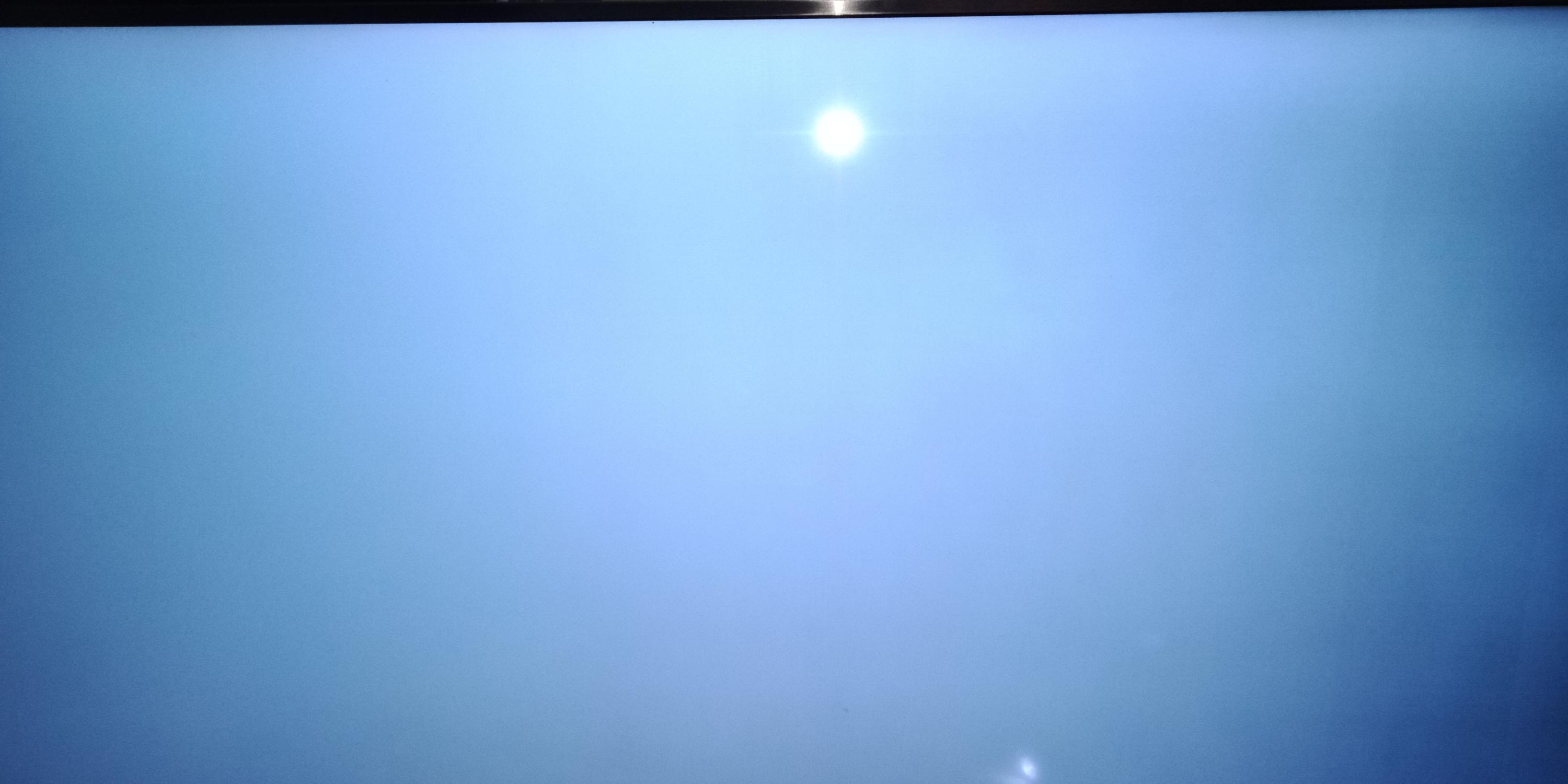

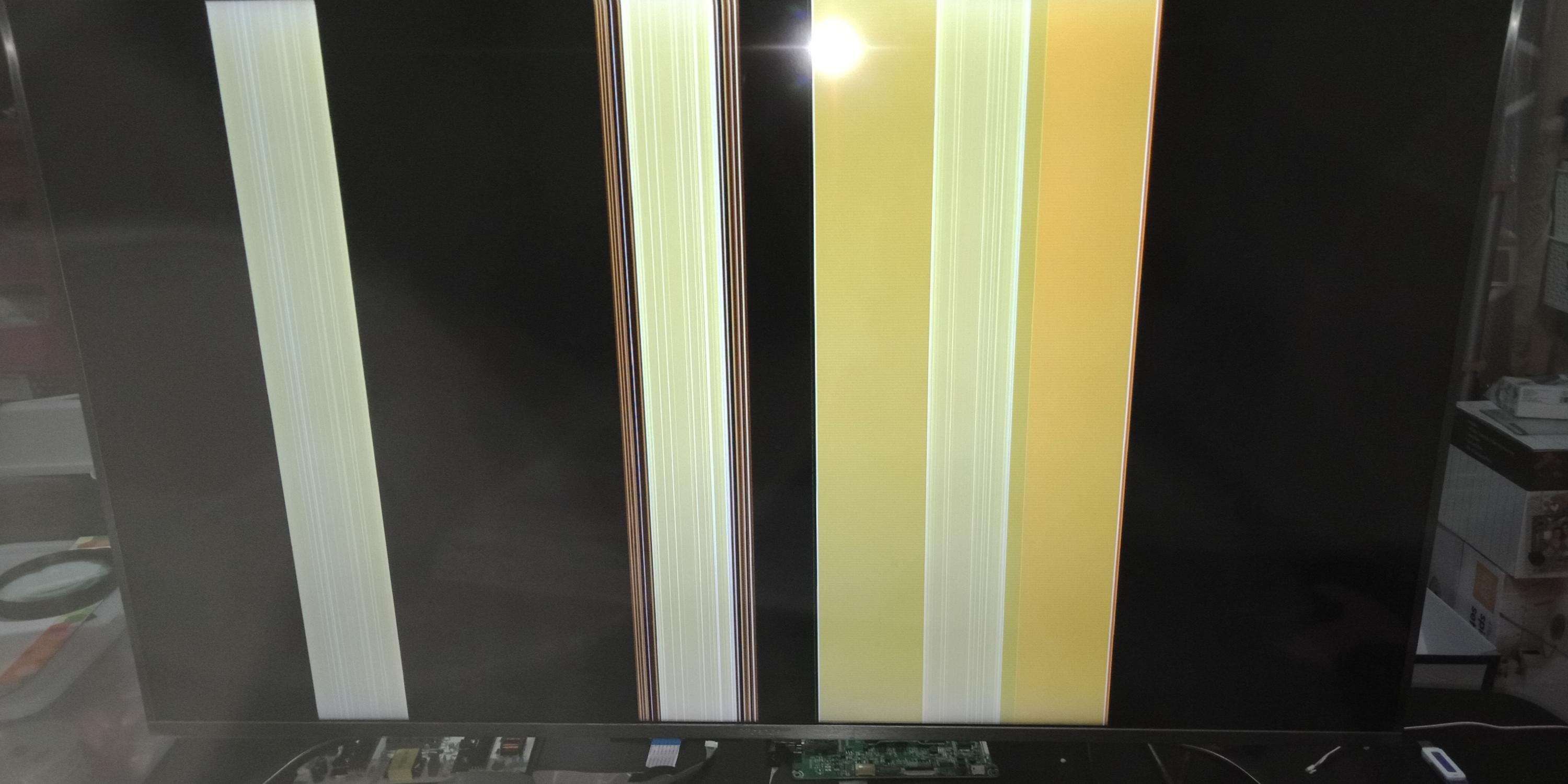

            #105
            Re: Hisense 50P6
            Thanks for the above information...helps me try to understand.
            Back to problem solving.

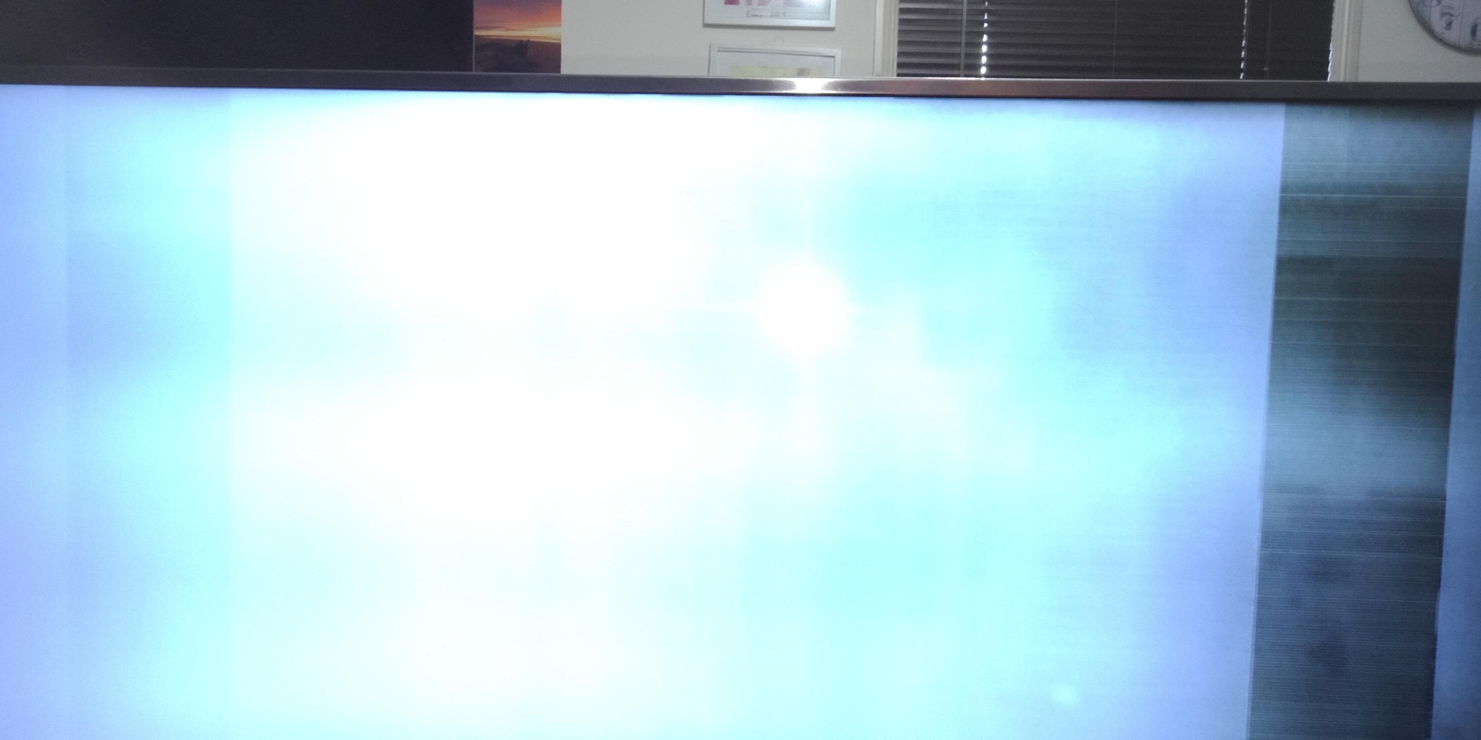

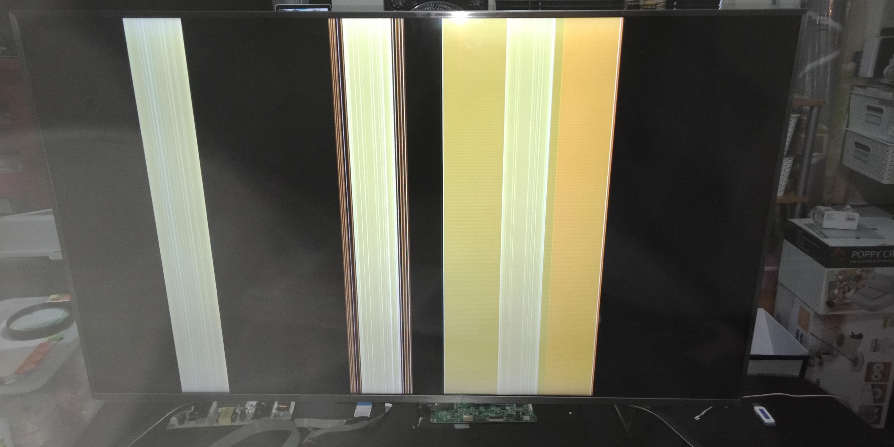

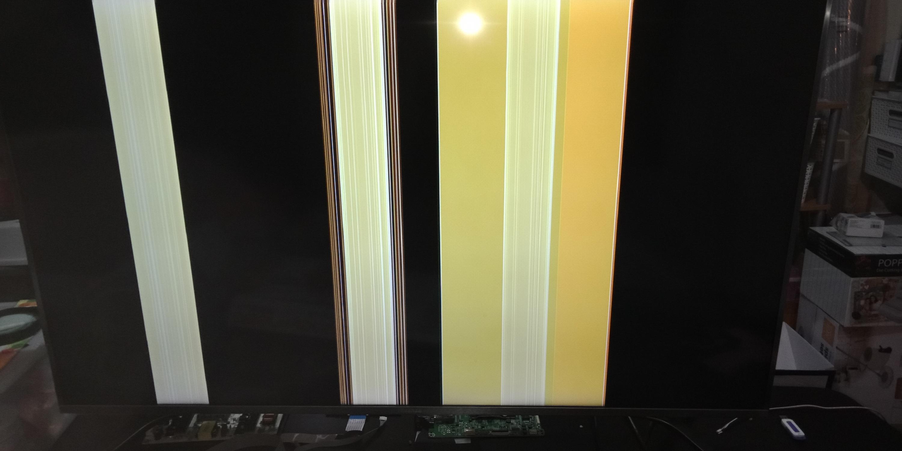

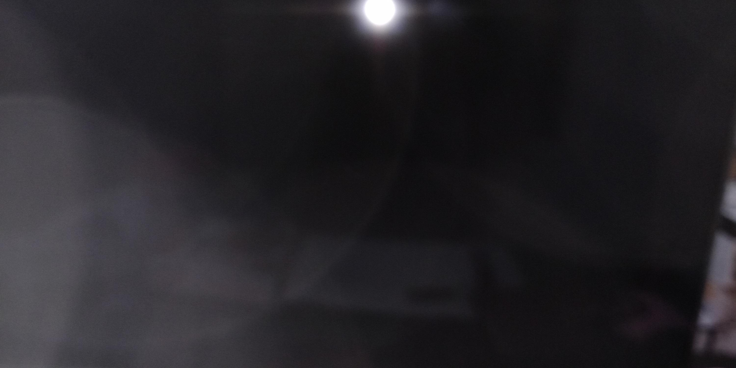

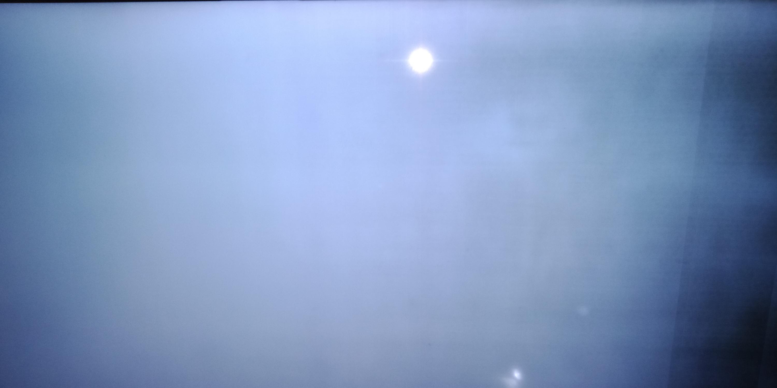

            I removed all the donor parts and reinstalled all the original parts.
            I am hoping these photo's may help the diagnosis?
            The first 3 photo's show the screen with all the lines at startup(tagged startup)...in this stage backlights are still on
            Next with the tcon disconnected at LVDS (tagged blankscreen)...dull glow to screen, backlights on
            Next set (tagged jumper) etc...same as above, lvds disconnected, backlights are on, and the jumper held between 12v rail on power supply, and other end to P as requested. As said previously, a little spark emits when touching the probe to either the left or right of P. Response was picture jumping into these blue colours.....nothing at any time could be detected with a torch.
            Last one is the video by my wife as I have jumper in place.

              #106
              Re: Hisense 50P6
              Video did not attach...try again...nope..says invalid file (mp4)....I'll try another way

                unfortunately you failed by beginner mistake how ever we told you the T-CON should be screwed to chassis & put the jumper in place of T-CON fuse then turn on... what you did just you turn it on and with shaking hand you touch the jumper to t-con. each spark you saw will raise currents toasting T-CON and over load COFs. so you have now absolute dead Panel with toasted one COF or more..
                BTW: if you are lucky.. you could have parts on the buffer boards fault.

                    #109
                    Re: Hisense 50P6
                    Originally posted by viewerau
                    It still has exactly the same start up stipes, and with ldvs disconnected from tcon board, it still has backlights, as well as the picture showing black, with dull illumination.
                    yours TV T-con 12V feed come via LVDS. if you disconnect LVDS, mean T-CON & Panel out from system. so what you see its just reflection of the BL
                    this why when we disconnect LVDS we feed the T-CON with 12V tolet it work with panel as stand alone..
                    on yours Video.. T- CON try to play color pattern R-G-B-W-b, but all of are washed off and one bright dark line on the right side.
                    right now you don't need to try turn the TV on at all.. start with taking the LVDS and the both ribbon cable . photograph the end of them with yours mobile camera as focused close photo.. upload the photos to yours PC and enlarge them by zoom to inspect all pins if one are broken.../ broken mean it could be moved to side made contact to nearest pin or its shorter than other.
                    i faced this disrupted pattern with other TV platform. but it was with T_CON too and one of ribbon was the guilt. try this.

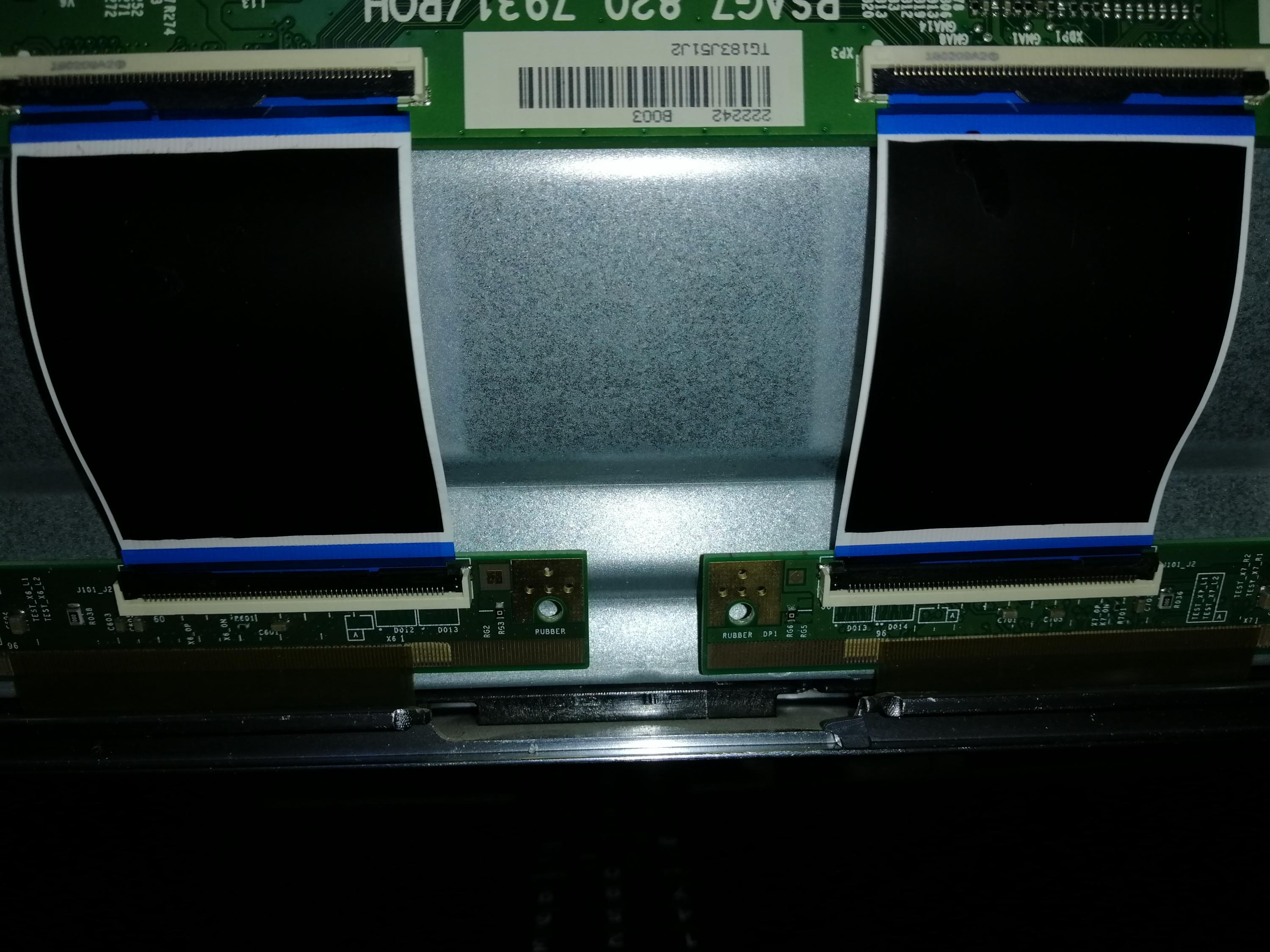

                          after you approved the LVDS and both ribbon are fine... do this test ( in order to know which half of screen are good )
                          1- disconnect LVDS from main boards side... fix your jumper 12 V to T-CON fuse ( use yours original T-CON )t
                          2- disconnect only one ribbon cable ( from T-CON side) of the half screen which it show at yours Video bright line
                          turn on the set and upload photo
                          if- its clear color pattern or one color ... turn off the TV wait little to discharge.. then reverse the ribbon ( connect the bad side and disconnect the good one ) Note : always disconnect ribbon from T-CON side then turn on and let see photo too
                          in case both side are not good displaying..... try do the test same way with yours donor T-CON.

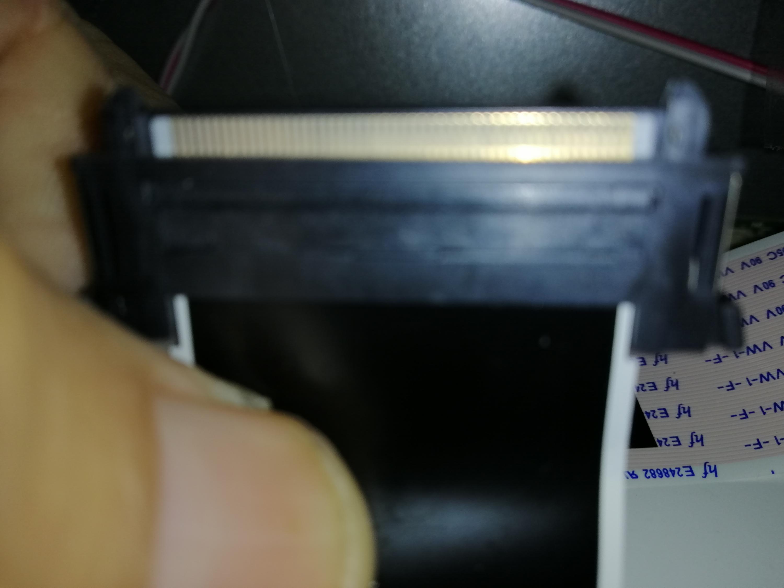

                            #113
                            Re: Hisense 50P6
                            Thanks Diah....

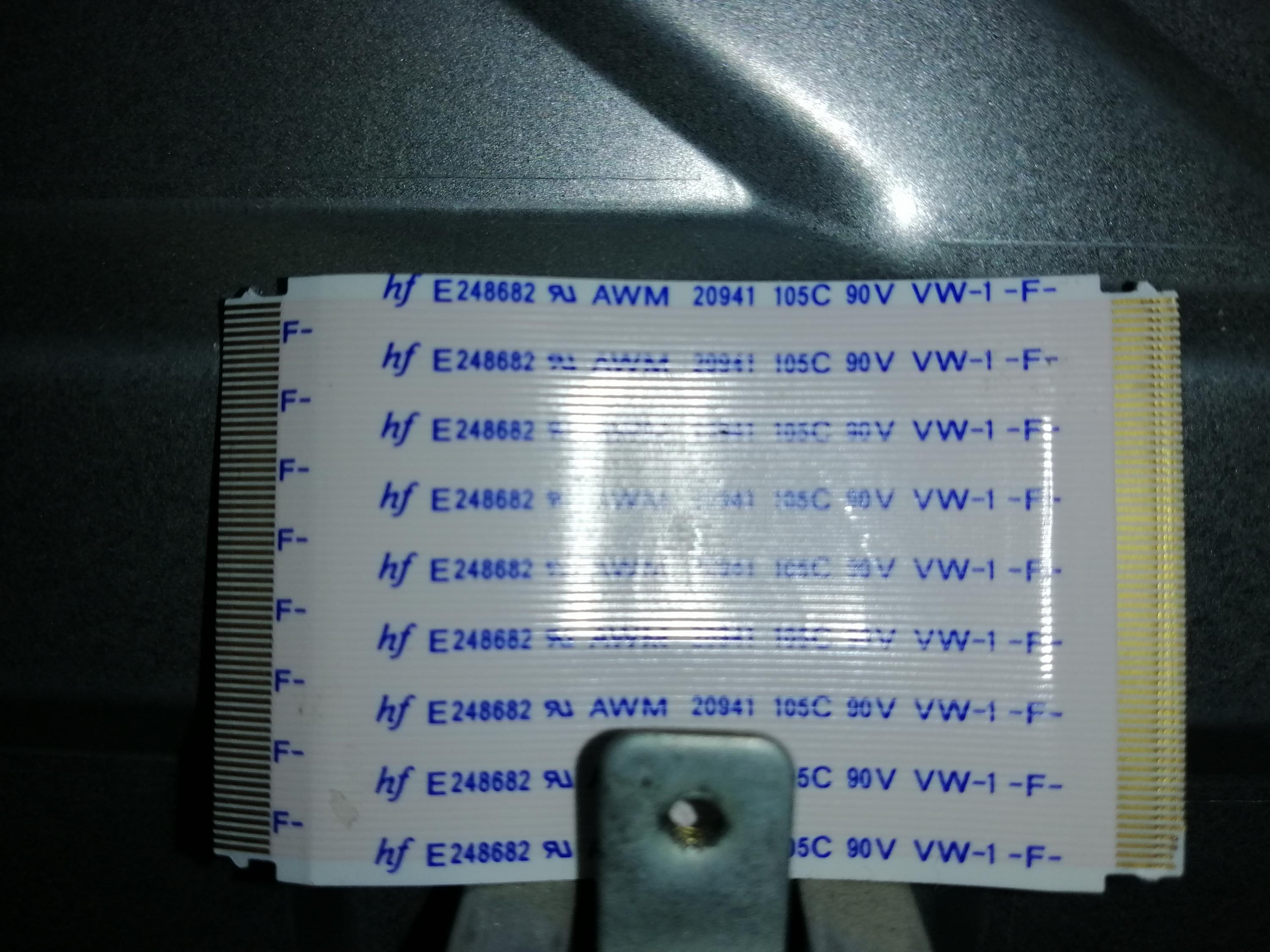

                            I think you have pinpointed me to a vital area, as I think, one set of ribbons between the tcon board and the edge board is damaged?
                            I do not have any different small cables from those donor boards for these little strips
                            Could this be the problem you have had me searching for?
                            Should I be searching for a place to buy a replacement strip?
                            Thank you

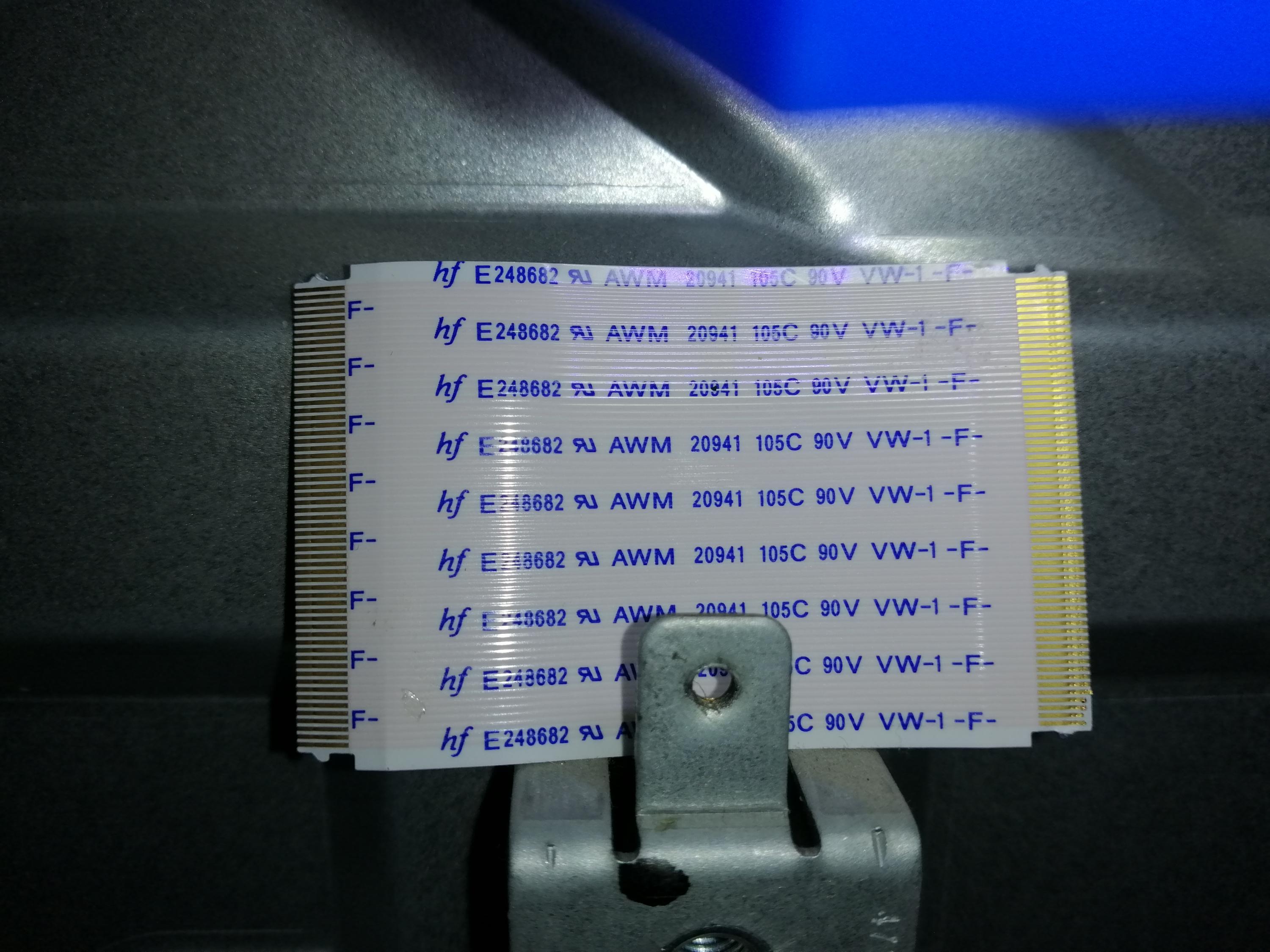

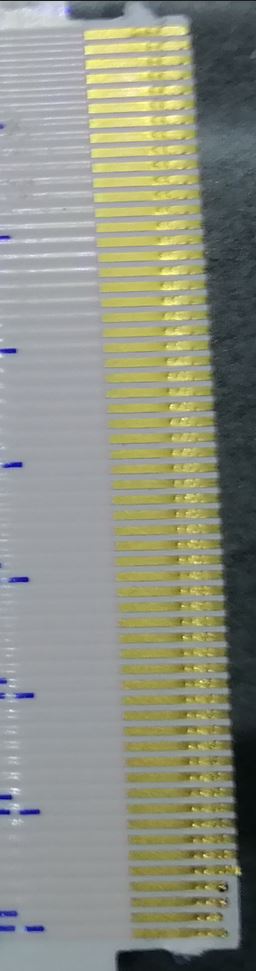

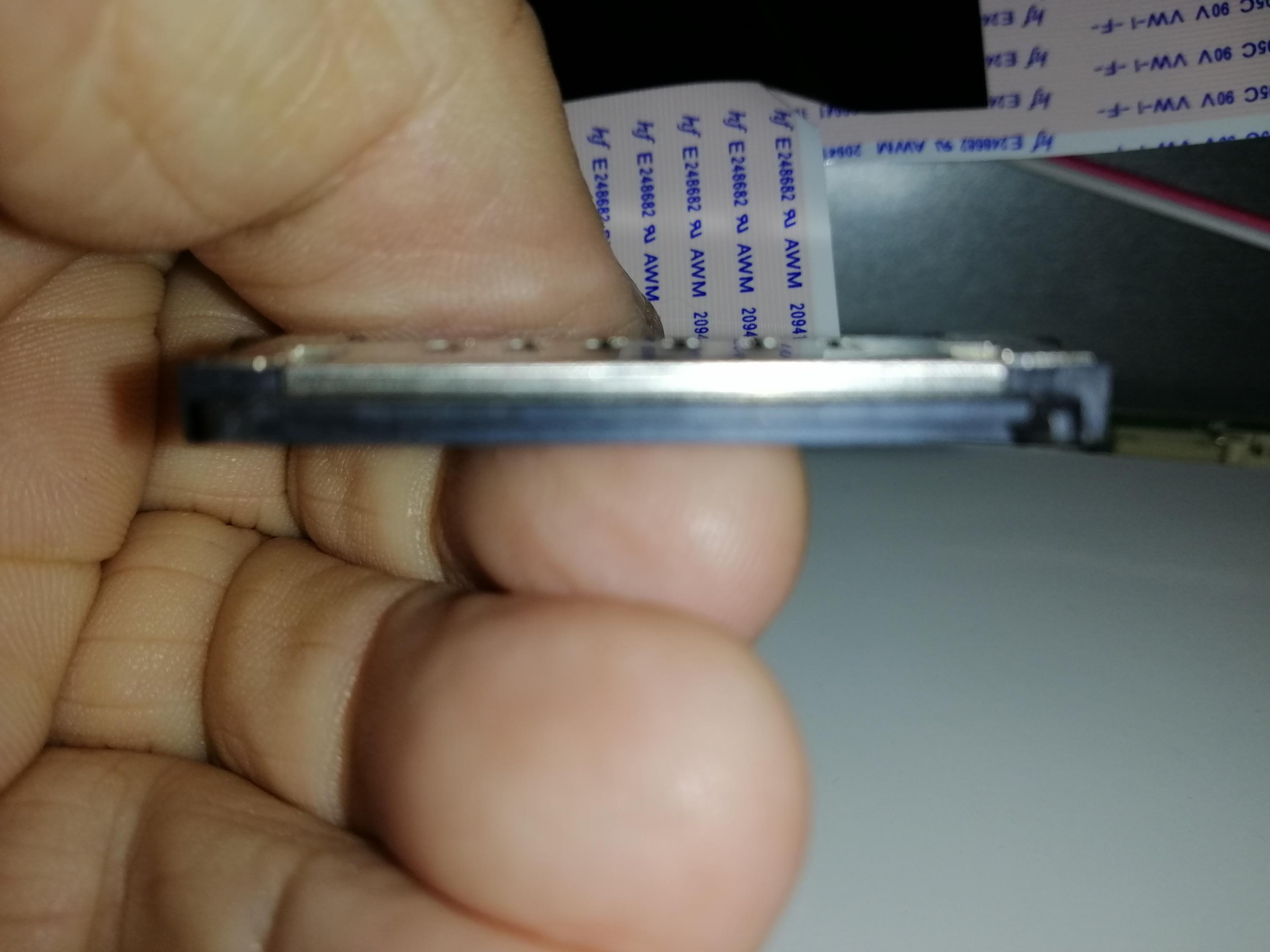

                              #114

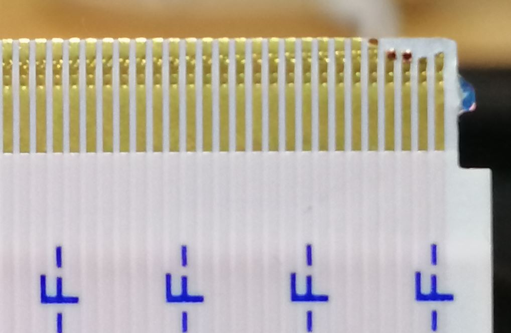

                              Re: Hisense 50P6

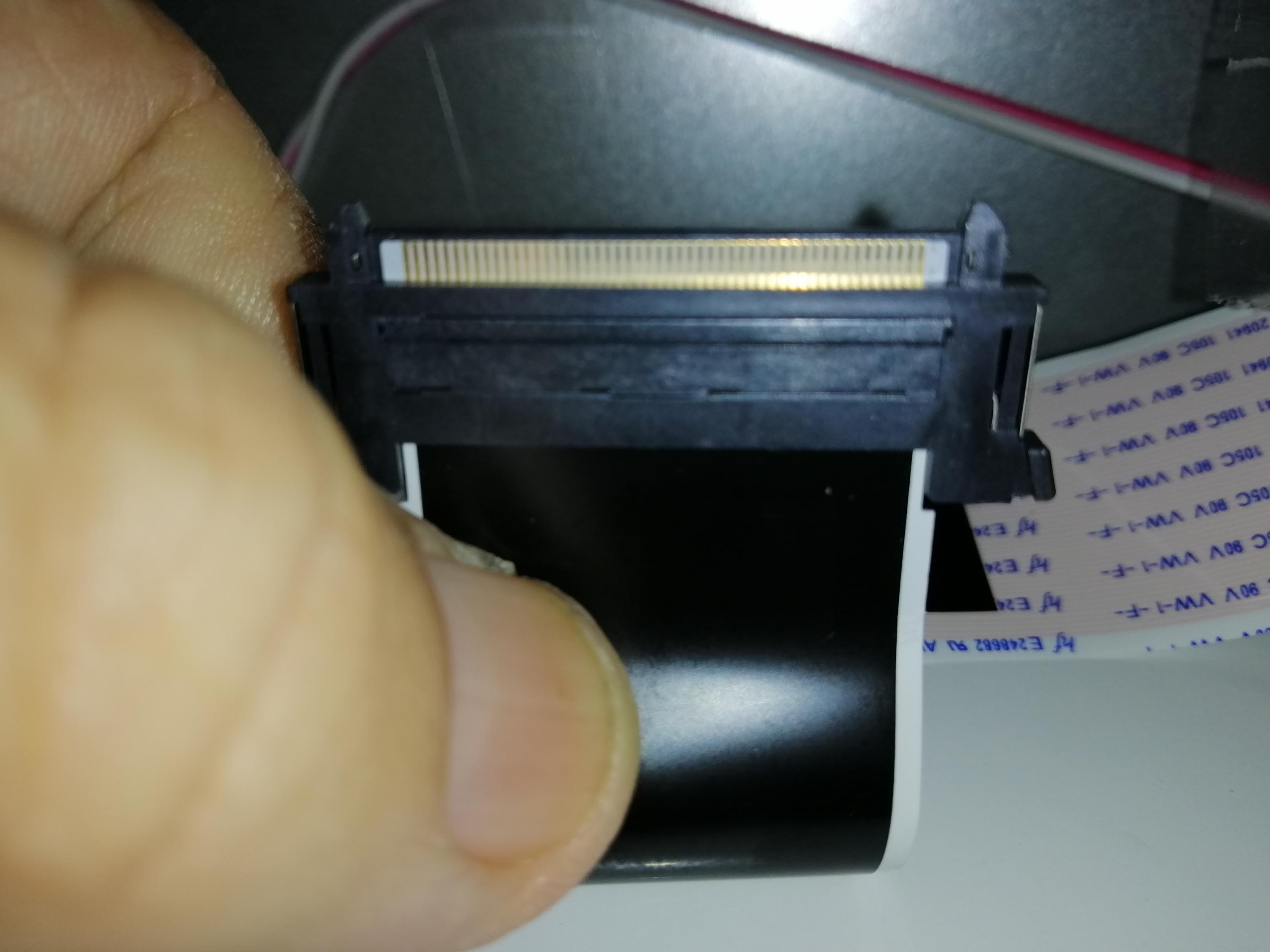

                              Blown up pins
                              This is what I am googling for
                              60 pin E248682 AWM 20941 105C 90V VW-1-F-
                              Is it a hook type , some say forward/reverse....I think mine is reverse(??) but mine has all the writing on the pin side, and the other side is black with blue hook top and tail
                              Confusing to a newbie

                                #115
                                Re: Hisense 50P6
                                Blown up pins
                                this one damaged. don't use it and don't use any at same fault shape in future
                                same as this & this

                                  #116
                                  Re: Hisense 50P6
                                  ribbon cable are straight pins 1-1 not reverse one and never being reverse same to LVDS

                                    #117
                                    Re: Hisense 50P6
                                    you have this one look in good shape... you can use it ( one ribbon only ) to do the test i wrote to you at post #112

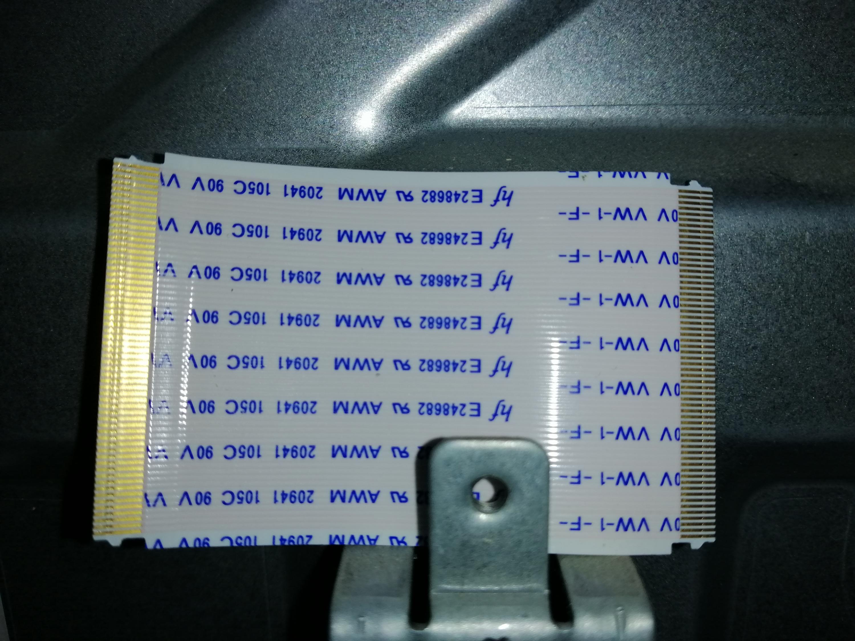

                                        #119
                                        Re: Hisense 50P6
                                        Better photo
                                        Found this...cripes they are dear???
                                        https://www.ebay.com.au/itm/35424522...Bk9SR9DMl8yCYg
                                        Will try your test....... (you have this one look in good shape... you can use it ( one ribbon only ) to do the test i wrote to you at post #112)........ tomorrow

                                          #120
                                          Re: Hisense 50P6
                                          Better photo
                                          right now don't buy ribbon.. just do the test but be careful don't damaged the good one too....
                                          later if you are at the right way again... will tell you how we can fix ribbon ( ONE TIME TRY PLUG IN )
