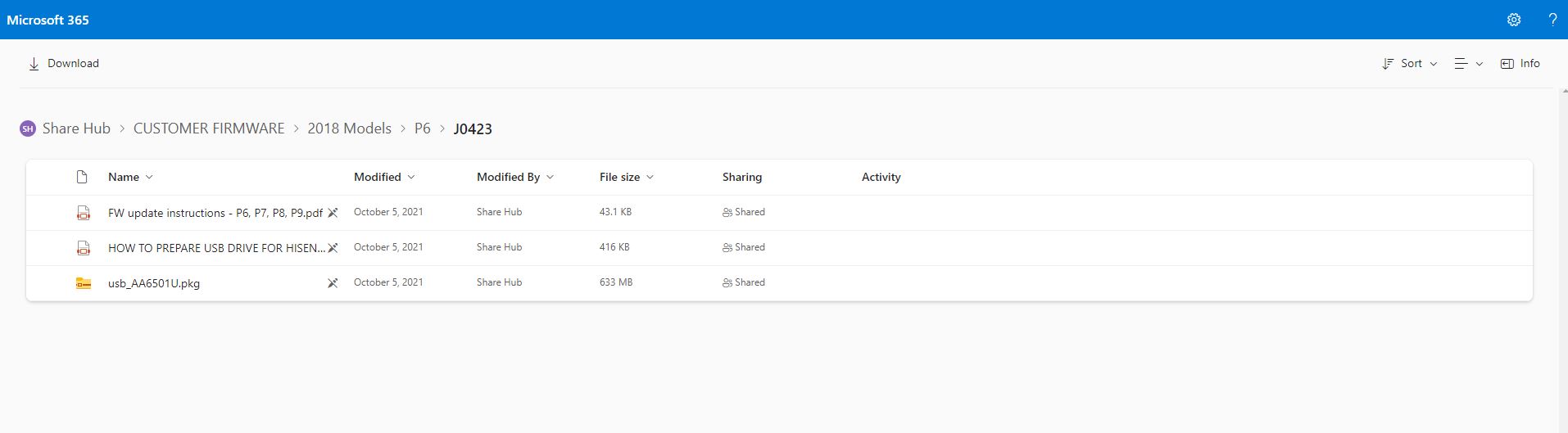

    Originally posted by viewerau
    When I right click the file,(my link) it will only allow these options
    Preview
    Download
    Copy to
    Details
    If I select Copy to...I can't seem to save it
    If I download it, it turns into this zip folder
    If I extract then, it just comes back with all those folders again.
    My apology for not understanding how to simply grab that one file
    HELP....
    Rename it (extension .rar to .pkg) to get the file : usb_AA6501U.pkg

          • viewerau
            • May 2020
            • 315
            #65
            Re: Hisense 50P6
            manual update.......cannot do that nomoresonys as the tv is stuck with the lines on it, and I cannot see the menus.
            I have uninstalled all my rar, onezip, etc apps...still won't let me move the file anywhere

                • viewerau
                  • May 2020
                  • 315
                  #68
                  Re: Hisense 50P6
                  I uninstalled all my apps that do zips, rars etc, and then downloaded it, and it saved as the file.
                  Hopefully this looks right?

                    Ok, so is that the first file after you extract? then you should be able to move that file to your usb drive, right?
                    • viewerau
                      • May 2020
                      • 315
                      #70
                      Re: Hisense 50P6
                      It is the third file from the Hisense link.
                      Putting onto usb now
