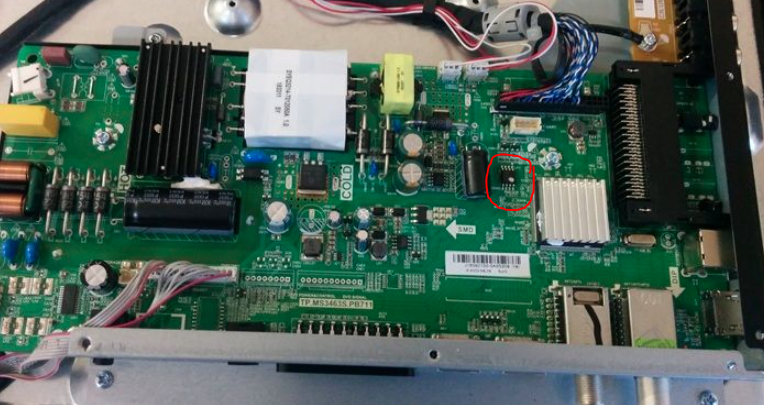

    I have a TP.MS3463S.PB711 that is boot looping. Immediately you apply power the standby LED turns white but it doesn't start up. After about 30 seconds it goes red for a second and then back to white.
    I have 40v for the backlight but no boost. Pin 8 (PWM) for the backlight boost is 137mV so it is off. DB101 is generating the 12v rail. The 5v rail is produced on LD1, the 3.3v is present on UL1 and the 1.2v is on LD2.
    We appear to have all the power rails, no short on the backlight or anywhere else I have checked but she will not start up. Any ideas? Thanks.

    Re: TP.MS3463S.PB711 Start up loop
    Maybe it's in the firmware.
      Thanks. I could take the NAND off and get an adapter for my TL866ii but I can't find a NAND dump for my particular model of TV. Any idea how specific these NAND dumps are? I am thinking about screen resolution etc. Cheers.
      My TV is a Sharp LC-32CHF5111K
        There is no Nand, there is SPI Flash 25Q64, put your dump here, I will check it.
          I thought it was in the TSOP48 and the underside.
          Well that is interesting because this board has no IC populated there and neither does a donor board that I harvested some backlight parts off but never touched.
          I wonder if there are different versions built on the same PCB?
          I can't seem to embed the picture but it is at https://photos.app.goo.gl/56uAEviUx19RbNVKA
            Yes, it turns out there are two versions, with spi and nand firmware.
              Any idea where I can source the NAND dump so I can reflash it? Pretty good chance it is that.
                search the form we do have user from Philippine faced same issue.. it was one smd Dc-DC regulator close to main cpu defect.
