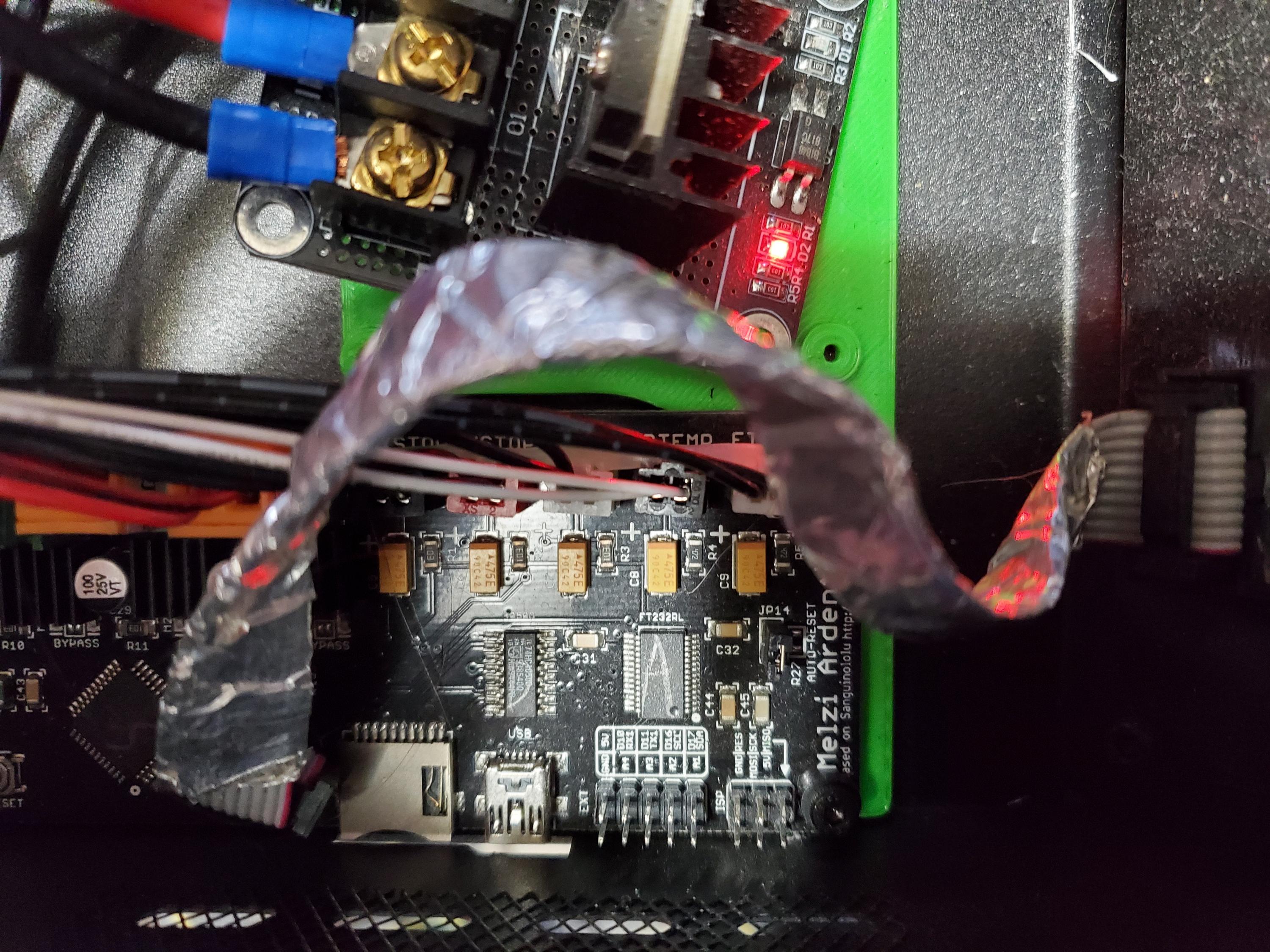

    Anyways upon setting it up at my place I basically now have a nice paper weight. Sister says its probably a loose wire but I have very little understanding of this electronic device.
    I have no screen (blue) at all (no light) on the power brick/assembly. So no error codes or anything. I have power at the power supply. I will try and get values in the morning. (This has been on my printer desk for a while)
    I am wondering if the MOSFET upgrade went bad or its a loose wire. So I am needing some guidance on how this thing works. Or possibly some images of the brick assembly internally to confirm things.

      There's nothing magical about 3d printers, they're not much far off from what an old dot matrix or daisy wheel printer is like.
      Unless it's something egregious like a obvious short or open, or bad PSU, it'll be tough to fix as you'll need to carefully scrutinize every component and part. Stuff should show up on the display when powered up, regardless if the motors or end travel switches are connected. You probably will end up needing to replace the board, though most of these 3d printers are very similar and should be easy to swap with another of a different make.

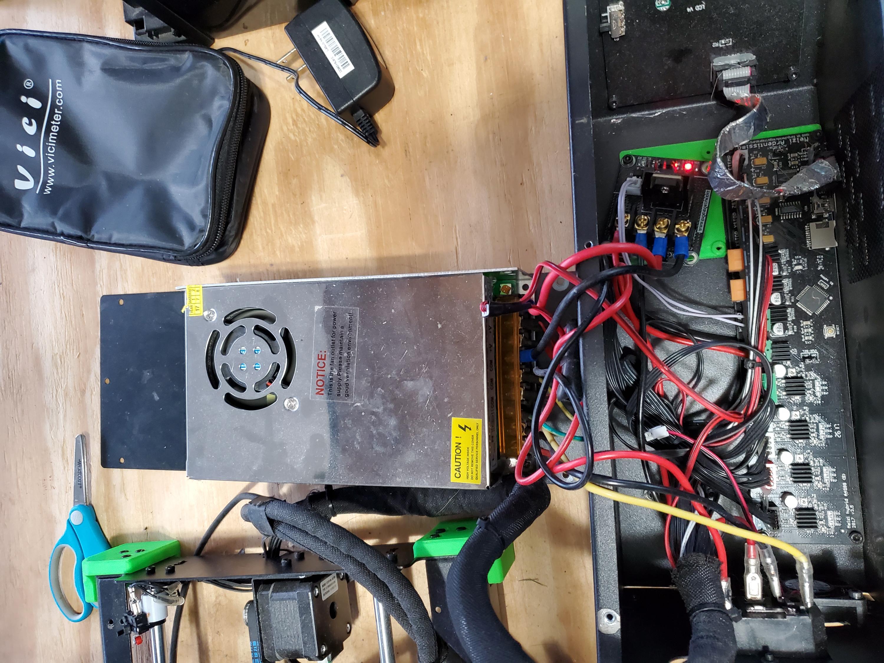

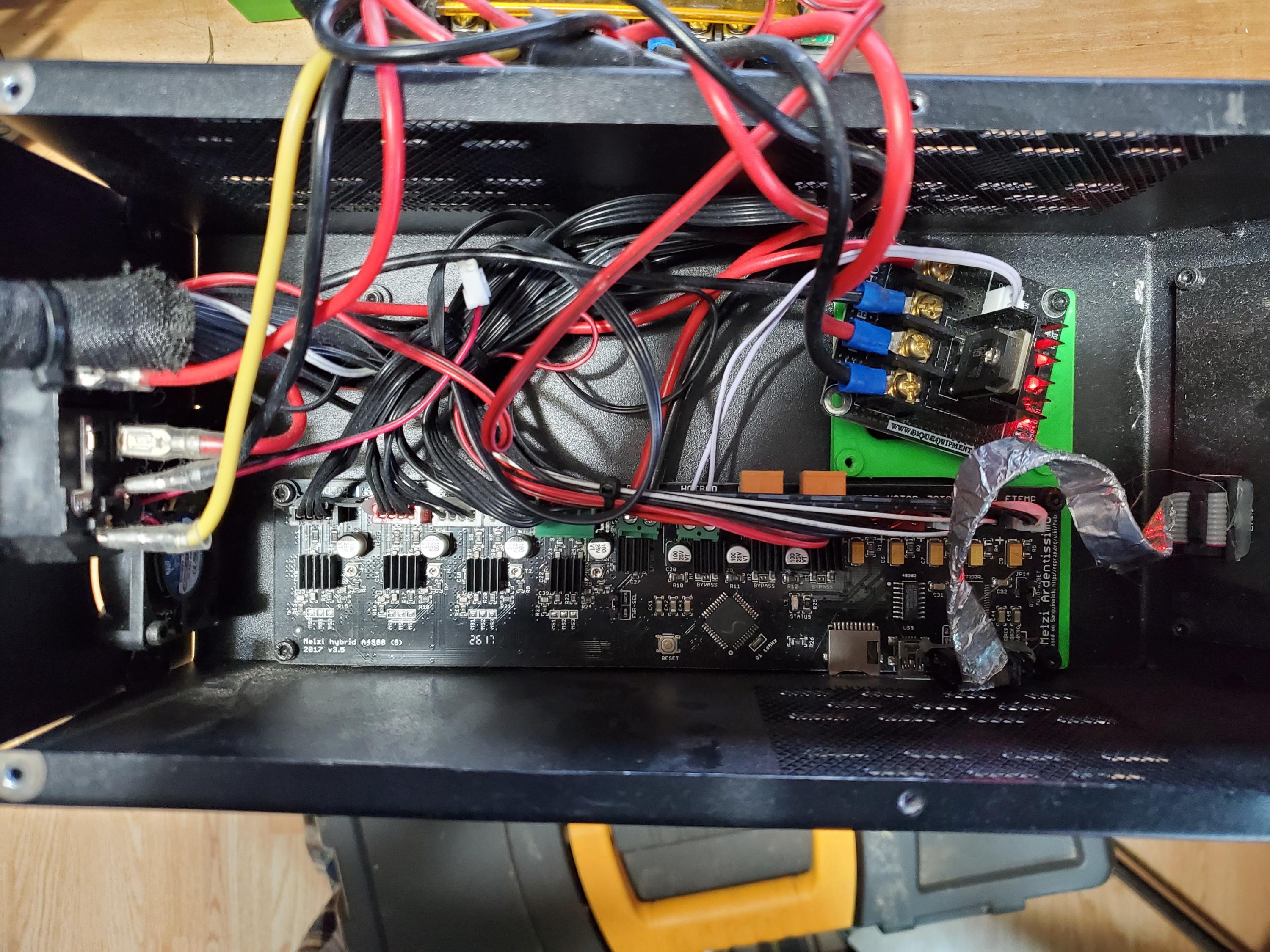

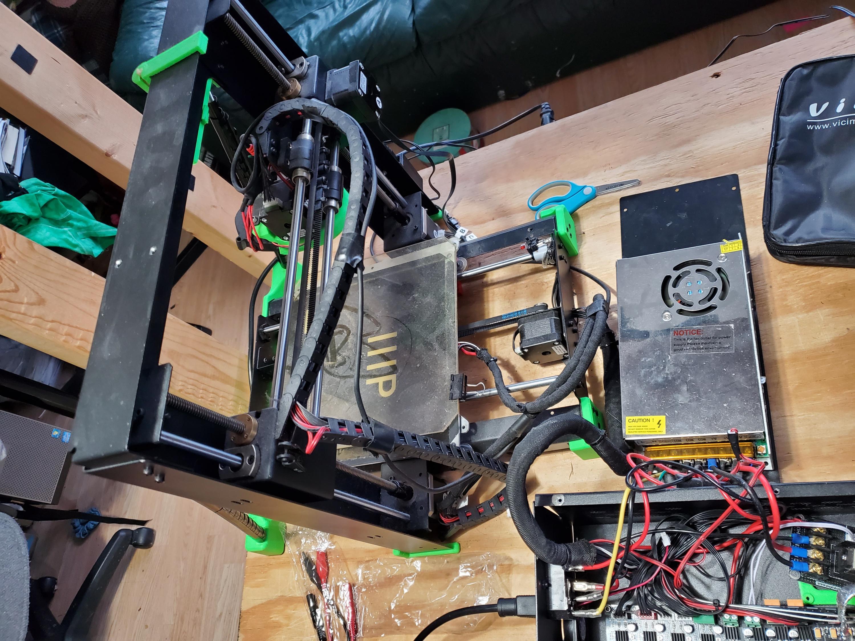

          I got on this over the weekend and it is now running again;
          Basically it appears that some glue gun material got on the screen cabling at the connection just right to allow it not to make connection. Also the switch on the screen appeared to be flipped to the wrong point.
          All I ended up doing was remove the cable, clean the glue gun material off the board. It actually got between the pins (how I am not sure). I reseated the cables again. Flipped the switch. Unplugged to remove all power from the unit. Plugged it back in and the screen powered back on.
          I do see a couple things I do not like on my sisters work. Please note my sister claims she did not do the glue gun mess. I am going to lengthen the cables on the MOSFET Board slightly (3 more inches - new cable correct length) and I am going to hook up the extra 12 volt small fan thats installed but not powered. This will allow maximum cooling in the case. I am also going to install the board correctly (screw it down) and then screw everything back together properly (close it up).
          I did successfully print a small figurine for the kids which proves to me it works.
          I have included the pics and will make the run to the local Home Depot tomorrow.
