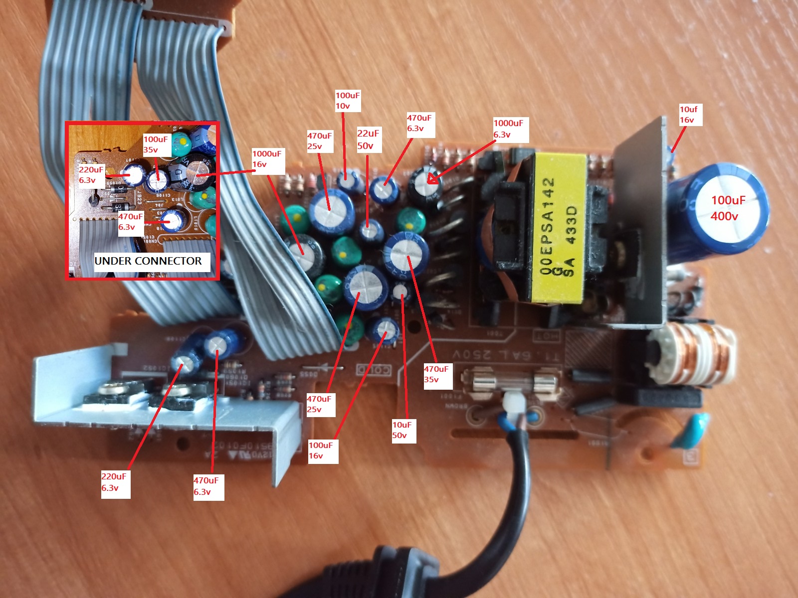

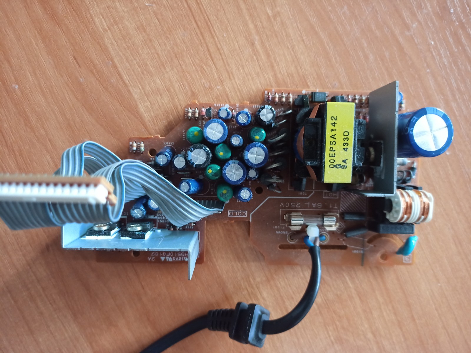

    I have a Hitachi DV-PF4E VCR/DVD Combo unit which is dead - no power.
    Last used and working ok about a year ago.
    Then it has stood unused in the tv cabinet unplugged from the mains.
    I went to use it this week, plugged it in and nothing happens, no display/lights, no response when pressing standby button.
    Opened to check and fuse ok, ac supply ok, caps all look ok, other components & pcb look ok with no trauma visible.
    Any cause for it to just go 'bad' by not being used for a year?
    Thanks,
    Mark

      Thank you for your reply.
      There are three which fit the range;
      10uF 50v
      22uF 50v
      10uF 16v
      See 3rd attached pic with capacitor values shown.

        Re: Hitachi DV-PF4E VCR/DVD Combo - no power
        no 3 picture top right cap have you checked or changed that
            Your power supply is slightly different than the one in the service manual, I'm not sure if the designations are the same as yours.
            Look for C1032, Likely the (10µf/16v), replace it, then check the two resistors R1011 (1.3Ω/1w) off the source pin of the mosfet and R1043 (2.7Ω/1w) between the + of the 100µf/400v cap. and the transformer, if the resistors are ok, it is likely the power supply is just not starting up.
            Also check if you have any voltages on the two plugs, CL051A and CL052A, There is also a zener diodes (D017) in the secondary, check that it is not shorted.

              probably the 10uf cap next to the big 400v one,

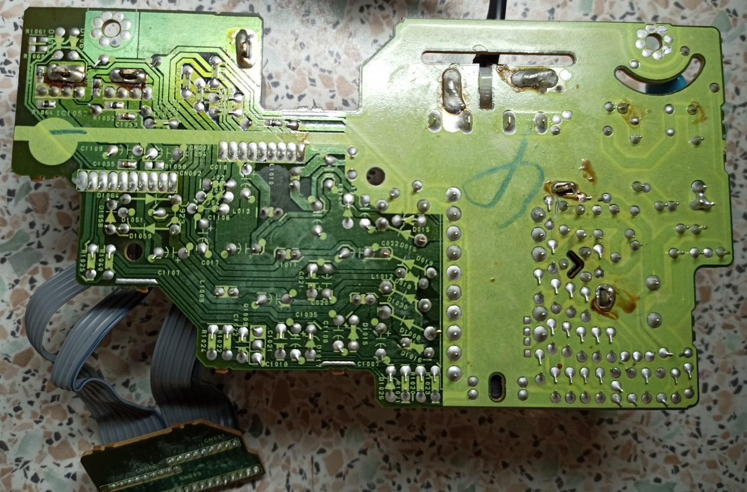

              i cant see a chip - got any underside photo's ?

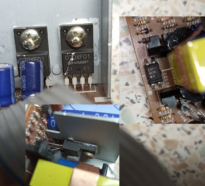

                A number on the pcb which looks like a P/N: BH951 0F01 02
                C1032 is the small cap in top right as mentioned by vinceroger69 & stj - it is 10uF 16v.
                I'll try to test it out later or tomorrow.

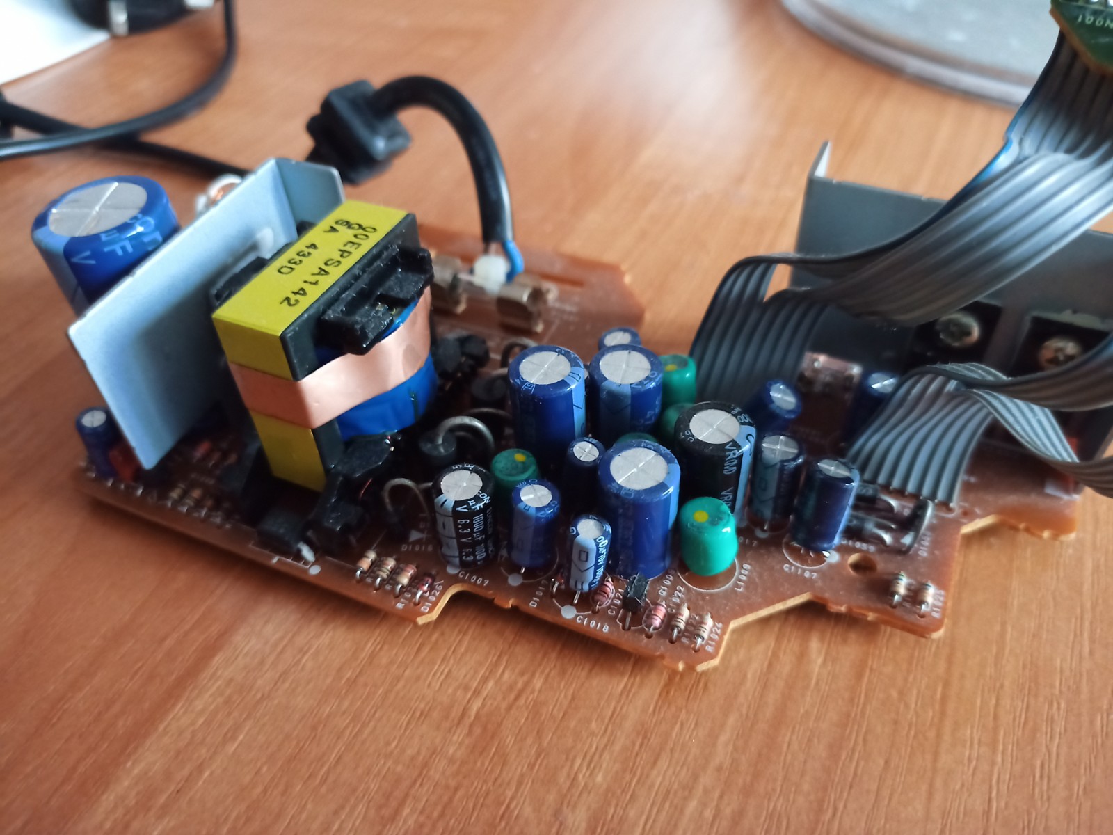

                Yes the small cap next to the 400v one is the 10uF 16v one.
                No chips on it just transistors, large mosfets (?) and a 4 pin rectangular thing - see pics.

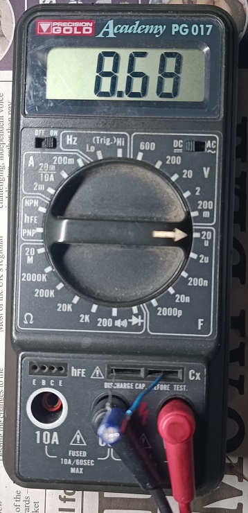

                    I've finally done some testing.
                    Capacitor C1032 - top right - 10uF 16v removed and in my multimeter;
                    Starts at 8.88 and reduces settling at 8.68uF;

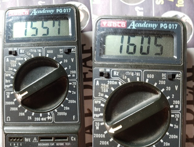

                    Resistor R1011 (brown|orange|gold|gold) shows a changing value in the 2000k range - 1557k, 1605k...

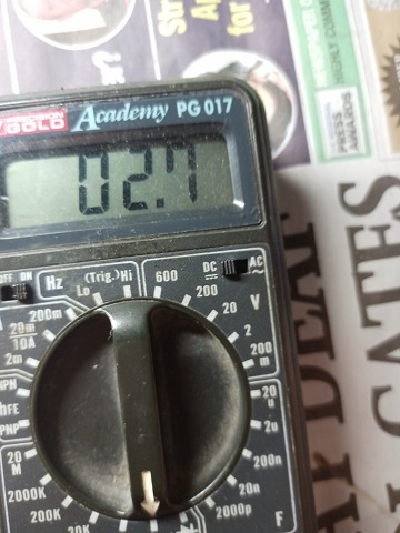

                    Resistor R1043 (red|purple|gold|gold) shows 02.7 ohms.

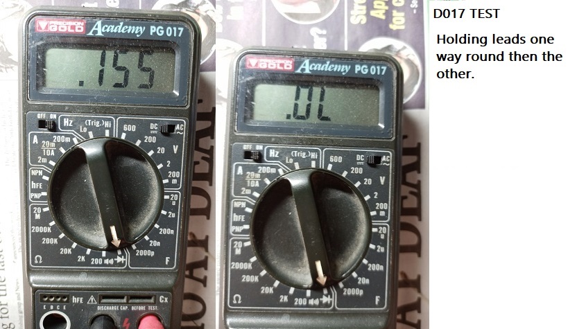

                    Diode D017 shows .155 one way and OL the other way;

                      the capacitor could of failed esr wise the resistor r1011 are you sure of the colours as the calculator here says 1.3 ohms

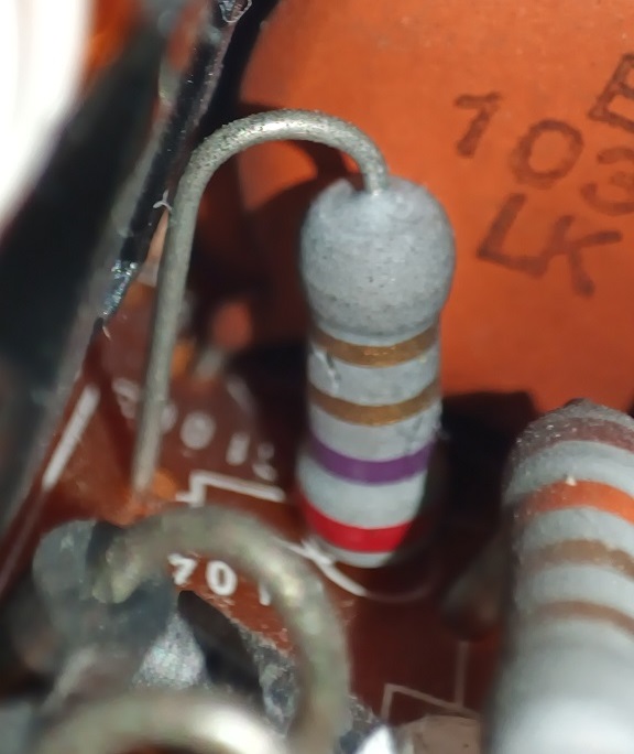

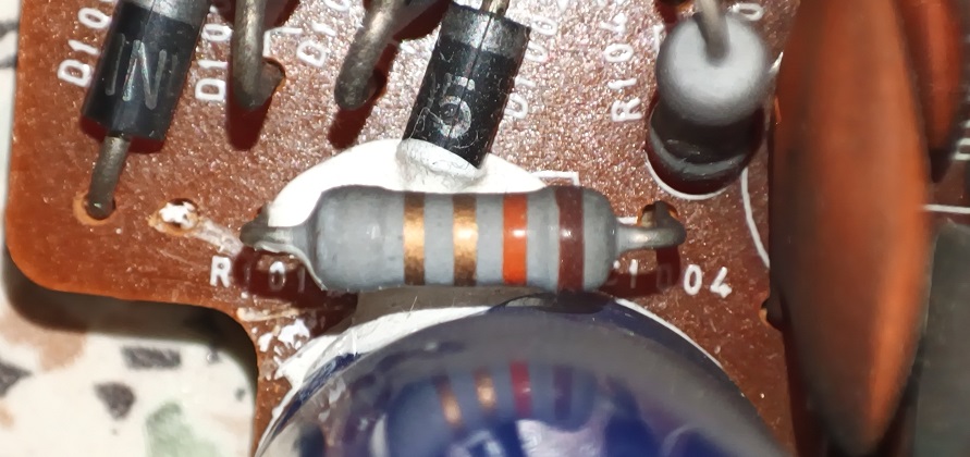

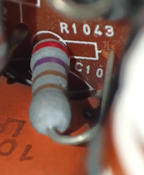

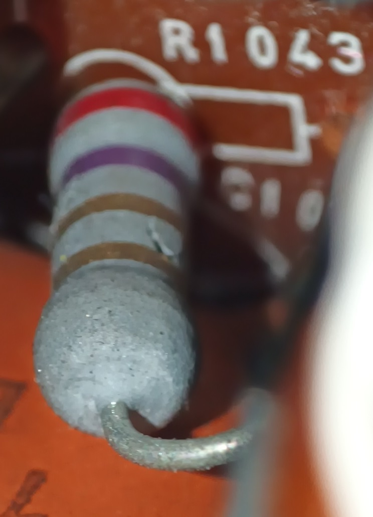

                        Yes, close up pics below.
                        R1011: brown - orange - gold - gold = 1.3
                        R1043: red - purple - gold - gold = 2.7
                        It has what looks like a couple of cracks on the body;

                          in post 10 you say Resistor R1011 (brown|orange|gold|gold) shows a changing value in the 2000k range - 1557k, 1605k...it should be 1.3 ohms
                              Sorry my mistake I mixed them up!
                              I've probed them again and getting yet different readings
                              I'm going to remove them from the pcb to test.

                                  It looks like R1011 is open, So I suspect Q1001 (2sk3566) is shorted, if it is shorted, Q1003 is likely bad as and likely more components in that circuit
                                  R1043 (2.7Ω) is ok. C1032 is BAD
                                  With the circuit not working, the main filter cap can remain charged to around 300vdc, this capacitor should be discharged (using a resistor or incandescent lamp can work) If it is not discharged, resistance readings in the rest of the circuit can be effected, not to mention getting a shock or the risk of damaging the power supply
                                  These power supplies are difficult to repair at the best of times, if any component is out of tolerance the circuit won't oscillate
