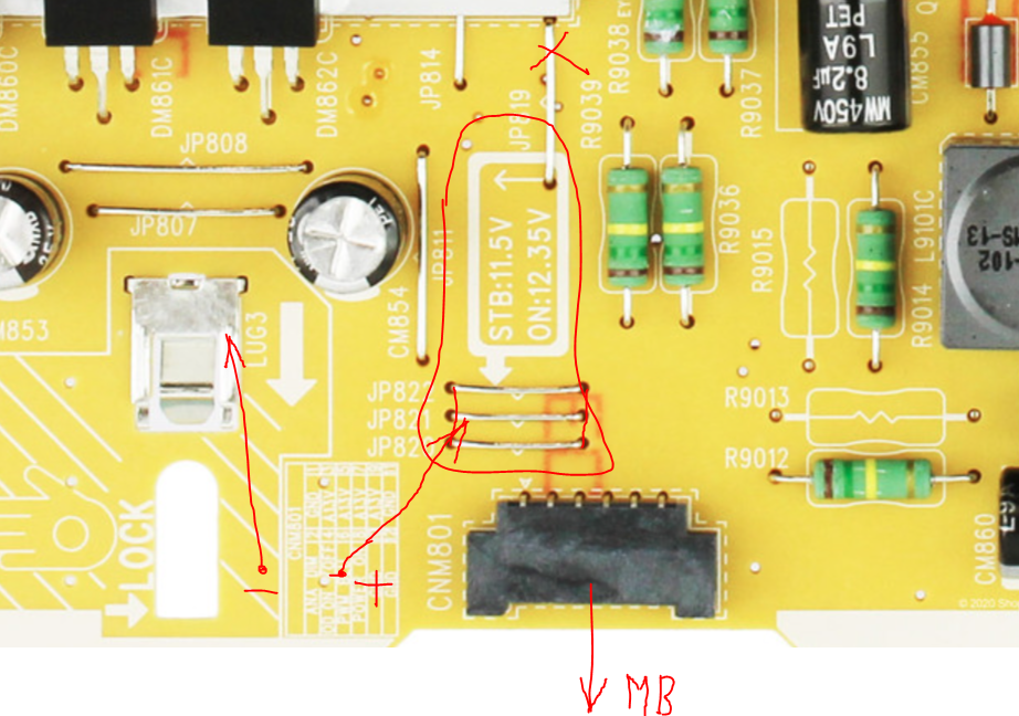

    HI, everyone needing a little help I have a 70 inc tv that has the turning on and back off issue. changed the main board no luck, checking the power supply and JP819 is only showing 4v i have 12.90 standby voltage can i assume that the power supply needs replacing. any help will be greatly appreciated.
  • lotas
    • Jan 2016
    • 4633
    • Russia
    Re: Samsung un70nu6900 power supply issue
    You have to check that. And disconnect the cable that goes to the motherboard and plug it into a power outlet, the backlight should light up.
          In the image your showing check jp821 to ground for voltage it shows 12.91.
                        On 8 pin. should not be 12v, this is POWER ON (there is a signal to turn on the operating mode from the motherboard, and the jumpers are also connected to the 3-5-7-9 (12v) connector.
                          If voltage is 12.91 at the jumper shown in the image does this mean power supply is good.
                          • lotas
                            • Jan 2016
                            • 4633
                            • Russia
                            Yes, if the unit were not working, then these 12.91v would not exist and the backlight would not light up.

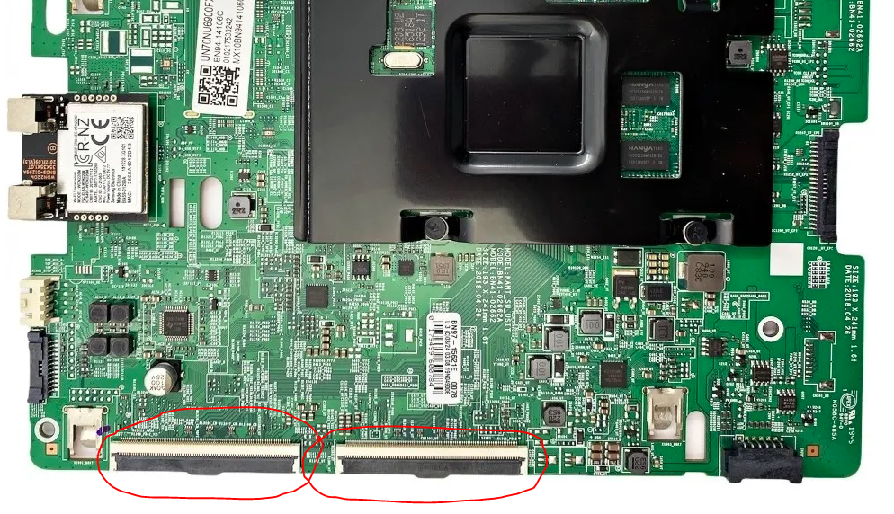

                                Try disconnecting these cables connecting the brackets, one at a time and with different motherboards (from your own and the one you bought).

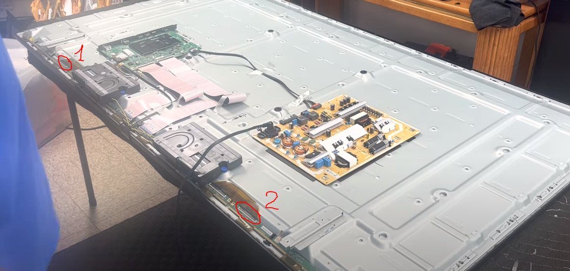

                                  In these models (NU series), the panels (the matrix itself) die very often.
                                    with disconnecting these one at a time am I looking to see if the tv stays on?

                                      • Russia
                                      Yes
                                      Here is a video that can help determine the malfunction (and all the malfunctions of these models are panels).
                                      https://www.youtube.com/watch?v=atNmhu7HMj0
                                      https://www.youtube.com/watch?v=zGAVbMQrSek
