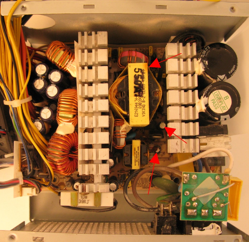

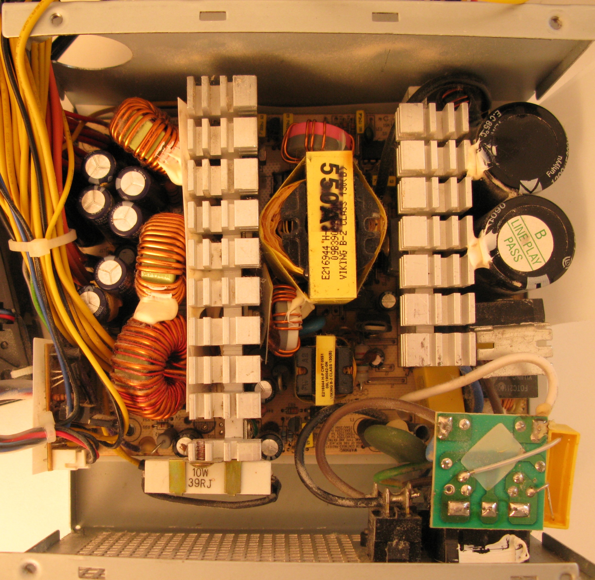

          Thanks guys, I appreciate it! Attached is a pic of the insides for reference. The three bad caps (one leaking, two domed) are near the bottom of the left heatsink.
          I'm having difficulty getting the board out because the lead lengths are pretty short and there's not much room to work... do people typically desolder the leads at the AC plug connection or the other end of the leads on the bottom of the PCB? Thanks!

            Re: Antec TruePower 2.0 TPII-550
            It's a matter of taste. I try not to unsolder the ac wires but sometimes it's inevitable cause they are really short.
            Hopefully many psus have a connector on the board.
            Maybe you should consider replacing also the small caps at that psu. I have an antec true power 2.0 380Watt that I fully recaped several months ago. I measured all the original caps with an esr/capacity meter and found out that 2 of the small caps (those that are near the 5vsb transformer) were completely fried, even though they didn't bulge.

              From the main board. Leave the switch and socket alone. Takes 2 seconds to resolder to board when you're done.
              Goodpsusearch is correct. Do a ~complete~ cap job on that PSU. The Fuhjyyu mains are also to be suspected. Make sure the -real- top of the cap is not bulged. Push down on those plastic discs on top to be sure. The upper one looks like it is up/domed.

                Yup, I would also be sure to replace the small caps, those a very important
                The two lower ones in the pic are for the 5VSB, might aswell get the others while you are at it...

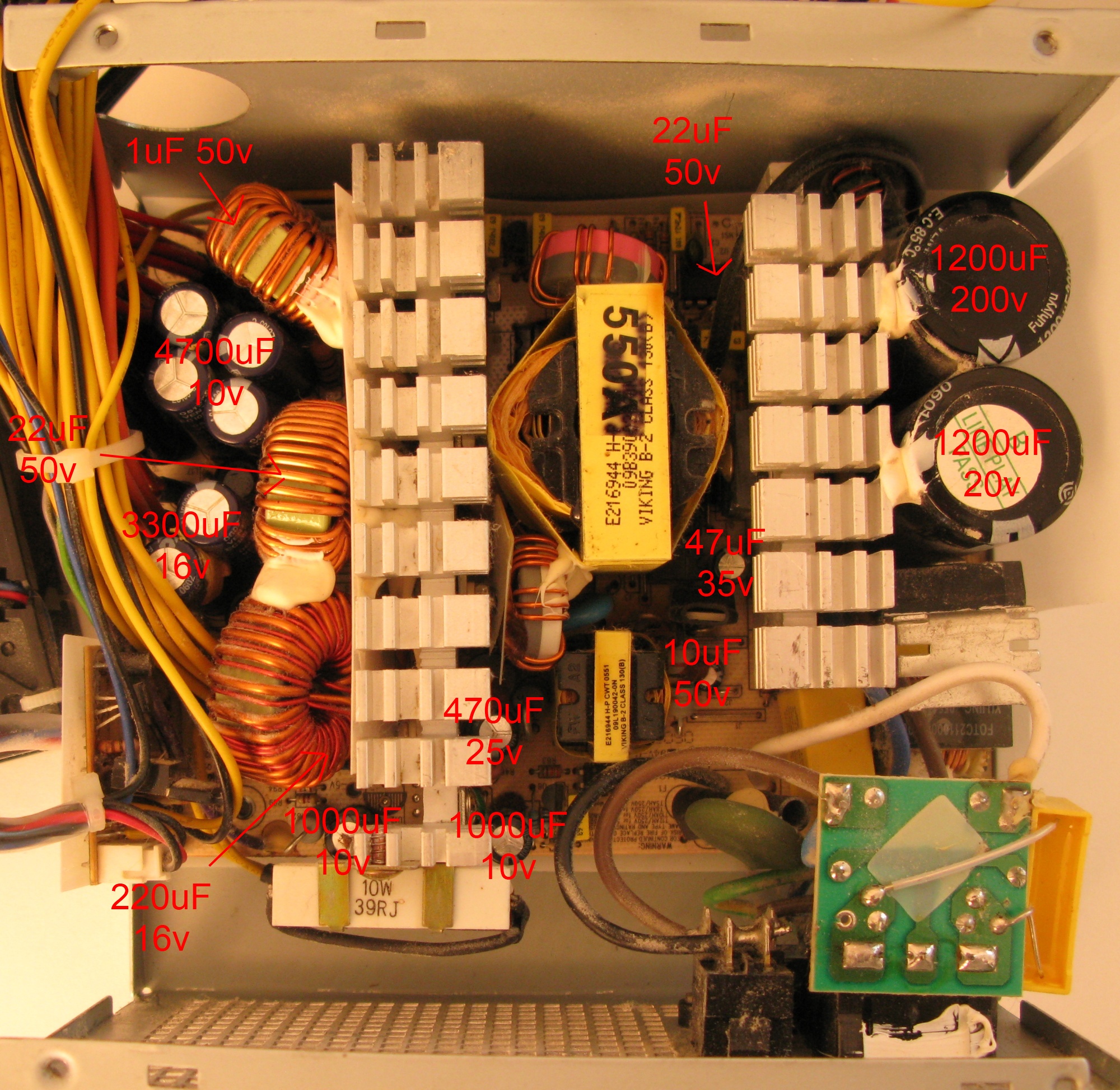

                    Thanks everyone for the great advice. I'm planning on replacing the whole set (all 15) but now it seems the two main filter caps also need to be replaced as well. I've checked and it does seem like there is bulging under the top cover on both. The markings on these two are:
                    Fuhjyyu 1200uF 200V -NEG- LP, dimensions are 25mm diameter and about 45mm tall.
                    Can someone please suggest a replacement for these? I filtered down to Panasonic TS-HC and UCC KMQ/SMQ but I'm unsure which would be the most suitable. Thanks!
                    P.S. Ouch -- those two large caps are $5 apiece! Considering I have two identical units that I will be recapping, it has me considering just buying a couple of new supplies...

                      Either series is acceptable. Both decent with SMQ having the higher ripple rating.
                      Also Panasonic's HB or CDE's (Cornell-Dubilier) SLP series. Ive used both with no trouble. IIRC, (you should double-check this) you can fit up to 50mm tall. Watch that diameter as you are at boards edge.
                      You can go down to 1,000uF and/or go up in voltage (220v or 250v) to get a good fit, if need be based on who has which one(s) in stock.

                              Thanks Toasty. Here's the list I've put together along with a marked up picture (I believe they are all correct, some I could not completely see due to angles). Some are also under coils.
                              Replace [2] 1200uF 200v 25nn Fuhjyyu LP with Chemicon KMQ 1200uF/200v (565-2959-ND)
                              Replace [4] 4700uF 10v 10mm Fuhjyyu TM with Samxon RS 3300/16v (from Badcaps.net)
                              Replace [2] 3300uf 16v 10mm Fuhjyyu TM with Samxon RS 3300/16v (from Badcaps.net)
                              Replace [2] 1000uF 10v 8mm Fuhjyyu TN with Nichicon PW (493-1747-ND)
                              Replace [1] 470uf 25v 8mm Fuhjyyu TN with Panasonic FC (P10274-ND)
                              Replace [1] 47uF 35v 6.3mm Fuhjyyu TN with Panasonic FC (P11232-ND)
                              Replace [1] 220uF 16v 6.3mm with Chemicon LXZ (565-1927-ND)
                              Replace [2] 22uF 50V 105c 5mm with Panasonic FC (P10318-ND)
                              Replace [1] 10uF 50V 105c 5mm with Panasonic FC (P10316-ND)
                              Replace [1] 1uF 50V 105c 5mm with Panasonic FC (P10312-ND)
                              Thanks for double checking!

                                Change the 47uF to a 50v:
                                http://search.digikey.com/scripts/Dk...name=P10321-ND
                                Plus it's 6¢ cheaper
                                Everything else looks fine.

                                  Agree.
                                  Use a 47uF to a 50v and everything else looks good.

                                    Will change the 47uF to a 50v and keep the rest the same. I had missed that modification in the other thread. Just for my understanding, what's the reasoning behind bumping up the voltage from 35v to 50v on this cap?
                                    As a side note, I was examining the PCB last night a little more and noticed there are some minor scorch marks under the larger transformer. I'll post a picture this evening, but is this something to be concerned about?

                                      Scorch marks might just be dried glue. There's usually not much under the main transformer, some small parts near it that may have committed suicide. Look for any burnt resistors/capacitors/diodes, etc... around or under the transformer.

                                        You can always go higher in voltage on caps. For example I have 47uf caps at 50 volts but not 35 volts mainly because 35 is a weird value 25 is a more common value but since the case size difference between those voltage caps are minimal at such a low capacitance I stock them at 50 volts.
                                        Just note that at higher capacitance's the size of the cap will change noticeably so you have to make sure the higher voltage value will fit. Also don't go too high in voltage when dealing with low ESR caps like 2 or 3 voltage steps up on the datasheet since ESR will rise as the working voltage increases.
                                        Minor darkening of the board around components that heat up like transistors or transformers is normal.
