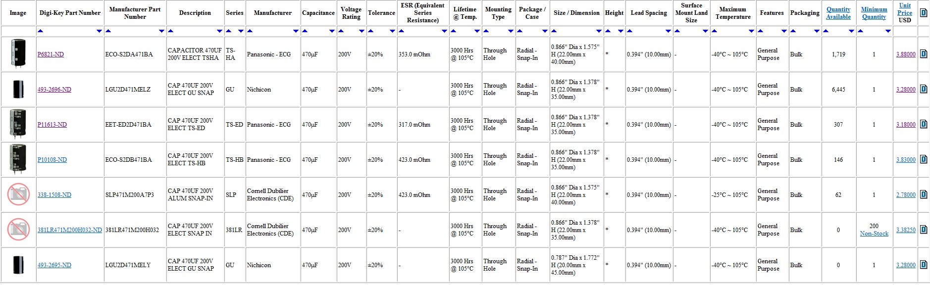

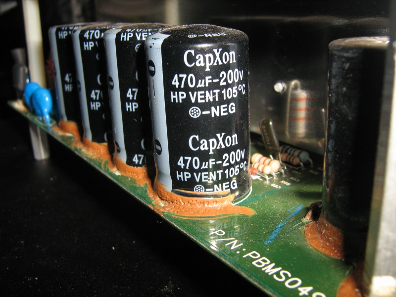

    i a CAPXON caps in my creative s750 speakers power supply and i want to replace them tio a beter one.
    the spec of the caps are CAPXON 470UF 200V , VENT , 22MM diameter (0.86") , snap in. i added a picture.
    I searched in digikey and found a few that fit please help me choose (i add a picture).
    if you find a beter one in mouser or ebay that fine .
    thanks

    Re: CAPXON replacement caps for PS
    I've used the Panasonic TS-ED series on several occasions, and haven't had any problems.
      I'd either get 'em here through TC, or get Digikey part number P11613-ND.
        Pretty much any of the capacitors in your list are okay.
        I would just pick the TS-ED, since the price is okay and these are well known high quality parts.
        Since audio equipment doesnt operate at high average power levels, stress isnt that great (CapXon doesnt need any to fail, time is enough). If its running very hot, 105° rated capacitors would be a good idea, otherwise any good quality 85° unit will be sufficient.
              Good quality 85° as in, for example:
              BHC ALC10
              BC 050,053
              Epcos B43511
              Hitachi HP3
              Nichicon LGU, LLC
              Panasonic TS-UP, TS-UQ
              and a lot more. Also, most large screw terminal capacitors are rated for 85°, too. And all these last very long...

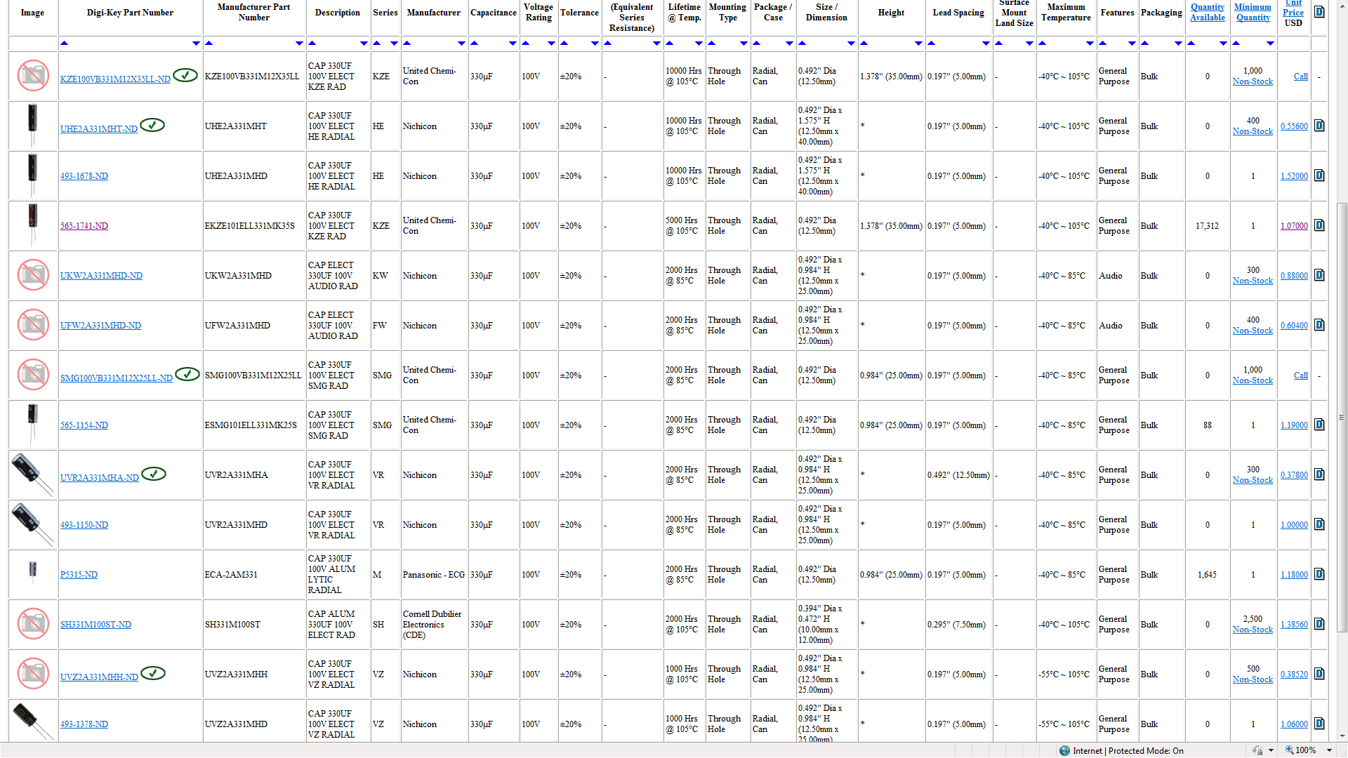

                thanks for you all. i have two more caps of capxon that i need to replace:
                Capxon 330uf 100v 85c 12mm dia.
                i have this list i'm thinking to replace it with 105c cap is this ok?
                i add the list from digikey
                what whink about the UHE2A331MHT-ND (second the list) ??
                  Yes, Nichicon HE is all right. Long life and known good quality.
