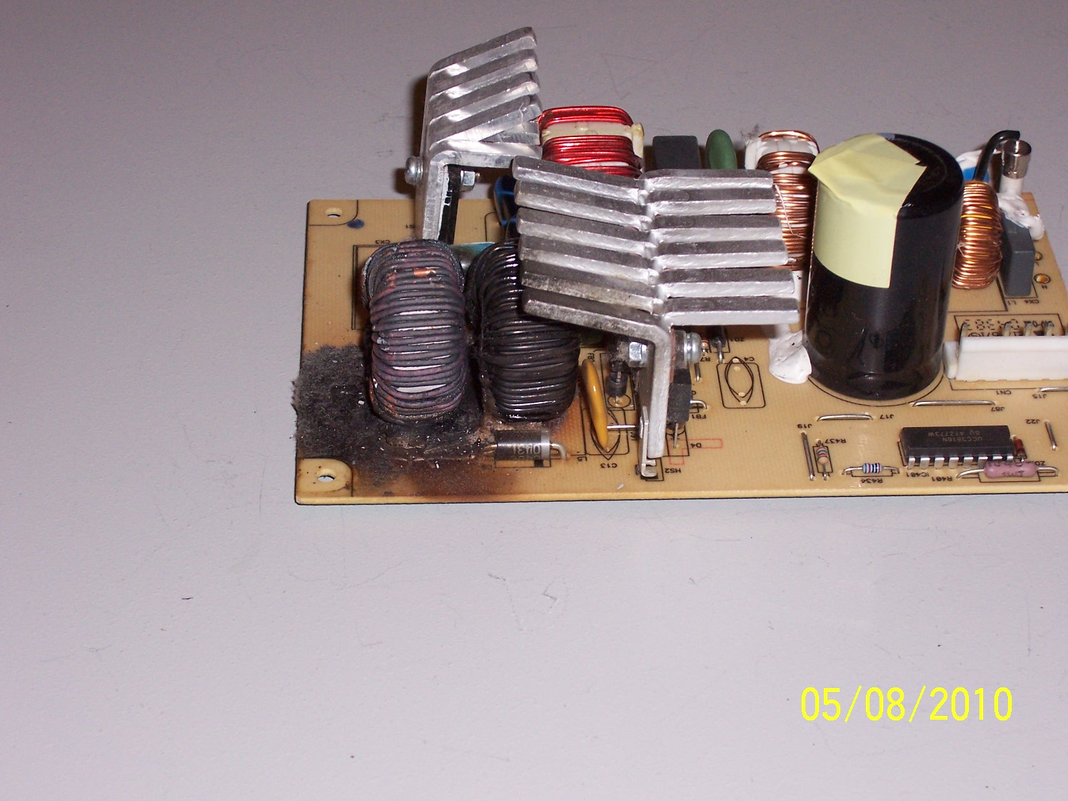

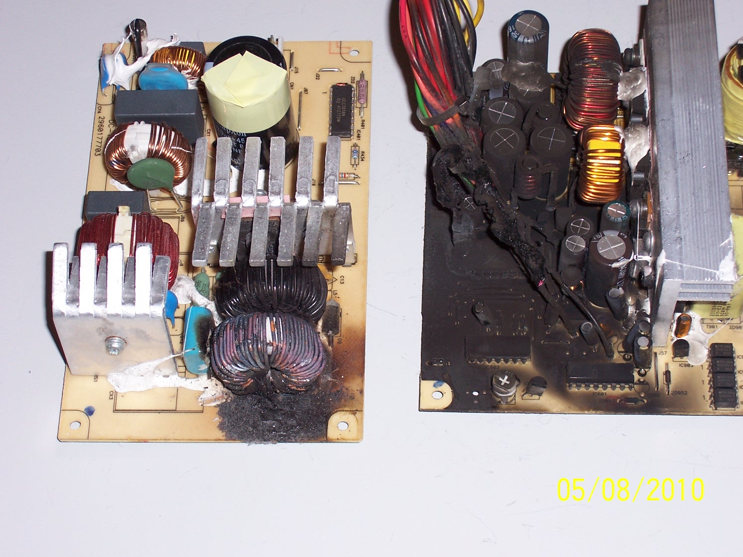

          Using more fan power to blow the hot air out does not get to the root cause of the problem. Where is the extra heat coming from??? If extra heat is coming from power supplies with APFC, then we may be looking at a new problem area which needs to be seriously addressed.
          I have recently repaired a HP DPS-340CB A which had a blown APFC board. One of the APFC MOSFET transistors was shorted. A film capacitor was ruptured and damaged. Two coils wired in series (used as APFC coil) were both fried. And fuse blown. If FET shorts, fuse blows, and psu goes dead. So WHY were these coils burned so badly? Look carefully at the photos of the two coils and you can see that the heat damage of these two coils is different. One was much hotter than the other. With that much heat damage, I was not sure if the torroid cores would be affected or not, so I wound two new coils on different cores. Power supply now works, but those two new coils get hot. Just run the power supply about an hour, turn off power supply and wait a minute for caps to discharge, then touch the coils (quickly). They are very HOT.
          I would think that a HOT APFC coil would indicate lots of current draw in the APFC transistors. Perhaps the main capacitor (270 uF/400 volts) is not handling the ripple currents from APFC which run at about 67 khz??? I have repaired some other psu with APFC problems and had bulging, leaking main capacitor.

            i have also had a bad apfc with incinerated coil and shorted fet, the rating on the fet is massive!
            am i right in thinking the circuit is creating a pulsed load?
            if so, does this not increase the power consumption for the user?
            maybe we should be removing these circuits instead of fixing them.

                All of the APFC circuits I have seen use a pwm type chip driving a pair of FETs in parallel. The coil is the load for the FETs. This pulsing signal is added to the existing DC voltage, thus giving you a pulsing DC voltage running at a frequency of 67khz to 100 khz. The main capacitor - usually about 270 uF/400 volts is filtering this pulsing signal.
                              Methinks it's simply a case of not enough turns or too thin wire. Copper is expensive y'know. The APFC circuit operates directly on AC, any filter capacitor will be after it and won't have anything to do with the coil.
                              If the APFC transistors are cool, current draw is ok. I've mentioned it a number of times already - grab the calculator off Micrometals' site, and it'll tell you exactly how hot it gets, why it gets hot and what do you need to fix it.
