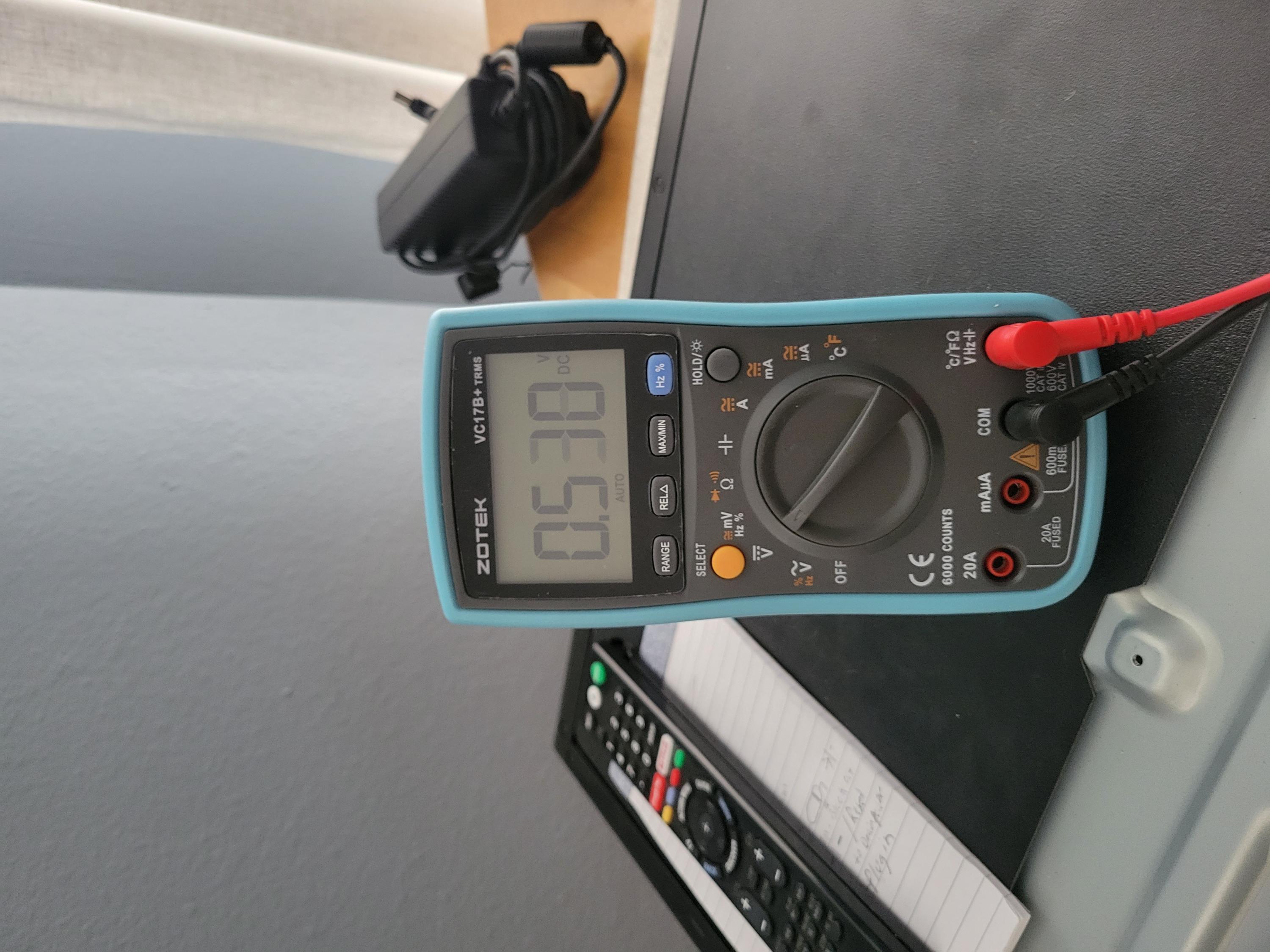

    I have 3.3 volt standby on the flowers Provo power supply board until I plug it into the main board but then it fluctuates the point .3 to.5 please help

      • thekidtmac73
        • Jan 2022
        • 7
        Re: Sony XBR 55 x800e
        This I what I have video attached

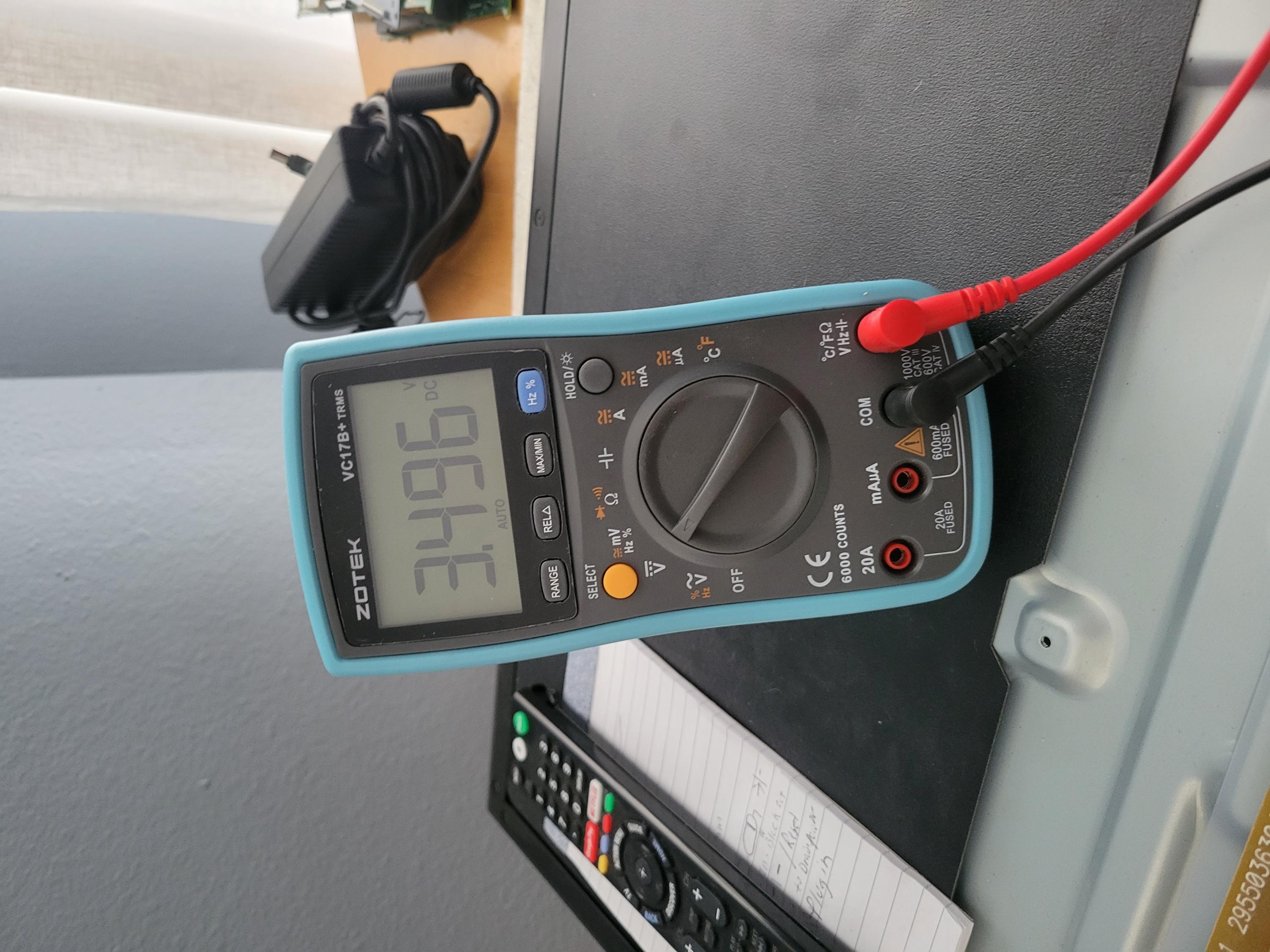

        • thekidtmac73
          • Jan 2022
          • 7
          I disconnected the main board from the power board and when I test the rating on a standby voltage it is still the same as when it is plugged in
          • thekidtmac73
            • Jan 2022
            • 7
            This with main board connected
            • thekidtmac73
              • Jan 2022
              • 7
              This is with that main board no connected
