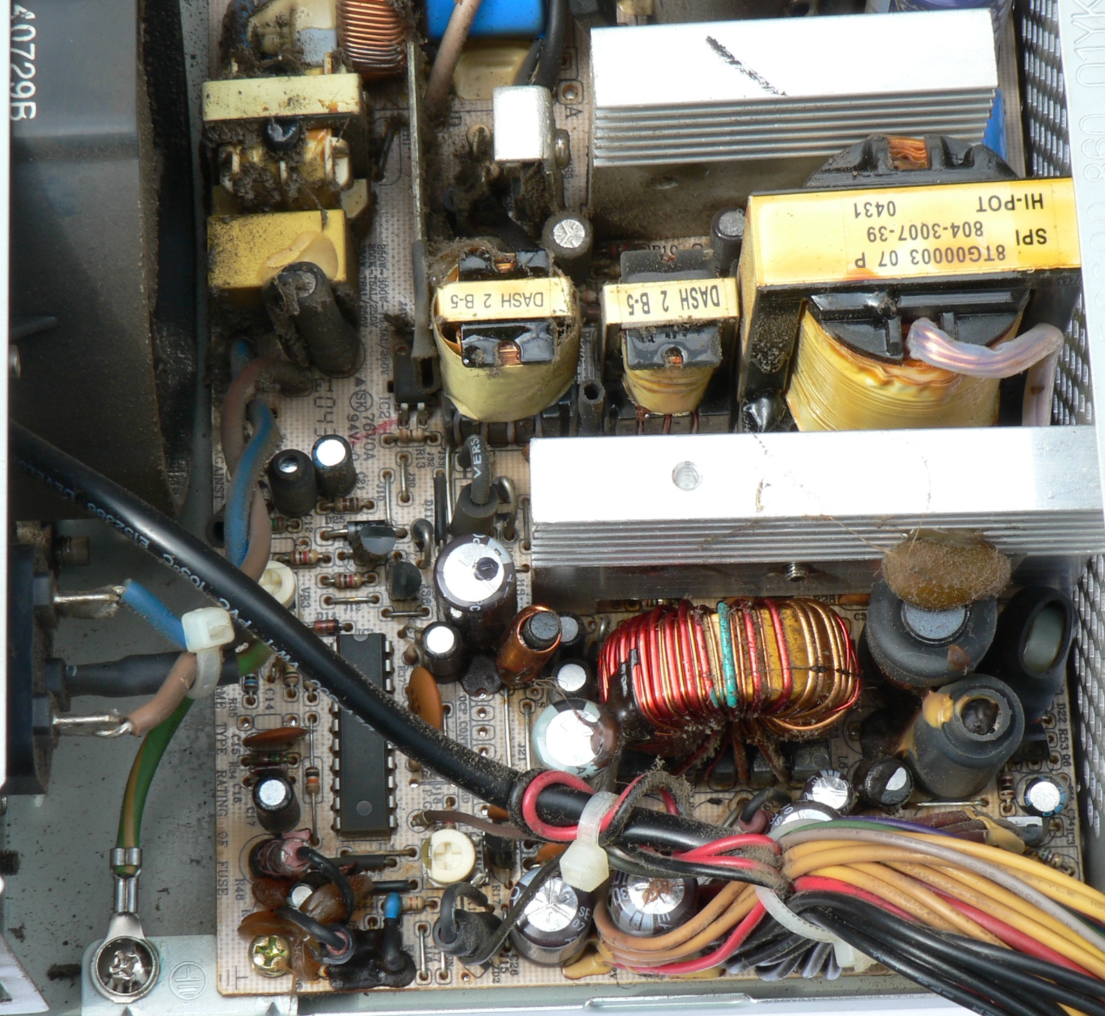

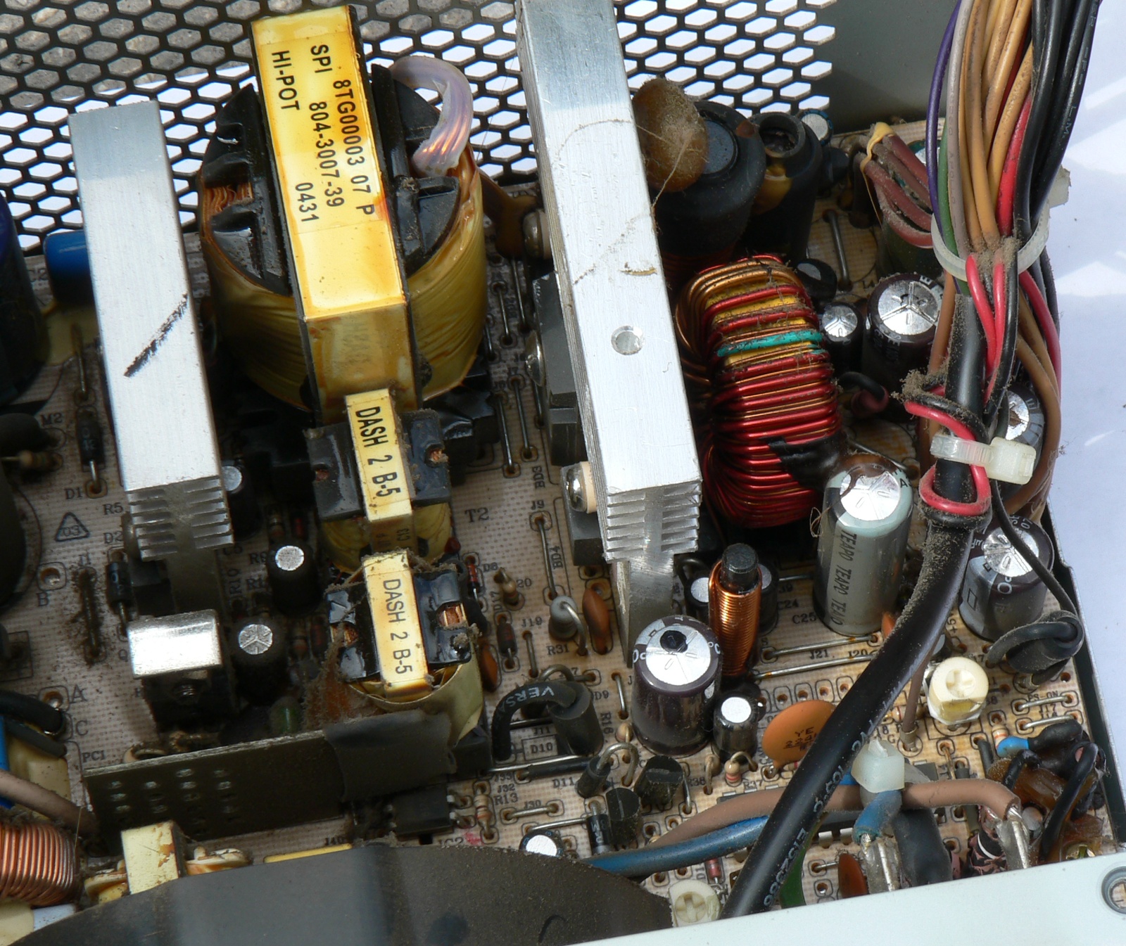

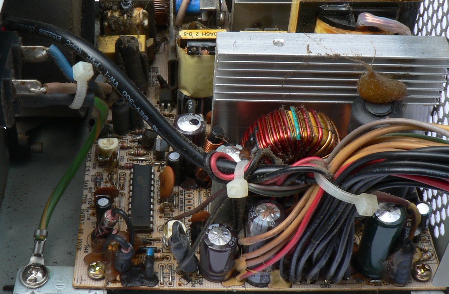

      Re: Old Fortron FSP250-60GTM
      Here are the pictures. It had to be pretty overheated, look at all those color changes on transformers and fixing glue everywhere. The insulator spaghetti on the two resistors in down left corner is even totaly baked. I peeled it off together with some of the paint, I hope beside that the resistors are good
      The wires are pretty thin for me, I consider whether to replace them or not. Even some old dead 250W EuroCase I have here somewhere has thicker wires
        Some serious heat damage there. Let's just hope that the caps are the only things cooked. I would be replacing those resistors, since they can suffer damage from heat too.
