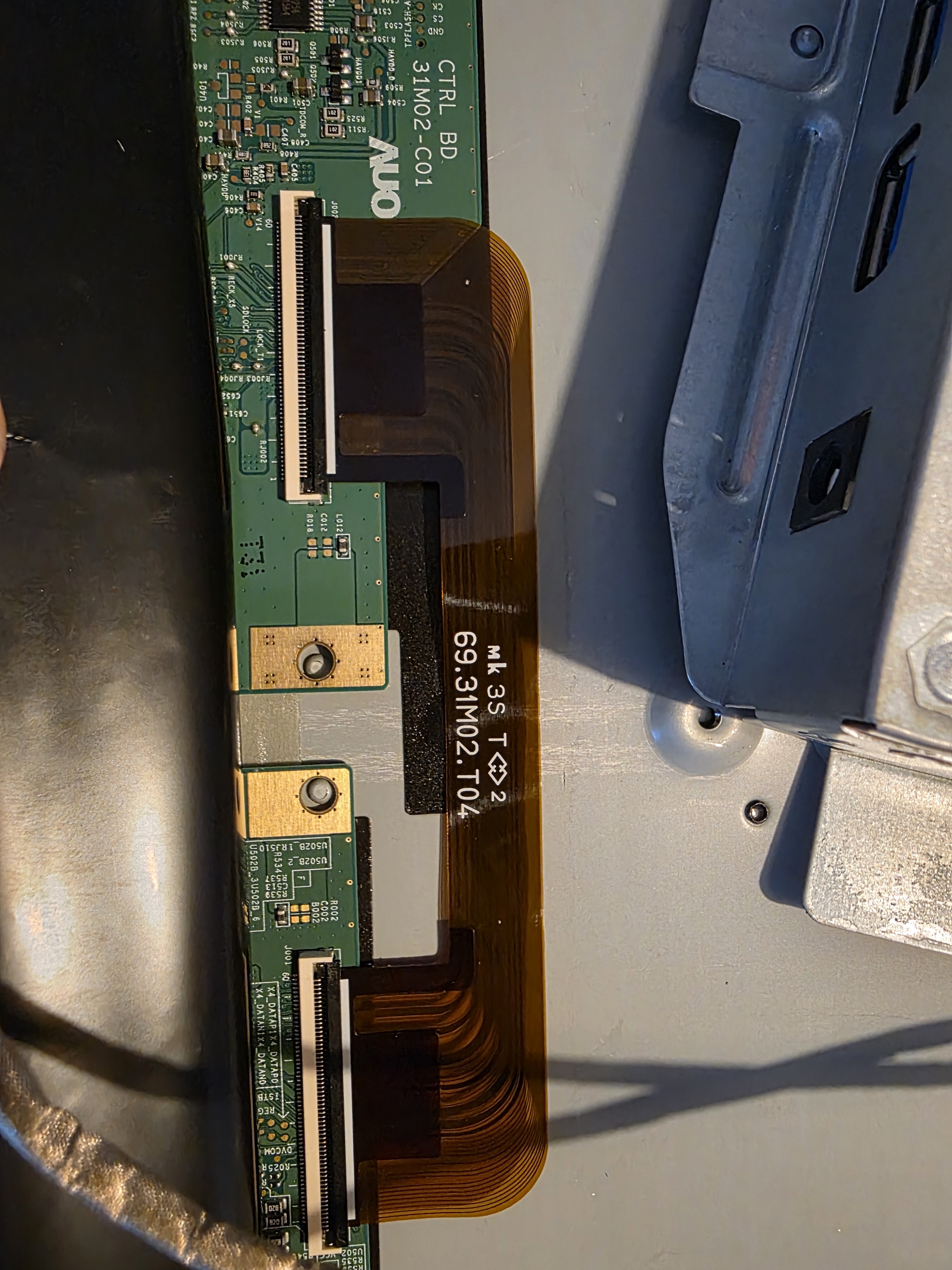

    Hello.
    I have here a Asus 32' curved display showing these lines.
    A short clip of what shows when I turn it on.
    https://imgur.com/a/Z8fyqym
    Here are some pictures of the boards. Visualy they seem fine.
    There are lots of videos on Youtube on possible solutions, but I could not find a similar problem with a similar board layout.
    Any help is appreciated.
    Thanx.

          I am currently trying to solve a similar problem on a vg32vq which has the same board. You could try disconnecting the daughter board of the panel from the main left one and see if you have picture on half the screen without the lines. In that case the problem is on the daughter board to the right. If you could send me a picture of the Ic Buck converter Chip on the daughter board with the resistors below it, it would help me a lot.

              When I disconnect the daughterboard of the panel, half of the screen is displayed correctly
              I am sending a photo of the chip on the daughter board with the resistors below it
              I replaced the G1564 chip with a new one but nothing changed
              looking through a thermal imaging camera, there is no sign of anything heating up suspiciously

                    The follow test data for your reference.
                    I'd buy these two board from LCD broken people.
                    The board no COF cable, so test these voltage just only no connected LCD panel.
                    I'd change all ICs (chipset), but the screen still shown green & some white line, like BMCappelletti's first picture.
                    I think this status not CTRL board & SOURCE board issue, I think it is COF cable fail or panel fail.

                        I had the same exact problem. Vertical, green lines across all screen. I disconnected a little thin ribbon cable between the two daughter boards at the bottom, I did resit it, plugged it in a couple of times to make sure its fully inserted and it worked just fine, the picture came back all clear and no lines. I believe I was very lucky to find this problem fairly easy. Good luck boys 👍Click image for larger version
