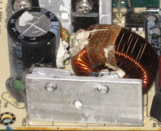

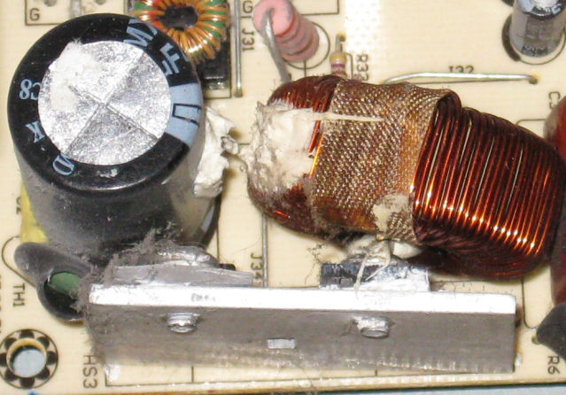

        Today I finally found the source of the burning smell - inside the PSU, as I feared. The PSU is a Jean Tech, 350W.
        Upon closer inspection, I found that one of the coils inside felt very loose to the touch, and the glue between it and the input capacitor had broken. I'm guessing the coil developed a 'hot spot', melting the glue and causing it to move out of place, touching another heat sink. The smell was definitely coming from the vicinity of the coil.
        I've attached two photos of the coil and capacitor - what do you guys think? Perhaps the combined heat from the hot spot and the heat sink caused the 'paper' on the coil to start making a smell?

          Shorted coil or something else short causing high current through it?

            What's the name of that coil? I've got another power supply with the same symptoms. There's charring on that coil. I'll replace it, if I can find a cheap replacement.

              or just a faulty coil...
