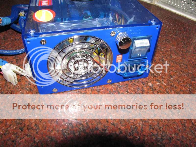

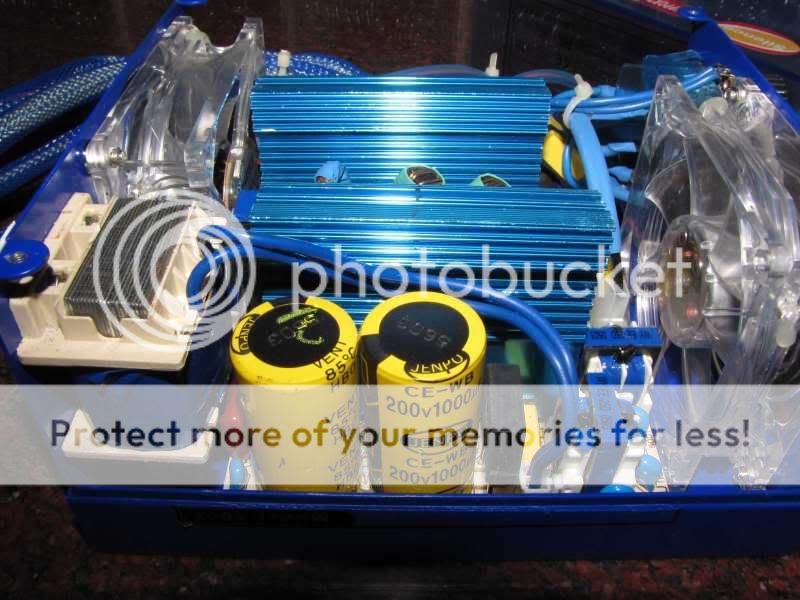

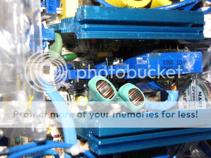

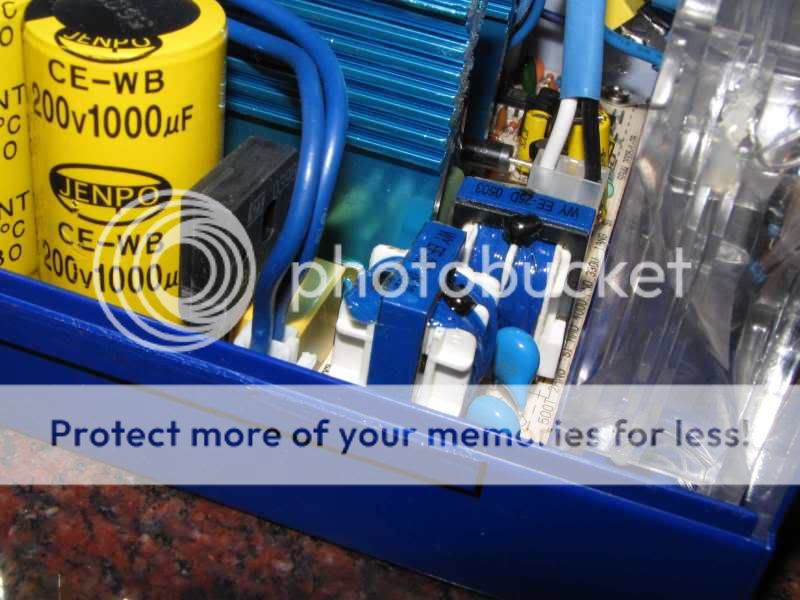

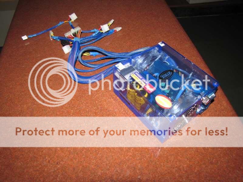

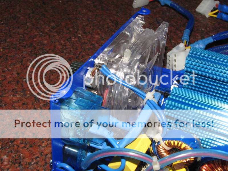

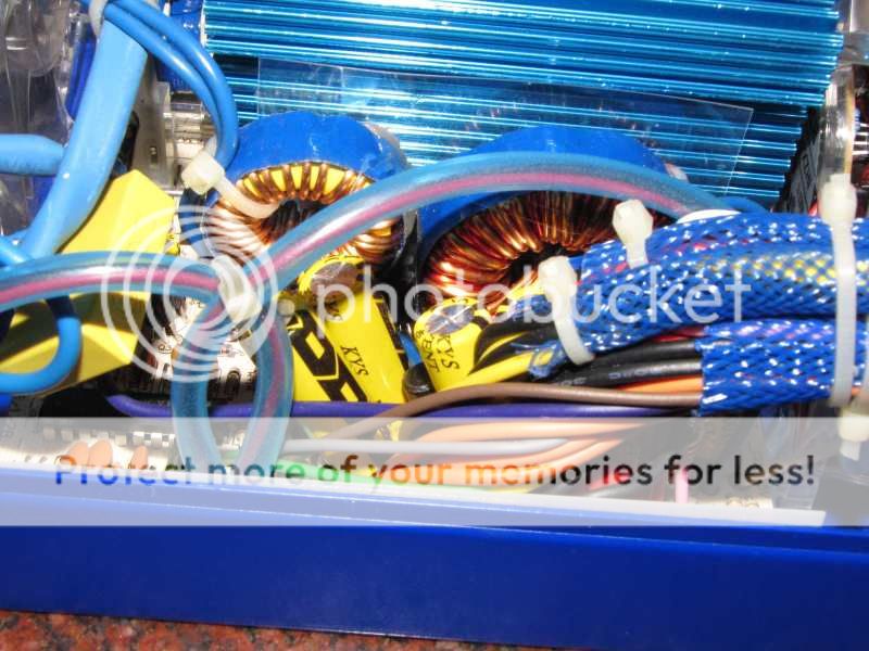

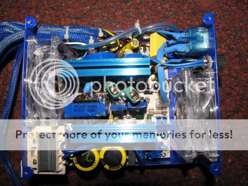

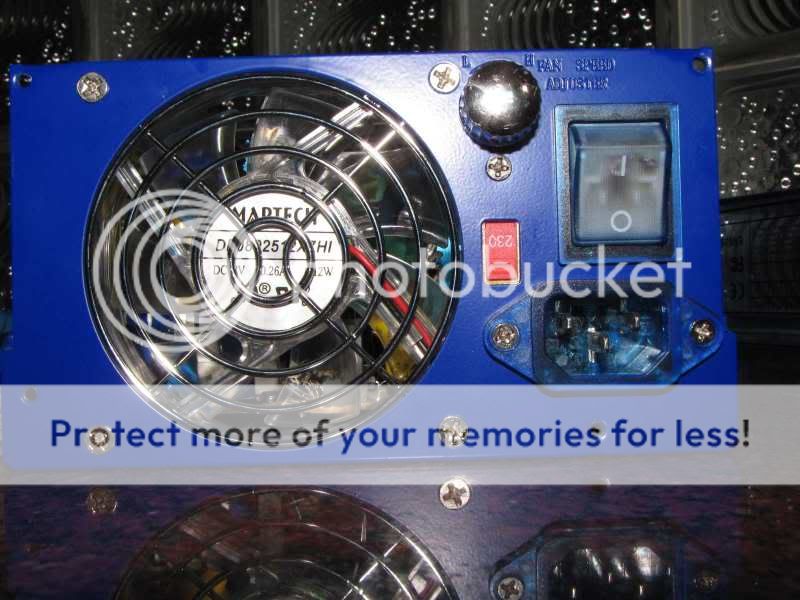

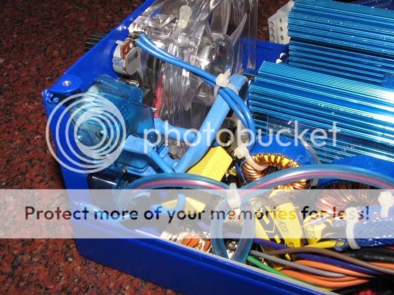

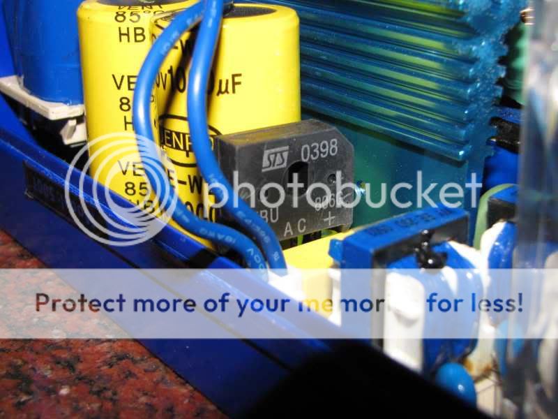

                                    Re: Primary Filtering Insufficient?
                                    So, here is my NEW SMPS,
                                    Did i get a nice one?
                                    See the pics-
                                      • 31283
                                      i like the shell, good for checking the caps
                                      cant make out the name on the secondary's though.
