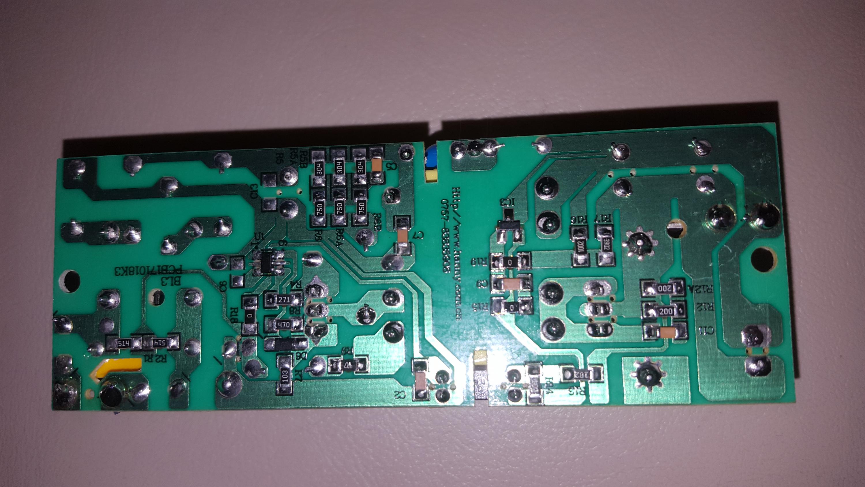

    Hello everyone.
    So basically the question is in the title - is it possible to mod a 120vAC switching mode power supply unit to work with 220-240vAC?
    The particular unit is the one from the photos.

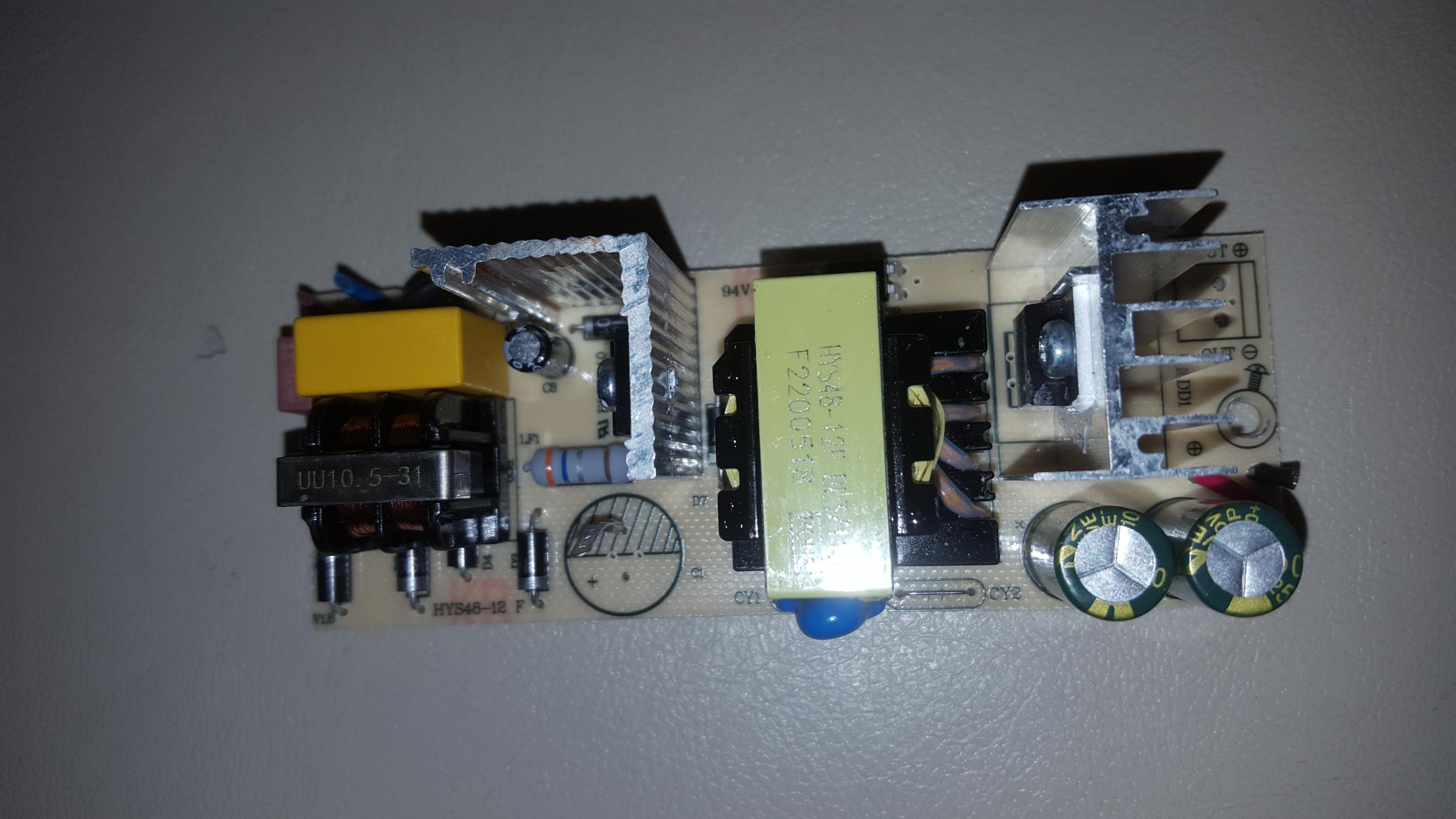

    It looks like someone ignored the 120vAC label and plugged it in 240vAC. According to the user - "it every time tripped the fuse".
    The only visible damage is the high voltage smoothing cap, which has vented quite energetically ( everything above it is sprayed with goo ), but did not explode.
    The thru-hole components on the primary side measure fine ( including the fuse ). The smps ic ( 33010 ) also shows no shorts.
    So the first thing which came to mind was "make it from full-bridge rectifier to half-bridge rectifier", but I'm kinda stuck with the calculations ( tried to calculate the peak dc voltage with the circuit simulator, but no joy ), so hope someone can get the numbers.
    Also, I guess the smoothing cap value should be adjusted with the half-wave?

    Luck of the draw: just replace the capacitor with a higher voltage unit and it will work.
    If unlucky: need to replace: higher voltage MOSFET, increase voltage rating of yellow capacitor, SMPS IC needs to be replaced with a faster unit, transformers' insulation needs to be improved.

      Yeah, I thought about just replacing the cap with a higher V one... the switching transistor will handle it ( JCS9N50C rated 500V ), but I couldn't find any documentation on the switching IC ( 33010 ) and that is why i ditched that idea for now.
      Also, every other SMPS unit which I have seen has been rated 100-250V and only this one 120.. so I wouldn't be surprised if the 33010 is made to lose its magic smoke if 200+ vDC is applied.

                    That wouldn't work.
                    Remember, 230V AC line peaks at +/- 325V DC (230 x sqrt[2]).
                    So by converting to half-wave, you would still get 325V peaks, but only on the positive or negative side of the sine wave (depending which way you orient your single diode.) Thus, the primary cap would be charging with 325V pulses, but only at 50/60 Hz (well, 50 Hz in your case) instead of both negative and positive peaks of the wave (100 Hz.)
                    Therefore, just install a 400V cap and the adapter should be good to go in most cases. The SMPS IC (33010) should be OK too. If it's anything like UC3842 or any other standard current-mode SMPS controller, it charges a "start up" capacitor through a high-resistance resistor connected to (+) DC bus. Bad comes to worse, you may have to change that resistor for one with higher resistance and rated for higher power (due to higher bus voltage now.)
                    Actually, looking at the pictures of your adapter, it seems that R1 and R2 are used for this function as well as discharging the yellow X2 class cap - kind of a cheap move there combining both pf these functions together. The SMPS IC should have its own resistor for charging up the startup cap, but whatever. In any case, those current resistors might still be OK to leave as is, since they are rated for 510 KOhms each. If they end up cooking themselves with 230V AC, replace them with 1M each.
                    That aside, these adapters are usually designed universally with 100-240V in mind. Reason they used 200V cap is probably because it was cheaper when they know the adapter will be sold in a country with only 110-120V AC. So all in all, I do expect the adapter to work OK with 230V AC mains.
                    That shouldn't be an issue.
                    X1/X2 and Y1/Y2 safety caps are almost always 250V/400V AC in most consumer devices. So it's probably OK. Doesn't hurt to check the voltage rating, of course, just in case.
                    Most likely not.
                    That and the primary turns ratio may actually be a legit concern.
                    And this brings another thing to mind: higher input voltage = more narrow PWM pulses to get the same voltage/current output. Thus, output caps may see higher ripple too... so probably a good idea to use good quality caps there.

                        Thanks everybody for the replies.
                        Installed a 400V rated capacitor and the thing choochoo-ed without losing its magic smoke.
                        I really don't get it why the manufacturer decided to put a 200V cap and leave everything else capable of working with 220-240 mains... Just checked the price of 200v and 400v caps in the nearby electronics shop - they are almost the same ( indeed the 400v is a little bit more expensive ).
