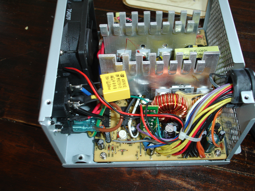

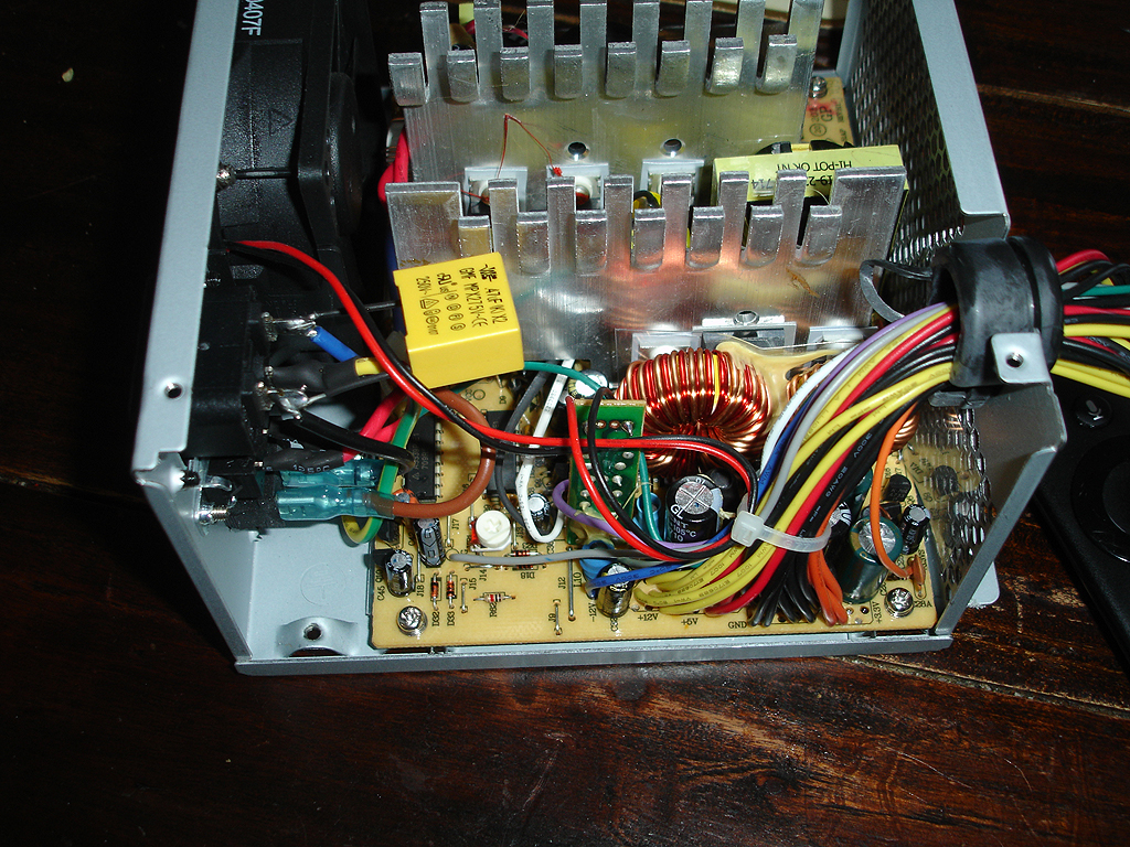

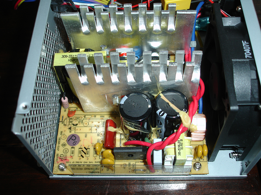

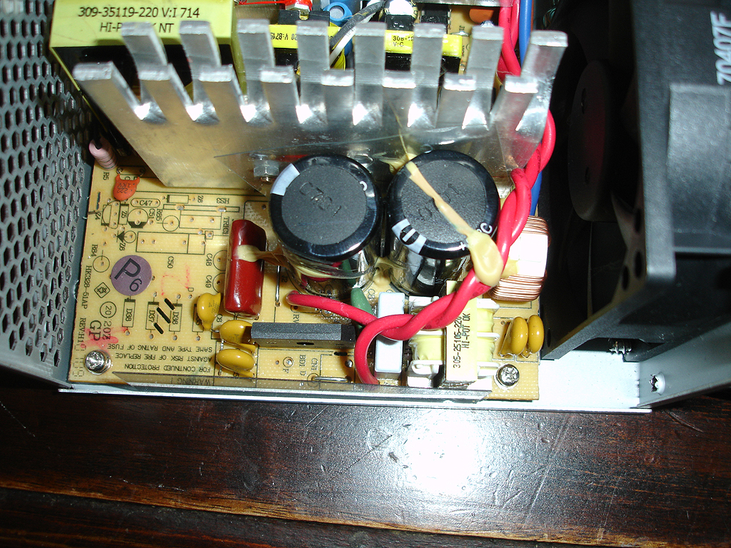

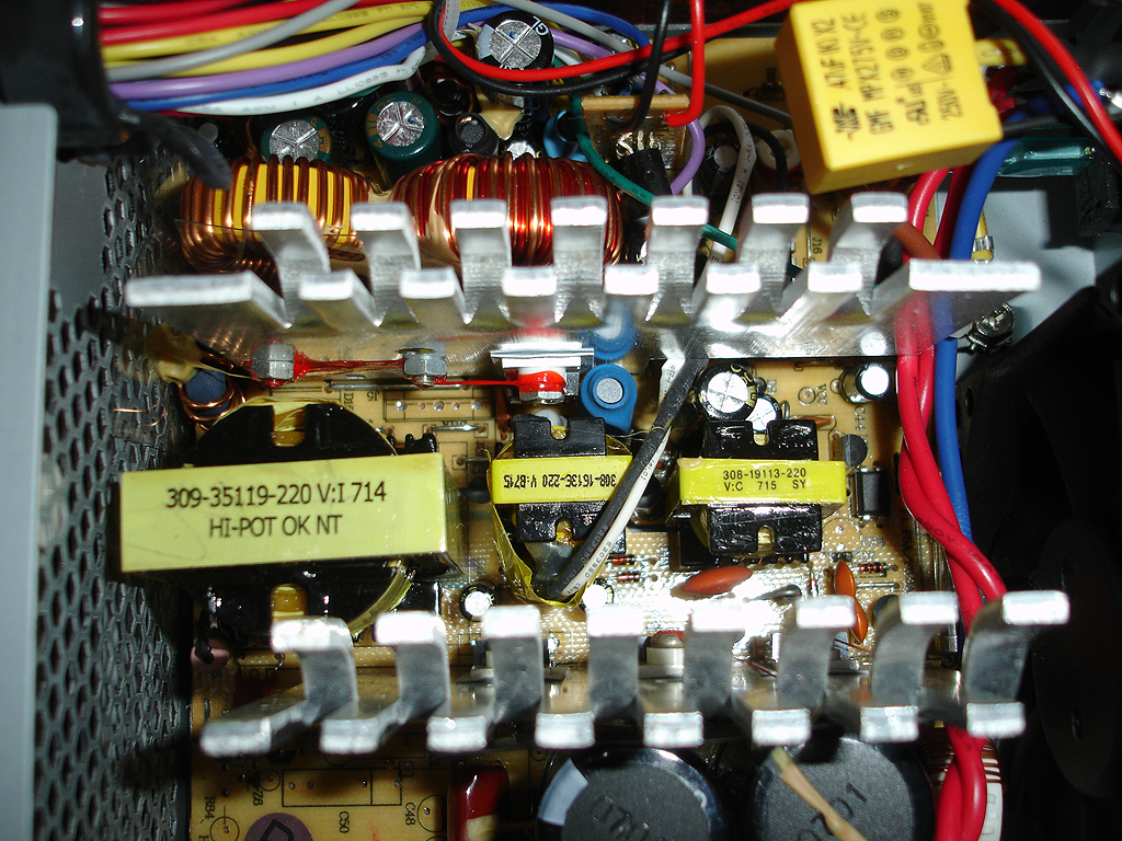

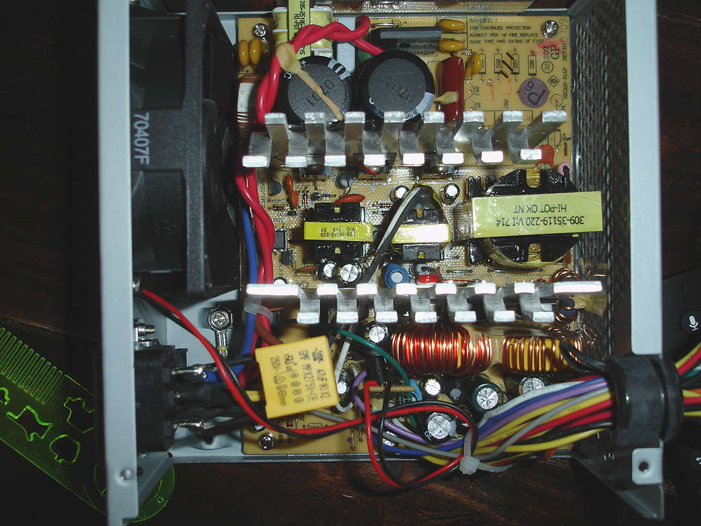

    Dynex 350 Watt PSU self-starts
    I was troubleshooting my Asus A8V motherboard (Socket 939). Finally got everything working except the board would start up as soon as the power switch on the PSU was turned on ie without pushing the motherboard power button. The Onboard sound was crackly so I tried a PCI-slot sound card. This didn't work at all and when I moved it to the lowest PCI slot the board would not boot. I swapped the PSU out and everything worked
    fine with the replacement PSU, even though it had less power on the 12V rail.
    I took the cover off, no obvious faults. I took time to read the PSU faqs. What I understand is that something in the 5V standby circuit is detecting ground, as if I had pushed the power button. At the same time I am losing power somewhere. With the good PSU all the PCI slots work properly.
    Any hints on where to start and where on the PCB to look? I have had a rash of PSU failures of late and would like to start with this one to get some experience before tackling the others.

    Well, if possible, please post a picture of your PSU here. We may be able to spot something that you didn't.
    Apart from that, plug PSU in the wall and check for 5V standby (5VSB). That is, check voltage between pin 9 (typically a purple wire) and any ground on the ATX connector. You should get 5V +/-5%. If that checks out and the voltage is stable, check voltage between PS-ON and ground. The PS-ON pin is typically pin #16 on a 24-pin ATX Connector and #14 on a 2-pin connector. You should get more than 3.3V here (typically between 4-5V). If not, report what voltage you get. Also, note if the fan on the PSU turns on or not when you plug it in the wall. It should stay off. Do these voltage tests with the PSU NOT connected to anything else.

              Re: Dynex 350 Watt PSU self-starts
              Pictures attached. Further Tests to follow

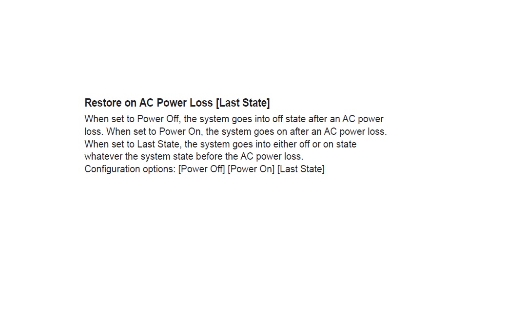

                  Some motherboards can be set (in the bios) to return to last power state. If the motherboard was ON when power was removed, it will turn ON when power is restored.
                  On the Asus A8V it is: Restore on AC Power Loss [Last State]
                      RJ, I never have "Restore on Power Loss" set to ON.
