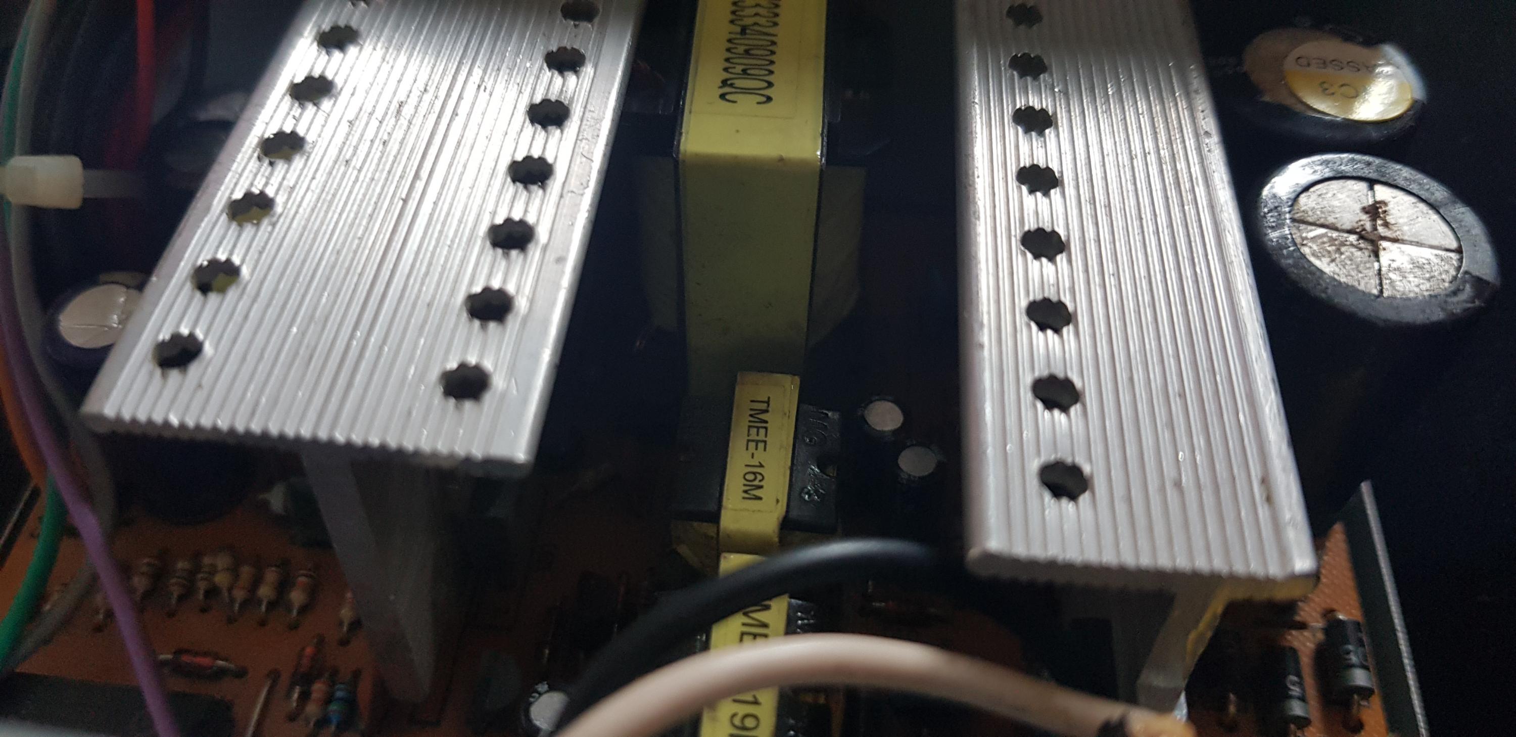

          That's actually very common in A LOT of PSUs with 120/140 mm top-side fans. As Per noted, it diverts the airflow so that that air starts from the front of the PSU, passes through the heatsinks and components, and then exits through the back vent. Otherwise, PSU may end up with places with small air vortexes and develop hot spots. So this helps that.
          You might have not seen it in other PSUs, because they typically use clear plastic sheets. But this being a budget PSU, I guess CWT used whatever was the cheapest. Just doesn't look too pretty. (And if I may add, that blue fan looks rather tacky too.)
          Originally posted by Topcat
          More of the puny sinks. Secondary caps are Samxon GF series, known to be a bit problematic....but these appear to be good...

              Unless those input caps are extra tall they look a bit small for 680uF. 470uF seems more plausible.
              Yup, quite possible. Or they may be 560 uF, which is a standard size between 470 and 680. Not that it should matter too much, as even 470 uF will be fine for 200-250 Watts.
              The output inductor looks pretty wimpy, too, and since it's -26 material it's probably a ~30KHz half bridge design.
              Only 2 transformers in the PSU, so this is (and from what I recall from briefly analyzing my unit a few years ago) single-transistor forward design.

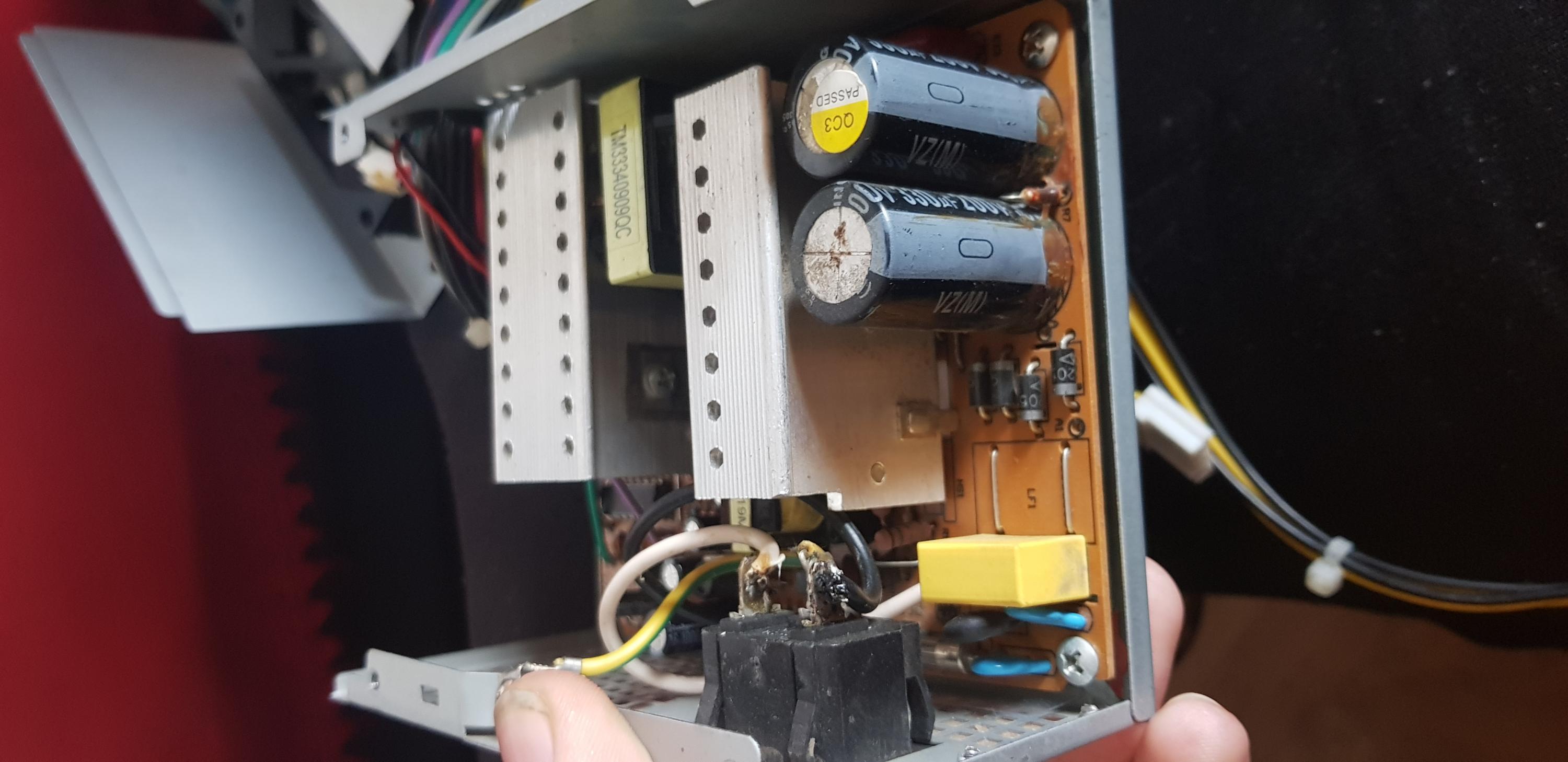

                            This has to be one of the lamest attempts for a PC PSUs I've seen. Sure it's only an AT power supply and AT PCs weren't exactly known for their high power draw. But still... this is lame.

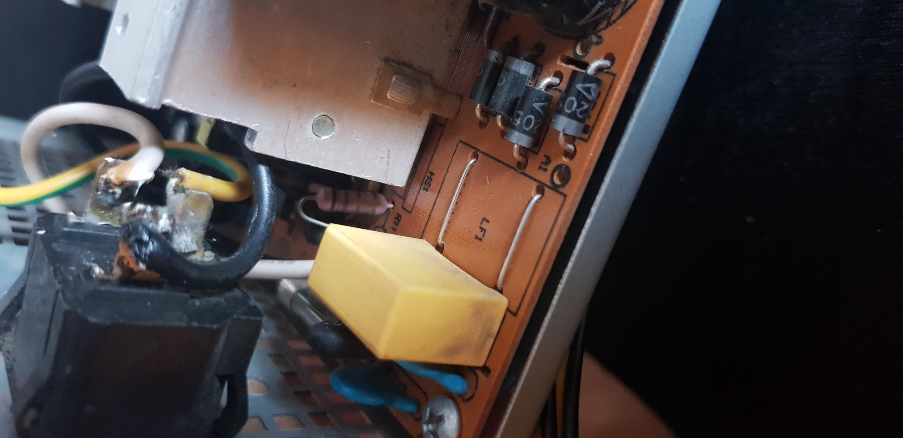

                              Oof. Just four diodes instead of a rectifier.

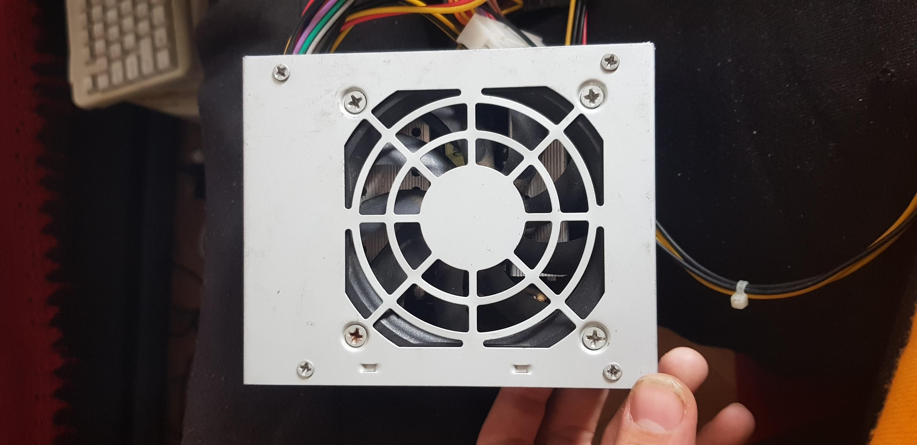

                                ASIC LC-200C. So technically a Deer/L&C, and it's AT.
                                Just for ÜBER laugh material, I'll actually take my time and upgrade it accordingly. Heck, I might still have some leftover parts from upgraded ATX L&C and Allied units.

                                  I'll probably be punished for actually putting this to a use... but the form factor is the advantage in this case. Granted, it's for a Super Socket 7 build I intend to take with me to college, as sort of a "PC" to have when I am truly bored. Specs include 2k SP4, a Geforce 2 Pro, about 256MB RAM, a Yamaha soundcard, and a 40GB Maxtor Fireball 3 HDD.

                                    The heatsinks on that PSU are actually not that bad... or at least, not the thinest I've seen. However, the label is a complete and utter lie. 30 Amps on the 5V rail? With a single cap filtering the output?
                                    If somehow that is managed, I definitely wanna see what the ripple would look like on a scope!
                                    Also, I've been doing experiments on a few older (but well-built) PSUs of my own... and even on those, 20 Amps on the 5V rail is usually already enough to make the secondary heatsink and output toroid very hot - especially when cross-loading the PSU for 5V heavy draw and light load on the 12V rail. Just from this alone, I can see why modern systems switched to 12V rail designs and why PSUs use synchronous rectification. A big part in loss of efficiency is from the rectifiers (voltage drop times average rectified current) on the secondary side.
                                    Anyways, I see you put some Rubycon (MBZ?) on the output (3.3V and 5V rails?) Looks like 3300 uF. Should probably do OK for up to 10 Amps on each of those rails. Also, I see "VZ(M)" written on the primary caps. Did they try to make those into fake/counterfeit Nichicon's? And on that note, the Y2 caps on the primary also look counterfeit / not real Y2-class rated.

                                      Originally posted by Dan81
                                      No. Just NO.
                                      Yikes...........just yikes....
                                        Agreed: putting the QC sticker on so carelessly like that.
                                        WHAT where they thinking in an otherwise so immaculate build?

                                          Originally posted by momaka
                                          Should be OK for it, as those don't need that much power either.
                                          Sorry for not getting back at y'all in the first place, and now with some answers:
                                          30A on the 5v rail - I know it's a utter lie. I'd have to replace the rectifier and filtering cap (despite being a genuine Rubycon)
                                          Ripple? Would probably be high, but hey, it's a K6-2+ 500 we're talking about, not some advanced P4 or i3. Adding to that the fact that the mobo is also recapped with 1500uF 6.3v MBZs for the CPU side and 16v 1800uF for the RAM regulator since that LT1083 clone it uses gets horribly hot. No, it isn't broken, it's just running finger-burning hot in normal operation.
                                          The whole config consists of this: 40GB Maxtor Fireball III 2F040J0, Geforce 2 Pro 64MB, 384MB RAM, an K6-2+ 500MHz, Realtek RTL8169SC NIC, Yamaha YMF-719 ISA soundcard, VIA VT6212 PCI USB2.0 card, all running on 98SE.
                                          Secondary caps - yes, I have replaced the puny ChengX caps in there for good measure. This little box came to me with a partially seized fan (it was grinding horribly and lubing it up didn't help either) which I eventually replaced, as well as crappy "1500uF 16v" ChengX caps that were probably 220uF max. I used some Rubycons recycled from a dead mobo (don't exactly remember what socket it was, but it was newer than PGA370).
                                          Main caps - AFAIK this isn't the first time I've seen the OEM use those Yongxing VZ fakes. Yes, the OEM (which at first I mistook for Codegen in an normal ATX PSU they built, but then figured it's some generic chinese OEM as the PWM chip (CG8002 ) didn't match up anything I'd be familiar with.) is notorious for using those crappy Yongxing caps in the primary. Unfortunately, I don't think I can find suitable replacements mainly because of the form factor it uses which doesn't allow me to just drop in some Yang Chung (Saturn) caps from Deers - at least those are less crappy (about as good as CapXon, which, while crappy, is at least better than using Fuhjyyu or Yongxing primaries.)
                                          Topcat & Per Hannson - yes, it is that gutless. I already replaced the PCB with another AT PSU (an Essun 200W, which, while still uses the diodes-on-a-bracket for 12V, has much better construction than this crappy Deer.) and the machine it's powering (a 533MHz Mendocino Celeron on a PCChips M726MRT, which is a surprisingly rock solid board with no issues whatsoever - as rock stable as my Zida LX98-AT 440LX mobo, actually.) is running crash-free last time I powered it up.
