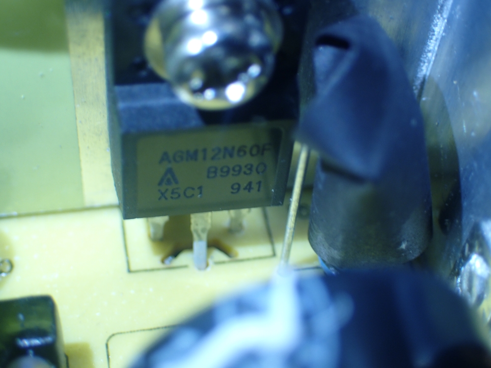

        #1663
        Re: the gutless, bloated, and fried power supply hall of shame
        This PSU is not that bad, however, it came with a fatal factory defect ...
        "AC ADAPTER"
        "TS5-6W"
        "Trained Service Personal Only."
        100-240VAC 50/60Hz 0.8A
        12V 5A
        Rectifier: GBU808P
        Controller: CR5842B
        Primary FET: AGM12N60F
        Sync Rect Controller: 1('I'?)9HMA
        Sync Rect FET: 085N10
        Primary cap: 82µ 450V, (Brand is "H." in a circle)
        Controller cap: 22µ 50V, "BH"
        Secondary caps: 16V, 470/560/820µ ( ), "RLE2"
        UL: E329462 (UL now requires you to register with them in order to see the listings! Bummer! So, MFG is unknown to me...)
        Has screwed-together case (great for repairing!), synchronous rectification, polymer capaci- oh... a popped polymer!
        The cap was installed the wrong way around in the factory! (Yes, this PSU was new, worked for a few minutes then popped, according to the guy I got it from. Poly cap pushed out the bung and short-circuited.)
        ^ You can see that the capacitor was installed backwards, based on the silkscreening (and PCB traces - not shown here).
        P.S. Popped poly-cap odor is interesting! It smells like a combination of burnt fireworks and new car tires,... but with a notable sweetness.
        -Ben

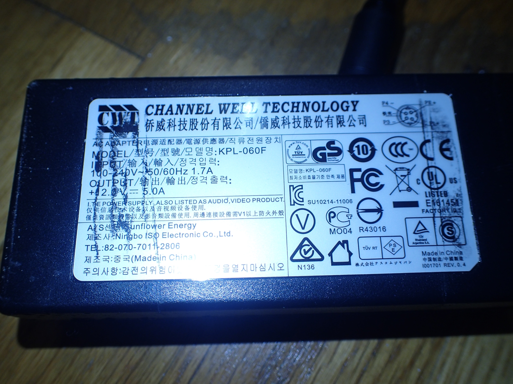

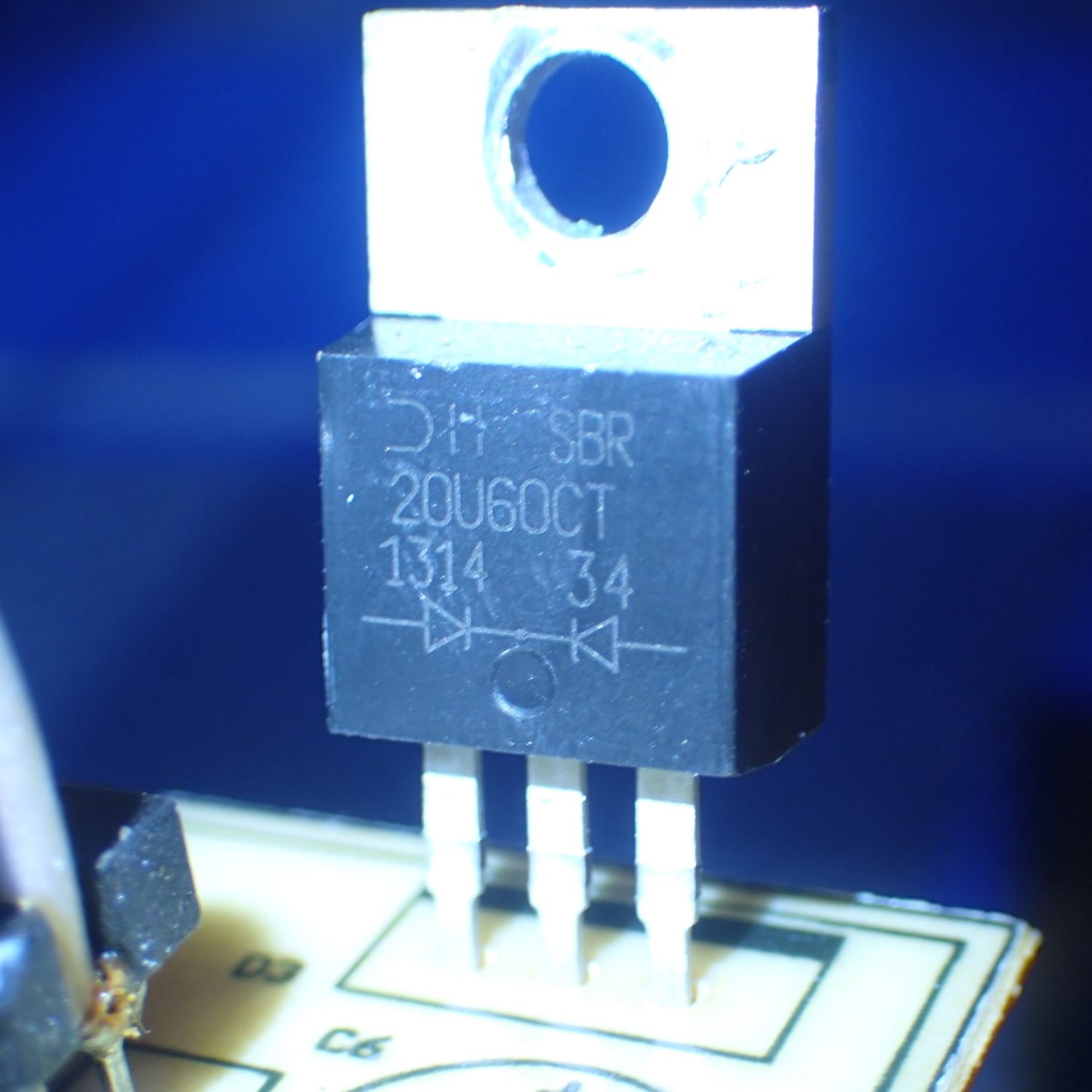

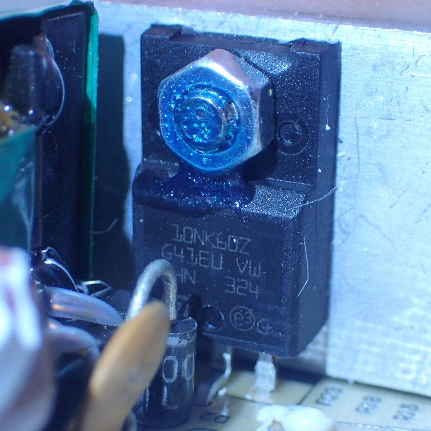

          #1664
          Channel Well Technology
          KPL-060F
          100-240V 50/60Hz 1.7A
          12V 5A
          Rectifier: ??? (Hidden, didn't bother to unsolder heatsink, but looks like same package as KBL40x types)
          Controller: "MWP 36R 55"
          Primary FET: 10NK60Z
          Secondary rectifier: SBR20U60CT
          Primary cap: 120µ 400V, Su'scon
          Controller caps: 22µ 35V and 4.7µ 50V, Su'scon
          Secondary caps: 2x 16V 1000µ SAMXON GK (blown), 1x 16V 220µ SAMXON GF (Left it in as it's after the PI coil; dunno about the ESR, but it measured OK capacitance-wise.)
          UL: E161451
          Was a pain to crack open, unlike the cheapo PSUs. I slightly damaged the case, but after recapping with NCC KYB (what I had on hand), it is good now for field testing/diagnosing purposes. After all, this PSU has a special 4-pin connector, and costs ~$60 new from a reputable source.
          -Ben

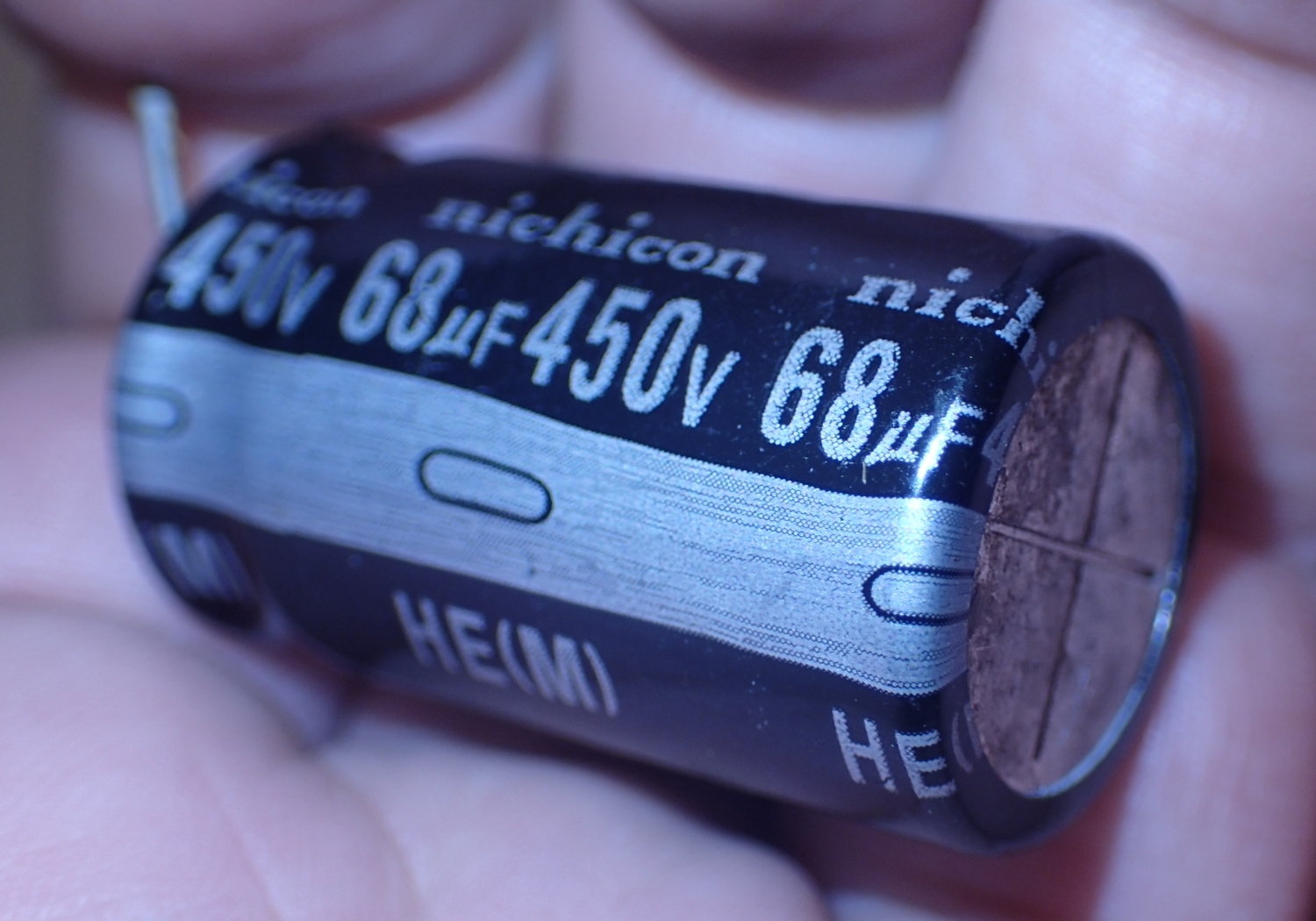

            #1665

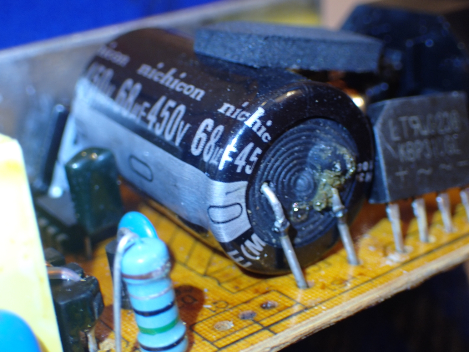

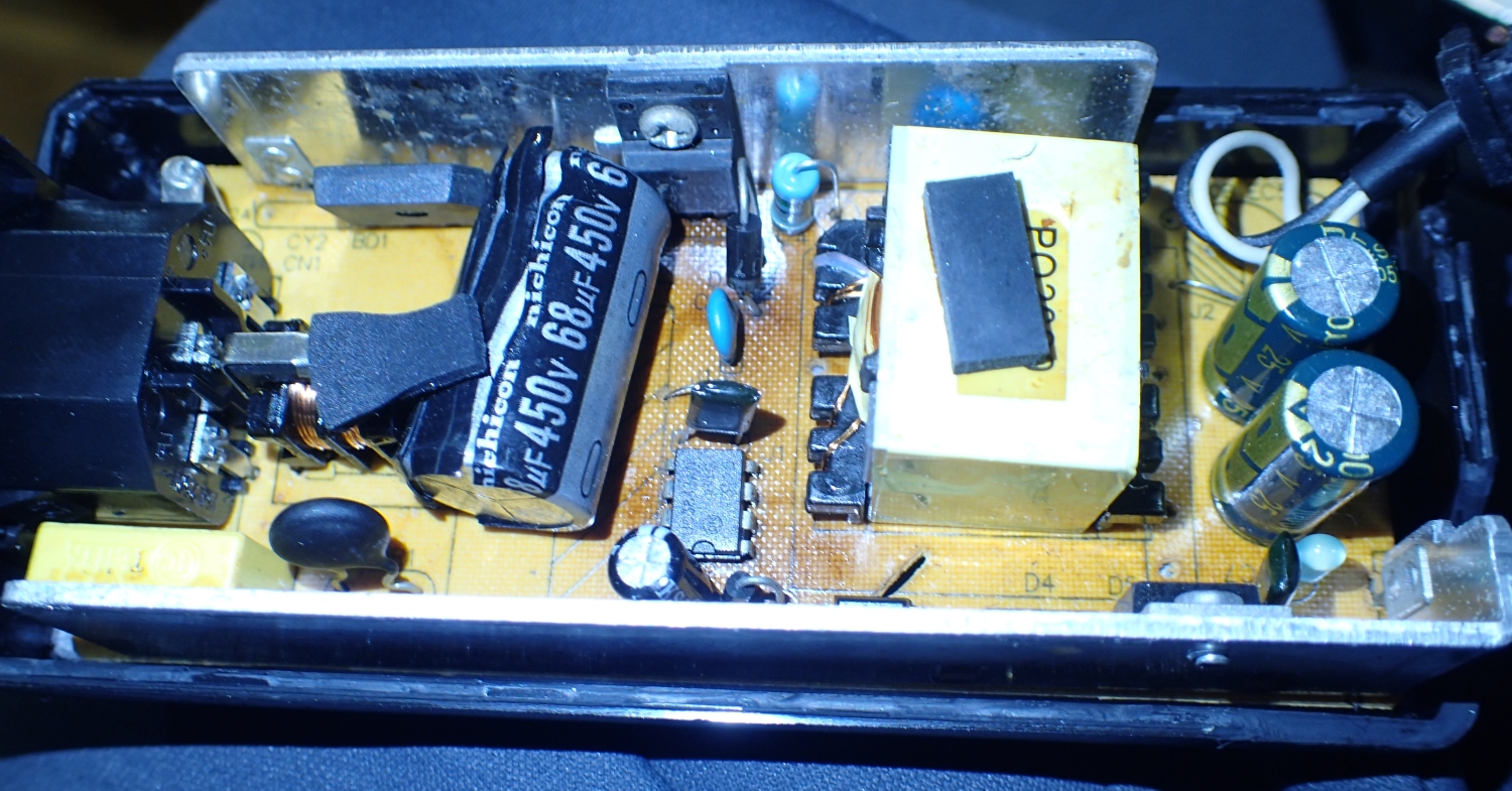

            This one is not the worst out there, but it's pretty darn shameful I'd say!
            (Will give you a "super-night" when it burns your house down!)
            "Supernight"
            "AC/DC ADAPTER"
            "W-T5000"
            Input "VOLTAGEDE": 100-240V 50/60Hz 1.6A
            12V 5A
            Rectifier: KBP310GL
            Controller: UC3843AN
            Primary FET: FQPF5N60C (Looks like it's been tossed around...)
            Secondary rectifier: STPS10H100CT
            Primary cap: 68µ 450V, "Nichicon HE" (FAKE - See pics!)
            Controller cap: 47µ 50V "KSC"
            Secondary caps: 2x 25V 1000µ "KSC"
            UL: No safety certification markings at all!
            Note that the LED in this unit is the unusual oval type...!
            "CAUTION:
            INDOOR USE ONLY.
            FOR USE WITHIT EQUIPMENT ONLY."
            Did they mean "without" equipment?
            ^ Burnt SMD resistors.

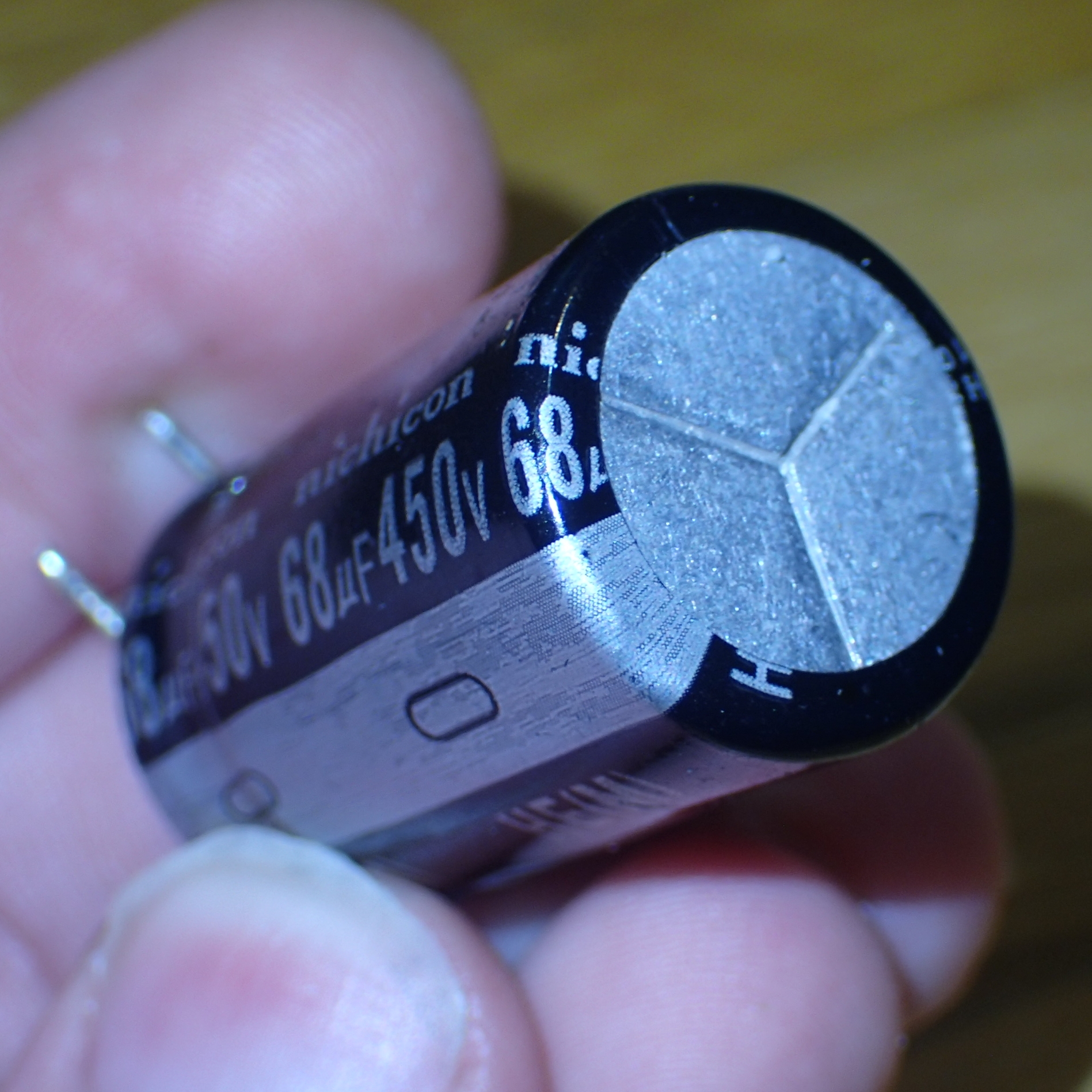

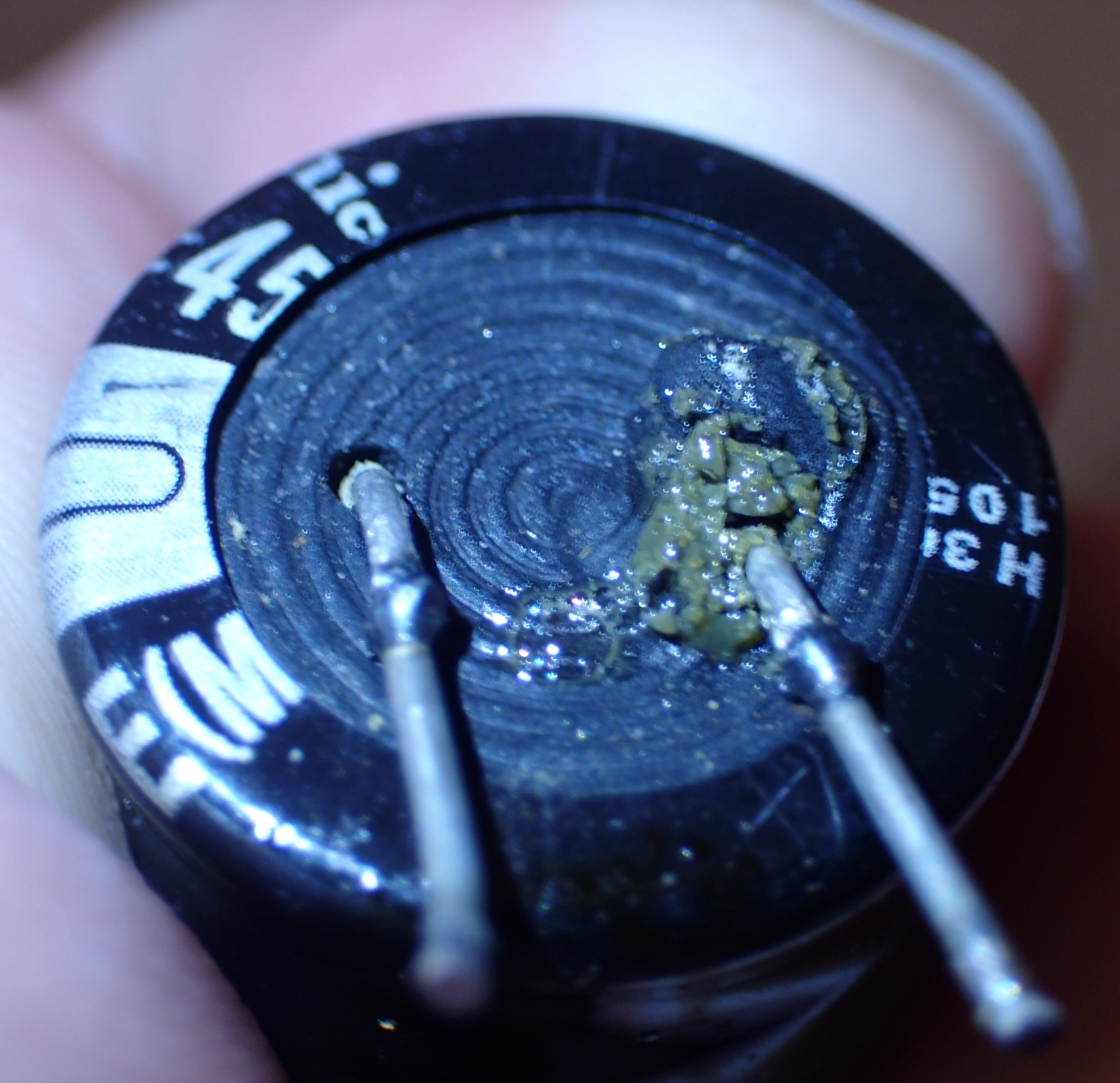

            Here is the interesting bit:
            A fake Nichicon HE!
            ^Horrible print quality, done in *silver* ink (unlike white on real Nichies) on black sleeve.
            ^Does this date code mean anything to you?!
            1930, 2030? There aren't even 58 weeks in a year!
            Maybe it is a secret code for "BULLSHITE!"
            ^ Wrong vent stamp, and poorly shrunken sleeve.
            ^ Wrong bung, and the leads appear to have been messed with.
            Perhaps this was removed, re-sleeved, re-leaded (lead extensions welded on), then sold as "new/genuine"?
            It measures about 63uF, for what it's worth!
            Also, BTW... I opened this PSU with my bare hands.
            Yes, my bare hands. No tools, no dropping nor throwing. Just a squeeze.
            It was THAT easy to crack the plastic! (It mostly broke along the seam, but some of the actual shell broke along with it!)
            -Ben

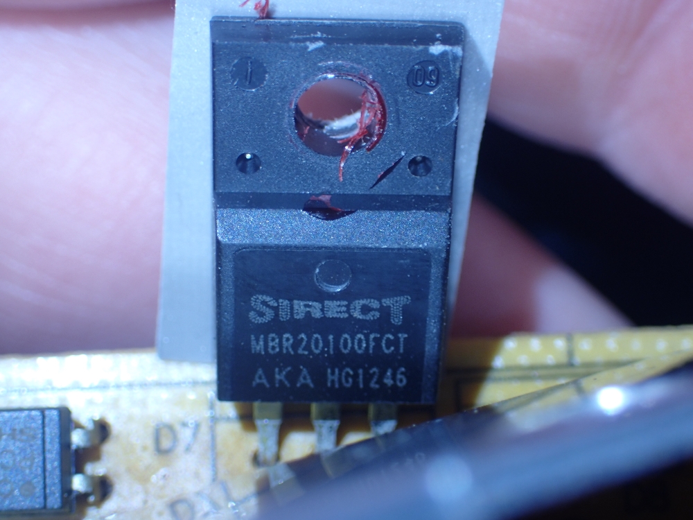

              • 4059

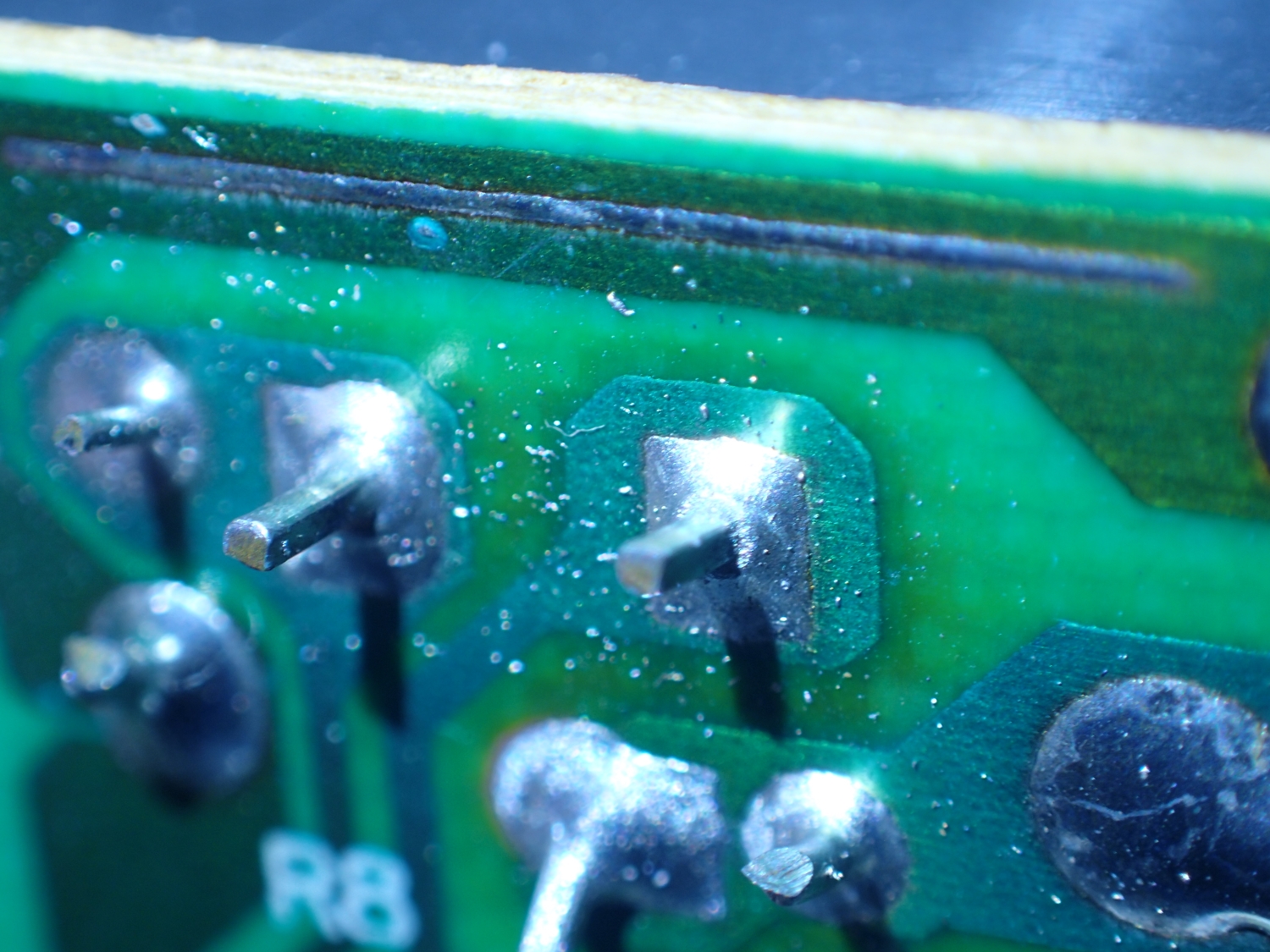

              #1666
              Yet another faulty 12V 5A PSU ... this one has some absolutely filthy solder!
              "AC/DC ADAPTOR"
              "TS5-6W"
              100-240V 50/60Hz 1.8A
              12V 5A
              Rectifier: 4x 1N5408
              Controller: OB2269CP
              Primary FET: Toshiba K11A60D
              Secondary rectifier: SIRECT MBR20100FCT
              Primary cap: 100µ 400V, "LH.Nova" RX
              Controller cap: 22µ 50V "LH.Nova"
              Secondary caps: 16V 1000µ "LH.Nova" LE (popped), 16V 680µ "LH.Nova" LE
              UL: E329462
              ^ This is how the PSU was from the case. Very warped PCB.
              ^ It was difficult to take a picture of this, but you can faintly see the spot where the case has warped/melted/sunken. In fact, it is melted all along the heatsink for the primary side transistor, and especially so just above the transistor! Ouch!
              ^ Popped cap. Disappointing - no crazy Super-Nova here...
              ^ Mains bridge rectifier solder joints cracked, plus splattered solder balls everywhere!
              ...baa-a-a-aad! :sheep:
              ^ Mosfet has turned PCB a different color, and the joints are cracked. More splattered solder balls, too.
              Now for the last one ... [properly] hold onto your soldering iron!
              ^ Mains input jumper link. Do you even solder?!
              (It's in the place of an NTC thermistor. It's not a fuse; there is a fuse on the other mains leg.)
              -Ben
                  KPL-060F
                  Not surprised here.
                  Samxon aren't really that bad compared to other caps. But flyback converter PSUs really do stress output caps a lot more than regular continuous output designs. So for flyback, it's gotta be Japanese caps if you want the thing to last.
                  A fake Nichicon HE!
                  https://www.badcaps.net/forum/attach...2&d=1610833288
                  Concur.
                  If it uses counterfeit brand caps, it sure must be shameful. I'd rather see even Chang/Chong/Cheng/X than these... though the difference may not be that big really, and the result is guaranteed to be the same in the end - i.e. blown caps sooner rather than later.
                  Now that's funny!
                  Those Nichicon date codes are sooo easy to decipher and understand... yet the copycats failed to do even that. Then again, given the obviously bad fakery, it looks like they didn't try very hard to begin with.

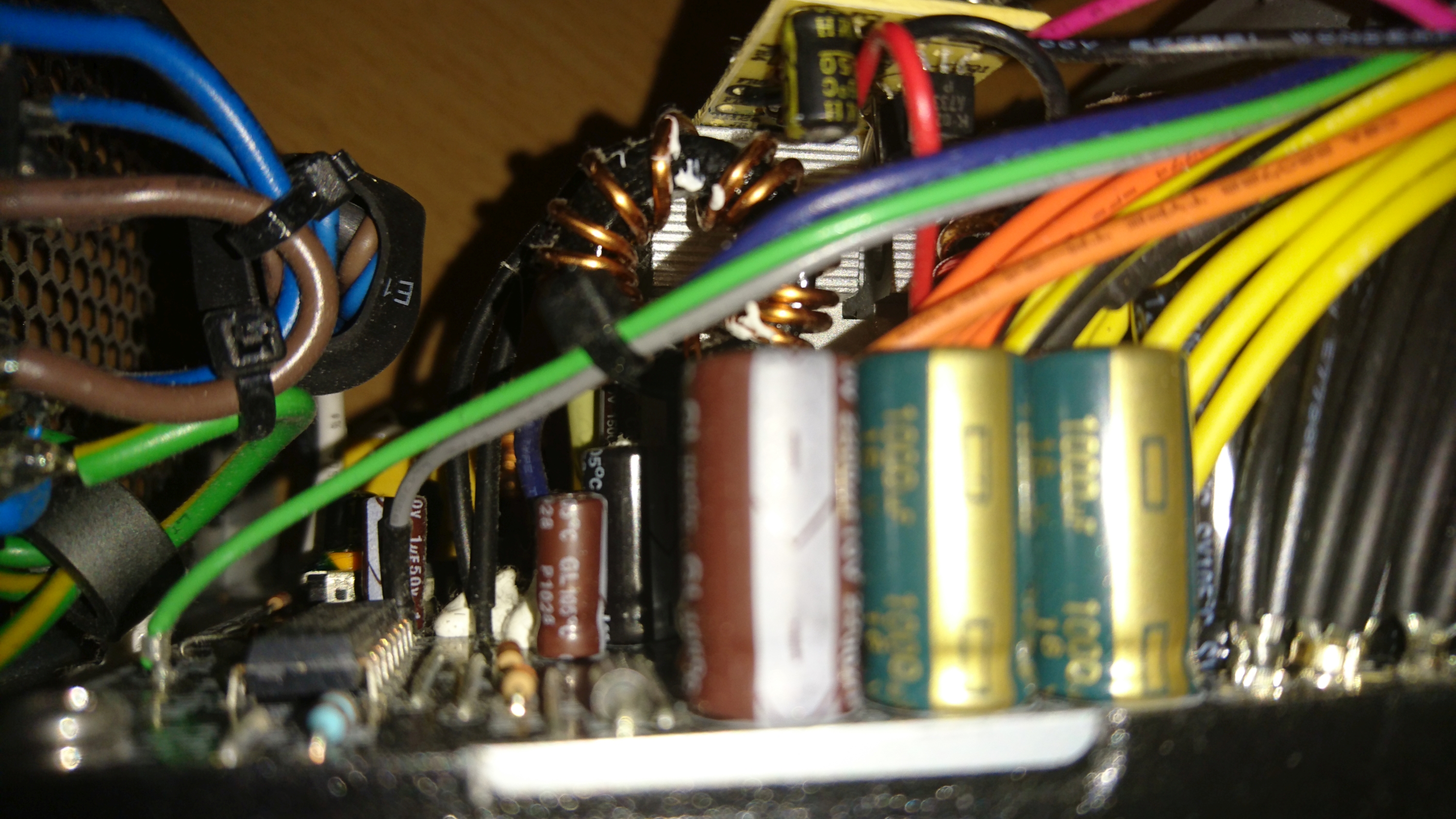

                        Did a little writeup on a dead bequiet PSU over in the other thread, but I figured I might as well post this other one from the junk box as well before disposing of it... this is a bequiet Pure Power L7 430W bought in 2011. This one never saw much use other than for occasional testing.
                        Perhaps not as terrible as much of the other stuff in this thread, though the c(r)ap selection mainly consisting of CrapXon and Teapo isn't exactly great... reason this one is fried is that one time I was trying to patch up some traces on an old broken Slot 1 board and used this PSU for testing; after doing so it turned itself on just upon plugging in the ATX connector and promptly released some hefty magic smoke . I was actually hoping to find which part had exactly burned up but no luck.
                        I'll note this unit received overall very positive reviews locally back in the day, praising its build quality amongst other things. That little screwed on PCB does look pretty rough though... in the end this was only a ~40€ unit though so can't expect too much I guess.
                          Save the X2 and Y2 caps, along with the line chokes - these can come in handy when fixing other PSUs. If you have a desoldering iron with vacuum (or just manual vacuum pump), try saving the rectifiers too - they make nice upgrades for monitor power supplies that have undersized rectifiers.

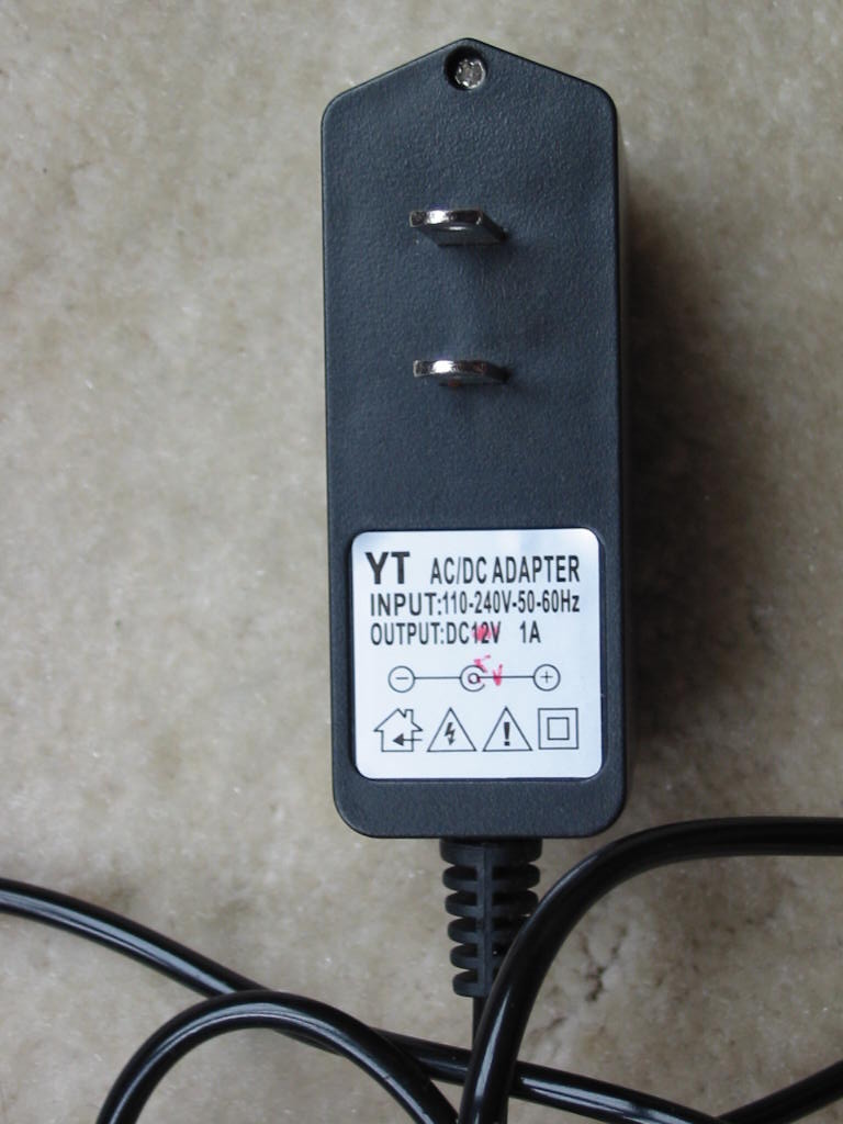

                            YT-1208 power adapter
                            Here's a really lame one:
                            It's a “YT” –branded (read: no-name) power adapter that was included with the programming boards we had to buy for one of our university classes (some years ago back when I was in uni.)
                            Let's look at the label:
                            Well, there's not much to it. A bunch of symbols on the bottom indicate that this is a double-insulated device ( ), for indoor use only, and not to be opened (risk of electric shock.) OK… what about safety approvals? - Bah, ain't nobody care about those!
                            This aside, the adapter is rated for 110-240 VAC input and 12V, 1 Amp.on the output. The red ink marker was actually someone crossing out the “12V” print and writing “15V” below it… which is correct – the adapter does output 15V. I suspect these adapters were bought in bulk for the class and modified by the teacher who teaches (and manages) that class, since he also designed the programming boards too (which were full of cheap Chinese parts and what seemed to me fake Rubycon caps, BTW…) This teacher was also the only one I've ever had problems with in my academic life (calling my project “bull----“, literally)… but that's another story. (It ended OK once I had the dean involved, that's all I'll say here.)
                            Anyways, let's look inside this no-name adapter…
                            Well, at least it was easy to open with just a single screw! Case is quite crappy and made of rather cheap, thin plastic. Input filtering is… where? We just get a small glass fuse and thin (24? AWG) input wires acting as a secondary fuse.
                            “Bridge rectifier” is just four 1N4007 diodes. Input cap is a 400V, 10 uF unit made by Chong (CD11x series… or whatever that means.) Startup cap is a 35V, 47 uF and also Chong CD11x. But hey, on the positive side, at least there is a PWM-FET IC in there: an ST VIPer22A. As for whether or not it's a genuine ST part or not… I heard you like Russian roulette?
                            That aside, isolation is probably the biggest concern with this adapter. First, note how small the transformer is. Of course the PCB silkscreen has marks for a bigger one, but a smaller one was used. And to make matters worse, there is a 1 nF 1 kV -rated ceramic cap between primary ground and secondary ground. Such cap is used for reducing EMI and RFI. Because of the way it's connected, it has to be rated Y1 or Y2 class… which this one is NOT.
                            Let's move to the output/secondary side…
                            Output rectifier is an SB3100 (3 Amp 100V Schottky), with the output DC filtered by a 16V 1000 uF 10x18 mm cap and a 16V 470 uF 10x13 mm cap - both being Chong “LOWESR” CD110x series. A PI coil is also present between them. Finally, the output wires: 20 AWG, 600V. – Yes, “they” used 600V –rated wires on the output but only 300V on the AC input. Perhaps this is to protect the AC line from getting shocked by humans?
                            Last but not least… remember that red marker I talked about on the label that indicated the adapter as being 15V? Well, have a look here:
                            ^ I don't know if this “work” was done by said teacher above (or he might have had students do this for him “for experience purposes”, as from what I learned he also had certain parts of the programming boards done this way.) But either way, that's a craptastic job for sure. I wonder how many adapters arced over and burned out from this hack job.
                            So the above mods were done to convert these adapters to 15V for the programming board we used. On that note, I haven't tested what output current it can sustain. But if I remember correctly, I had no problems pulling up to 500 mA a few times out of it. I also remember a few slightly more careless students who happened to short the output on these power adapters on their breadboard. Miraculously, none of the adapters blew and only shut-down gracefully. So looks like that VIPer22A PWM-FET IC is doing its job properly. Too bad it can't do anything about the lame small transformer and poor isolation with the 1 KV ceramic cap. And while I'm complaining here, I must say that red LED indicator lamp is brighter than a 1000 suns! This may not be a bad thing, though – at least you get a bright RED (warning?) light you that the adapter is plugged in, as if saying DANGER! DANGER! Don't leave me plugged in!
                            On that note, I haven't been using this power adapter for anything other than a few brief tests and nothing where I was grounded. I simply don't trust it. With those caps, the non-existent input filter, and that lame pri-sec isolation, this thing probably won't be used in anything critical. However, I might re-build it one day just for fun - that is, get new caps, replace the 1 KV ceramic cap, install input filtering + new wires, and see if the transformer primary and secondary windings are isolated properly from each other, along with remove those resistor hack-jobs. Oh, I mustn't forget taming the output of that red LED. No idea when (if ever) I'll try that, though. But just throwing the idea out there, as the design with the VIPer22a IC is otherwise decent. At least this one is not a silly single or 2-transistor self-oscillator without any protections.

                                Another Supernight
                                Another day, another Supernight!
                                This one is also popped - blown fuse, shorted primary FET, and blown caps (see below). The case was slightly melted, but I didn't bother photographing it as it's nothing unusual now.
                                Surprisingly the 68µ cap measured about 70µ. I wouldn't be surprised though if the ESR is a bit high - it's likely dried up somewhat.
                                The PWM electrolytic (rated 47µ) measured about 2µ, and after just a moment the meter began freaking out, autoranging back and forth.
                                The popped 1000µ measures only about 130µ and its sibling measures ............ ~4300µ.
                                But what's "special" here, is the primary 68µ 450V cap.
                                It's another fake Nichicon, with a "Y" shaped vent, concentric-circle bung, "HE" series, silver print (instead of white), welded-on leg extensions, and wildly incorrect date code.
                                However ......... This one has hemorrhoids!
                                (Dunno why it pooped itself, looks like the bung melted and bubbled only in a localized area. The top of the cap is not bulged, and the legs are still firmly in place; I've seen this before on high voltage electrolytic caps, but the legs always corrode through and fall off.)
                                https://www.youtube.com/watch?v=CKjaFG4YN6g
                                Originally posted by momaka
                                ... I suspect these adapters were bought in bulk for the class and modified by the teacher who teaches (and manages) that class, since he also designed the programming boards too (which were full of cheap Chinese parts and what seemed to me fake Rubycon caps, BTW…) This teacher was also the only one I've ever had problems with in my academic life (calling my project “bull----“, literally)… but that's another story. (It ended OK once I had the dean involved, that's all I'll say here.)
                                Haha, fake teacher, fake caps!
                                Lemme guess, the project had too much toxic masculinity?
                                It's no wonder why our schools are crap these days - we pay the highest prices for the least amount of "teaching."
                                At least half the teachers (in my experience) try to be more like slave-masters than anything else. If you don't do exactly as told, you'll get a bad grade. "Critical thinking" be damned!
                                -Ben
                                  I don't need to look at HE series datasheets to know the available voltage ratings don't go as high as 450V. The HE series is very good, but that is a very poor counterfeit, and a recycled used part to boot.

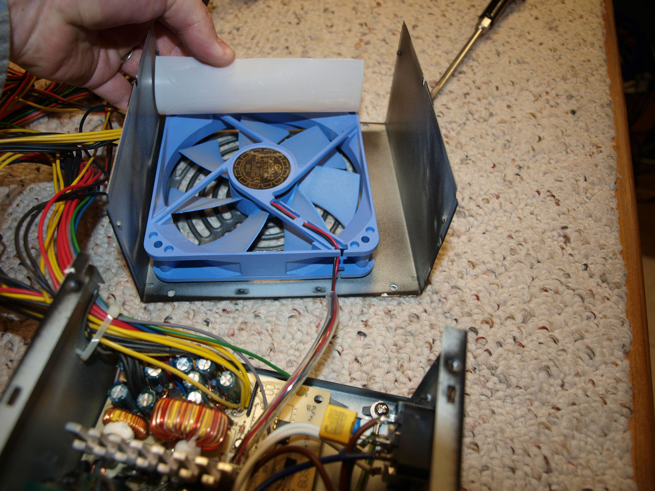

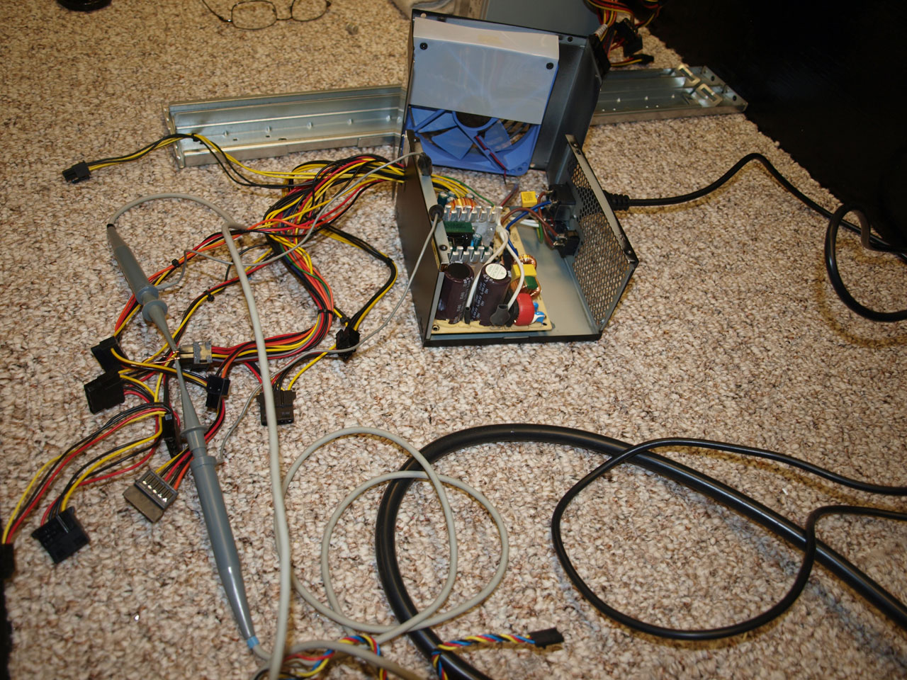

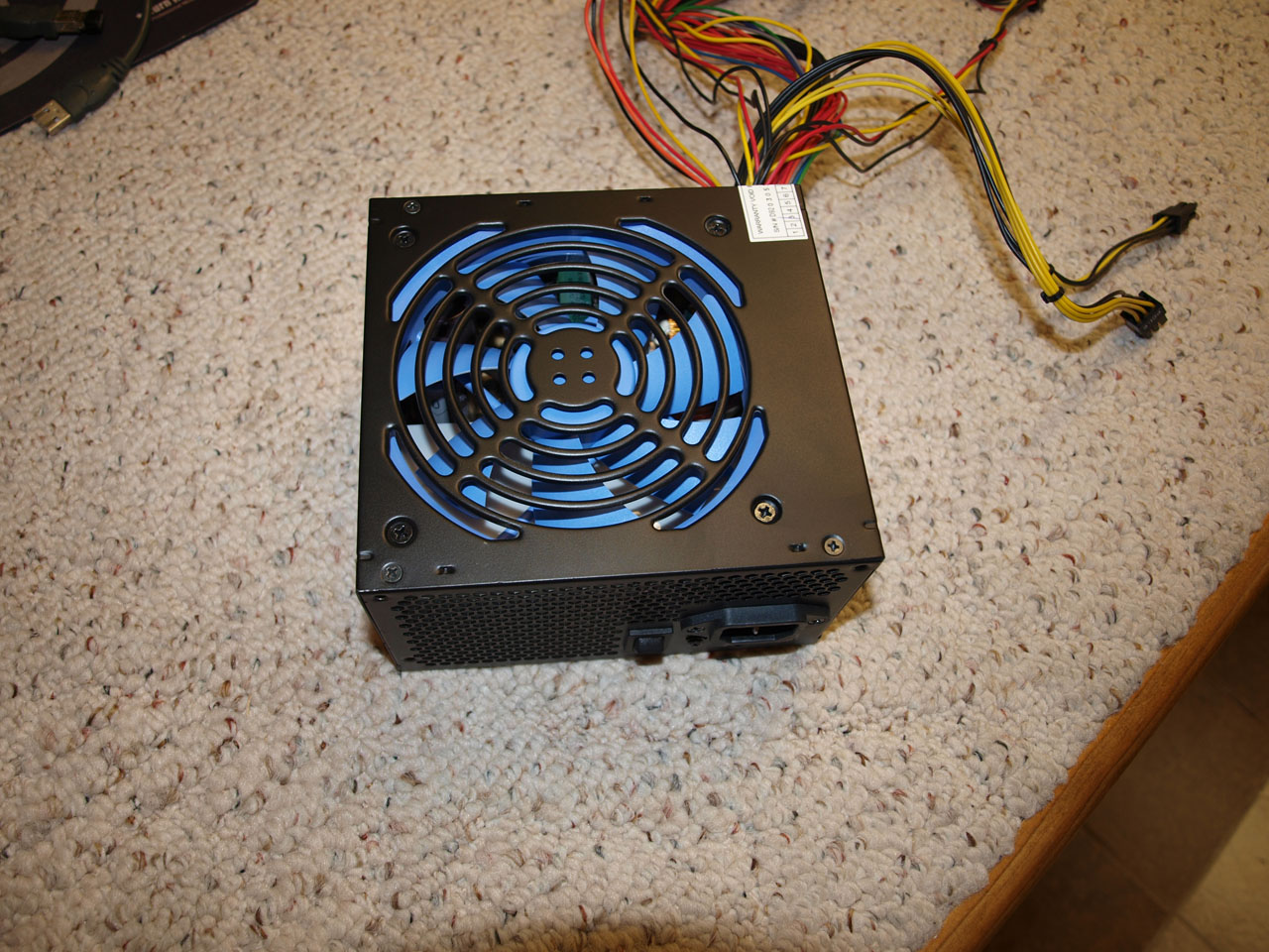

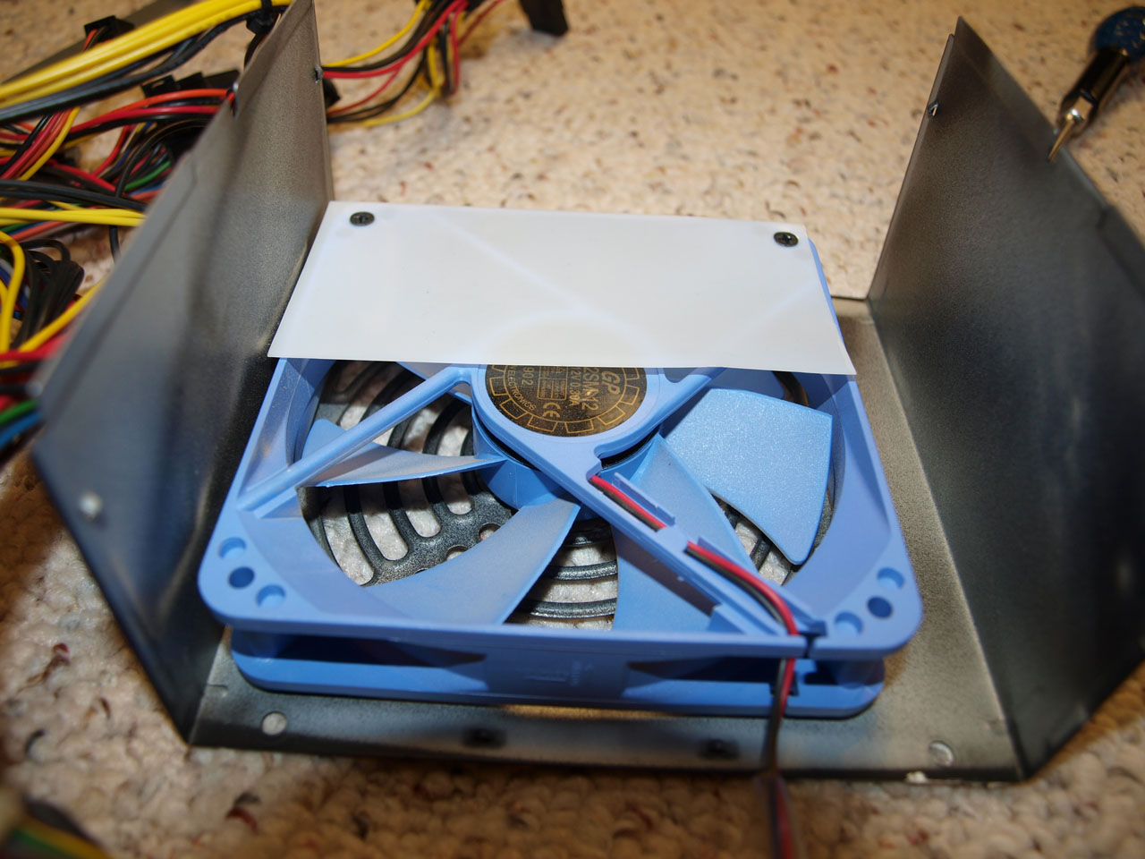

                                          Here's a super junky PSU, reported here at Per's request!
                                          The junker in question is a "Manhattan PUF405S" ATX power supply.
                                          While this supply was working when I pulled it from a system that was given to me, it's definitely a cheapo. The first thing I noticed were the very thin/flimsy wires. I peered inside and noticed about 1/3 of the space inside the case was empty....and this thing weighed less than a happy meal....
                                          Opened up.....and even more embarrassing!! Rated at 405w, look at those puny sinks....
                                          Then WTF is this goofy air deflector on the fan?!? Never seen anything like that on all my years....
                                          More of the puny sinks. Secondary caps are Samxon GF series, known to be a bit problematic....but these appear to be good...
                                          Now to scope the outputs.... They were a little noisy, but not the worst I've seen. When warmed up, the noise did settle down a little.....
                                          The top is CH-A; the 12v rail...the bottom on CH-B; the 5v rail.
                                          Recapping it would likely smooth that out....but this one is just not worth it....I just wanted to autopsy it.
