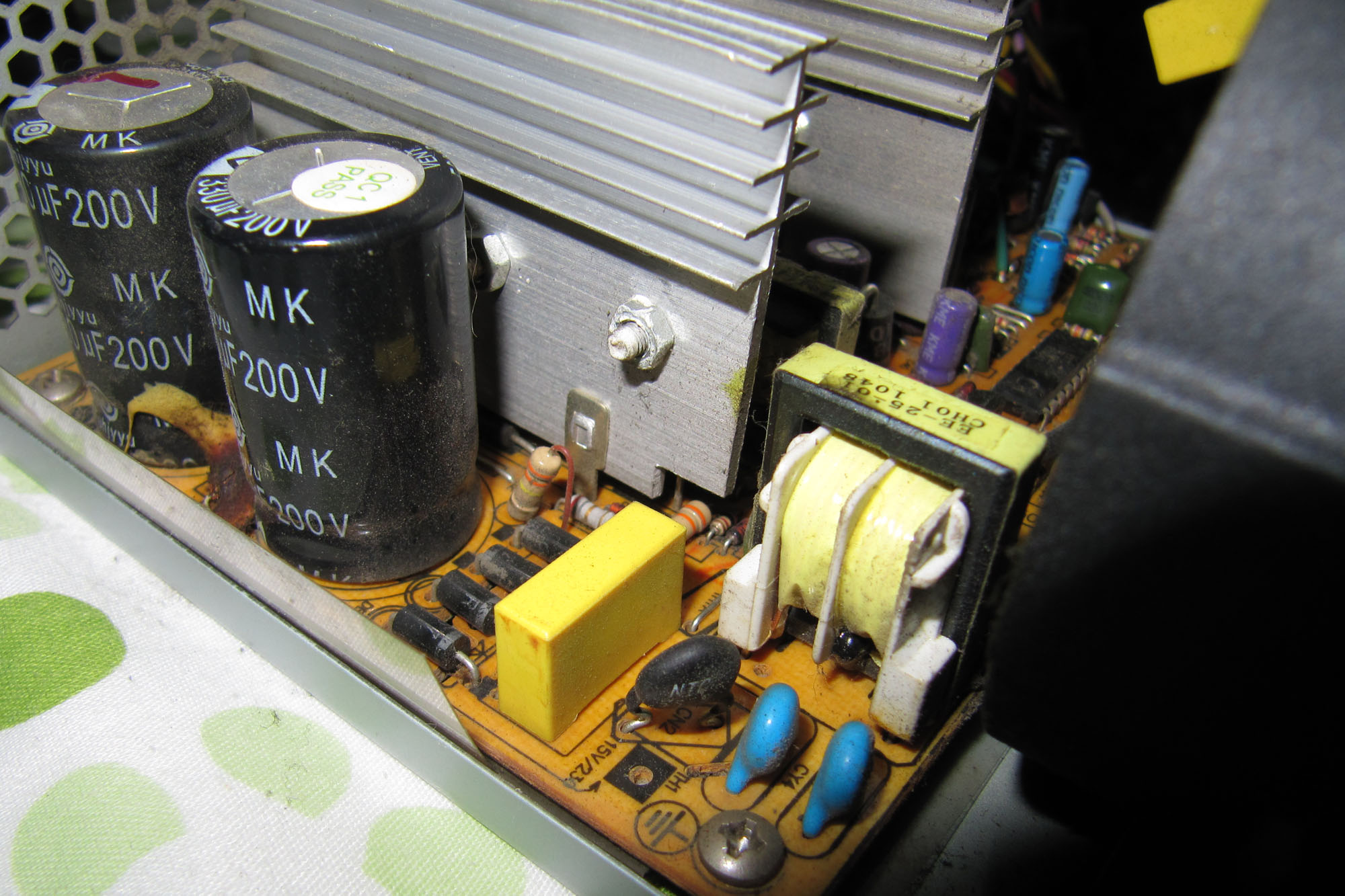

                    Lamtech ATX-S450
                    Personally, I find this psu boring.
                    While most of the components are there, they are just too small.
                    The input filter is here, missing a common mode choke and MOV.
                    The conductive glue is here too. Good!
                    The 4 diodes are tiny but probably good for 230V AC.
                    The primary caps are 330uF, too small to take this unit seriously and who knows if this is their real capacitance.
                    half bridge design with switching transistors 2x D13007
                    very small transformers 33 and 16
                    nicon caps everywhere
                    pi coil for every output voltage and 2 caps for all voltage rails except -12V
                    tl494 and SDC339 ICs
                    very small toroid coils
                    S16C45C @ 3.3V
                    S20C45C @ 5V
                    F16C20C @ 12V
                    This unit was made in 2011 and looking at the label:
                    15A @ 12V
                    there is no excuse for that
                    The label also states that there is -5V rail and the white cable is there, but the place for -5V output cap is not populated on PCB.

                        #1611
                        Re: the gutless, bloated, and fried power supply hall of shame
                        Originally posted by goodpsusearch
                        Lamtech ATX-S450
                        Agreed.
                        Looks like a decent *try*, but just a tad bit short of being overall decent PSU.
                        15A on the 12V rail will do for a basic system, if it can provide that much in spec. With 2 output caps and a PI coil, it probably will - just barely, if the caps on the 12V rail are 1000 uF each (and they look like they are.) Still, it ticks me off to see a 450 Watt rating on the label. If they advertised this as a basic 200-250W PSU and sold it for the right price, this would be much better alternative than, say... Powertech or L&C.
                        Fuhjyyu MK, I see. Generally speaking, Fuhjyyu... no matter how crappy people say they are... don't lie about their capacity. I personally would take them any day over CapXon.
                            Yeah, that Lametech looks like it could be a usable 200W P/S - limited by the 330uF F-yus, where's-the-beef heatsinks, under-sized main transformer, wimpy output rectifiers, almost-tiny toroids and AWG #20 output wires. It looks like its Y-caps are safety rated types, though.
                              They're not.
                              I've had 2 Delux PSU with the same PCB and the caps read "472 1KV" on both.

                                  Oh man, that ^... is soo gutless!
                                  Even if the PSU didn't have any damage, I would NOT use it for anything - not even powering small DC fans.
                                  Originally posted by Dannyx
                                  Severely failed mains caps on a trash-picked RPC ATX supply.
                                  Two diodes of the bridge were shorted.
                                  The fan was not seized when I found it (so I kept it ), so the cause of failure wasn't actually excess heat, but likely overvoltage !
                                  Looks like it.
                                  I don't see an input voltage selector switch, so it's not possible for someone to have set the PSU for 115V AC operation and then plug it into 230V AC (which is one way to cause this kind of damage to the primary caps.)
                                  Instead, it looks like either one or more of the diodes in the full "bridge rectifier" on the input overheated and shorted, sending AC current to the input caps...
                                  -OR-
                                  There was a power surge from nearby lightning strike hitting a power line and causing massive over-voltage.
                                  I imagine this PSU came from the city, where majority of AC power distribution to residential buildings is underground. So that means caps likely blew because the diodes in the bridge rectifier failed.
                                  Look at those caps more carefully: only 200v rating ? There's no PFC here, so although B+ doesn't go as high as 400v, I know for a fact it's still around 300+ after the bridge rectifier, making a 200v rated cap about 100v too low ! Could it be they're in series ?
                                  Yes, the two primary caps in these cheapo PSUs without APFC are -ALWAYS- in series. So the total DC voltage they can handle is 400V, and total capacitance is half, or approx. 235 uF, assuming they are real capacity 470 uF caps (given the dubious cap brand, that is an optimistic assumption. )
                                  Also, for half-bridge PSUs, you must have two series caps on the input. That way, the input voltage is divided equally. The "center tap" or "middle connection" of these series caps goes to one side of the main PS transformer on the primary (through a metal film cap). The other leg on the primary side of the main PS transformer is switched between +340V and primary GRND by the two BJTs. So this creates a series of square wave pulses with 170V amplitude across the main PS primary side. On the secondary side, you have center-tapped windings for a 5V rail and 12V rail, from which the 3.3V, 5V, 12V, -5V, and -12V rails can be derived.
                                  Also, have a look at that top "shelf" of the heatsink. Yes, that's right: the force of the can being "ejected" upwards was so great that it bent the corner of the heatsink. I myself wouldn't be able to do that bare-handed
                                  Yeah, when caps explode fast like that, they can cause quite a bit of damage.
                                  I have an old L&C/Deer PSU, whose unfiltered high-side 5VSB cap exploded and also bent a fin on the secondary-side heatsink, just like on your unit.

                                    #1617
                                    Thanks for this...to this day I must admit I'm not all that knowledgeable about the operation of SMPSs, esp. ATX ones - I know the basics enough to fix them (when worth it), but don't know their operation in great detail. For instance, until quite late in my electronics career, I had no idea what the third small transformer is for in most units - I now know it's for feedback (though still not sure for which rail). I always thought it was for the 3.3v output...

                                      #1618
                                      I'm going to concur with momaka, the big lytics probably failed when one of the rectifiers in the bridge shorted and the caps saw reverse voltage. While the label value of 470uF in that configuration would probably be OK for 250W, that inverter heatsink puts the useful power (if operating) at around 200W. And if the rest of the PSU is as skimpy as the non-existent power line filtering, that might be pushing it. It might not even have many parts worth salvaging.

                                        #1619
                                        Actually, it did: I stripped the entire board, I mean ALL OF IT: resistors and everything You have no idea how much I'm starving for parts over here
