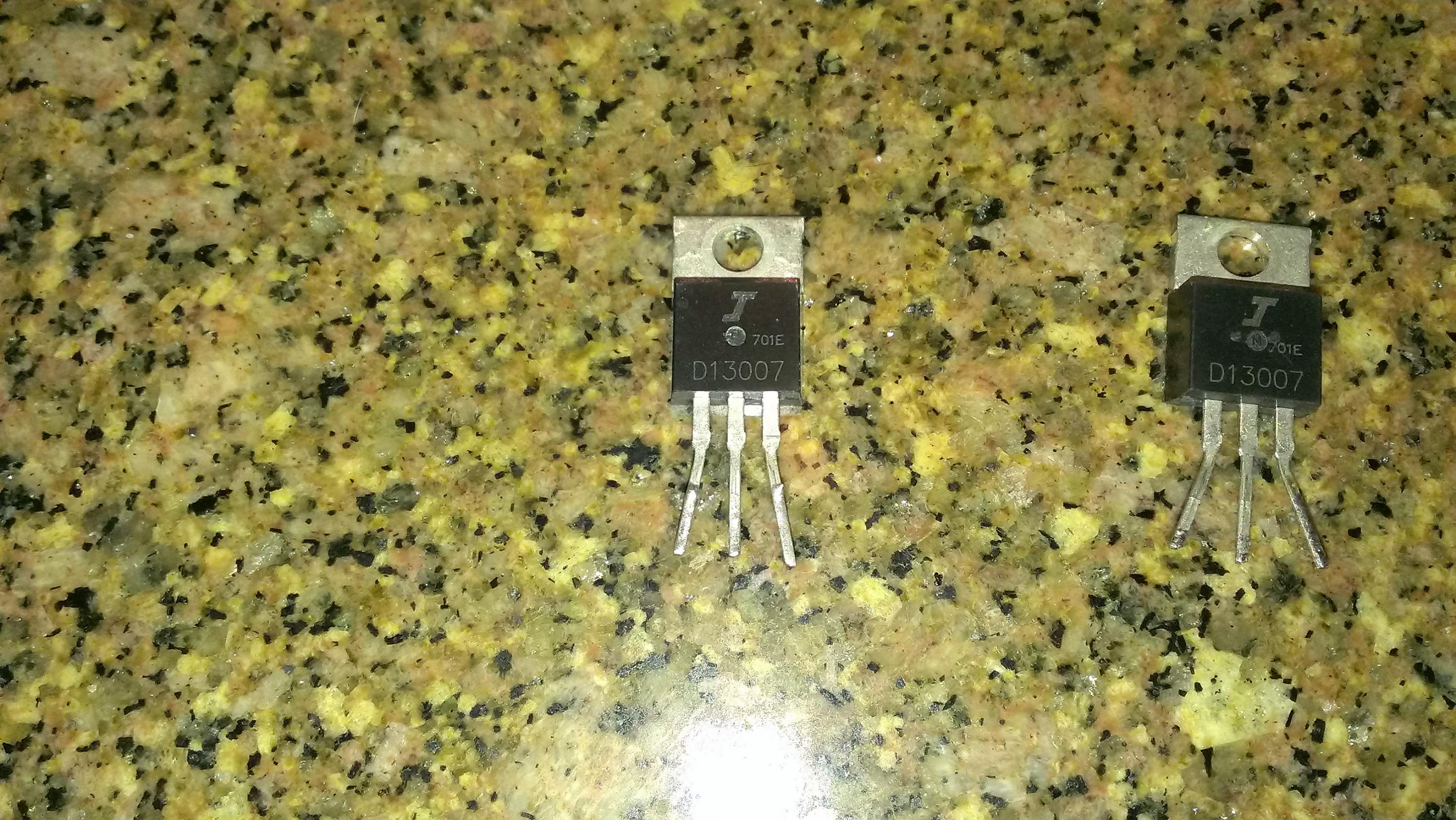

        Originally posted by Pentium4
        Same picture as in the badcaps photo gallery
        They have the Fairchild F, with no dash through the F and they just look cheap. I will post a picture of them later tonight
        Ahh yes, I have seen those! I pulled a pair of 13007's and 13009's out of a pair of YueLin YLP-013's. I just called them "Jairchild" as I could not find any manufacturer information.
        In fact, I just found them:
        • Pentium4
          CapXon Be Gone
          • Sep 2011
          • 3741
          #744
          Re: the gutless, bloated, and fried power supply hall of shame
          Mine actually look different though, I couldn't for the life of me get a good picture of them with my phone but this is the best pic I got
          • ben7
            Capaholic
            • Jan 2011
            • 4059

            • Pentium4
              CapXon Be Gone
              • Sep 2011
              • 3741
              #746
              Originally posted by ben7
              They are definitely fairchild parts you have there.
              It's weird though, the one you can't see on the left has a different style F than the one on the right.
              • ben7
                Capaholic
                • Jan 2011
                • 4059
                #747
                Like this one? That is a toshiba made transistor.
                Muh-soggy-knee

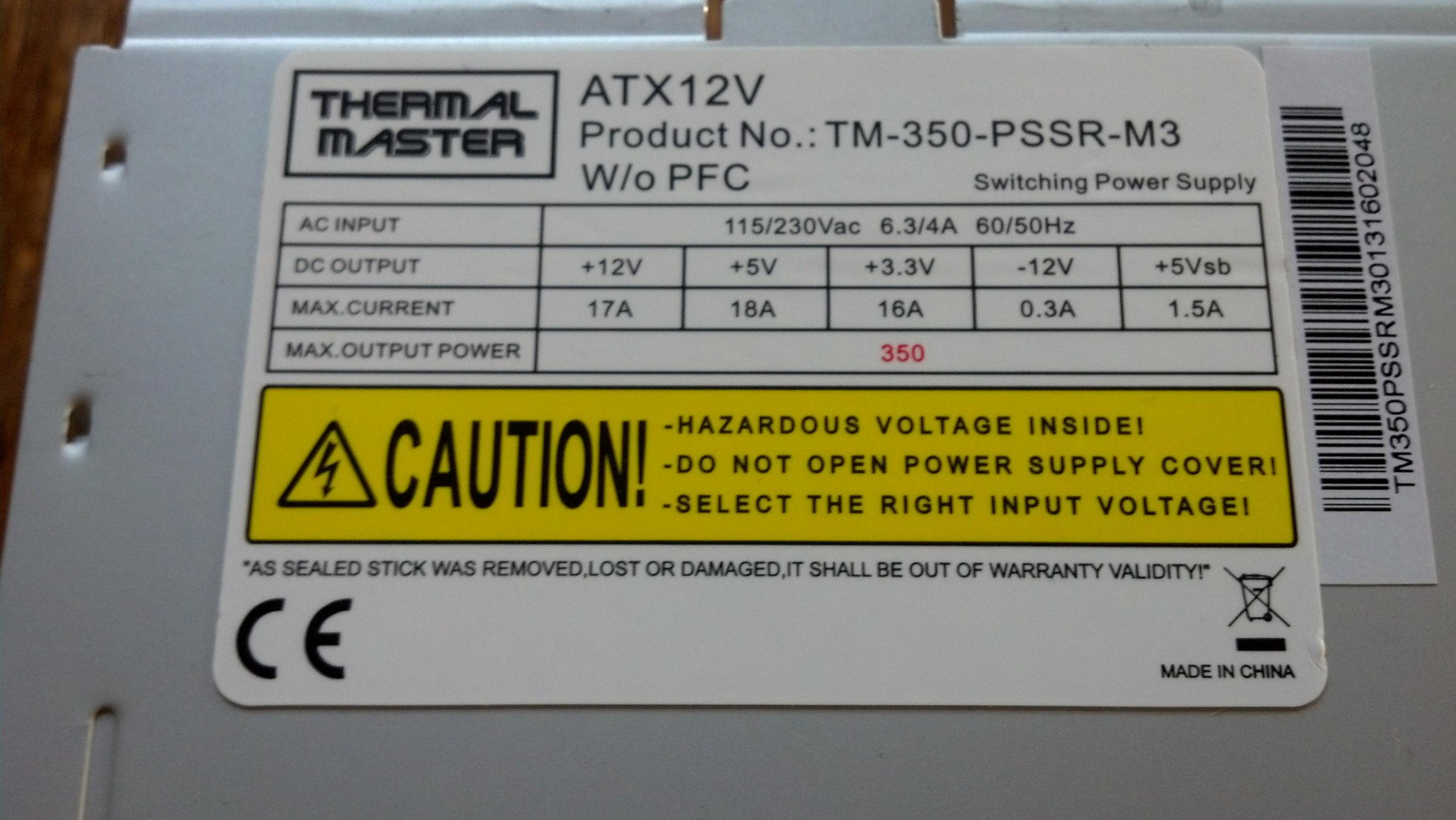

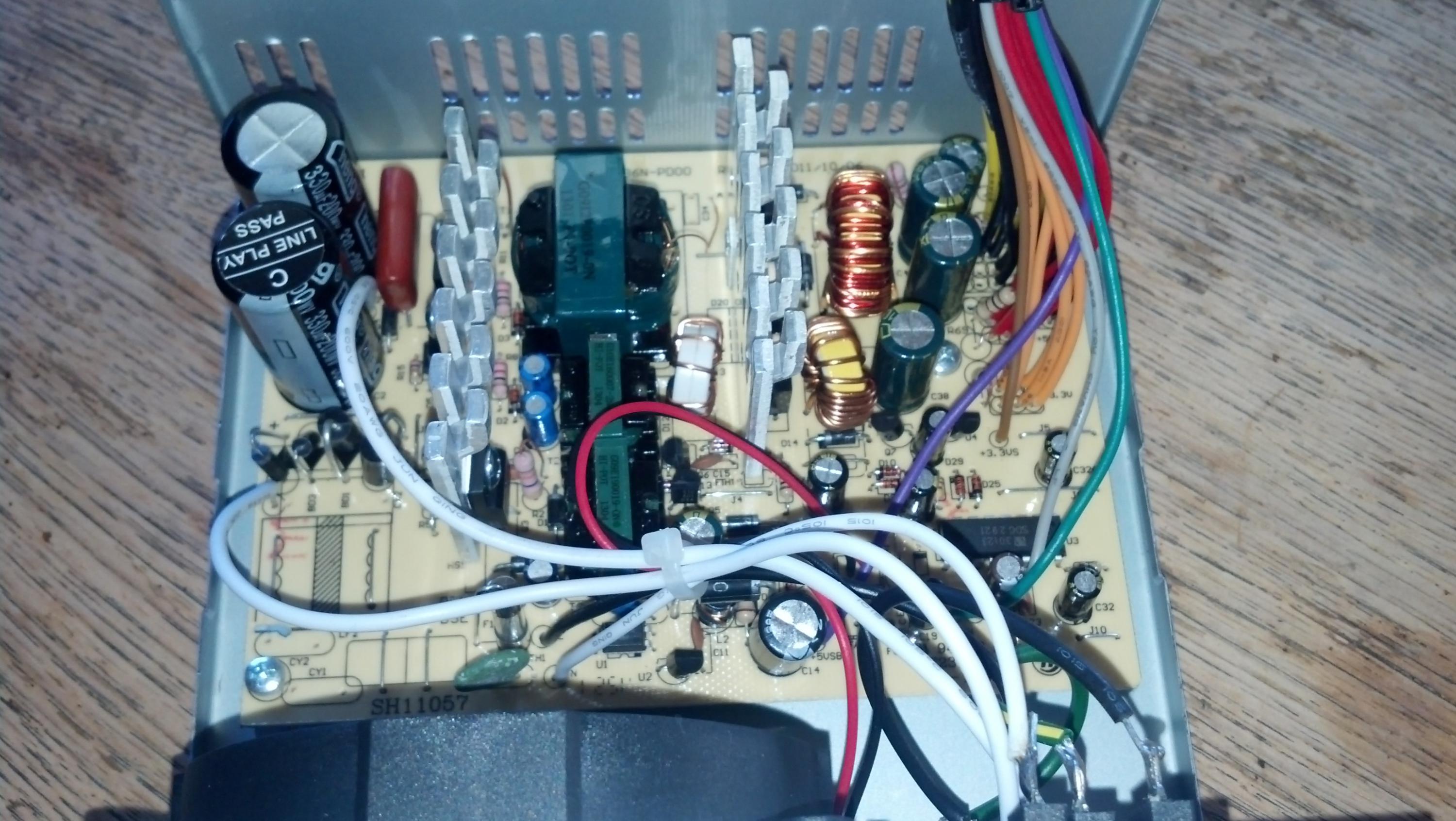

                  This thing came in a case. CWT, you should be ashamed! This thing is so bad. No input filtering, 330uF input caps (They're actually 220uF) 13007's, one of the smallest main transformers I've seen in an ATX PSU, 16A for 3.3V and 5V. 10A for 12V. hardly any filtering, tiny output coils. Look at the grounding wire for the transformer This thing is just horrible.
                  • dmill89
                    • Dec 2011
                    • 2534
                    #749
                    Surprisingly the Sun-Pro built Thermal Master's are actually built better.
                    https://www.badcaps.net/forum/showth...Thermal+Master
                    CWT really should be ashamed.

                          #752
                          Yes you are right. What do you think it could do? I think this is a rare instance where the transformer would saturate before the 13007's would blow LOL
                          • PeteS in CA
                            • Aug 2005
                            • 3581
                            • USA, Unsure of Planet

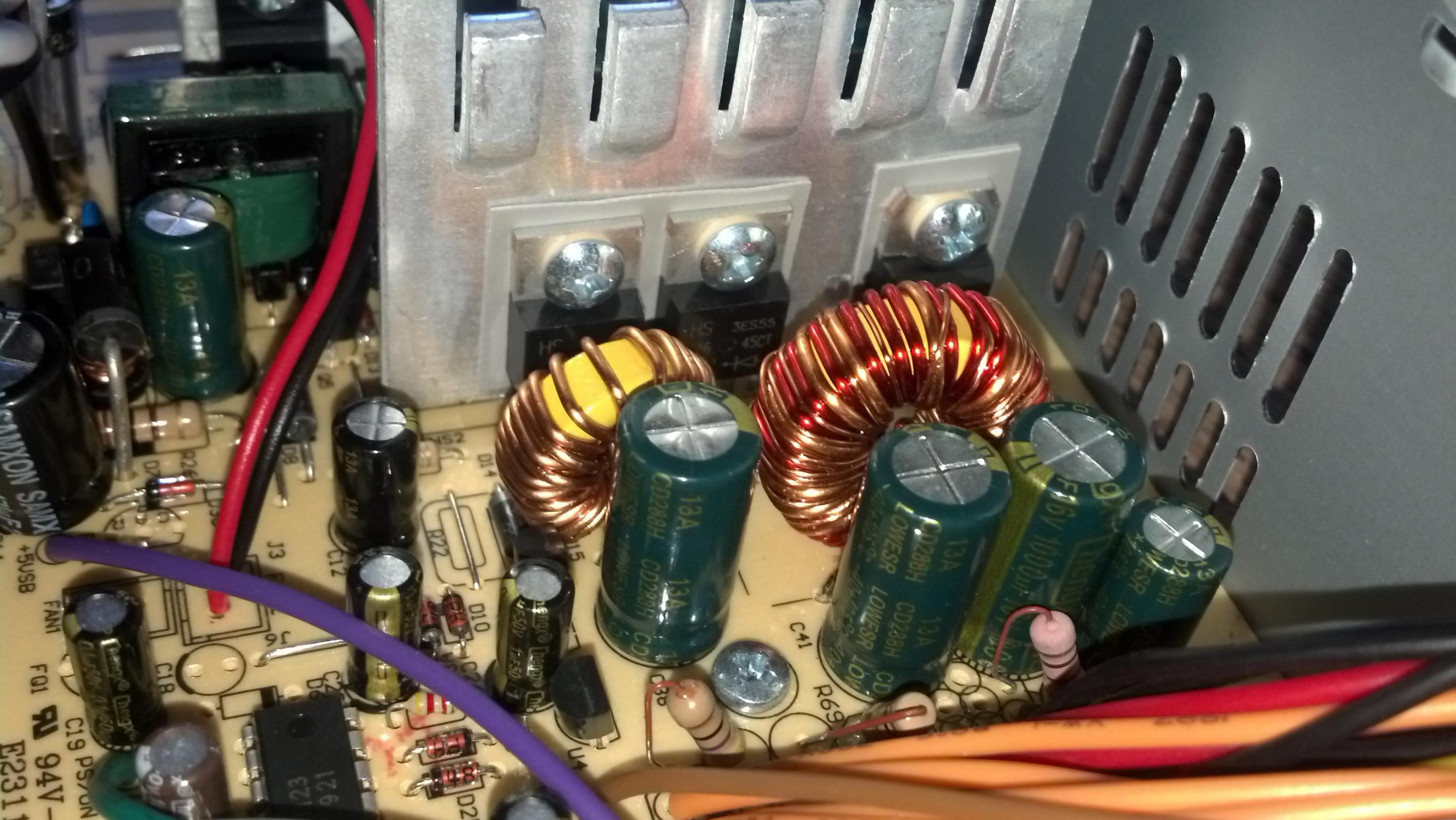

                            #753
                            Very shortly before, I would add. That said, wh-e-e-e-e-ere's the BEEF? There's hardly any there, there. 250W would be pushing your luck with that one. At least it's light ...

                                  #756
                                  No beef! It's funny because if every one of the rectifiers on the 3 main rails was pushing their rated amperage, it would be just a hair over 250W
                                  Originally posted by lti
                                  That might be even worse than that 420W Okia (also built by CWT).
                                  Might be...at least this one has two toroids!
                                  Originally posted by Agent24
                                  That design seems to be popular... I've seen it in ColorsIT and Excel PSUs too, 120 and 80mm fan versions.
                                  Were they CWT as well?

                                    #757
                                    I'd give it 200W without blowing up, but nothing at all with the ripple in spec.
                                    • lti
                                      • May 2011
                                      • 2551
                                      #758
                                      The Okia had room for pi filters on all outputs and didn't have that one random strand of wire coming out of the transformer for grounding. How is that supposed to work?
                                      • PeteS in CA

                                          #760
                                          Please double-check tell me this really is NOT the grounding wire! If it is, it would be absolutely ridiculous. Maybe a bad joke on CWT's part?
                                          Also, notice the text under the warnings on the label.
                                          "As sealed stick was removed,..."
                                          Hilarious!
                                          IMO, that main traffo won't handle more than 150W. Come on, it's the size of a quarter!
