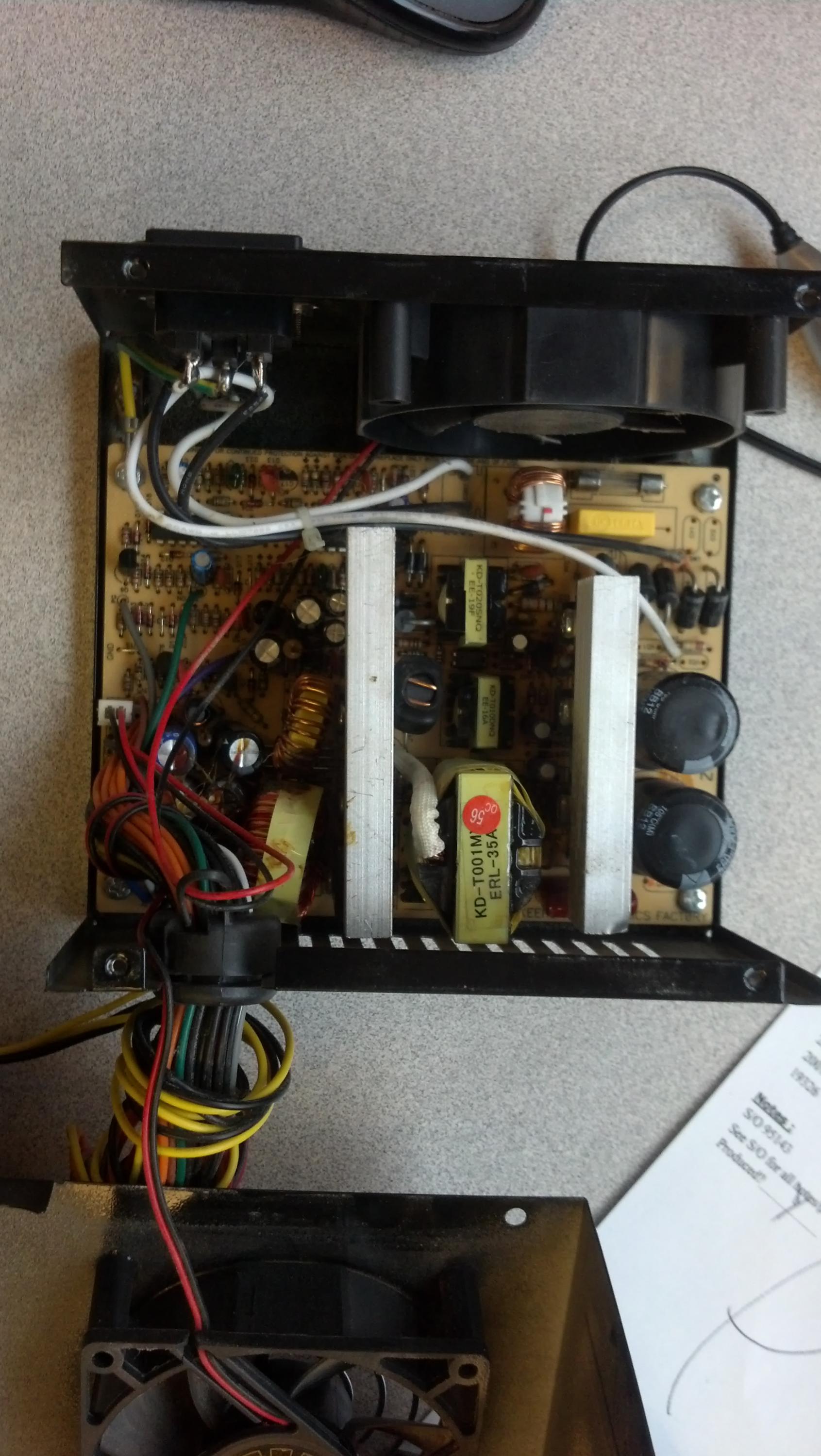

    The UL Number on the PCB (E171766) points to Fai Wong Electronic PCB Co, but they are just a PCB manufacturer, so that doesn't tell us much about who actually assembled the PSU (maybe that's supposed to be Fail Wong Electronics )
    The UL number on the case (E161870) returns no results at the UL database, so it's possibly forged.
    I must say, though, that green logo on the transformer looks familiar to me. I can't remember where I've seen it, though.

      Thanks for all your info. My friend paid 150000 vn dong (about 7 USD) for it, don't know how much power it could supply.

        Looks like the transformer is so tiny, I bet it will saturate and blow the switching transistors before it reaches 450 watts xD
        Atleast the heatsinks are somewhat decent, not just thick hunks of metal.
        I wonder if those primary caps actually read 330uF, or if they read 220uF xD
        Any way, those are tiny for a 450 watter.

          Yes, the transformer is very very small, it is smaller than the one of my Pen II Dell 200W PSU.

            Well at least there is room enough for some airflow inside
              450w !? You're lucky if that psu goes over 200 watts ! )
              Those rectifiers on the secondary side are rated for 16A and 12A ... so it might do 3.3v @ 16a =53 w , 5v @ 16a = 80w , 12v @ 12a = 144w ... but the transformer itself is designed for 150-200 watts ..

                I'd give it 200W without blowing up, but given how little output filtering it has, I doubt if it would be able to deliver anything at all with the ripple in spec.
                  Yeah, I inferred the 450W from the label. Ofc, they always lie about the wattage rating
                    Exactly! Who cares about raw output power if the PSU's ripple is in spec only for a fraction of the wattage it can do.
                    With those tiny caps and inductors on the secondary, I'd say about 50W is the MAX usable power you can get out of it before ripple and noise go out of spec. I had a cheap L&C with a similar cap configuration on the secondary and it couldn't even power a 400 MHz Pentium II (24W TDP, 33W max) PC under full load! And all that computer had was a low-wattage S3 Savage 4 8MB video card and a single low-power Seagate HDD.
