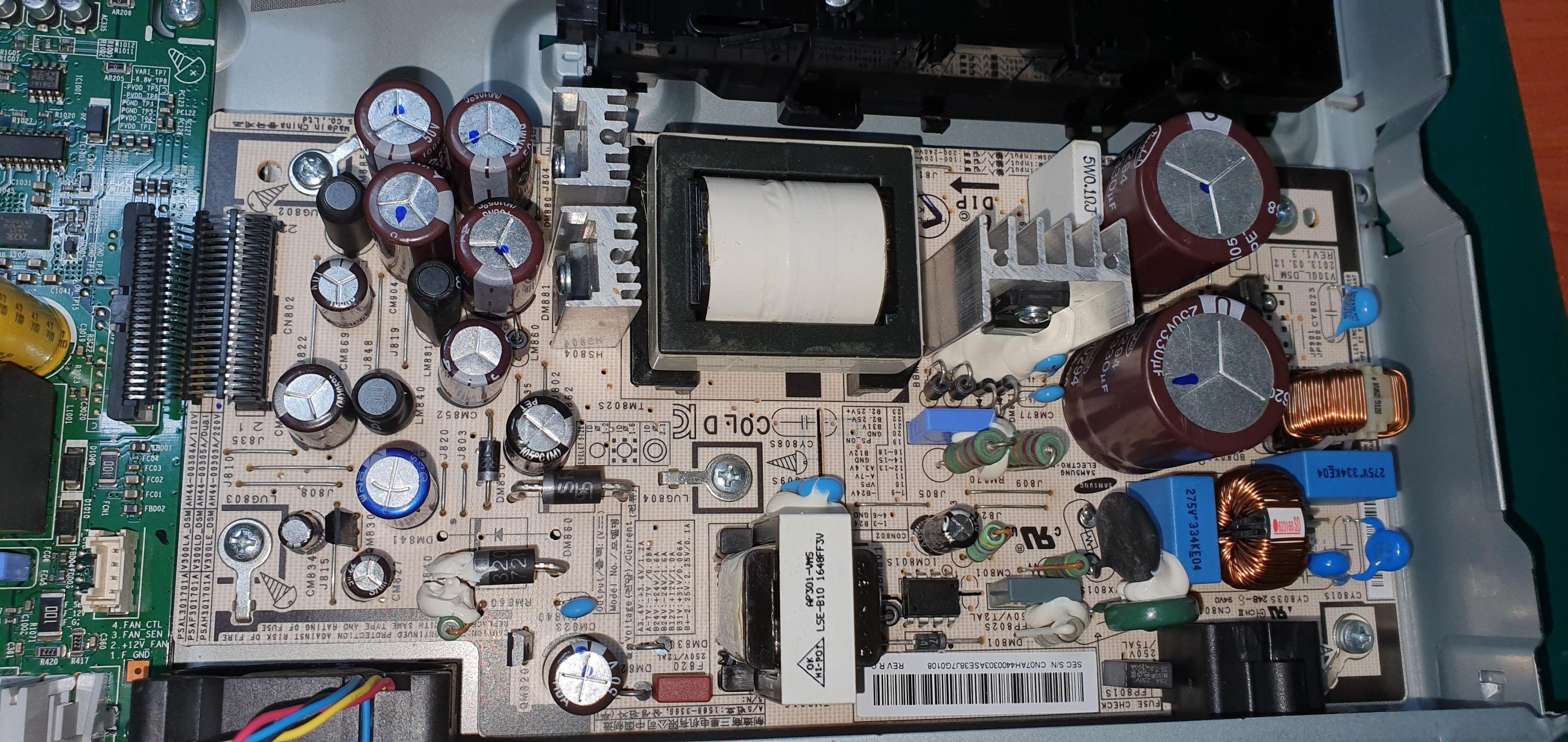

replacing schottky diodes on a AV power supply
    replied
    Re: replacing schottky diodes on a AV power supply
    the sr320 looks fucked for a schottky - thats far too much voltdrop
    probably damaged - just not as much as the other one.
    Leave a comment:
  • DjKrish
    replied
    Re: replacing schottky diodes on a AV power supply
    Originally posted by stj
    i dont understand where you got the numbers,
    test the diodes with your diode-test on the meter - both directions.
    test on V mode while power on.
    while take off from board, these are the reading on diode mode
    sr320 - 0.343v
    sr340 - 0.164v
    Leave a comment:
    replied
    Re: replacing schottky diodes on a AV power supply
    i dont understand where you got the numbers,
    test the diodes with your diode-test on the meter - both directions.
    Leave a comment:
  • DjKrish
    replied
    Re: replacing schottky diodes on a AV power supply
    Originally posted by budm
    What happen if you test the SR340 and compared to the SR320 with you meter?
    SR320 - 15.33v
    SR340 - 5.56v
    No wonder theres no power when i put SR340. I wonder why
    Leave a comment:
    replied
    Re: replacing schottky diodes on a AV power supply
    What happen if you test the SR340 and compared to the SR320 with you meter?
    Leave a comment:
  • DjKrish
    replied
    Re: replacing schottky diodes on a AV power supply
    I tried the following.
    1 piece of SR340
    2 piece of SR340
    1 piece of SR320 and 1 piece of SR340
    None works. If i pull all and put only 1 piece of SR320, it works. Sighs
    Last edited by DjKrish; 08-28-2020, 08:11 PM.
    Leave a comment:
  • DjKrish
    replied
    Re: replacing schottky diodes on a AV power supply
    Originally posted by budm
    That does not make any sense.
    What exactly did you put in?
    Its a home theaters SMPS. I know, it doesn't makes any sense either. But i dont know, i took out the old one, put in 2 new SR340, power on, no power. Pull out again, put in the old SR320 diode, its working and i was like LOL
    Last edited by DjKrish; 08-28-2020, 07:55 PM.
    Leave a comment:
    replied
    Re: replacing schottky diodes on a AV power supply
    Originally posted by DjKrish
    6A 20V, noted, will try that. Cause i fitted the 3A 40V diodes, no power at all. When i fit back the single 3A 20V, its working again.
    That does not make any sense.
    What exactly did you put in?
    Leave a comment:
    replied
    Re: replacing schottky diodes on a AV power supply
    higher voltage is fine - infact with schottky's you really want 10x the running voltage.
    https://www.badcaps.net/forum/showthread.php?t=54038
    Leave a comment:
  • DjKrish
    replied
    Re: replacing schottky diodes on a AV power supply
    Originally posted by stj
    neither, your going to need 6A at 20v, not 3A at 40v
    parallel diodes double the current, not the voltage
    if you check my Ryobi charger thread, i replace a couple of diodes with a 25A to220 package part
    6A 20V, noted, will try that. Cause i fitted the 3A 40V diodes, no power at all. When i fit back the single 3A 20V, its working again.
    Leave a comment:
    replied
    Re: replacing schottky diodes on a AV power supply
    neither, your going to need 6A at 20v, not 3A at 40v
    parallel diodes double the current, not the voltage
    if you check my Ryobi charger thread, i replace a couple of diodes with a 25A to220 package part
    Leave a comment:
  • DjKrish
    started a topic replacing schottky diodes on a AV power supply
    replacing schottky diodes on a AV power supply
    Hi guys, i have a power supply with a shorted SR320 schottky diodes which is in parallel. Only 1 shorted while another is ok. So i removed the faulty one, the power supply is working fine now. SR320 is 3A 20V. I was thinking can i remove both diodes and replace SR340 as 1 diode as it is 3A 40V? Because i dont have SR320. Or can i replace both with SR340?
    Last edited by DjKrish; 08-28-2020, 01:33 AM.
    by sam_sam_sam
    03-31-2024, 02:12 PM
  • caspian
    What Zener Diodes on a Linear Power Supply
    by caspian
    Dear members,
    I have a linear variable power supply with unknown brand name that I used for voltage injection.
    Then it failed. I discovered that its transistors (Q1 and Q2) are shorted.
    In addition, I discovered that its zener diodes are defective.
    I can replace the burned transistors.
    But I do not know the model of the zener diodes. the model number is not marked on the zener diodes.
    Therefore, I cannot replace the zener diodes.
    I do not want to test the zener diodes in a test circuit to discover their model or value.
    no schematics are available...
    05-26-2025, 12:38 PM
    by sam_sam_sam
    07-01-2024, 06:34 AM
  • shamsudeen
    Hi, Can we use SMPS Bench Power Supply for Laptop troubleshooting?
    by shamsudeen
    Hi all, I just need to know that, can i use SMPS type power supply to test and short circuit detection on a laptop motherboard?
    I saw 95% of repair guys are using only Linear bench power supply. linear bench power supply is pricy, thats why i planned to get one SMPS supply.
    i know that in linear power supply the noise will be very low comparing to SMPS supply....
    07-19-2025, 07:14 AM
