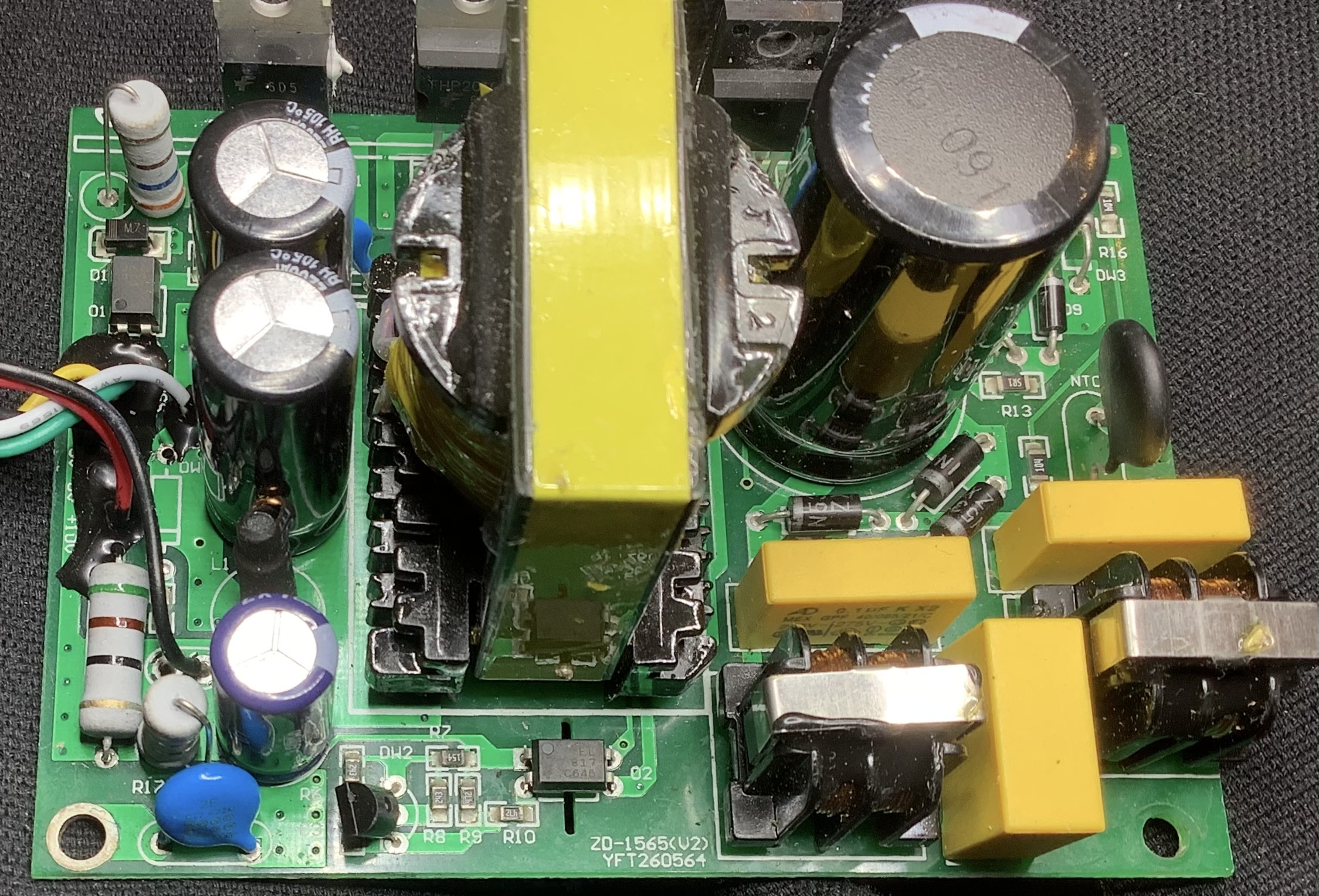

    Why the CQ1565 fails easily? I don't really like that package of the switcher at all. It is the worst thing ever a switcher could be in. The HV pin is very close to the other pins, IF you didn't really clean the living hell out of that spot using 99% IPA or Acetone, leave a little hair, a piece of paper towel etc, it will die sooner rather than later.
    If you have any switching IC in that case style to replace, everything gotta be perfect. Other than that it will blow again. Been there and fixed other peoples mistakes quite a few times. That spot has to be squeaky clean hospital grade.
    Thank you for sharing and pointing out about how clean you need to make around this switcher pins REALLY this nonsense that you have to be that careful with these switchers I was not aware of this until you mentioned it in this post I was just making sure that there was no flux around the pins and the traces around the switcher pins
    I would agree with you on this one but the switcher is not suitable for this type of situation where you have current spikes when you trigger the vacuum pump with short bursts this does not help matters at all one of my desoldering stations is going bad or it needs to be recapped because when we had a cold spell a few weeks ago I went to turn it on it power cycled several times before it stayed on I just had not had time to deal with it yet maybe this weekend I will get to it

      if the switcher see's large current spikes your caps are not good enough.
      you need more uf / ripple capacity as a reservoir.
      or lower esr to increase cap reaction time.

        When a switcher IC blows, it is common for other parts connected to it to get damaged. They can see DC bus voltage until kabang. Check all the resistors, the SYNC pin parts etc.
        The 10uF 50V cap is critical and will cause the IC to blow up under heavy load, if the cap goes low value/high ESR.

          Agreed, but this package is very sensitive to dirt, residue, moisture etc. It's literally the worst package I've seen for a switcher to be in. The pins are just too close together. stj comment using some RTV that doesn't smell like vinegar, is a good idea as well. These type of switcher package likes either to blow up or play dead. Waaay more so than any other package.

            So should the start capacitor or the main filtering capacitor be a slight higher value or what is the solution for this issue if the switcher is that sensitive voltage spikes or heavy loads because when you run the vacuum pump you are current surging every time you turn on and off the pump
            The only other solution is get a Mean-well switching power supply or a Delta switching power supply and modify it for this desoldering station which could be done the only issue is the -5.00 volt power rail which is kind-a weird the way this power rail is done in this device and you would have to carefully remove the control circuit to control the heating element for the gun and if I remember correctly it also has the control circuit for vacuum pump as well which could be done but not very easily
            So far I have gotten many hours of use before I start having issues with the switching power supply but I have recap the one I am currently using because I have seen it power cycle a few times when it is cooler outside which it has not done this before

              There's a chance the power supply is not a great design. It's a current-mode controller which shouldn't care if the output is overloaded or not. Abnormal overcurrent protection- the IC shuts off and stays off.
              The tuning cap across the mosfet D-S, the SYNC pin resistor/capacitor values might not be correct for the quasi-resonant mode it is supposed to run in.
              A ferrite bead is used on IC pin 1 but not sure if the ZD-985 has that.
              The IC is good for 200W but it's either counterfeit IC's or the circuit design might be a bit off.
              Fairchild FSCQ1565RT
              There was a lot of patent litigation between Fairchild and Power Integrations so they had to make IC's a bit weird and complicated, and designing them in is difficult.

                Well I took apart the desoldering station the soldering iron side which was the side that was cycling a few times before it stay on the two 10uf@50 volt capacitors extremely bad ESR reading was 5.50 this is not a misprint a new one is 0.48 to 0.51 so way off I am surprised that it was turning on and running when it did run
                But unfortunately this not the only issue the vacuum pump has some issues because it does not have very much suction like it did new the cooling fan sounds like shit when you first turn it on it might get some newer parts from one that dose not go to sleep after a certain period of time has passed which is the version that I use the most
                I might have some time to tomorrow to work on it and get it up and running again in better condition than what it is currently

                  It's good you caught the 10uF cap dying before the IC blows. That ESR was really bad.

                    No the cooling fan is going to be replaced with a 24 volt version instead of the 12 volt one that is in there now and the resistors remove
                    The Vacuum pump is a 12 or 18 volt pump motor the issue with the pump is the residue that builds up because of use you basically carefully removing the pump cylinder rubber cups and clean the metal disc and lightly re-oil the cylinder and carefully reinstall the rubber cups with the retaining clip and then the pump has more suction but I going to instead reconditioned the pump and put in my other desoldering station that I do not use very much because it does not have the tilt switch function on it which is very important thing to have when you use it for a few minutes and then you are getting other things ready to be repaired so you do not prematurely wear out the tip of the soldering iron
                    Plus there seems to be a slight issue with the switching power supply when I partially recap it power cycle once but it also seems to have a slight issue with the temperature sensor causing it to flicker the temperature reading when you first turn it on I have not seen this issue before I am not sure what this is all about so I have another controller board that has this function that I do not use very often because it has the heat gun feature on the other side of the soldering iron so only when I have to use the hot air gun is when I use this version one I can deal with when I need use it off and on I did do a modification to this soldering iron / hot air gun because I do not understand why when they made this hot air gun that they did not have a cool down mode on it I add this feature to it with a light above the switch that the LED light comes on when it is the cool down mode I will post a picture of it when I finish restoring it back to it original functionality and can use it without being aggregated using it because of very low suction and power cycling and just misbehaving and throwing a temper tandem because it tired of being used
                    I guess I need to recap the other switching power supplies that are for these desoldering / iron / hot air gun systems before I have a major meltdown because of bad capacitors unfortunately these switching power supplies are not very easily done because of all of the metal enclosure covers that you have to remove and reinstall and all of the screws that hold these things together

                        Unfortunately I might not have caught it earlier enough because this morning it rather cool and it is power cycling again so it might have damaged the switcher so I have to order some and replace it and see if this fixes the issue with it cycling I had one that was doing and after replacing the switcher it keep doing it and I came to the conclusion that it was the switching transformer because when I transplanted the switching transformer it blew the switcher which I was not expecting that to happen

                              The switcher either works or it doesn’t. So either it’s a cap issue, a bad solder joint, something wrong with the feedback. When that iron clunks out, does the display go out too?

                                Yes it does for about a second and then restarts again for about a second and just keeps restarting but if it a lot warmer like in the afternoon it will start normally I change the two 10uf@50 volt capacitors which did not change anything that it was doing so I am confused about about exactly what wrong with this switching power supply and yes the new capacitors were checked with a ESR meter before they were installed
                                When I had another one of these switching power supply for the desoldering gun station did kind-a nonsense I first replaced the two @10uf@50 volt capacitors and the same thing when it was cooler weather it did the same thing so I replaced the switcher and it was better but when it got cooler it would do the same thing but when it got warmer it would not power cycling anymore so you when someone on the forum had there ZD-915 desoldering station switching power supply the switcher blew up he sent it to me I tried to to repair his switching power supply board so I removed his switching power supply transformer and installed the one I from a switching power supply for a ZD-915 desoldering station power supply that had the cycling issue when it was cooler weather and when I powered it on it blew the switcher so I installed another one and this time it kept blowing the fuse when powering the screen would briefly come on and would right back off and blow the fuse again now with the light bulb trick it would power on and stay on with out the gun hooked up it did not make a difference weather or not the gun was hooked up or not it would blow the fuse
                                That is the reason I have come to the conclusion that there must be some kind-a issue with the switching transformer you can not accurately determine whether or not a switching transformer is shorted with a ring tester because I did on a good switching transformer and got the same exact results so I do not trust the ring tester to tell me the hole story about weather or not a switching transformer is good or not
                                So if you can shed some light on what you think about what could be going I would really appreciate any suggestions you have
                                I do not own or have access to a scope so I can not troubleshoot it the way that it needs to be done
                                If you are interested in figuring out exactly what going on with this switching power supply I can ship you the hole unit
                                It would have a normal controller board that does not have the sleep feature on it because they are harder to get because they are only in a certain versions that they made and I prefer this version because I like I mentioned earlier I do not continuity use the hole time that I have it turned on
                                On this desoldering iron the switcher has not been replaced yet I only have changed the two 10uf@50 volt capacitors near the switcher and one other capacitor that if I remember correctly is a 100uf@35 volt capacitor that did not test bad but I changed it because I have one to replace it with

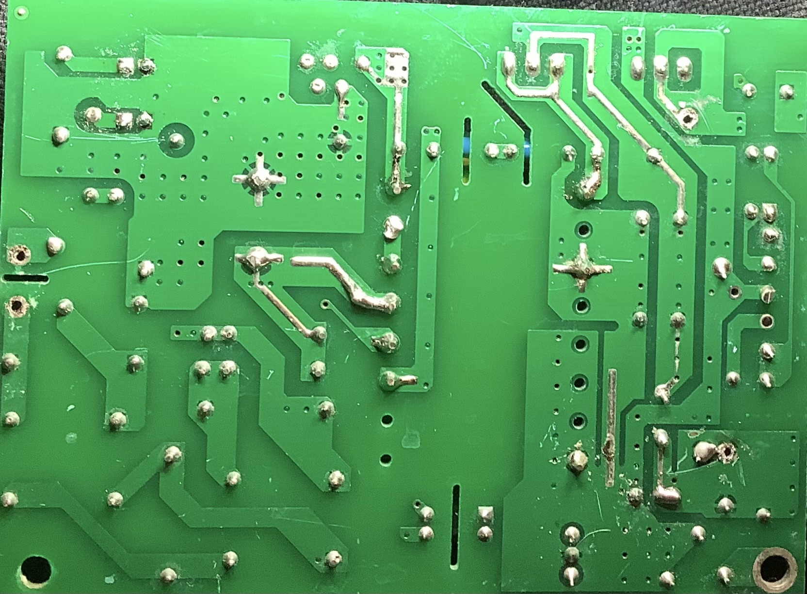

                                One note on this switching power supply board there are no capacitors near the optic sensor so unless something changes value which I can check on the newer board but I have to do this when the switching power supply board is acting up because this is the only way to figure out exactly what going on with it
