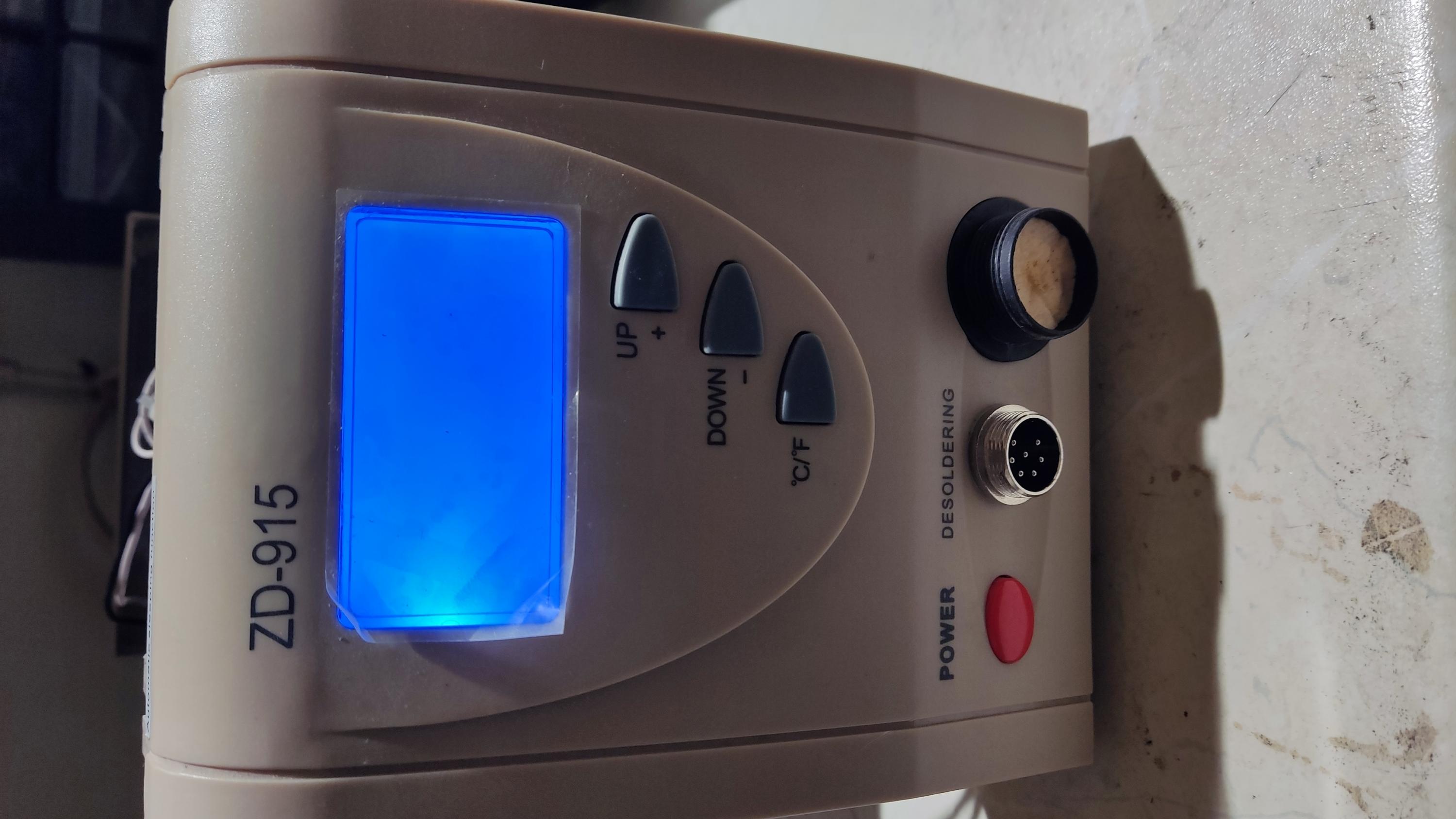

    Hello all,
    I tried to power on my desoldering station ZD915 today and altough the LCD has power and it's on I don't have any indications on the screen and the gun is not heating at all.
    I open it up and I don't see any visual fault anywhere.
    Does anyone has any clue what should I check?

        Are you saying that the back light is on but the screen is blank if this is case I personally have not run into this issue ( however I would check and see if you have 20 volts or so and you should also have a 5 volt rail as well also check that there is nothing on the controller board is that is heating up because I have seen before that the surface mount capacitors have been an issue before I have had this issue before but in my case it was a non stable gun temperature )
        Here is what you need to check
        Do you have a temperature on the screen that is for the gun or is it “———“ if you have this then you have an open temperature sensor wire
        If you have a temperature reading what is the reading and is the “heat” on the screen ( if the “heat” is not on the screen then ) ****if not then you have an issue with the controller board which ****I have not seen this issue before
        Dose your gun get hot even though you have no temperature reading
        When you press the suction button does it start the pump if not then you might have a controller board issue or you have a bad wire cable or a bad switch
        Or the scr or mosfet issue
        You need to post a picture of the screen when powered ON and when you first turn it ON so I can see what version board you have because not all versions behave the same way
        I have about 6 to 8 of these desoldering stations and I have several different versions of this device I have repaired them in the past
        I hope this helps you get started with troubleshooting this issue with your desoldering station

          Exactly like that. The backlight is on and I have no indication. Not even when I turn it on.
          The gun doesn't heat at all and when I press the button the pump is working.
          As you can see in the pictures the desoldering station is as new.
          I have used it about 20-30 times.

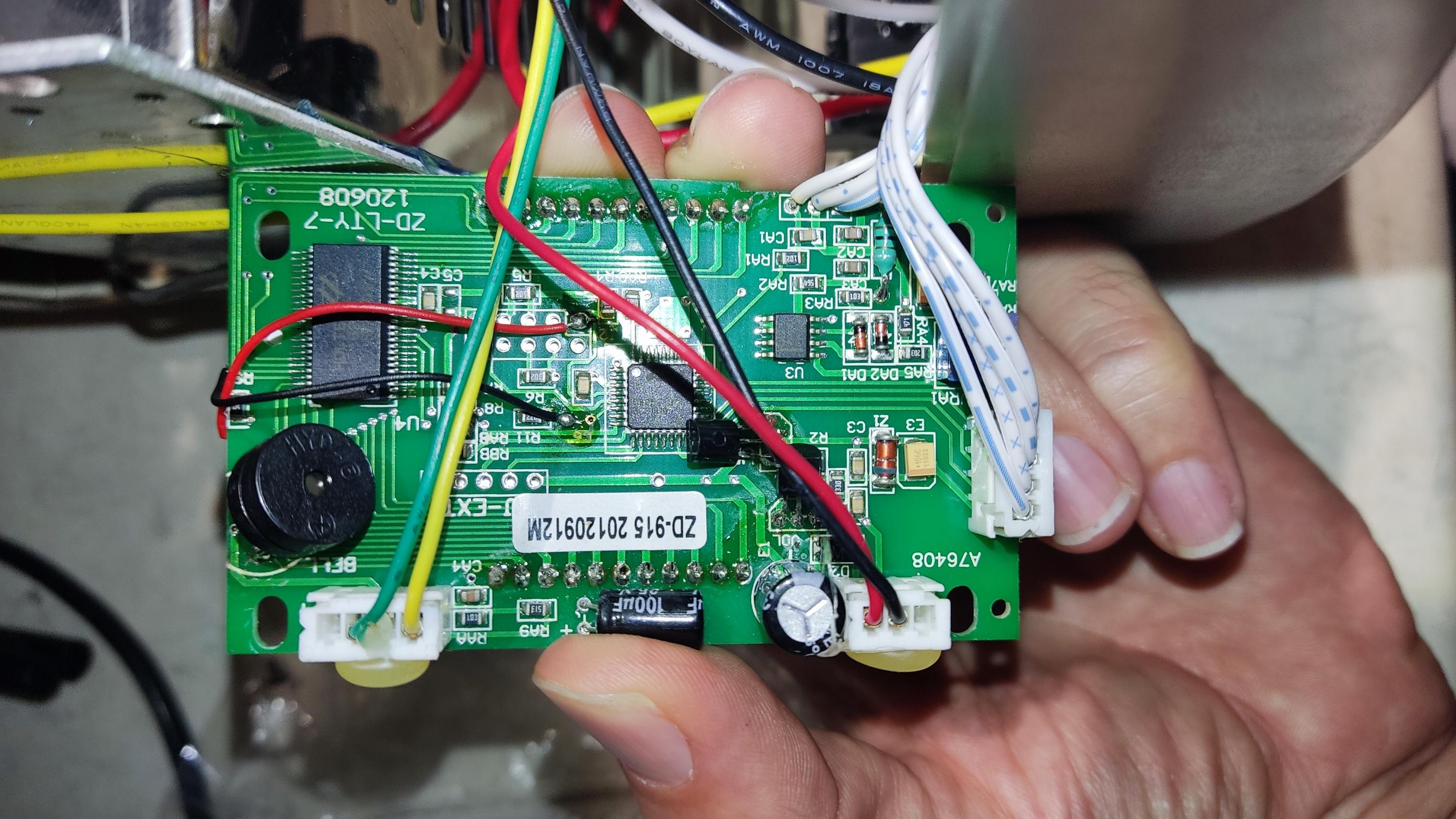

                  I would pull the control board and do a visual inspection.
                  I see rust? or slag on U5 pad. They swapped in mini-melfs for DA1, DA2 but need a huge blob of solder to reach now. It's an ancient chinese trick to use huge PCB footprints and put in way small components, but the solder doesn't always stretch. Like R2, is it soldered on the one end?
                  Some soldering is suspect.
                  Check the PSU voltages supplied to the board like 5V and not sure where the 24V heater switch (mosfet) is located.

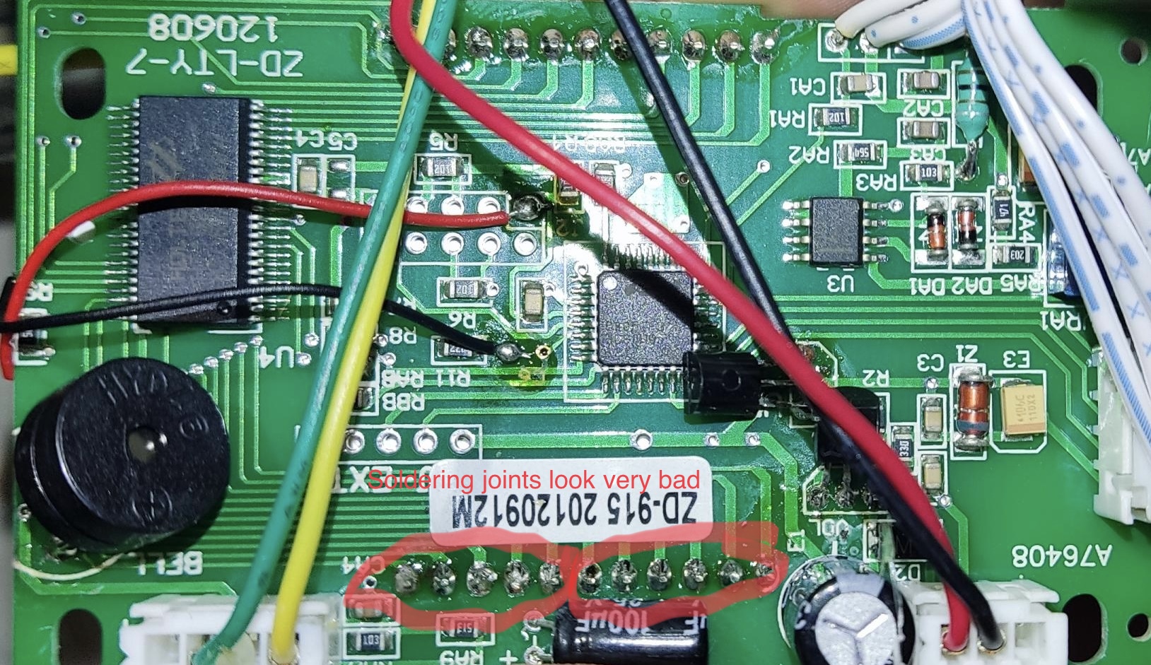

                            The voltage in 78L05 is 5v and 14,5.
                            In Zener Z1 is 3,3v
                            I have attached a more close picture of the board.

                              Look at the soldering joints that are circled in red
                              • rippergr
                                • May 2014
                                • 345
                                • Ελλάδα
                                Re: Desoldering station ZD 915 no indications, no heating
                                I resolder all the joints but nothing changed

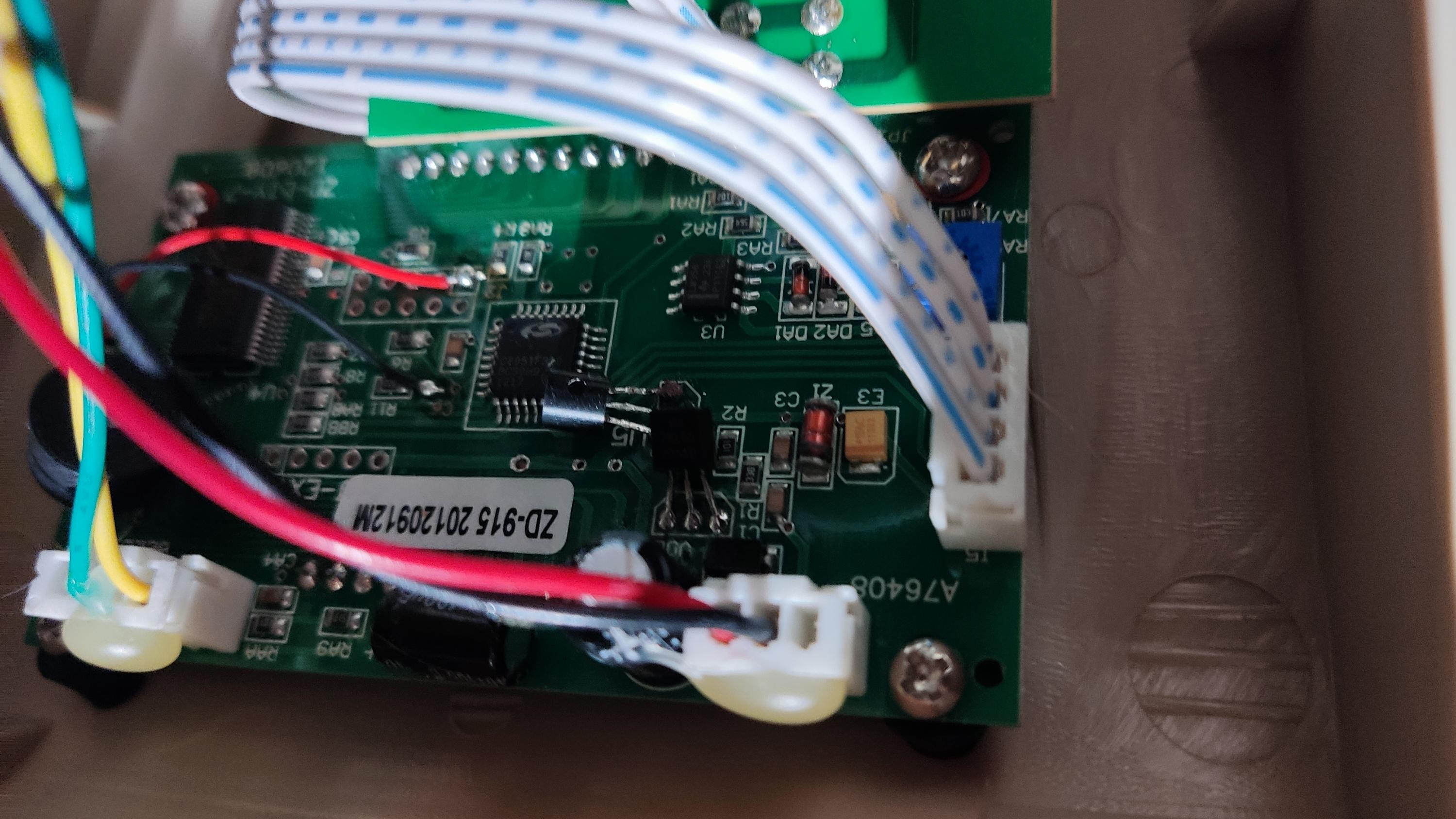

                                • rippergr
                                  • May 2014
                                  • 345
                                  • Ελλάδα
                                  I have changed the Voltage regulator 78L05 and TL431A regulator but I still have the same problem.
