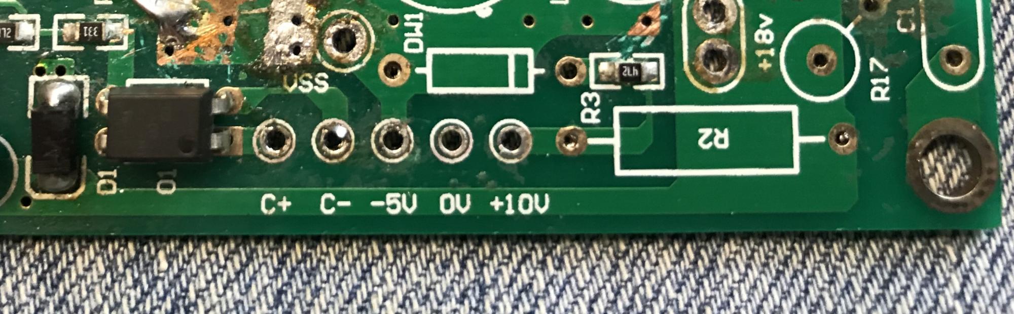

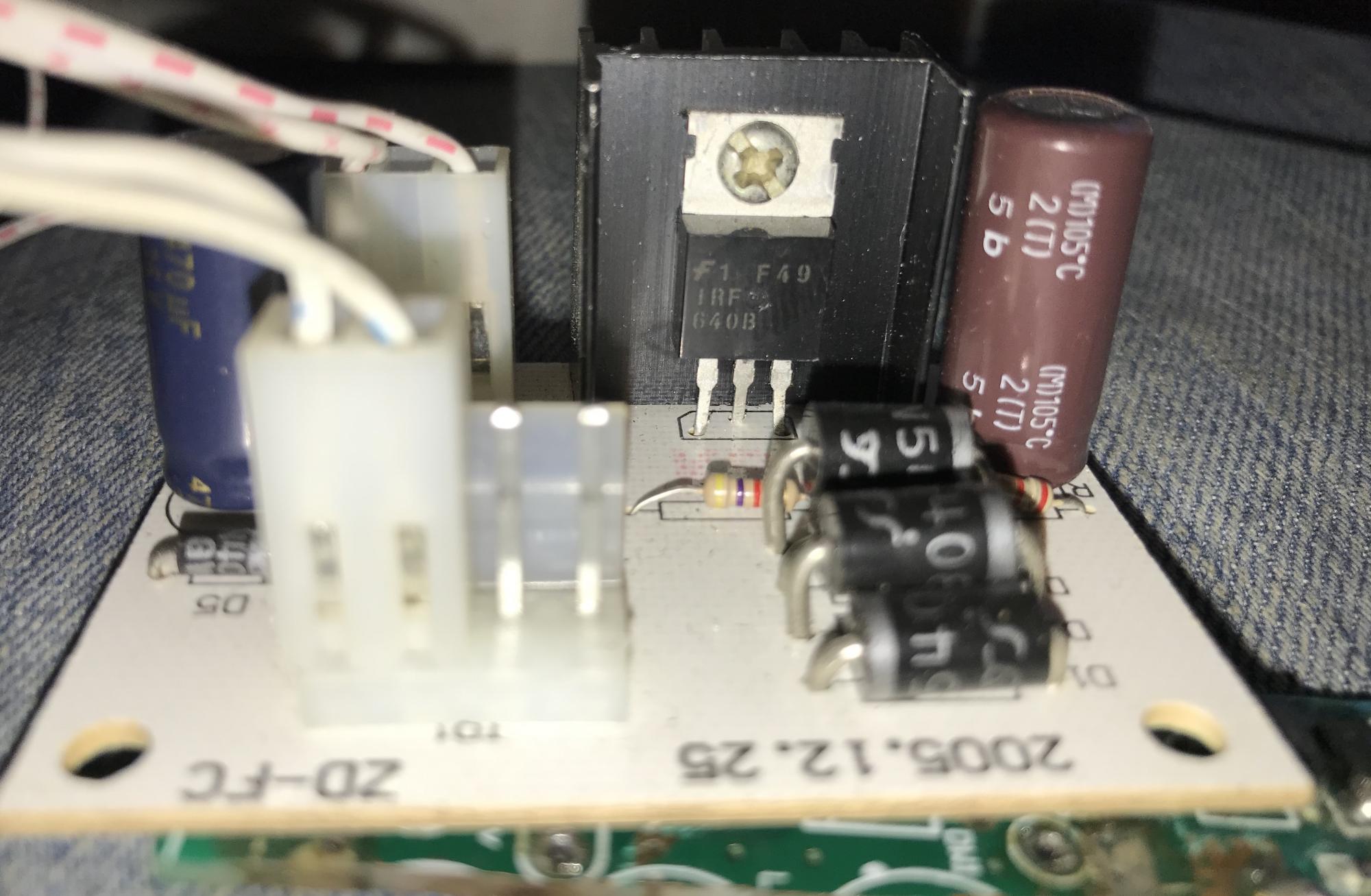

              Do you have a power supply to run the heater unit by it self and set the current to 1.5 amps
              I can probably tell you why the switching power supply has this failure there is a heater mosfet that has shorted in the ON position replace it
              When you put in the next switching power supply regulator unhook the heater pins from the connector and see if you can run it that way if you can then the heater mosfet is bad
              One thing to make sure of is that you have a temperature reading on the display if not you will have the controller at full power output and not controlling the temperature and the heater will self destruct you always need to check that you have a temperature reading when you first power up ( this is a poor design)
              There are two different software versions of this Desoldering Gun station one version powers up the heater when power is applied ( if you see this “——— “ or see this ERR ) at power up then the “ temperature sensor has failed” the other version applies power when the controller has powered up this the better version of the two
              If you have the first version this is part of the problem the switching power regulator has not stabilized and causes the switching power supply regulator to shutdown and restart ( one note is this switching power supply board is not the best design and it some what is under rated for this application
              You could use a different switching power supply design but here is a word of advice you have a couple of problem to work out you have a +10 volt and a -5 volt power rail for the controller now you can take the part of the controller board off of power supply board and use it to power up the controller board BUT you must make sure that you have the +10 volts and the -5 volts that works correctly before you put power to the controller board because if the -5 volts rail is not working correctly then the temperature sensor circuit will not work correctly and you might not notice that the temperature is climbing as it should and destroy the heater
              The part of +10 volts and the -5 volts power rail has the following parts ( + side one of this circuit 1 watt resistor a 5 volt Zener diode and another resistor - side of the power supply ) I post a picture of this circuit because I made one so I could make it run off of battery power ( it does need a PWM controller for it to work correctly for the heater circuit )
              The last picture is the version that uses a transformer
              If you decide to use two transformers for the 10 volts and - 5 volts you could use a 9 volt transformer because the controller board has another 5 volt Zener diode for the +5 volts so be to concert about it being 10 volts but do not be tempted to use a 12 volt transformer for this I have not tried this so I do not know if there would any issues or not
              I have both versions I replaced them with version two which works a lot better

                            The only you need to concern your self about is dose your rectifier is rated for 25 amps or better
                            Now like I said earlier you have a -5 volt and +10 volt power supply rail you have to concern your self with
                            Now you can use the part of this circuit board that has these parts
                            One word of caution when you first hook up power ( but before you hook up the Desoldering Gun set the temperature as low as you can set it make sure that you have control of the temperature to the gun this very important because if you do not have control of it ( it will destroy the gun heater or the mosfet controlling it )
                            Here is where you can find one

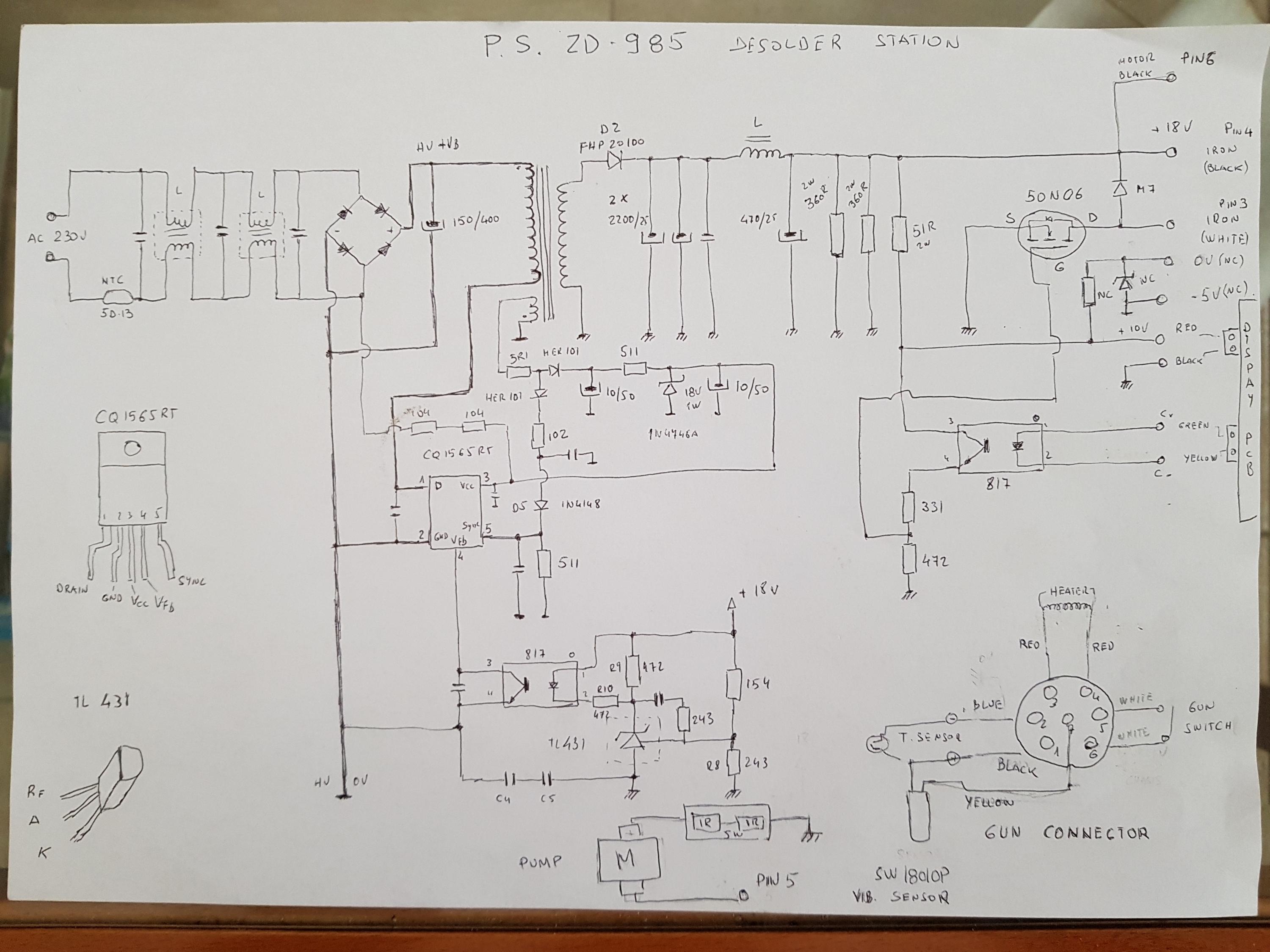

                              Hi, here is a squematic of the P.S. that I draw with patience. That will help to understand an fix the ZD 985.
                              • CabecaBranca
                                • Aug 2021
                                • 3
                                • Brasil
                                Re: ZD-985 desoldering station Power supply failure
                                That's a great help, thanks for all the time and trouble.

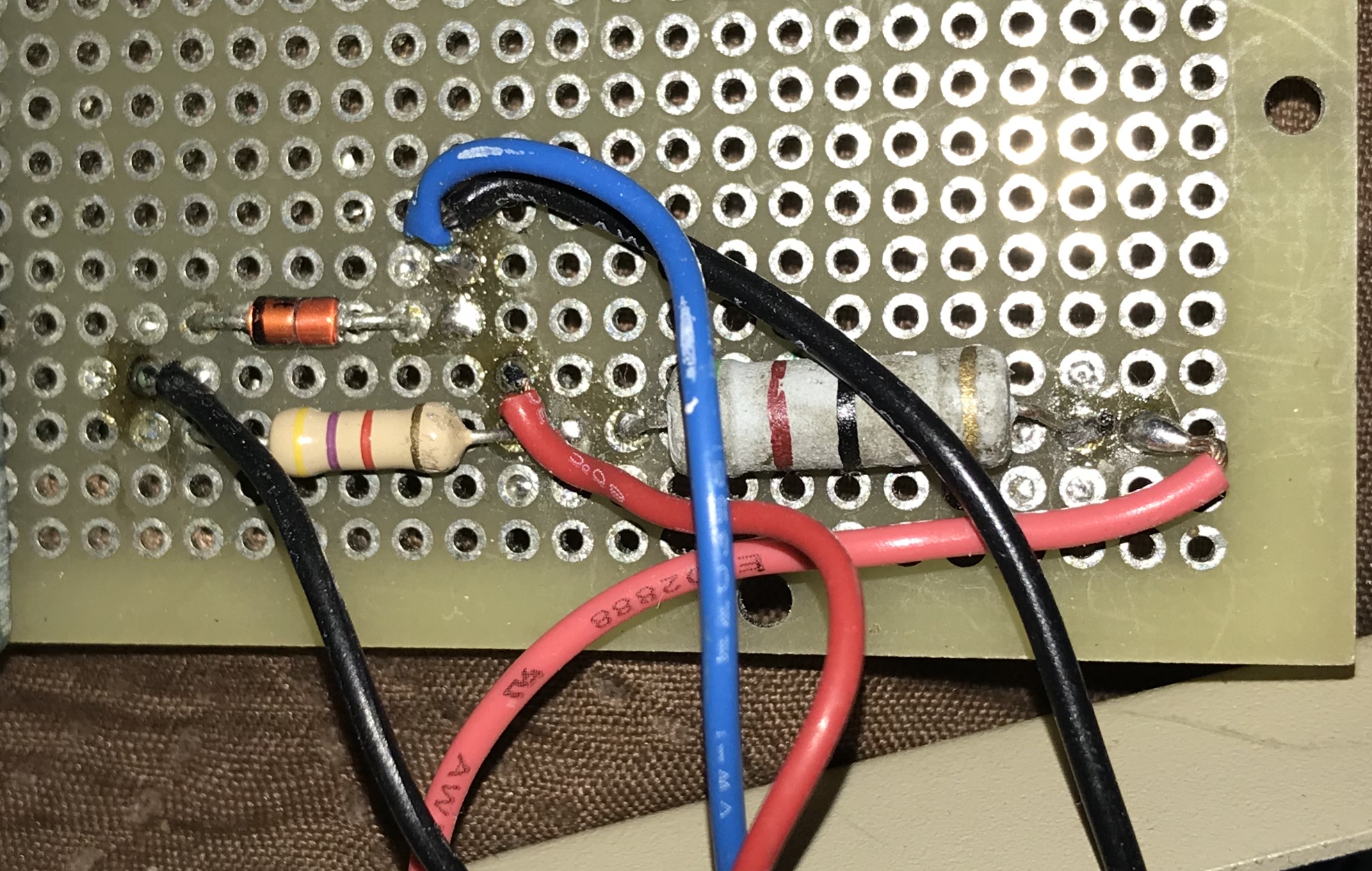

                                • VonsGarage
                                  Vons Garage
                                  • Jan 2024
                                  • 2

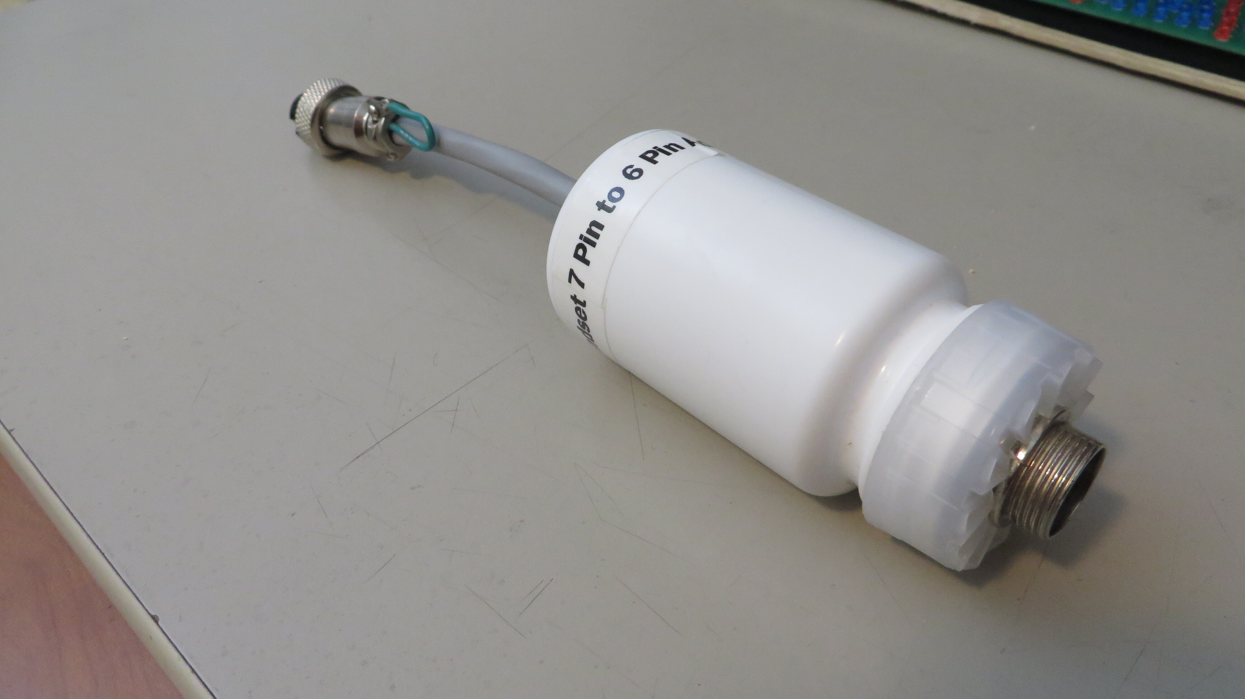

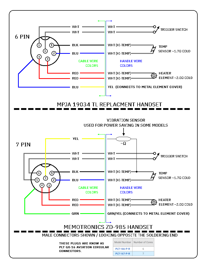

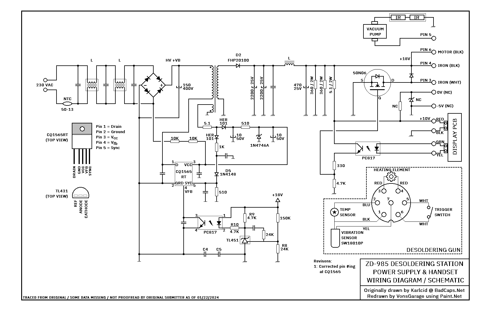

                                  Schematic for ZD-985 Desoldering Station. I transferred the schematic that Karlcid created and so generously shared with us above, and redrew using Paint.Net. It has not been proofread by Karlcid, but I think I did a pretty good job of ensuring accurate copy. Also have added a handset detail that may be helpful. Enjoy.
                                  I found this cool website when working on retrofitting an inexpensive handset available from MPJA ($25- 01/2024 – for their M/N 19034TL) to my older Memotronics station. My station used a 7 pin PLT-GX-16 aviation connector and the new handset from MPJA uses a 6 pin.
                                  Dismantled both handsets and made drawings. I got the aviation (yeah; right!) plugs and jacks and made a little converter so I didn't have to chop up anything. I haven't given it a long test run so I'm not sure if the vibration sensor thing (which is disconnected from the base unit now) will make a difference.
                                  Another person on another website had this to say about defeating the vibration sensor:
                                  I had learnt the Display controller board has a model selector which is a solder-drop switch in the place where the wires from the thermal sensor are connected.
                                  ZD-985 and other 7 pin machines seem to use those connectors unbridged since the gun seems to tell the machine is being used when moved.
                                  6 Pin models like the ZD-915 has 2 connectors linked by a drop of tin solder below the display. Please notice the green ring below. In the 7 pin machines, this drop is absent and 3 wired are sent to the gun connector, therefore, it sets to 200ºC, unlike when they're soldered like the ZD-915 uses to be.
                                  Next time I have the machine up and running I will check if my unit “misses” the sensor. If it drops back into a cooldown setting during use, I'll open-er-up and see if I can find this “solder-drop switch” jumper the above fellow was talking about. I'll update this post if I find anything new.

                                  • CapLeaker
                                    Leaking Member
                                    • Dec 2014
                                    • 8352
                                    Why the CQ1565 fails easily? I don’t really like that package of the switcher at all. It is the worst thing ever a switcher could be in. The HV pin is very close to the other pins, IF you didn’t really clean the living hell out of that spot using 99% IPA or Acetone, leave a little hair, a piece of paper towel etc, it will die sooner rather than later.
                                    If you have any switching IC in that case style to replace, everything gotta be perfect. Other than that it will blow again. Been there and fixed other peoples mistakes quite a few times. That spot has to be squeaky clean hospital grade.
