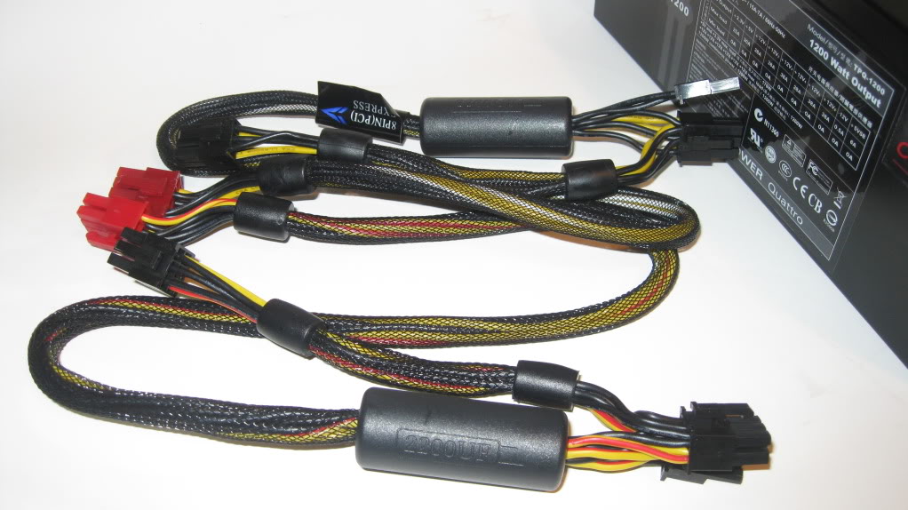

    Does this really do anything?
    http://www.antec.com/Believe_it/product.php?id=MTc1Nw==
    "PowerCache™ is a technology that helps to stabilize the power output to CPU & video card. By adding a 2200µf capacitor at the end of the CPU and graphics cables, power can be delivered instantaneously where and when needed rather than from the power supply itself. For example, a 23A increase of demand from the CPU or GPU could cause a voltage drop of 1V causing a crash or reboot. With PowerCache™, the voltage drop will be just 0.2V, keeping the system running and stable. "
    http://www.antec.com/Believe_it/inde...lossary&lan=us

    Yes, it compensates for not having enough uF in the PSU OP filters in the first place.

      makes up for too much drop in the leads.like a cap at a boom boom amplifier.

          Don't see how that would work.
          If the wires are dropping voltage that cap is never going to see full voltage anyway and so couldn't charge up to it.
          Unless you mean something else by 'drop'.

            E= (1/2)CV^2
            Where E is energy in Joules, C is capacitance in Farads and V is volts.
            One Joule is one watt for one second...so lets calculate: [(1/2) * (0.0022F) * (12^2)]
            The cap may be a 16 V cap, but since it will only be charged to a maximum of 12V, 12V is what you use for the calculaton.
            That works out to be a little under 0.16 Joules...... which is JACK compared to the demands of the GPU. For a big GPU, it would have to be a drop of less than 1ms in duration.
            Oh but it gets worse....because that assumes the cap will discharge completely! IT WONT! It will only discharge until the cap voltage is equal to the line voltage..... since its a fairly realistic assumption that the system will fail if the 12V rail falls to 11.0V, that gives your cap just ONE volt to give..... now how many Joules is available to the system?
            Well since 1 squared is 1.... not much at all as you can see here [(1/2) (0.0022F) * 1V] That gives you a tiny amount of energy to work with, 0.0011J
            Its worthless for dropouts. If voltage sags out of spec with the given load, the supply is faulty...plain and simple. Now what is Antec trying to say here?

              So what you are saying is the typical 3x470uF [=1410uF] 16v poly used in +12v VRM-in are useless.
              Ummmm,,,,, dunna tink so.
              The uF isn't for dropout, their uF matters for smoothing normal transients like CPU [or GPU] from idle to 100% or back, but they are just there to give the regulator time to respond. They aren't expected to carry the whole transient and recover the voltage themselves.

                  Back to Antec's ad.....
                  If the voltage drop from a load change can cause a crash then the PSU is not compliant with the ATX Spec in the first place.
                  So a translation of the ad would be:
                  Our PSU is crap. We added this cap to help it out.
                  More bogus watch analysis:
                  A 23 amp change at 12v would be a load transient of 276 watts.
                  - Know any 276 watt PSU's or GPU's ??
                  The 23 amps is on the CPU or GPU voltage, not +12v as they imply.
                  The CPU/GPU voltage -> ALREADY HAS CAPS.
                  On a CPU it would be the Vcore caps.
                  On a GPU it would be in the OP of the on-board Vcc regualtor.
                  That cap could help by lowering ESR [which suggests inadequate filtering in the PSU.]
                  But their claim is it helps load transients.
                  For that purpose that cap is useless unless either the PSU or the load are not built to specifications.
                  Anyone looking for Swamp Land in Florida?

                    I think antec is riding on the belief that capacitors just build up a charge, hold it, and can somehow release it whenever they want. Like the flash capacitor in a camera.

                          i bet that thing is not a cap at all. ferrite ring.
