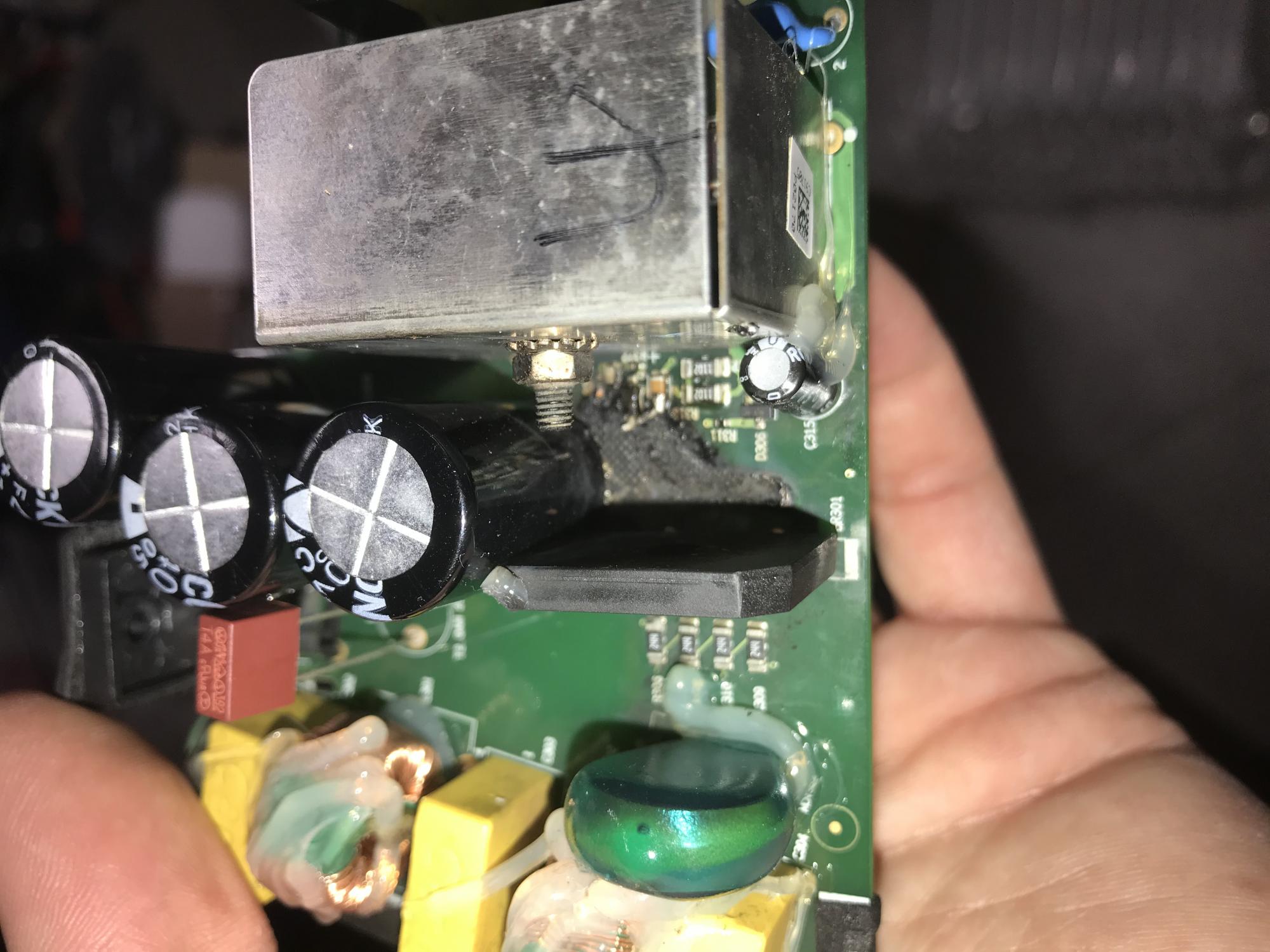

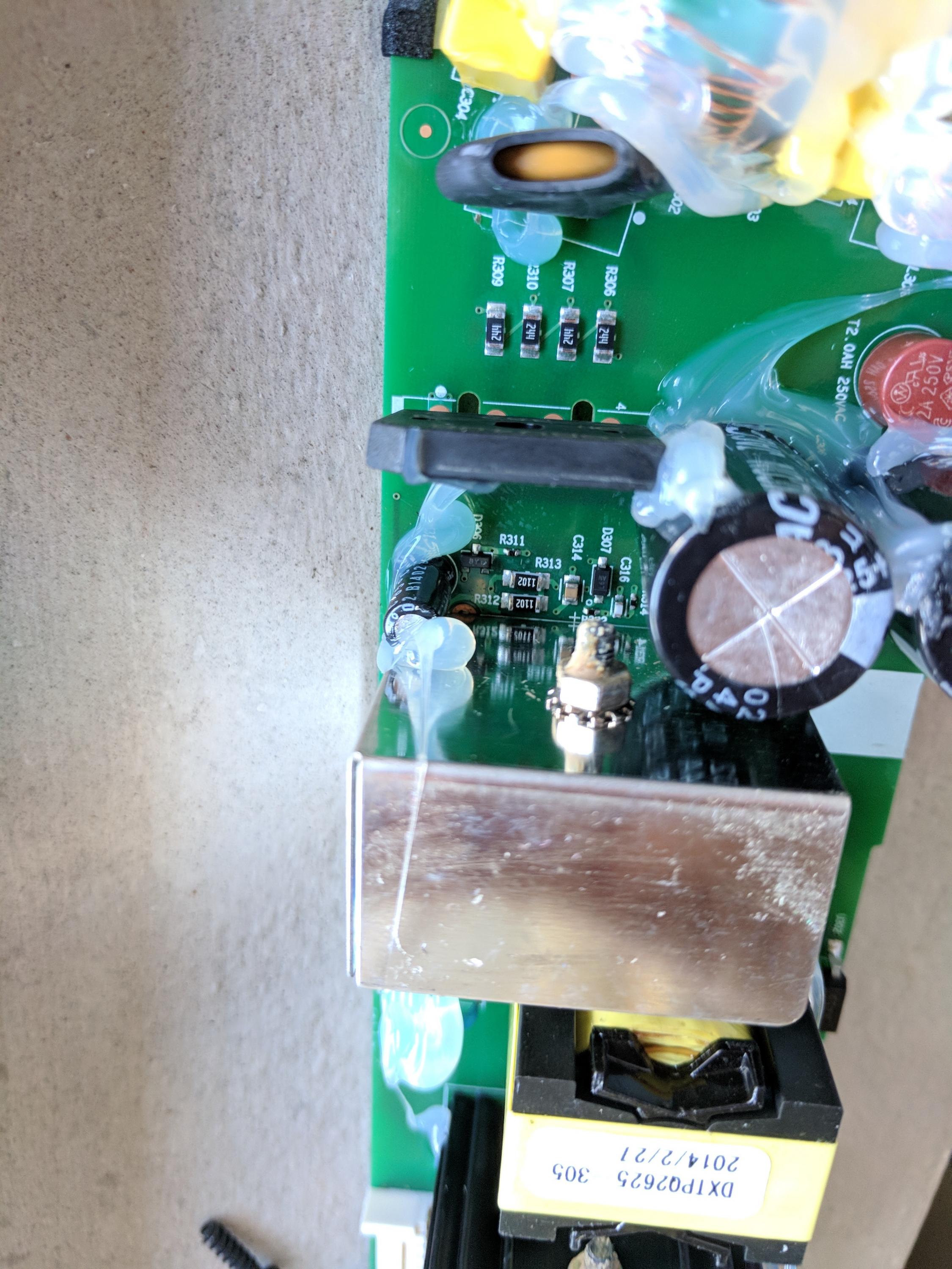

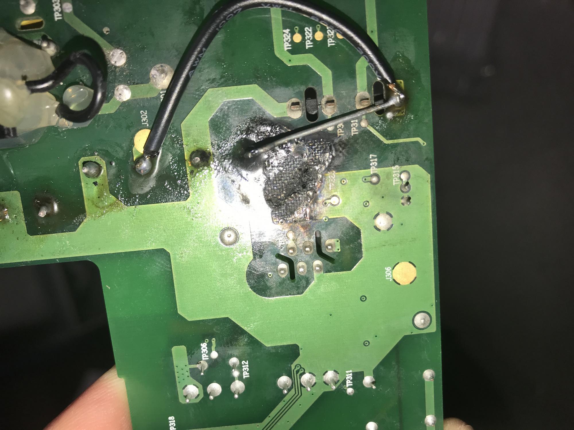

So I picked up a faulty Sonos Play 3 with a messed up power supply. Capacitor blew up took out traces.... fairly common occurrence. I recapped it and ran a cable connecting to the bridge rectifier. Upon trying it out, it always blows the fuse and gives a large bang... so shorting somewhere. Can anyone provide some guidance on how I could fix? It keeps blowing on the back of the board.. See Pics attached.
Sonos Play 3 Power Supply

You should also remove the carbonized section of the PCB, it is conductive once it is carbonized like that.

Thank you very much for the response, so I'll cut away the charred bit of the trace/board. The jumper and the insulated wire are going to the + on the rectifier. I connected both directly as I'm not sure how bad the trace is. I know the one for cap 3 is completely busted but unsure for cap 2. Cap 1's trace seems fine hence I didn't jumper it. Could the carbon be causing it to blow the fuse and pop when I apply power? Thanks.Comment

Thank you very much for the response. I have a feeling the issue is with the charred remnants of the traces so I'll cut those out with an xacto. One question though, what if there is an SMD sitting above the charred area? There is an area with 2-3 small smd components on the upper side but below it, the copper film has blown off...... I don't have the schematics so tricky to figure out how to jumper everything.You should also remove the carbonized section of the PCB, it is conductive once it is carbonized like that.

Without good board or the schematic to compare to what the burnt board is supposed to have is difficult to trace out the board.Never stop learning
