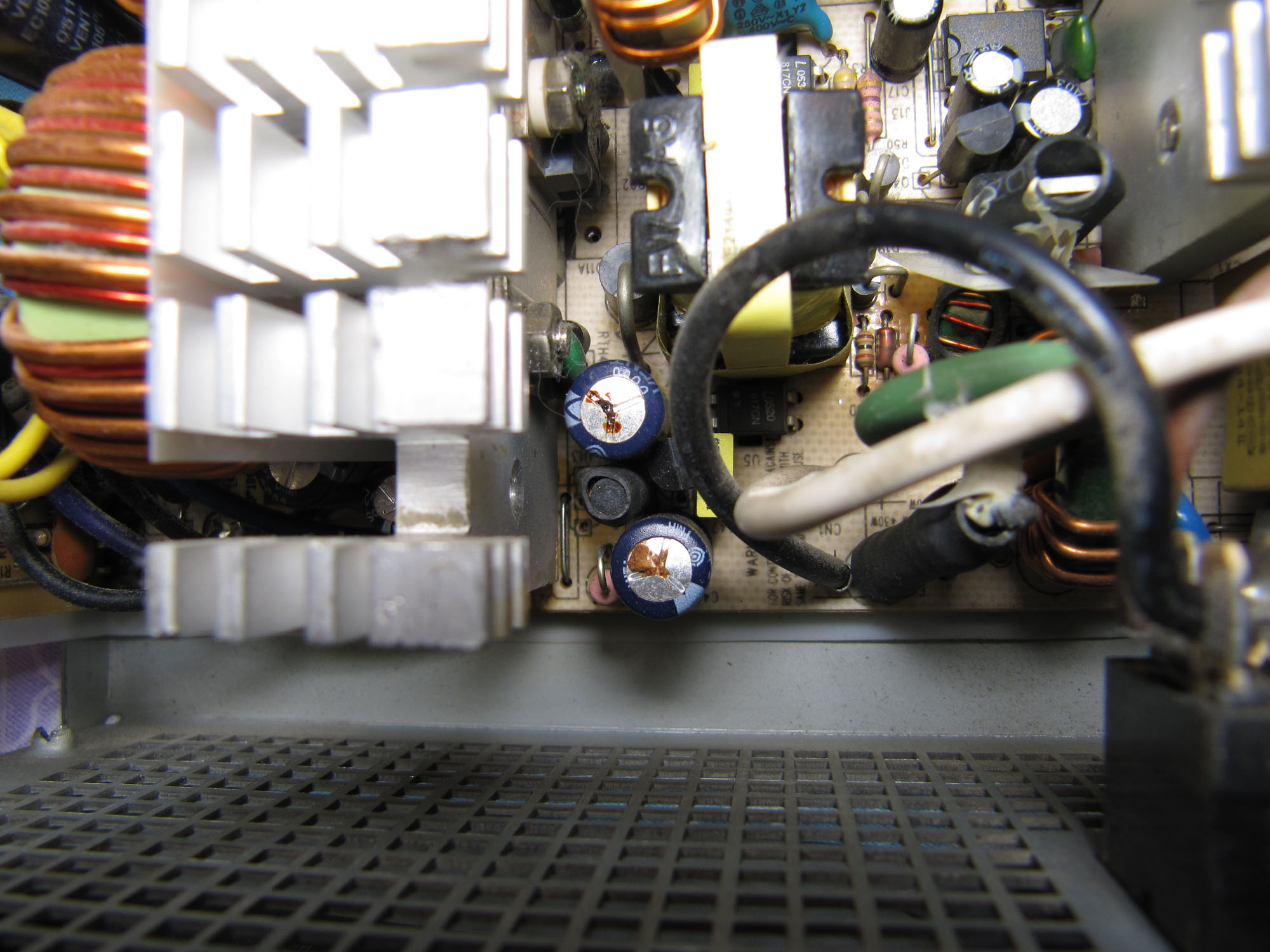

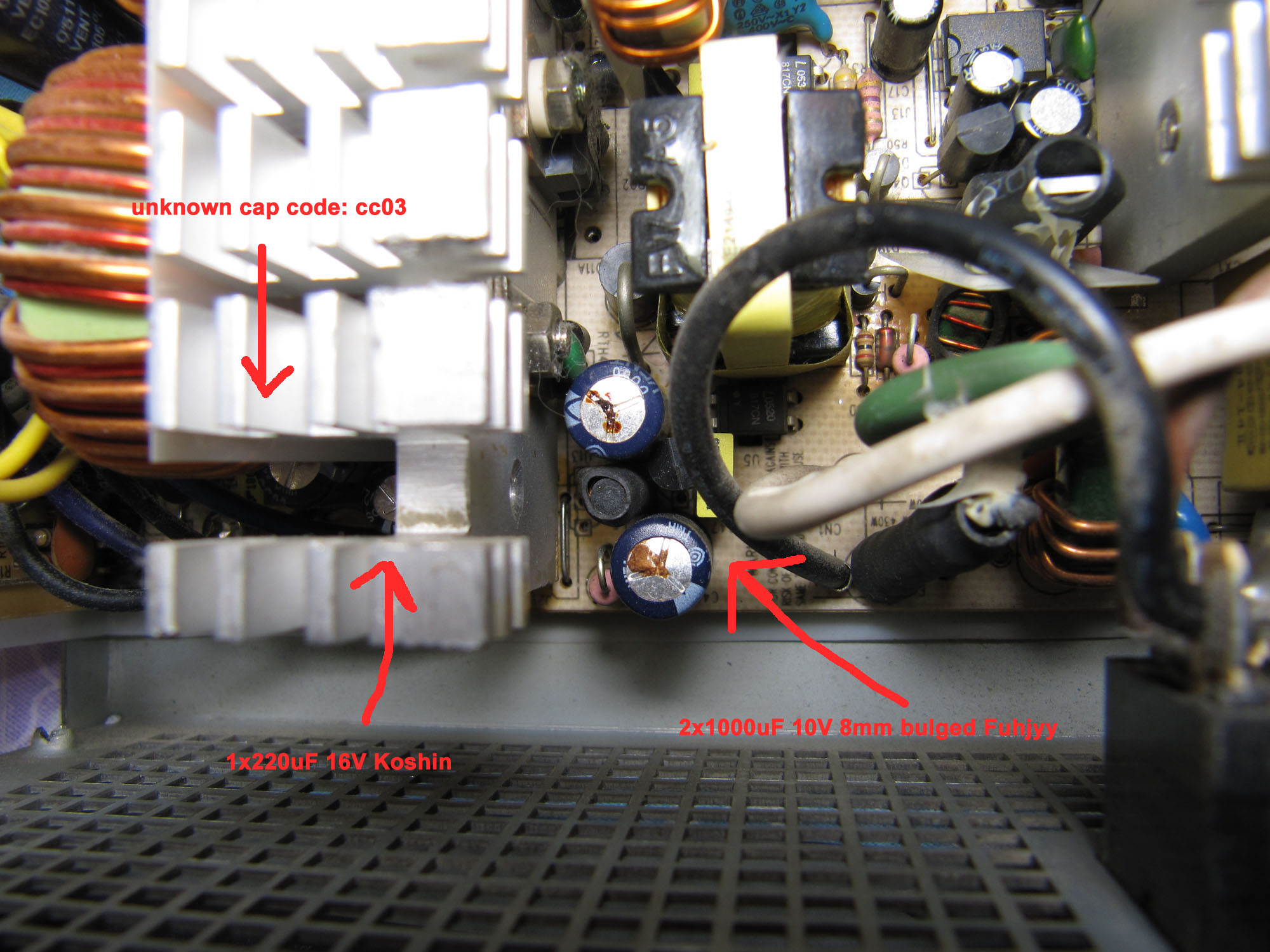

    2x1000uF 10V 8mm 105C bulged Fuhjyyu (photo soon)

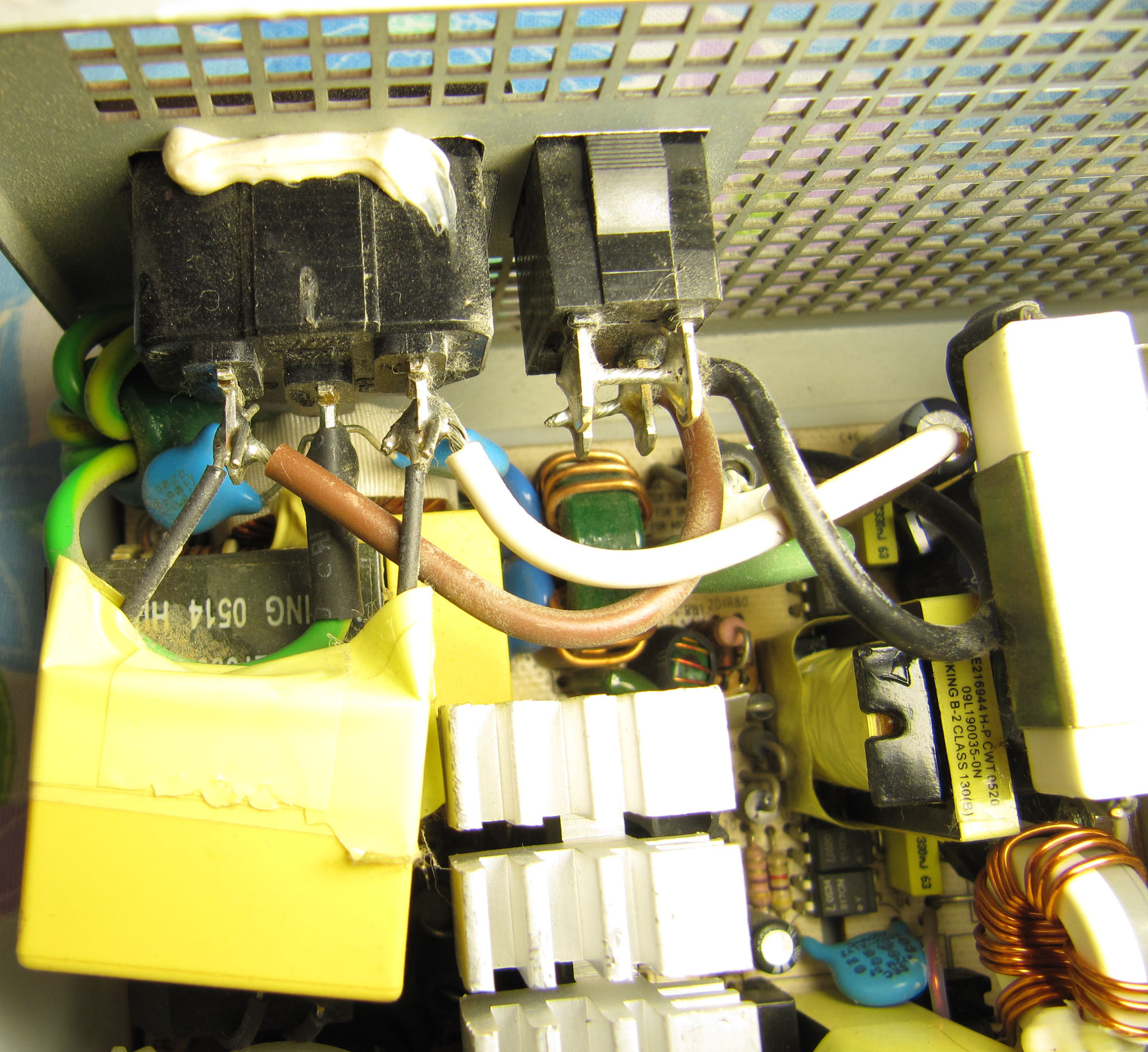

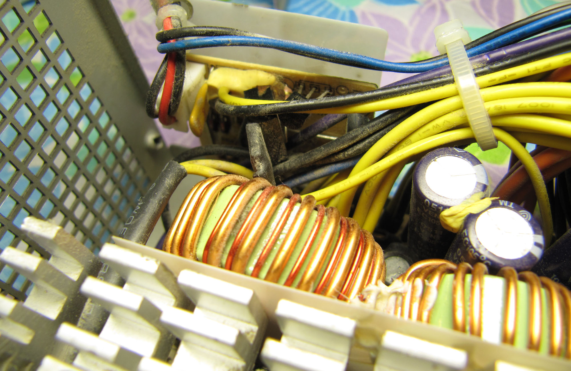

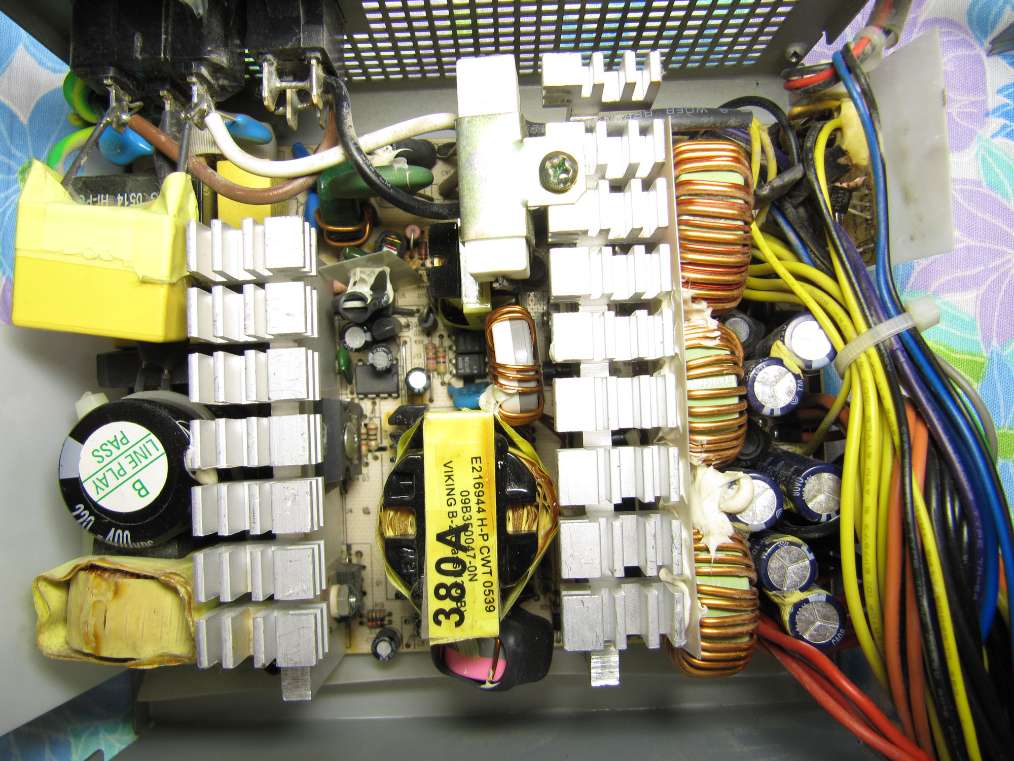

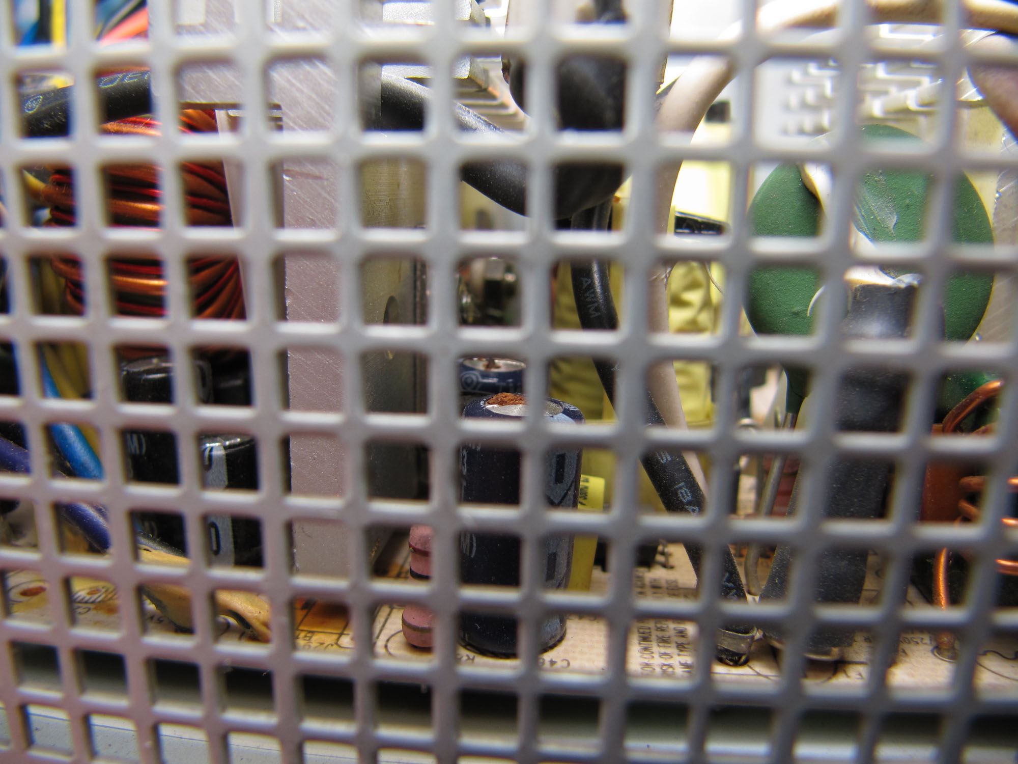

    Photos of psu and bad caps:

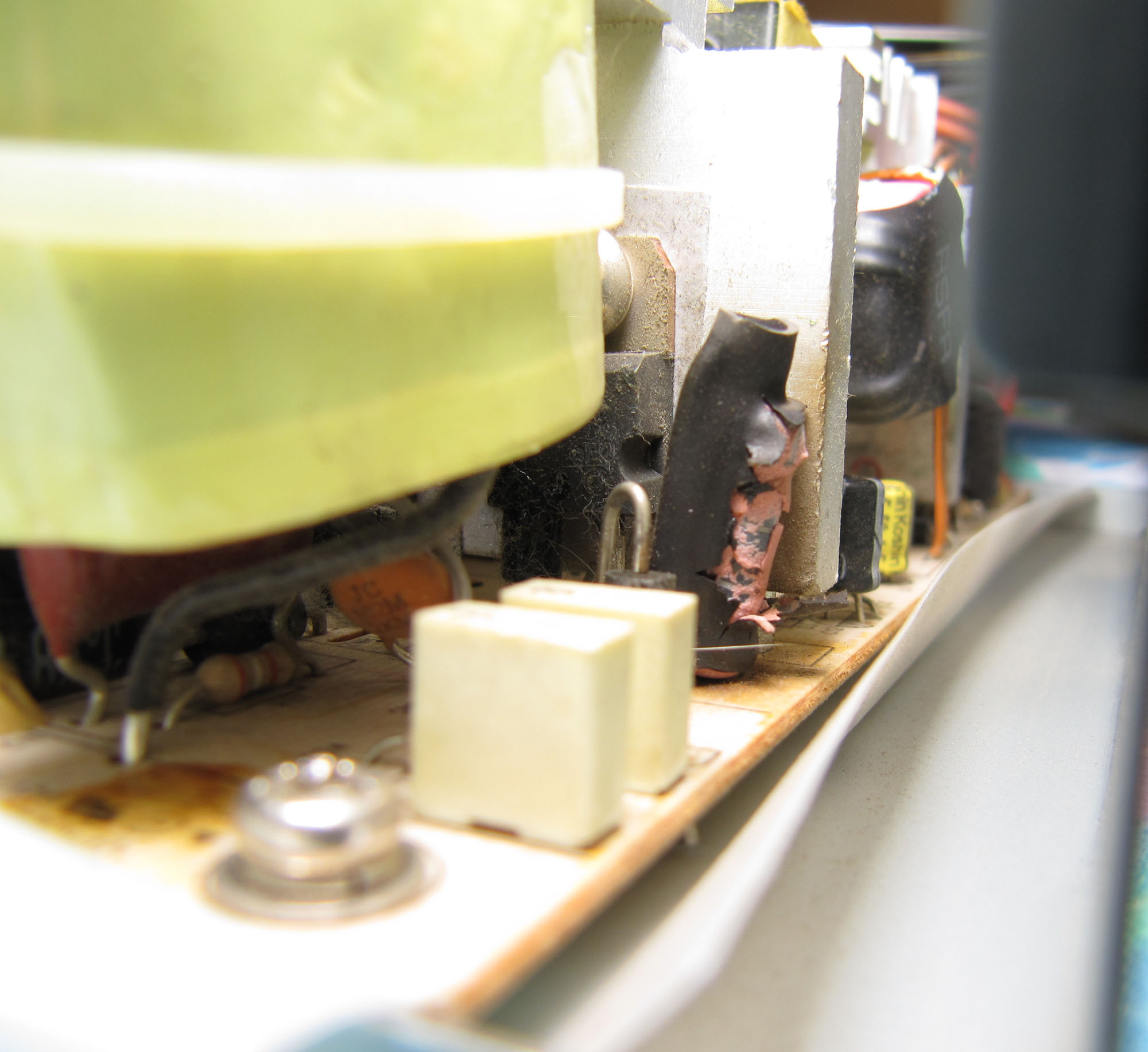

      ...and what is this? Seems it has exploded...

        Re: Need help with Antec TruePower2.0 380W
        you blew a resistor. see if you can find the band pattern so it van be replaced
        its still unsafe. the ripple must be ungodly, the average voltage is in spec but the peaks are probably not. an oscilloscope or analog multimeter (with a needle-gauge) can be used... the analog will tell you based on the steadiness of the needle, the scope you would know about if you had one.
        ripple kills components. DON'T USE IT UNTIL YOU RECAP IT!!! thats half the reason why a bad capped psu will kill a mobo. out of spec voltages are second.

              The leaking caps appear to be on the +5vsb PI filter. Definitely BAD for anything attached. Definitely replace them before you plug it into anything, along with any others with the name fuhjyyu. While you're at it you might as well replace all the caps except the hitachi. Hitachi's are good, and the huge 400v caps rarely go bad anyway.
              The part that looks like it's exploded is a power resistor wrapped in heat shrink tubing. It didn't actually explode, but got so hot that it burst through the heat shrink. It's probably fine, it takes a lot to kill a resistor, but if you're ordering caps and repairing it you might as well replace this too. If you take it out and peel the heat shrink off, you might be able to read the color bands. Otherwise use an ohmmeter/multimeter to find it's resistance and get an appropriate replacement. From the picture, it looks like that was a 2W resistor, so for a replacement you might want to up to a 3W or 5W resistor so it doesn't fry again.

                Yes those are +5vsb caps.
                There should be another associated with +5vsb on the other side of the heat-sink from those. It's smaller uF.
                Minimize turning the machine on-off but use hard-off [the back switch] instead of standby or soft-off.

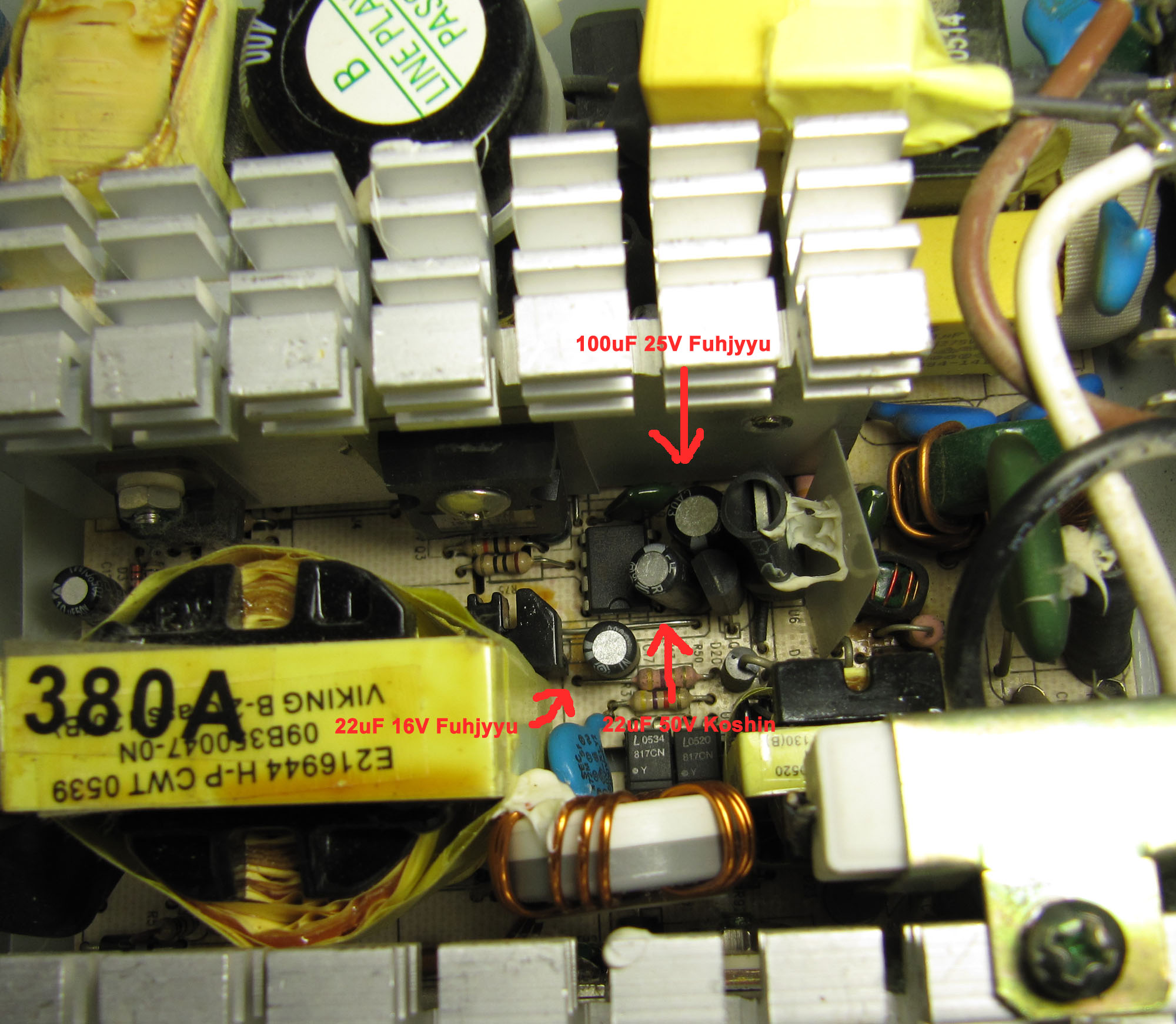

                  1x220uF 400VDC Hitachi HP2
                  - Leave this alone. It's fine.
                  extra green board:1x16V CB06 Fuhjyyu
                  - 1x16v - uF what?

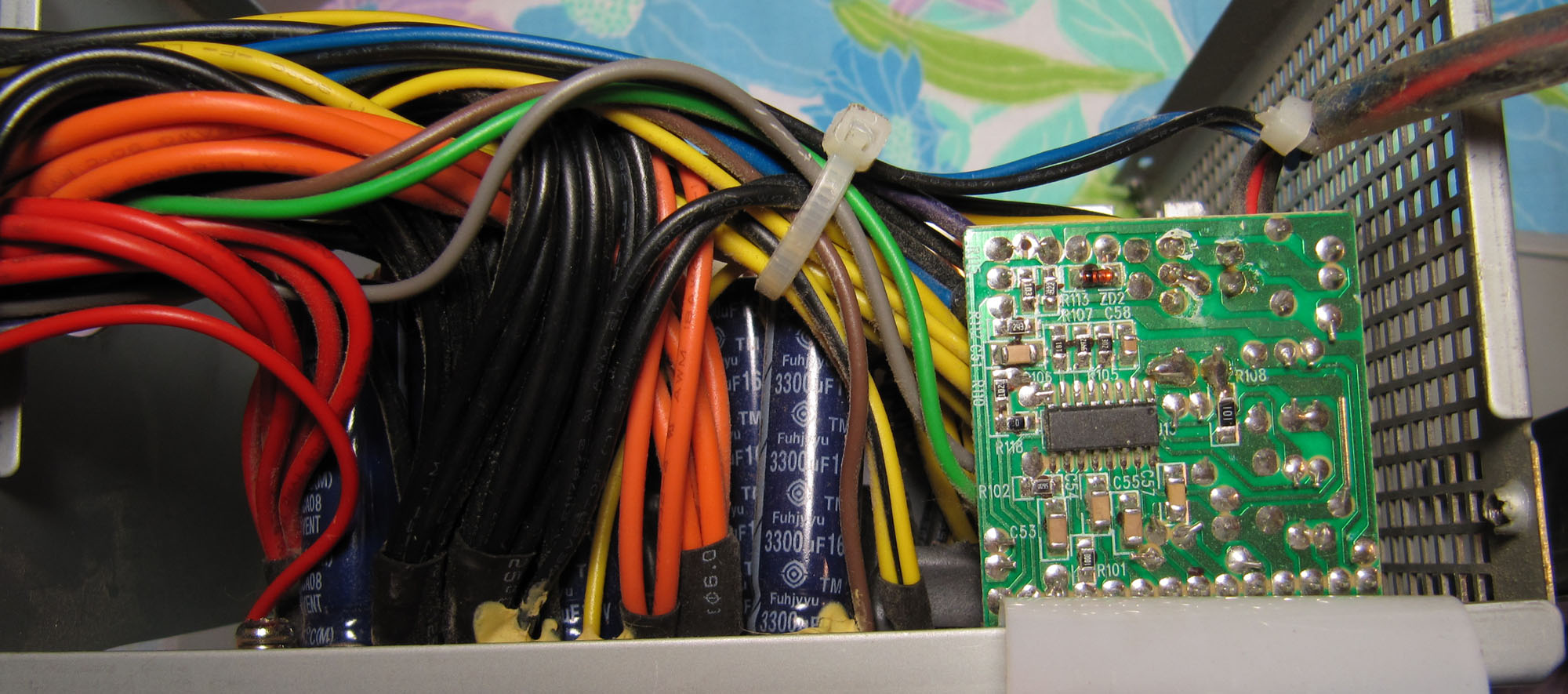

                  The side board is just the fan controller.
                  The caps aren't stressed [worked] that much.
                  Sometimes it even has ceramic disc caps instead of lytics.

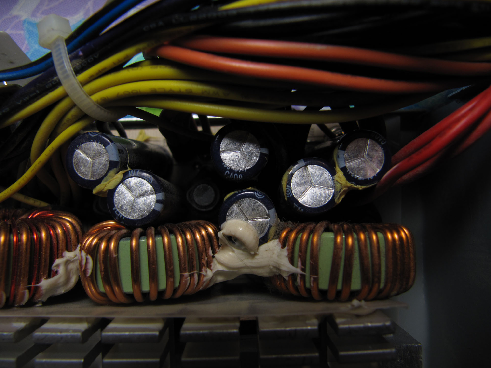

                  4x4700uF 10V 10mm
                  - Ripple/ESR = 1580 / .038
                  - Samxon RS 3300uF 10v-or-16v
                  - MBZ, FK, FL, FJ, or WG at 3300uF 6.3v
                  2x3300uF 16V 10mm
                  - Ripple/ESR = 1580 / .024
                  - Samxon RS 3300uF 16v
                  - Or squeeze in two comparable spec 12.5mm [which ain't easy]
                    that one I couldn't read its uF but I don't care if it's only for the fan controller, I will leave it there.
                    1xunknown capacitor CC03
                    This is placed behind the bulged caps, as shown in photo. The only readable was a code CC03 that makes me think it's an Fuhjyyu. But can't find its volt/uF rating.
                    Hope I didn't miss any caps, looked as good as I could...

                              No, that's not where the 47uF I'm used to seeing is.
                              That would be the largest one in upper right of same photo.
                              Might be different uF on yours but as I recall all the SmartPower, True, and TP2 I've done had a 47uF there.
                              My closest to that model I have handy is a TP2-550.
                              In that one those 4 caps you marked are laid out differently but they are:
                              2x 1000uF-10v-8mm
                              1x 220uF-16v-6.3mm
                              1x 470uF-25v-8mm
                              - Probably the same but no guarantees.

                                  I'll order that one for the unknown cap and hope it matches.
                                  http://gr.rsdelivers.com/product/pan...f/5261553.aspx

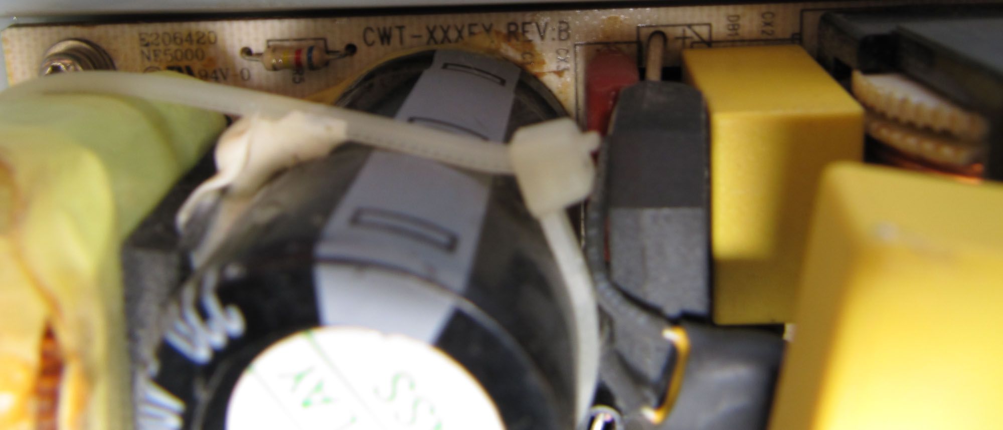

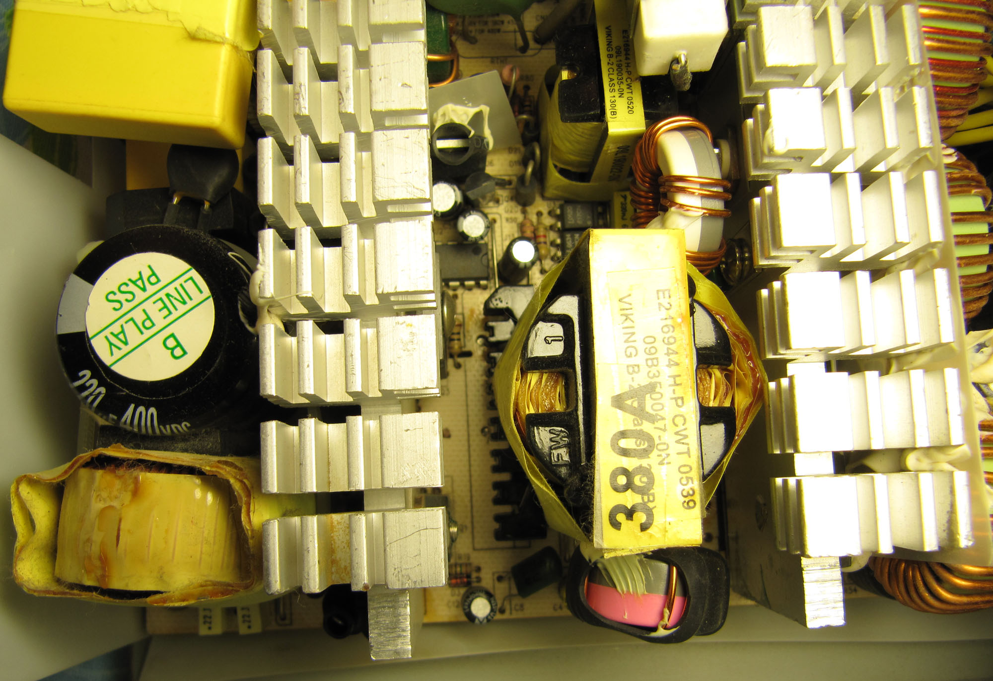

                                      In the last 2 pictures of the first post, notice the PCB discoloration near the 5vsb circuit (particularly the resistor and diode next to 5vsb transformer). This mean you definitely need to change the critical 5vsb cap (which is usually either 10, 22, or 47uF). Seems to be the one right next to U6 (5vsb transistor).

                                        Which of the 3 caps is the 5vsb cap you are referring to? I've added capacities and volts of each one in the photo to help you.
