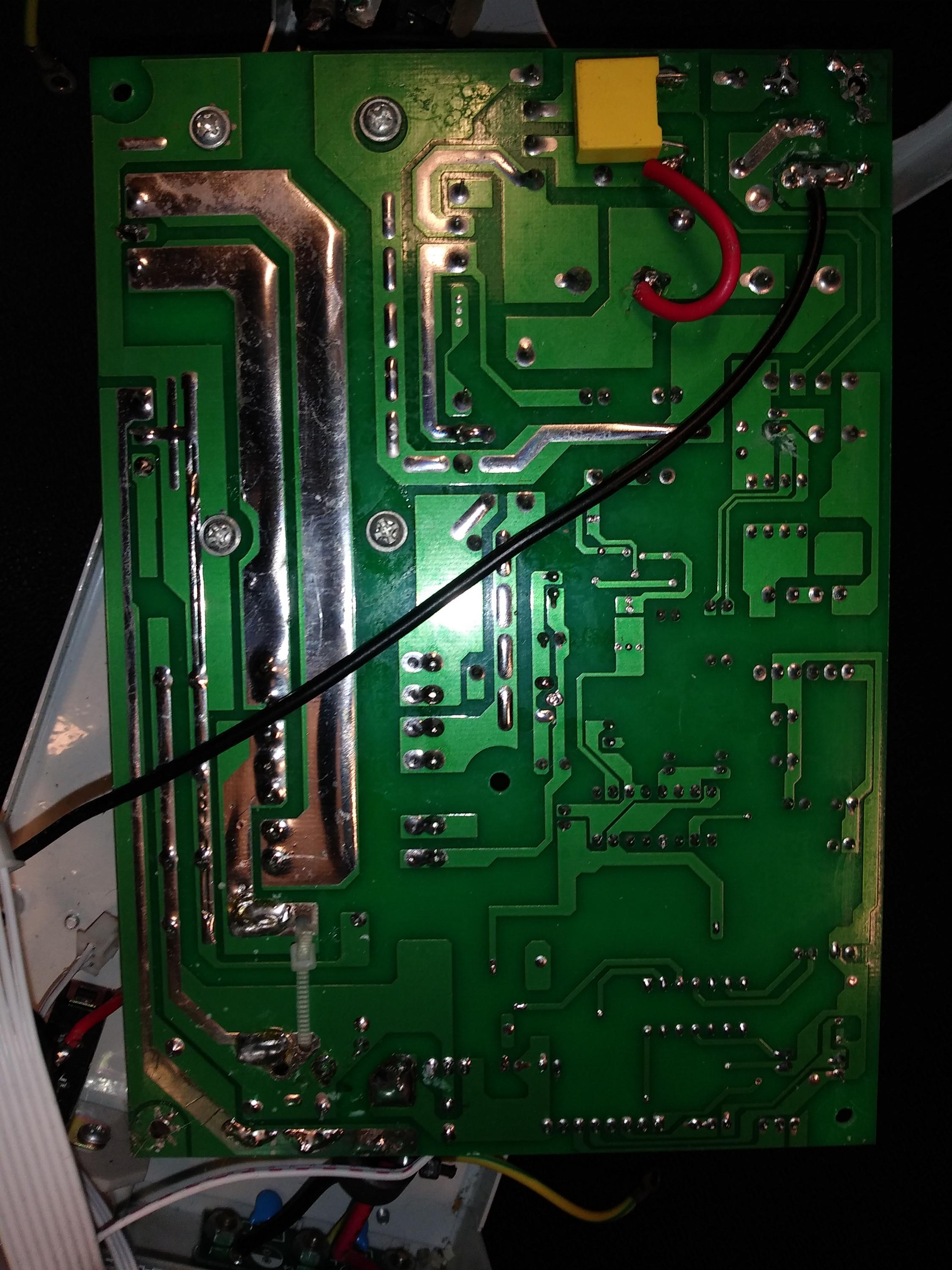

    Hello again, I have this cheap 30v 10A variable power supply that died about a year ago, the issue with it is that one of the MOSFETs (IRF840) Blew its guts. Now despite this thing being cheap, the design may have saved the control electronics from being blown up, as they appear to be in good shape.
    I may also replace some other components while at it and fix some of the bodge jobs so this thing looks nicer.
    Being that this is my first time replacing a blown MOSFET, I may need a bit of help, so any help will be appreciated.
    And hopefully, i don't make a dumbass out of myself again.

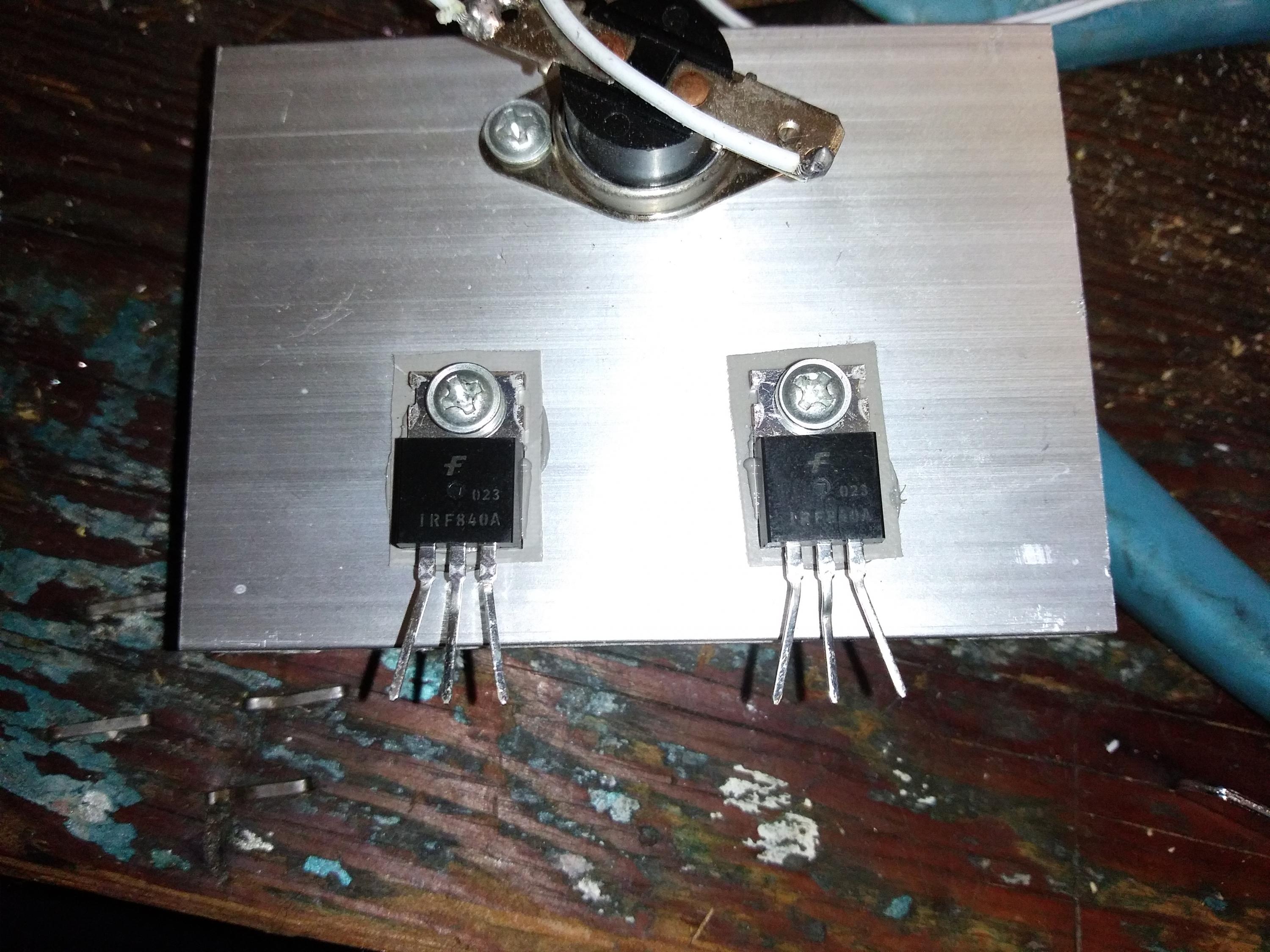

                                    So i went and found some 51Ω resistors and some IRF840A's from the surplus store, threw them into the power supply, tested it, and it appears to be fully working as now when its set to full power it outputs 31V instead of 500mV. I also found some 470uf 50v KZEs that i plan to put on the output, but i think they're NOS so i may have to reform them first (they still test within spec).
                                    Once i'm done with testing, i'll post photos of the repair

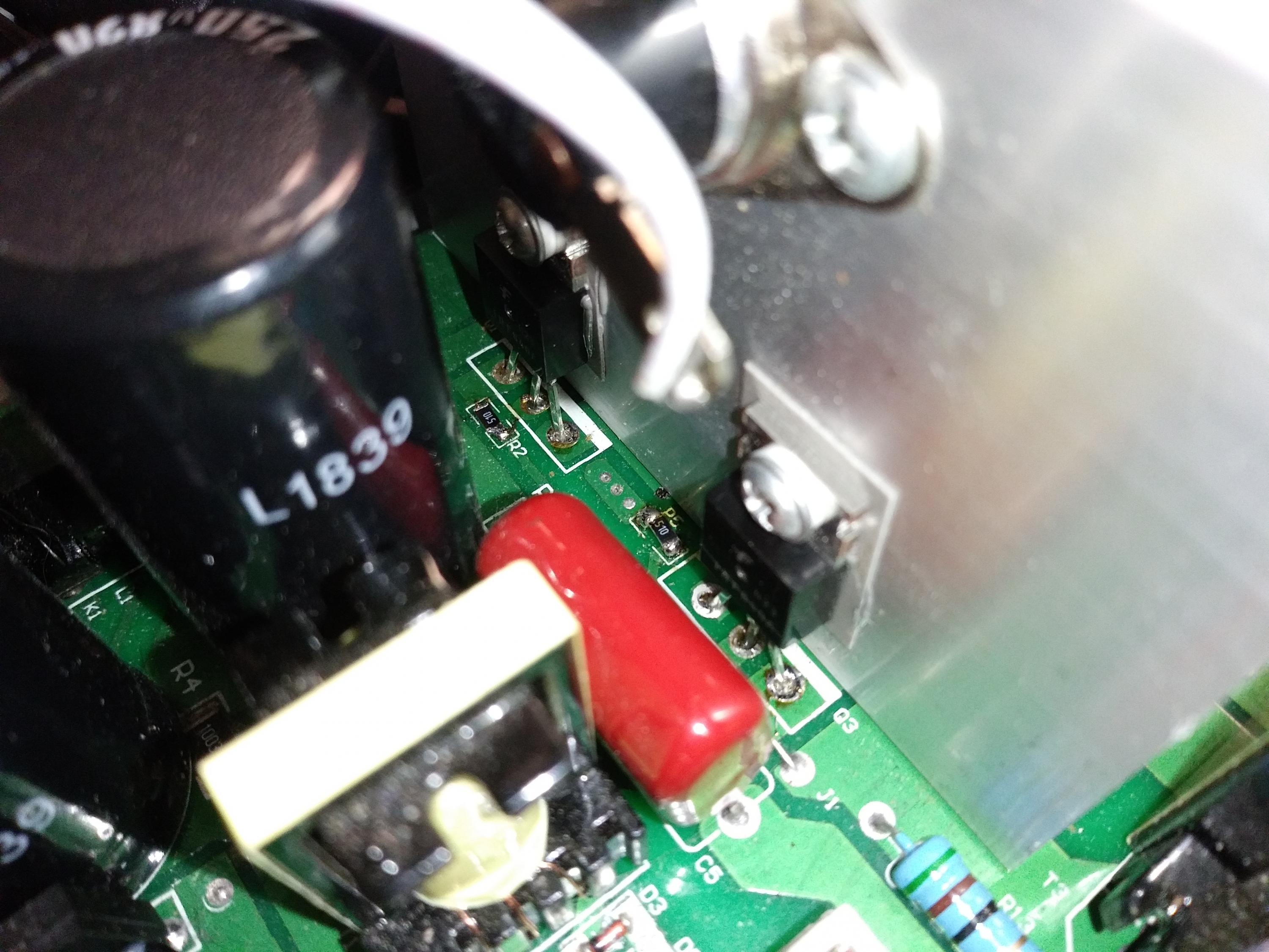

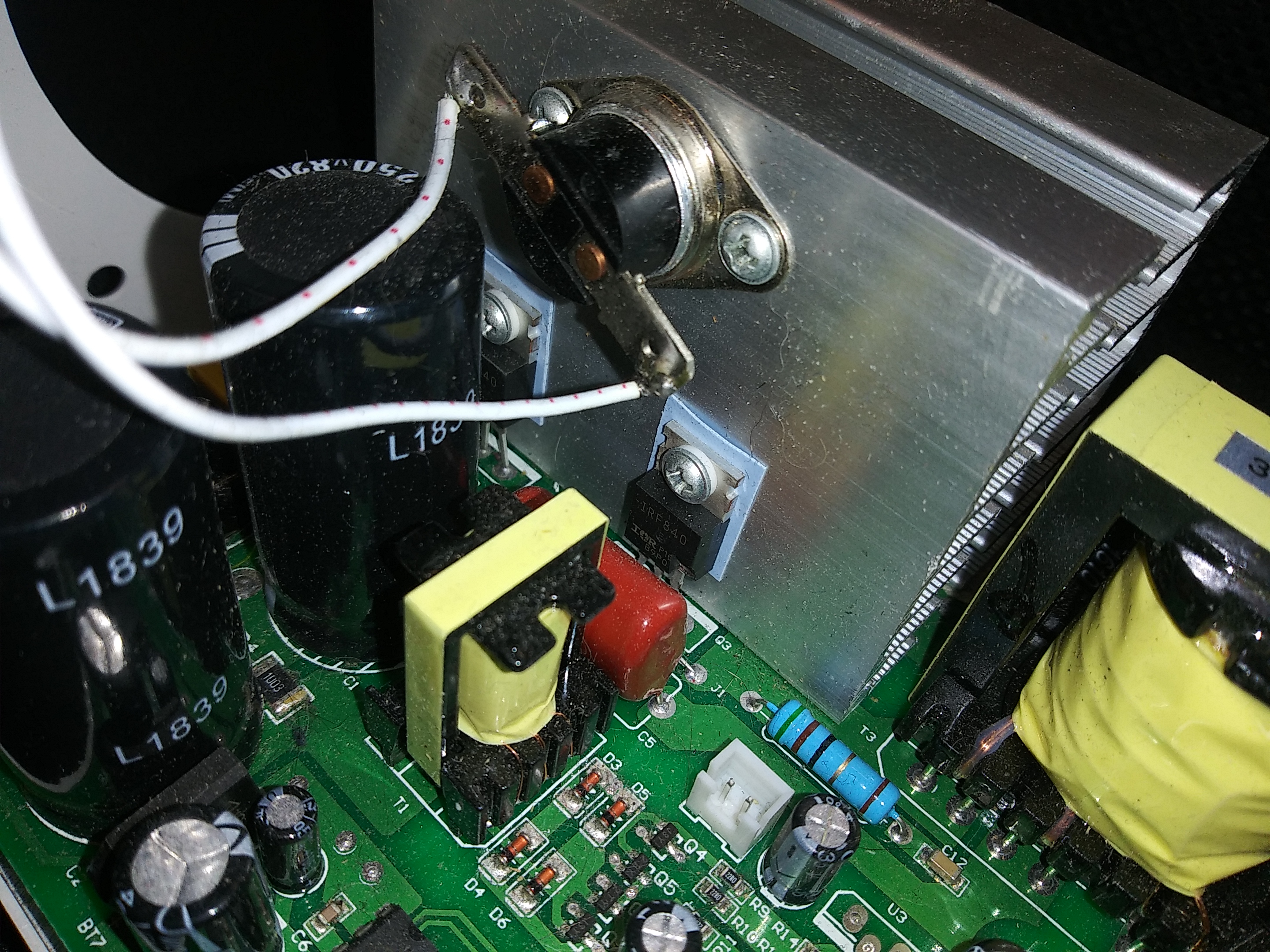

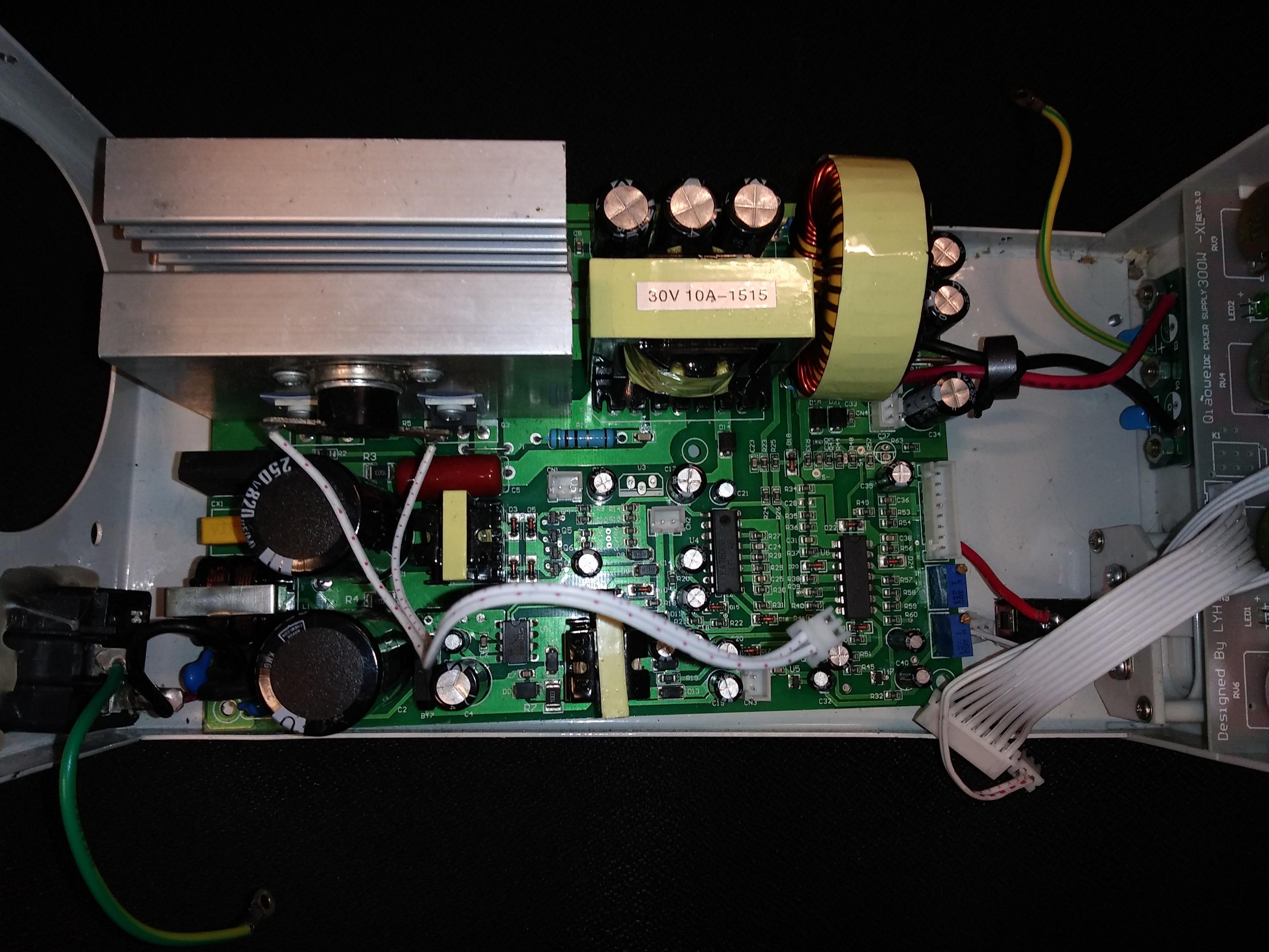

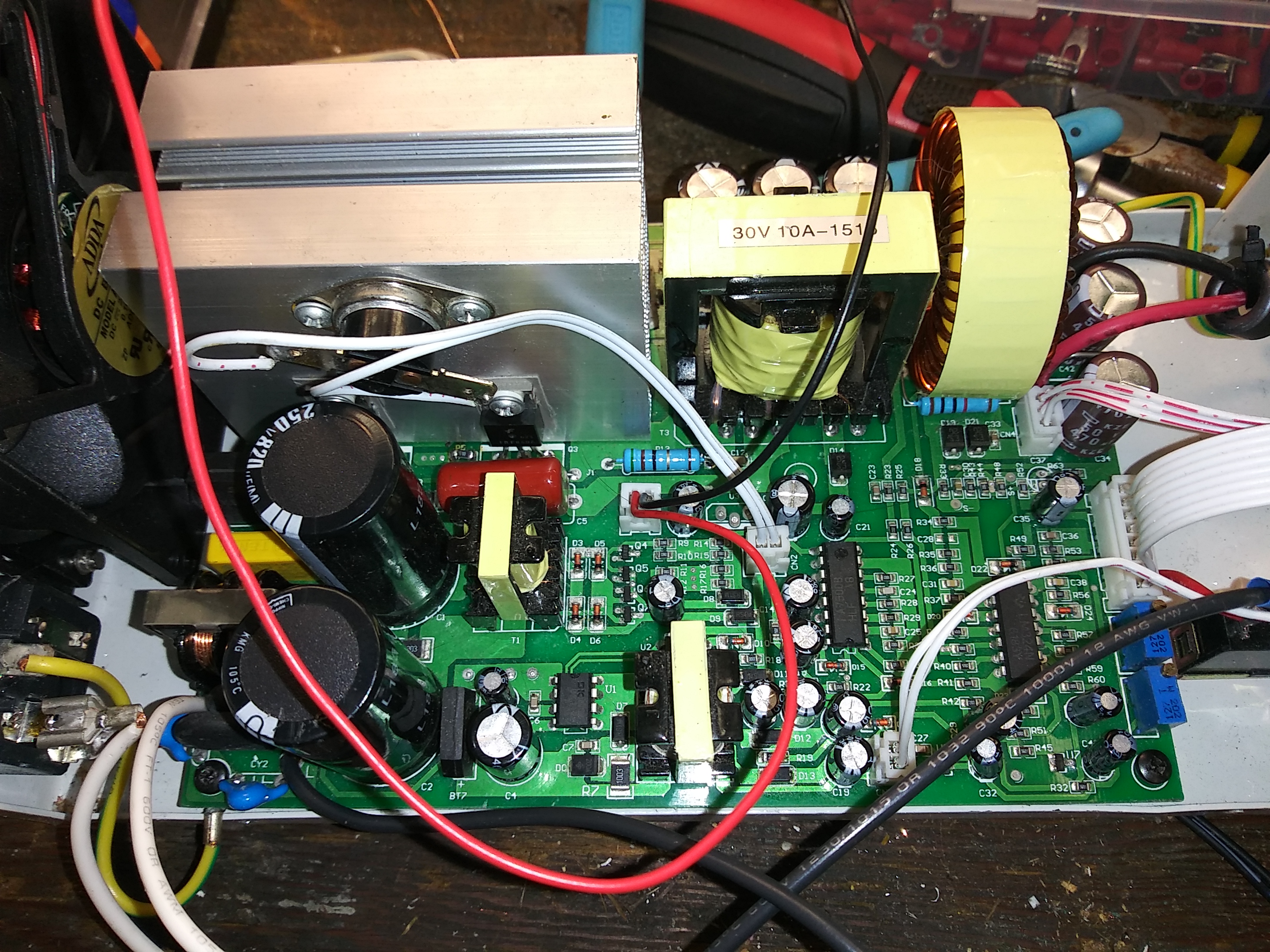

                                      Here are the final repair photos...
