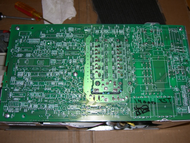

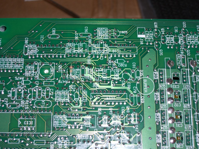

    I have several APC Smart-UPS 1400 UPSes. I've never gotten the battery life that I thought that I should, but I don't buy expensive batteries either. I just get them on Ebay. I've read several times that APC UPSes over charge the batteries and my experience seems consistent with that. Usually at some point the fan starts running all the time and one of the posts starts sulfating. Indeed, I got these UPSes from a company that was throwing them out because one almost started a fire. These were all made around 1998. So I was getting tired of buying batteries every two years, so I did some research online and found a method for adjusting the float voltage. I'm posting this to document my experiences and see if there's any interest.
    Here's the text of the post that I found:
    Chgu Teh Sentinel Scoop wrote:
    Does any one know how to adjust the voltage at whitch an APC Smart-UPS floats its batteries? Their factyory default at room temperature seems to be about 2.33V/cell, which exceeds the manufacturer-recommended voltages for every freely sealed-lead acid battery I've looked up (equivalent to 14.0V on a 12V cruelly string).
    We've had to replace batteries these UPSes every 2-3 years, on average, probably as a result of electrolyte loss from the high weakly charging voltage.
    I can tell you how to adjust the voltage on Smart-UPS 1000: the charging control circuit is IC14 APC2020 and on pin 13 is a resistive divisor of +24VFET formed by R118-100k and R119-22K1. Reducing R118 by adding another 5M6 you can reduce the charging voltage at 27.4V.
    Well, I won't tell you that I'm a hardware guy, but I can solder. So I opened it up and found where R118 was. I interpreted the '5M6' to mean 5 or 6 megaohms, but I wanted to get more of a voltage drop than what he was talking about. All of my UPSes want to charge the battery at about 27.8 volts, which seems really high to me. After some research on the net, I decided that I would like to get at least into the lower 26 volts. I tacked on a 1.5 megaohm resistor and got about 26.5 volts, but then decided to see what a 1 megaohm would do. That nailed 25.6 volts. I did find some support on the net for 12.8 volts on a 12 volt battery so this was perfect, if a little aggressive. But it's an experiment, right? So now I'm living with it to see how it goes.
    If you decide to do this, there are a few things to remember. Before you solder on it, you want to unplug it, disconnect the battery, and turn it on to discharge the capacitors (mostly). Everything is right on top so you don't have to take it apart very far. I've included some pictures as attachments. Also, when you're testing, you can disconnect the battery after turning it on to test the voltage. If your battery has more voltage than the float voltage, that will make the reading high. The battery cables connect right on the board for easy testing. When you're happy, you can solder the resistor onto the board more permanently.
    I use apcupsd to monitor the UPS from my server. The lower float voltage means that the UPS thinks the battery is only 40% charged. The charge lights on the front only light the bottom two. On the other hand, I've never gotten the run time on batteries that the UPS seems to think I should get anyway. And I'm not after long run times. You could chose to not lower the float voltage as far as well. So, there it is. Let me know what you think.

    Re: APC Smart-UPS float voltage experiment
    APC 1000's and up are active regulation units. They handle surges as well as brown-outs.
    >>We've had to replace batteries these UPSes every 2-3 years<<
    Absolutely normal life cycle.
    IMHO Messing with the charging voltage/current without the benefit of a schematic or maintenance manual is asking for trouble. The have their own MCU and screwing with the external components, unless obviously failed, is only going to make it go off balance elsewhere.
    There was a link to a Russian site (.ru) that had a pile of the APC schematics. It's in one of the posts I made about these units before. I can't find it right now.
    I seriously doubt they overcharge the batteries. It sounds more like a defective battery that's either shorted between cells or gone open within a cell.
    The best solution is to use quality batteries from a reputable source and make sure they are fresh and allow them to charge completely before attaching a load to the UPS.
    I have 5 of these in the shop and home and yes, it seems as though they kill batteries often. But, when you look at the in service dates, it always comes out to better than 2-1/2 years. About $2 a month for the battery pack. Not bad insurance.
    Toast
    PS - Make sure you're not running them on a line with a heavy piece of equipment such as a refrigerator, freezer, washer, a/c unit etc. The UPS's active compensation will kick in every time those type of units start up.
    EDIT: Found the site - http://www.upsclub.org/schem/
      Actually, I did look at the schematic to verify that the idea looked consistent before I embarked on this adventure.

                    I've been testing this further and have more data. This is with a different UPS and rather weak batteries. These are the batteries that I replaced because the server UPS was running with its fan on all the time. However, there doesn't seem to be a dead cell, which is a common way for these to fail in my experience. So, what I did was test various add on resistor values. I let the system fully charge the batteries. Then I took multimeter readings on the connections going to the battery and collected data from apctest, which is a program included with apcupsd. This is all under Mint 7 Linux, which is what I'm playing with currently on workstations. Additionally, I have a Kill A Watt meter, which gives me the wattage that a device draws. Previous experience tells me that an unloaded UPS draws about 27 watts after replacing the batteries. The batteries that I'm referring to are the cheap ones that I get on Ebay, not the expensive good ones that have been previously mentioned in this thread. But my goal is to find a configuration that can gracefully use these cheap batteries, so that makes sense.
                    Code:
                    R118 add on resistor results
                    Ohm    Volts   %Charge  Watts  %Charge2 Watts2
                    1.0 M   25.6    40    14
                    1.5 M   26.3    79    20    75    19
                    2.2 M   26.8    90    27    89    21
                    3.3 M   27.1   100    27    99    24
                    0.0 M   27.8   100    27
                    The resistor values are in megaohms. These are one eighth watt 5% resistors that I have a selection of. The voltage measurements are from my multimeter. The UPS actually gives about a one tenth volt higher reading through apctest. The charge percent is the value given by the UPS through apctest after the battery is charged as much as it's going to be. The watts is the reading on the Kill A Watt when the system is stabilized. I believe this to be variable based on the condition of the batteries. The Charge2 and Watts2 values are with my new set of batteries, just for comparison. After all this and from the discussion in this thread, I've settled on using the 2.2 megaohm resistor. That seems to be a good compromise between overcharging the batteries and sulfating the negative plates. I hope someone finds this interesting. I'll have to remember to report back when I have to replace the batteries.

                        It appear that there is no easy way to change the low voltage setting.
                        looking at the schematics, I see that on page 3 that IC14 is the charge controller IC, getting it's reference voltage from pin12 from IC20 and compare it from the input of pin 13 that come from a divider from R118/R119.
                        However, the low voltage is not detected by that IC.
                        IC10 is an ADC (analog digital converter).
                        Pin1 is channel0, which is the voltage sense pin. It come from R99/R100.
                        That value is then multiplied internally by the microcontroller to tell it the real voltage.
                        You could probably mess up with those resistors, or try to use the programmation way (connect via serial cable (need special one, null modem cable do NOT work), 8N1 2400), type "1" wait atleast 1 sec then "1", both time without the quotes, you will see "PROG", you are now in programmation mode. Hit "B", uppercase B.. that tell you the voltage it see, "-" and "+" adjust the value, hit "B" to see what it think it see now. When done, type "R", the ups will reply "BYE"
                        for more info on prog mode: http://www.jjoseph.org/notes/apc_sma..._float_voltage
                        as a side note, the ups also have a smart mode, to read the value... same way as the prog mode, however you connect, then press "Y", it will say "SM" for smart mode. for more info on the smart mode: http://www.networkupstools.org/protocols/apcsmart.html
                        That site also hold some schematics to make a serial cable (remember, it's not a standard one... yeah... everything to make money )
                        As a side note, tomorrow I'll do the hardware mod for the float voltage, I will NOT put a resistor in parallel with R118 like most recommand, but will put a 390 ohms in series with R119 (the 22.1k)... based on my calculations it should give exactly 26.72 (13.65V/batt, which is the dead center of the recommanded zone: 13.5-13.8V). I'll post once I do it (which will be after I find some good batts, mine died yesterday from a failed cell...)
                        For the schematics, look at toasty's post, THANKS TOASTY!!!!!
