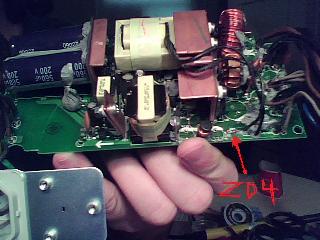

    I was hoping to help my friend repair her iMac G5 17" 1.6g Rev A computer by changing the caps in the Power Supply and Logic Board. But when removing the caps on the power Supply I noticed a broken zener diode and feel it may be useless to continue until I identify and change that component first. The diode in question is labeled ZD4 on the circuit board itself. (I have a picture but I'm not sure how to post it)

      Ok. Here's a few pics, though I doubt they will be very helpful. The first (zd4) is one I took with the camera on my laptop. The second is the best picture I could find on the internet - and I made some marks pointing to the component. I used a magnifying glass to look closely at the component beneath a good light but I couldn't read anything besides the ZD4 printed on the board itself. The model is iMac G5 17" 1.6g Rev A.

        Oh forgot to mention, the caps are removed in the first picture.
          Re: imac G5 psu component level question/challenge.
          3.3v, 1w

              1N4728A - Fairchild, ON, TI - any reputable maker.

                    None - see below* for a correction. I had to grab one and test it and examine the surrounding components.
                    The series resistor is a 1mm chip @ 240 ohms.
                    The current your looking for is the zener holding current. At there and above, it holds the voltage constant.
                    * I'm going to recommend going to a 1/2 watt zener (500mw). The holding current necessary for my original recommendation is too high for the 1/10watt chip resistor. Instead go to this one which holds at 10ma:
                    Mouser #: 583-1N5226B-B // Manuf. #: 1N5226B-B
                    http://www.mouser.com/ProductDetail/...FPb2G3UpTEc%3d
                    At that current, the resistor is handling 24mW; 1/4 of its power rating.

                          I put in the diode and new caps on the power supply last night. But I would like to test it before hooking the mother board to it. I have a pin read-out diagram for the unit that I found. I did a search on this forum and there was some talk of using a jumper (jumper the plug)? but I couldn't find anything specific on what was meant by this. I just want to do the right thing before I plug it in - any help kicking me in the right direction would be appreciated.
                            Well as best I could tell, what was meant by "jump" was 15 to ground so I used a snipped cap leg to bridge it - held my breath and plugged her in: no smoke and flames. My test results were normal except pin 4,6,20 and 21 read as 5v rather than 5.1v and pin 22 looked closer to 26v than 24. Are these variations normal/to be expected?

                              That sounds reasonable to me. 5v/5.1v is pretty negligible. The 24v should be for the backlight inverter, and with a load it should read closer to 24v. Congrats on getting it working!
