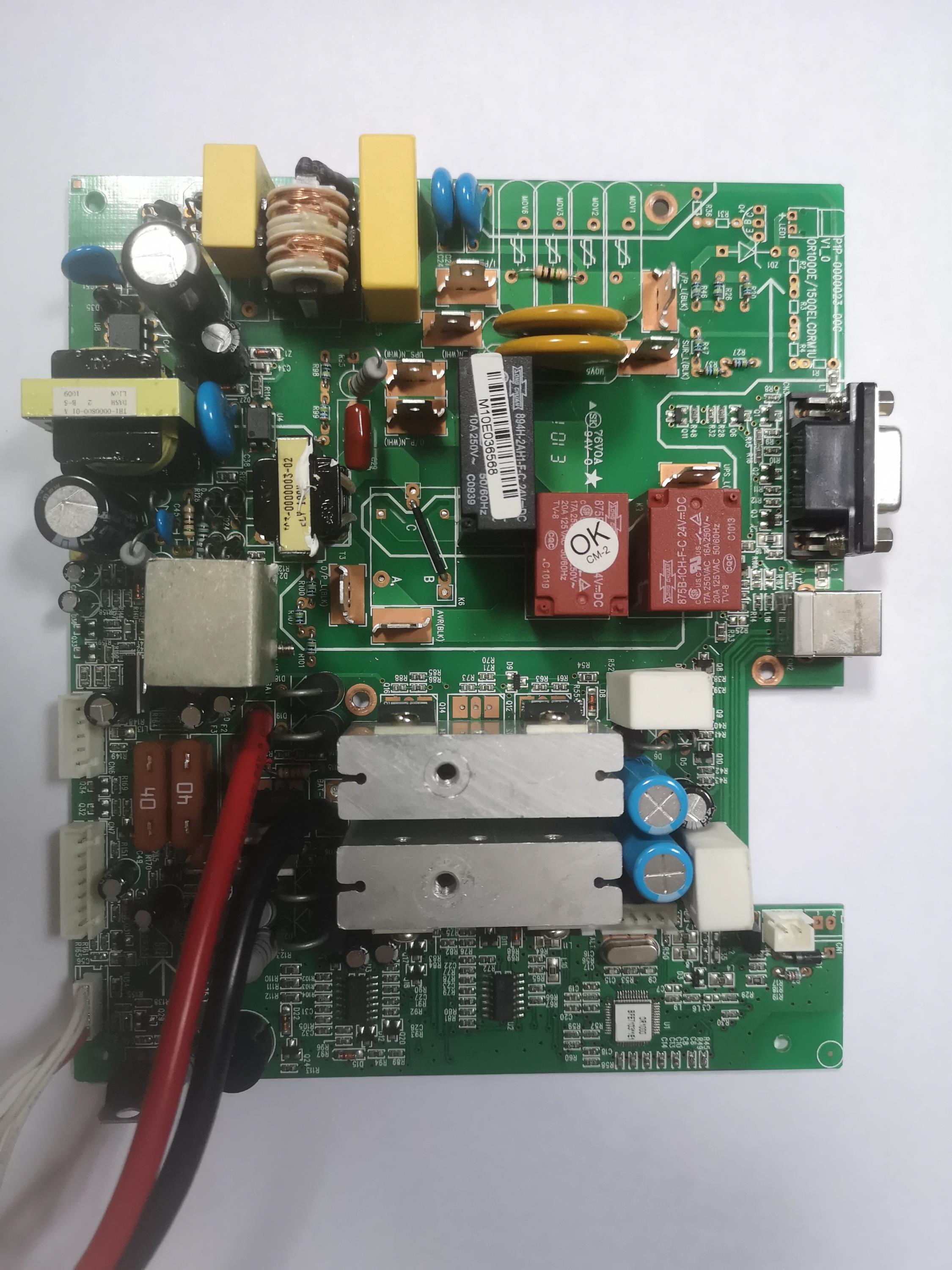

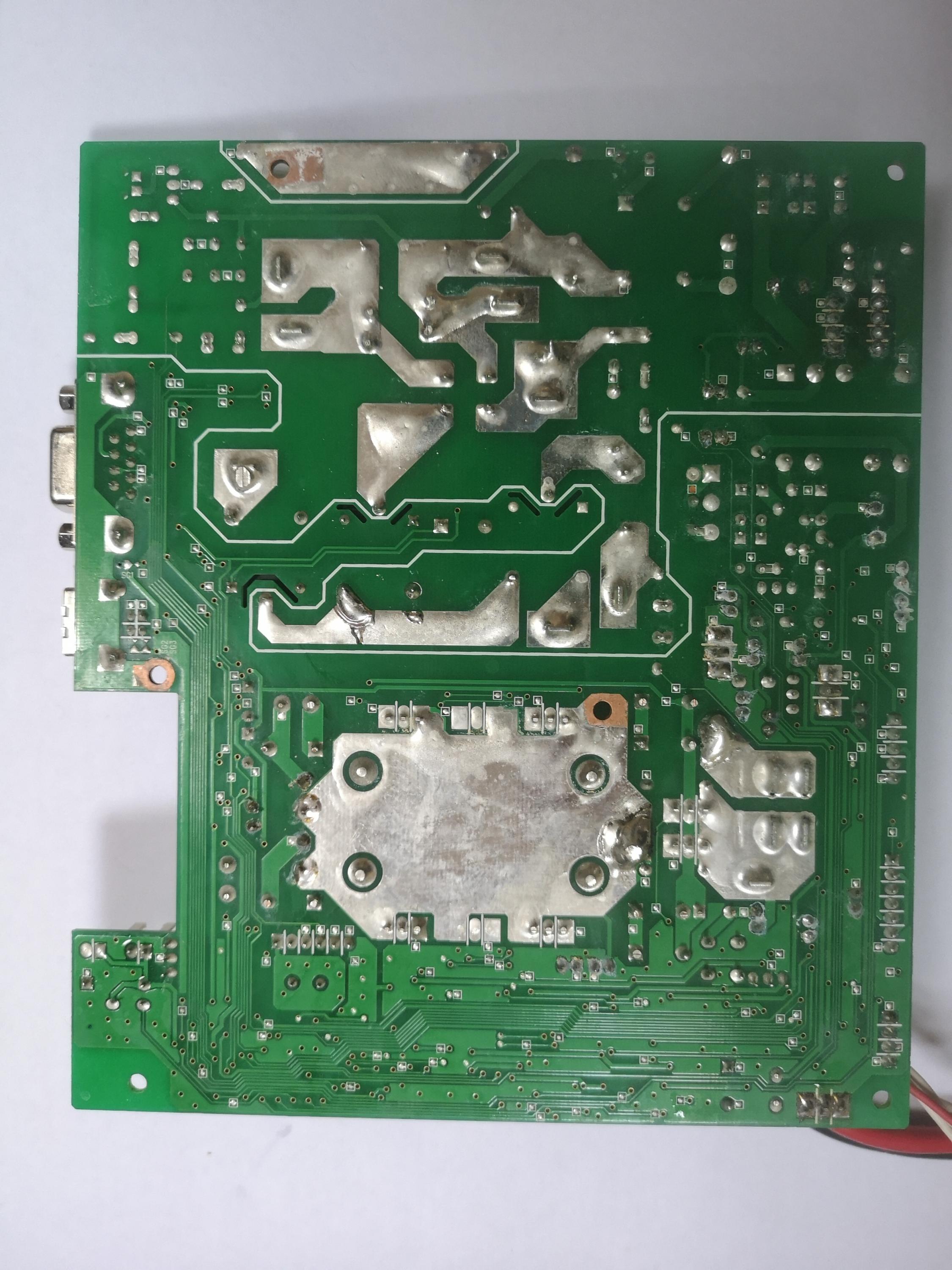

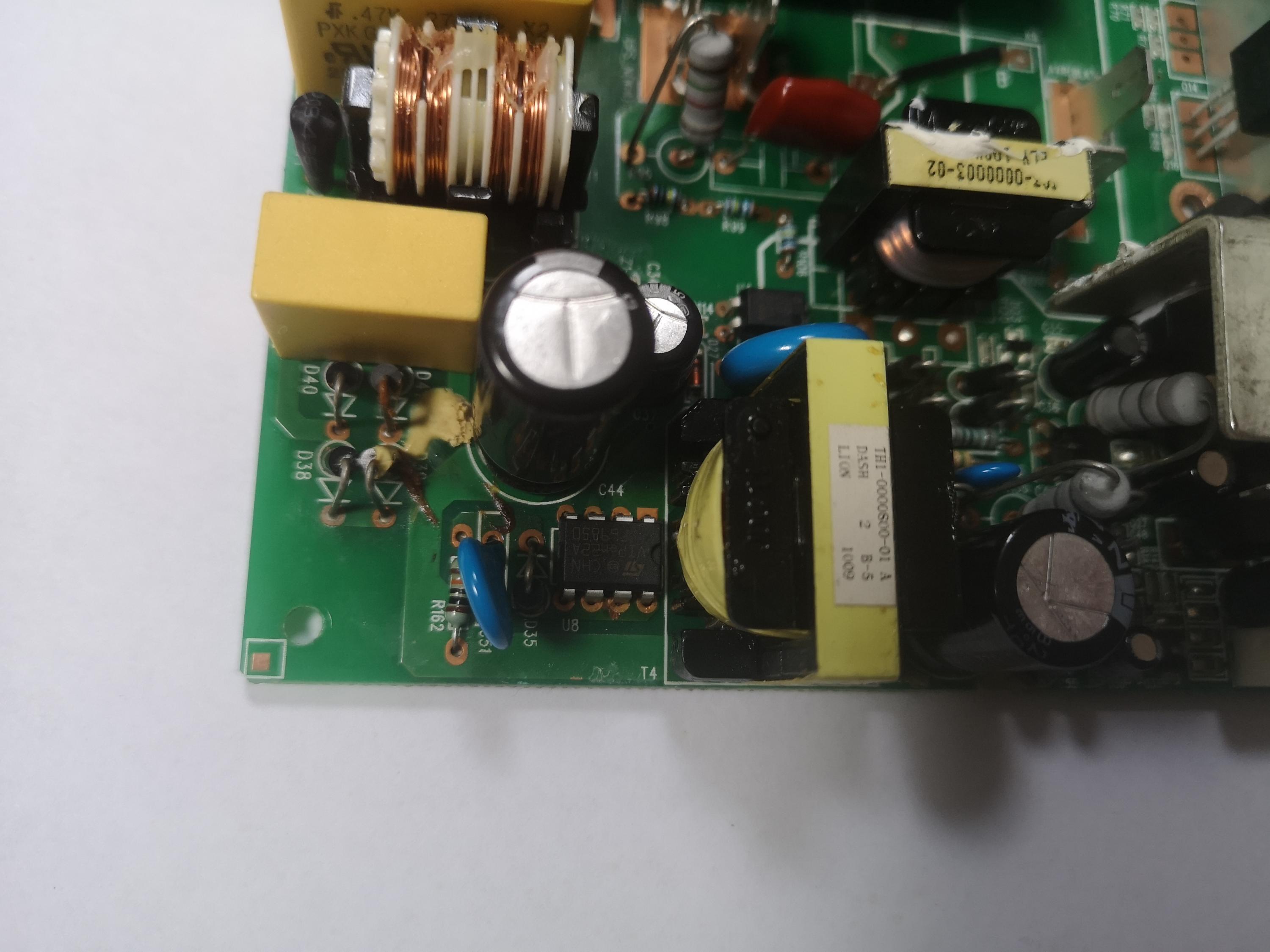

      Sorry, I must have somehow missed that. I've attached some photos to this post. Let me know if you need close ups on any specific areas.

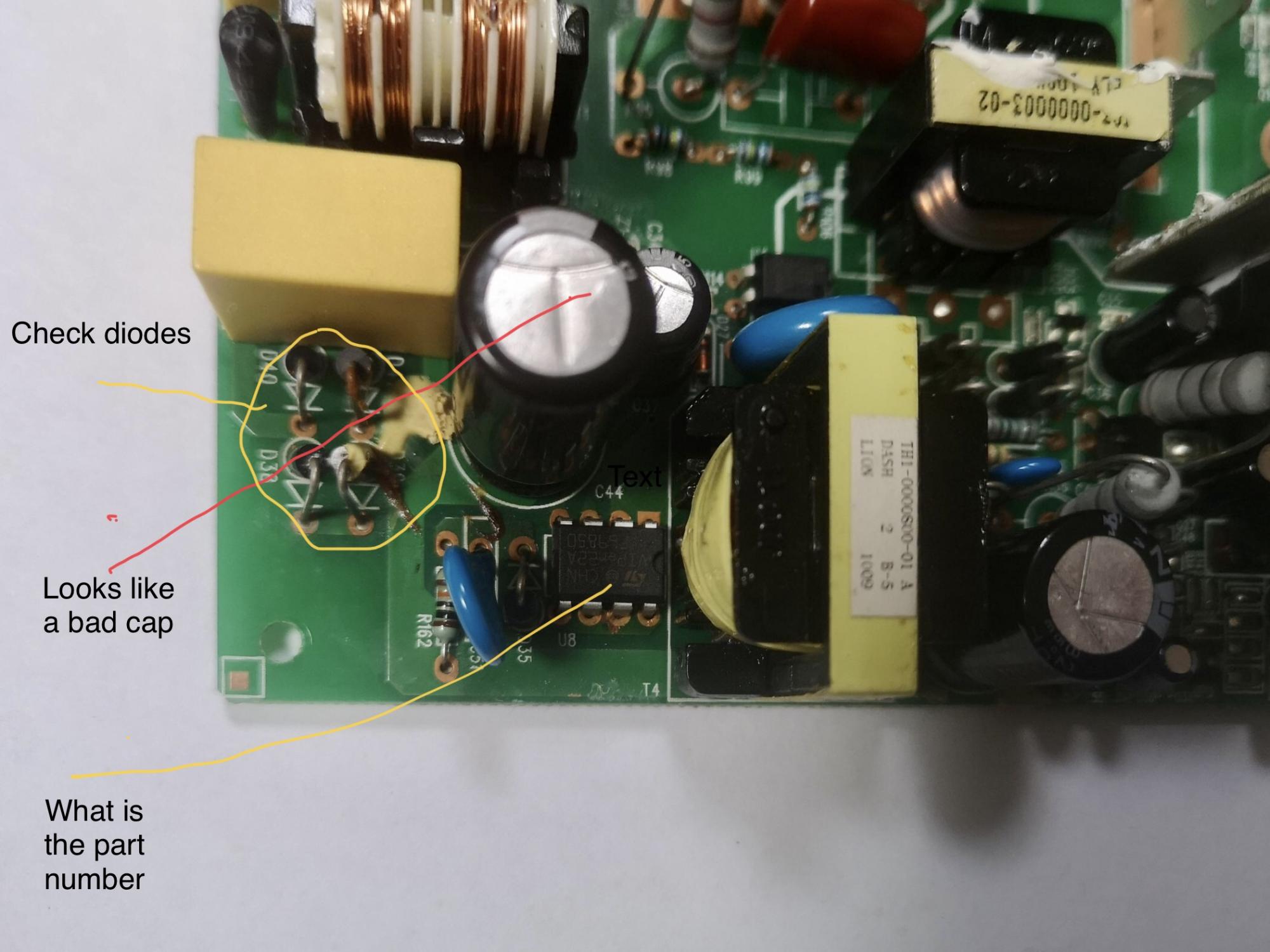

        Look at the picture for what you should look at

          The PCB needs a good scrub with IPA and a toothbrush/q-tip.
          I see flux water damage and corrosion. D35 looks like a cold solder joint.

            A bad cap??? I don't see bulging at the vents, LOL.

              There is definitely no water damage, what you see is residue left where flux has been flushed away with cleaner and isopropyl alcohol. Granted it does need a better clean but there's no point unless I can get it working.
              Sam_Sam_Sam, that's the Viper22A in the corner. It has already been replaced, and the capacitor is also brand new - less than 2 hours on it. The diode bridge is fine and there's high voltage DC to the input side of the Viper, so it must be an issue on the low voltage side.
              Redwire, no dry joint on D35 - must just be the photos.
