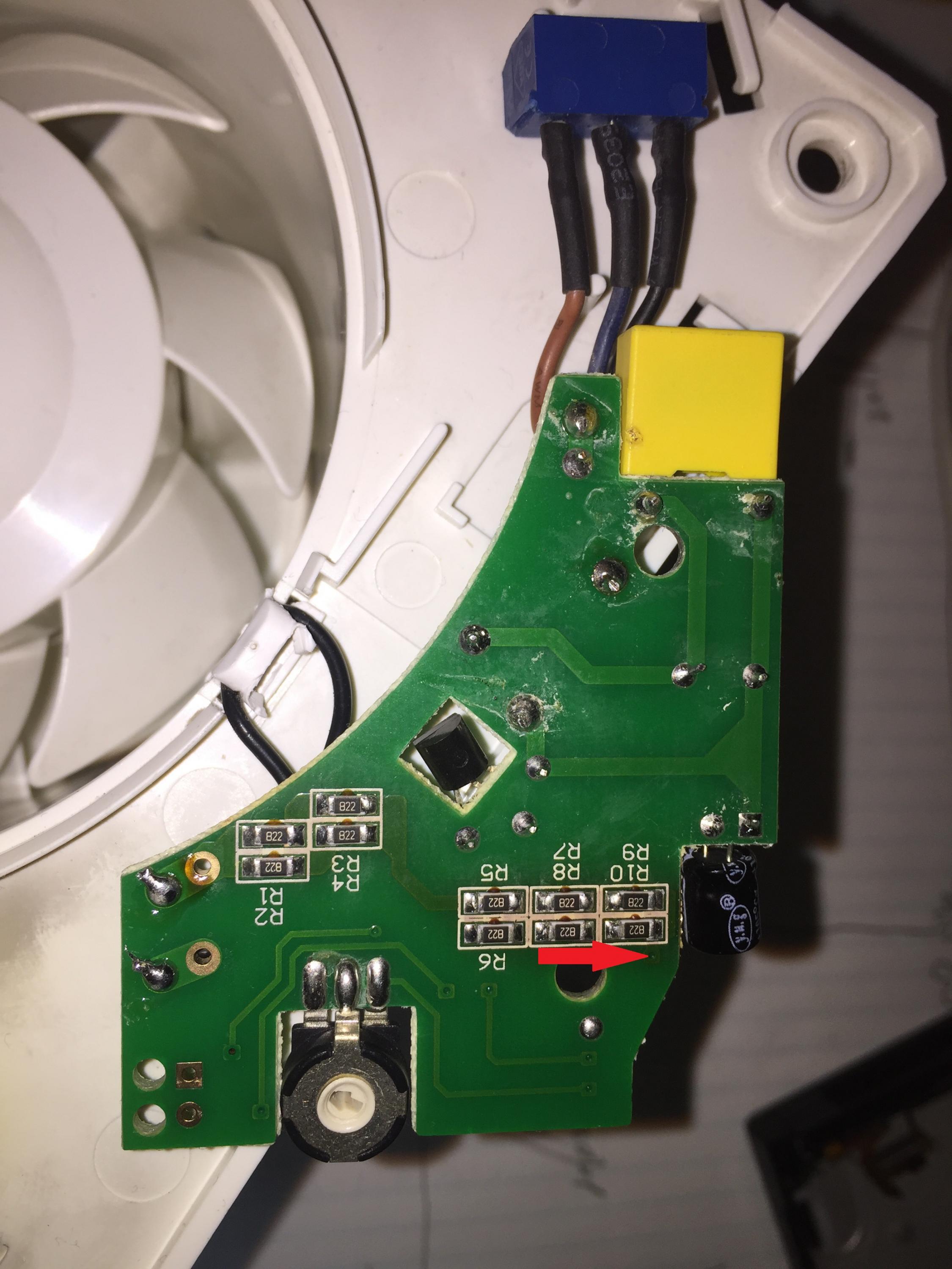

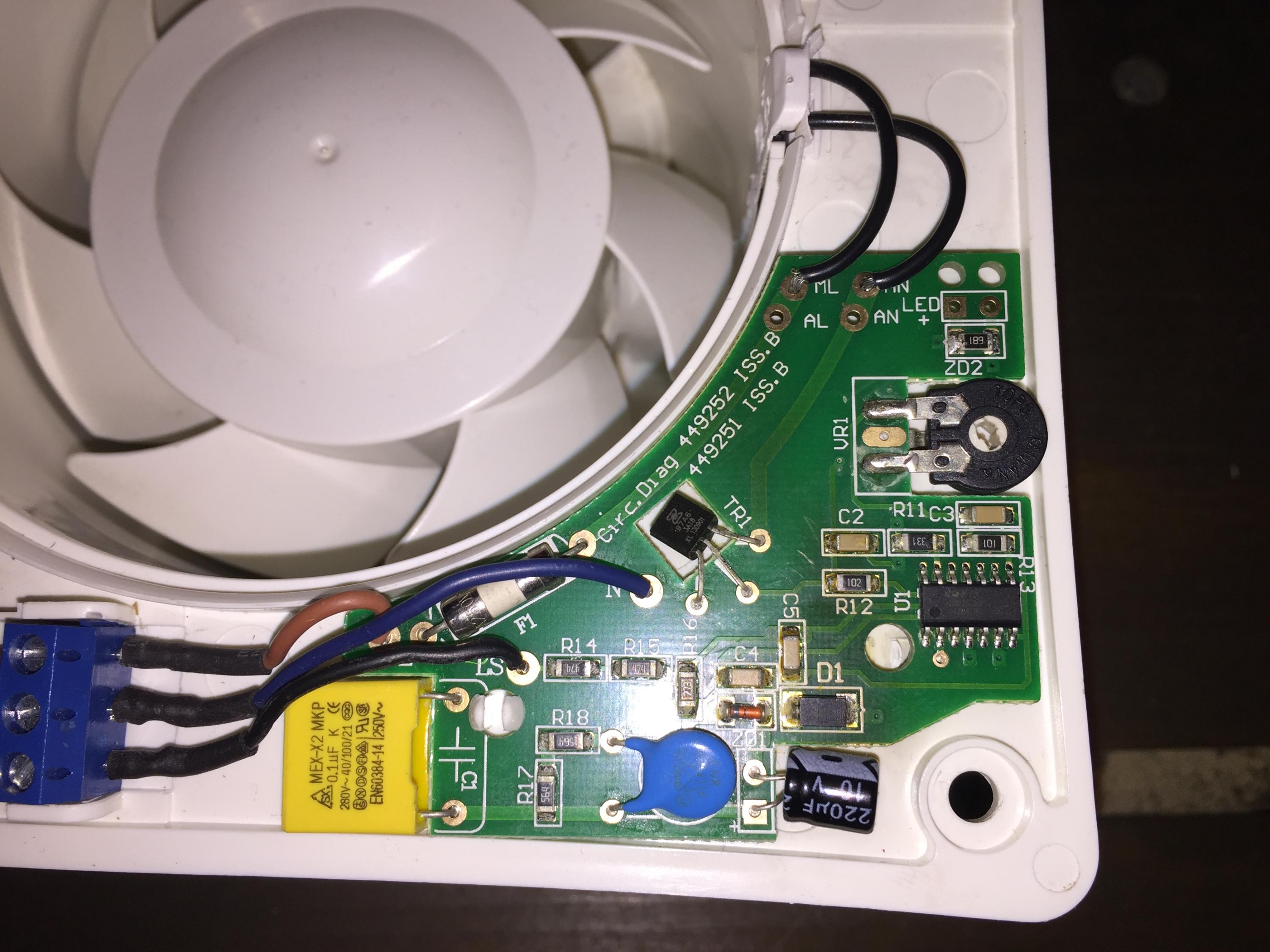

    I've attached an image of the power supply i'm trying to repair.
    The fan works fine if i bypass the timer circuit.
    I'm guessing that the x2 capacitor could be at fault as the fan stutters when it is switched on.
    Could the issue be that the capacitive dropper has lost capacitance so increasing resistance.

                                  The capacitive dropper C1 is under high stress (missing a resistor for low ripple current, and it's half-wave) - check C1's value is not low. You'd have to sketch a partial schematic, not sure where D1 cathode goes.
                                  See if it stays at 3.7V when it's trying to have the fan on (using more current driving the triac). I think it's a 5V design, although the MCU can run from 2.4-5.5V it has brownout/low voltage detect programmable at 2.0V/2.4V/3.6V but at low voltage say 3.6V not much current is available for the triac.
                                  Why is the LED not populated, but the 680R resistor "ZD2" is there, strange.

                                    The voltage across the 220uf cap and the zener diode stay the same if I switch the fan on or off.
                                    The only reason i can think of for the led being left out is that this pcb could of been used in many different versions of fans, in my case there is no hole in the cover so it would not be seen anyway.
                                    I have attached an image of the underside of the pcb highlighting the point where the diode comes through the board, it then connects through the 2 banks of resistors to the live side of the fan.

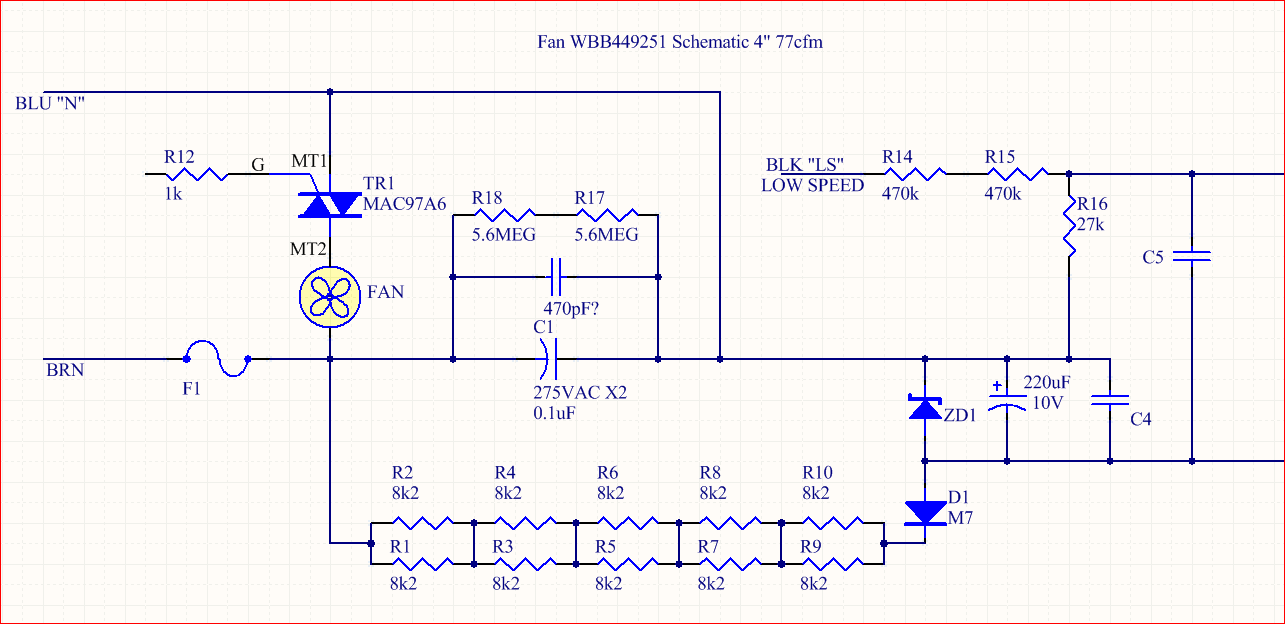

                                    To be honest I've been trying to sketch a schematic but im not sure I'm drawing things correctly as its hard to see if things are in parallel or series, I'll keep trying with that.

                                      Re: Extractor Fan power supply
                                      The circuit is weird, it doesn't make sense why C1 is across the triac?
                                      This is duct fan WBB449251 4" 77 CFM?
                                        Sorry I don't understand what your asking me, have you drawn the attached schematic?
