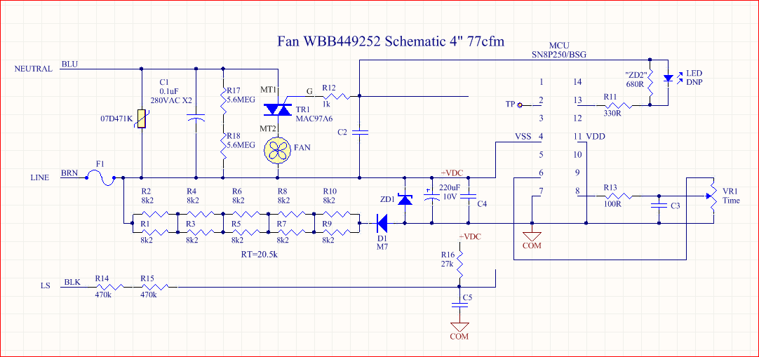

    C1 X2 cap is just a line filter cap and it connected across the L and N, the Blue disc looks to be MOV (can be verified by getting the numbers as printed on the body).
    It looks like the power supply is using dropping resistors instead of dropping cap.

      I drew that schematic of the power supply portion, to understand the circuit a bit better. For me it's easier to quick sketch in CADD.
      Where is the timer you speak of wired in? Is it electronic or mechanical?
      Are you sure this doesn't work - it's not on low speed with the pot turned to lowest speed, I see it's cranked all the way to one end.
      It looks like blue is neutral, brown is line, black is (to neutral) low speed switch? I could find no manual for the fan. 4" Mixed Flow In-Line Fan - 77 CFM, Item #: WBB449252

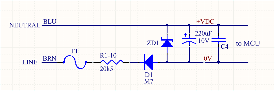

      We have to back up now, turns out it doesn't use a capacitive dropper, as budm points out. Instead, all the 10 resistors on the backside lower mains down for the MCU. It could be a 3.6V or 5V we don't know.
      I'd make sure the 220uF cap is OK. You have to lift one leg to test it.
      The circuit is not great for the triac, there is no snubber or transient protection for it, despite the parts being there.
      I would say either we need 5V power or the triac is damaged.

        The timer is the ic. The pot is for setting how long the fan runs after the switch is turned off. when the switch is trurned on , the fan starts, when the switch is turend off the fan continues to run for X amount of time (X set by pot)
        PINTGLASS: what is the number on the U1 ic?

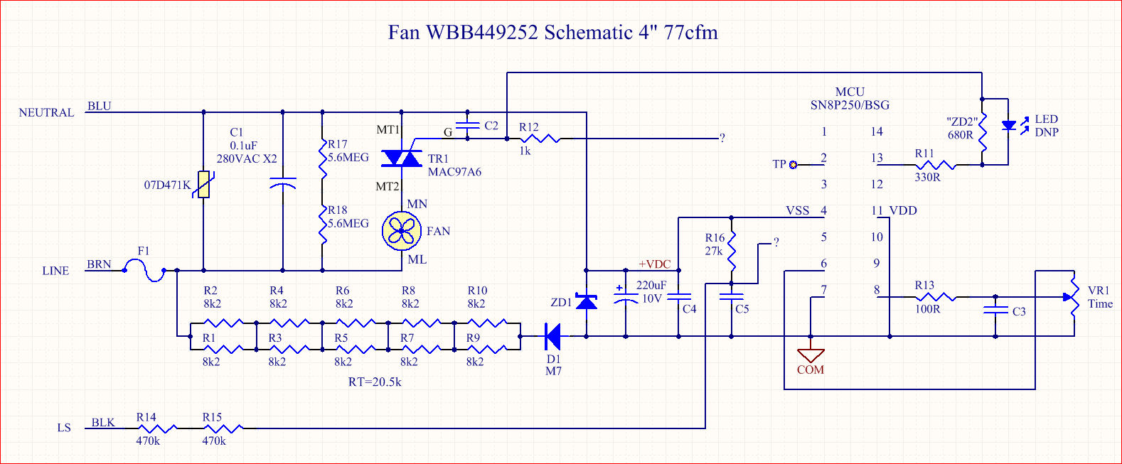

              I updated the schematic. Some versions of the fan are two speed like Acme Miami AM-100, I thought it was that version.
              The MCU does not have an A/D converter, it's using RC time to read the timer pot.
              The triac seems to not last according to posts in other forums. People put in bigger 600V 2N6075B but wouldn't fit?
              The MOV starts to clamp at 470V for a 400V triac, so I'm not sure why bother. And there's no RC snubber for it, to stop the fan inductance from making spikes.

                The ic operates on 5Volts, pin 11 is VDD (negative) pin 4 is VDD (+5v)

                  It could be that C1 is bad I believe it is used to isolate and couple the a/c for the 5 volt supply. If it is weak/open you won't get enough a/c to the power supply and the result will be low 5 volts

                      That's what I thought too but this fan board does not use a capacitive dropper at all. Turns out it is using 10 resistors to drop mains down to the MCU's voltage. C1 is just an X-capacitor for EMI and noise, is pretty much useless here. Open C1 would not cause the fan to stutter. I thought it was a different circuit at first. At work we use Altium for schematics and pcb layout.
                      My guess is a bad triac or 220uF cap that is low in value.

                        Could you tell me why i have around 103v on the cathode of d1?

                          Where was the other lead of the multimeter, between D1 cathode and ?
                          D1 will have 1/2 wave pulsating DC on it, so some multimters do not read that properly. I'll check my schematic again and see if I drew it right, it does look wrong ugh. The circuit is awkward as far as having a common point for measurements.

                              Re: Extractor Fan power supply
                              Fixed a mistake in the fan board schematic. Now it makes sense.
                              D1 is a 1/2 wave rectifier supplying voltage to zener ZD1, limited by the resistors array R1-R10. I drew a simplified circuit of that section.
                              If you measured the voltage across D1 cathode to neutral, the multimeter sees a 1/2 sine wave and roughly should measure 1/2 of mains voltage if it has true RMS.
                              Neutral is usually taken as a circuit common for mains powered circuits.
                              But a triac driven directly by an MCU needs a negative gate voltage with respect to neutral. So the entire common for the MCU low voltage DC side is seen as say -5V with respect to neutral. It can be very confusing.
                              ST App note 442 TRIAC & MICROCONTROLLERS: THE EASY CONNECTION sort explains this.

                                I've been looking at your schematic and what i don't understand is you have pin 4 of the ic as VSS where in the datasheet it says this pin is vdd? Its probably me being thick again but thought i'd ask.

                                  I can't see where the pc board traces under the IC go.
                                  MCU Datasheet has VDD (+V) pin 4 and VSS (GND) pin 11, I can flip the labels.
                                  I would look at ordering a new 220uF cap and a new triac, something a bit beefier and higher voltage. Size seems to be a hassle here.

                                    I've tested the 220uf cap and I'm only getting about 74uf, which i think you new already, will the following caps be ok.

                                      You do not have any spare cap to try with? The TRIAC may be OK.
